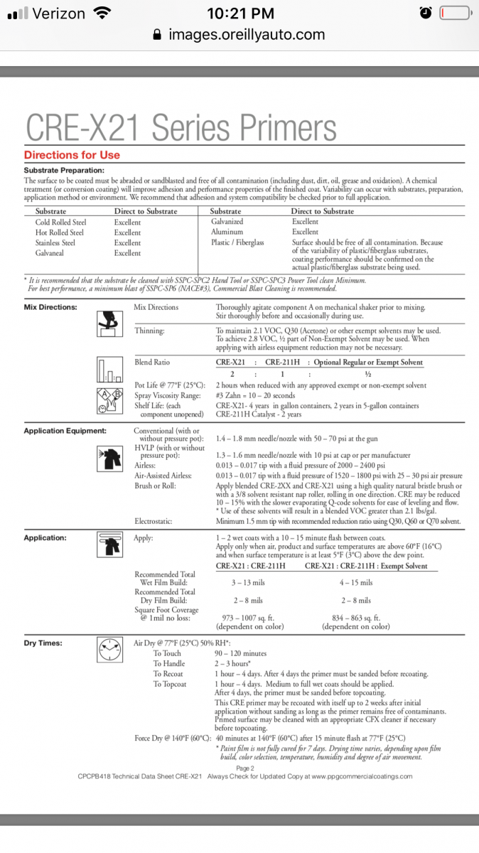

  3. Its done , the parts are blasted and they used sand. What I cleaned out of the car was tan, red and black.
    3D497604-9AEA-497B-A67E-CCB2EFBBB02E.jpeg 62D932A9-ECBE-4C69-BA3A-1AA5206A1861.jpeg

  4. Thanks K13, you certainly add valuable information here.
    What product like do you work for?
    A little bigger

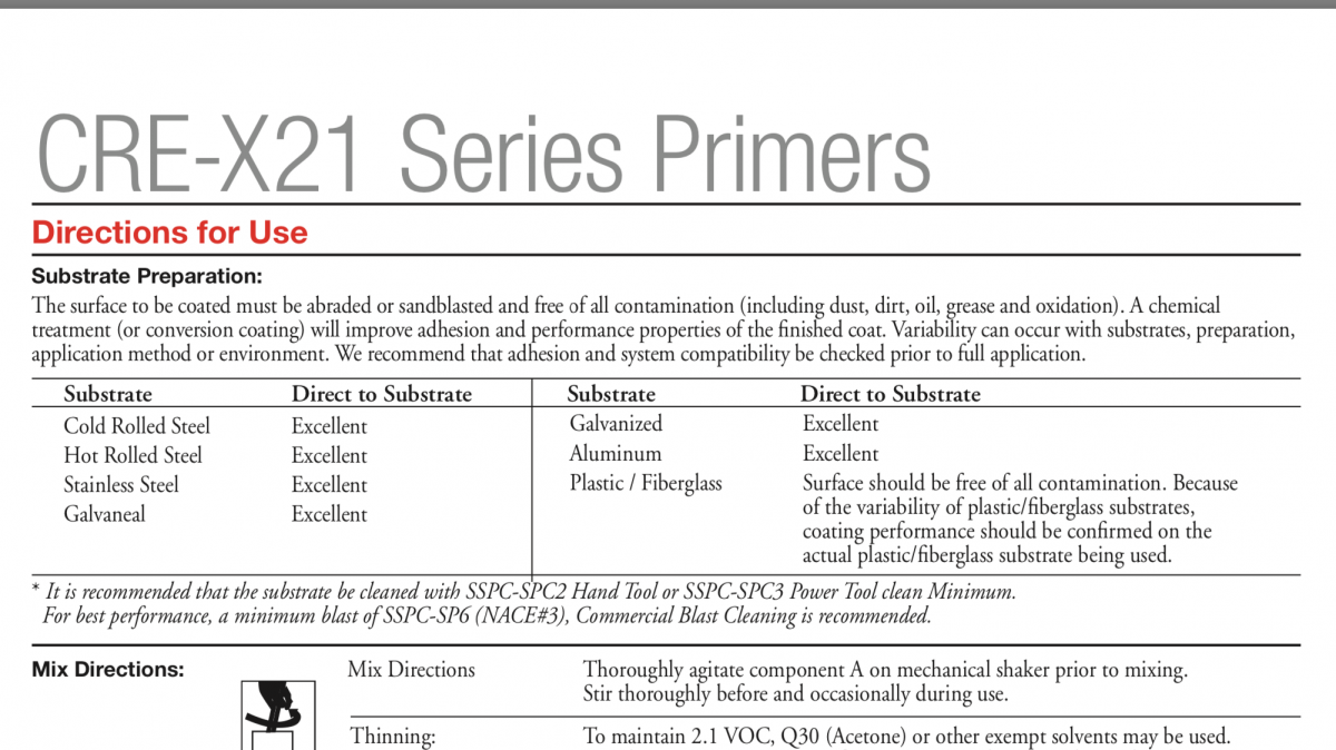

    Some place on the 4 page tech sheet in “fine print” (WHY ?) in an asterisk footnote they said that the testing was done using “bonderite 1000” as a conversion coating.
    I read up on the bonderite 1000 - an iron phosphate conversion coating that’s a multi step process that requires plenty of water and last step is deionized water.

    I'm not familiar with that primer, but from the sheet it appears to be an industrial type primer and not automotive specific? Have you used it with automotive topcoats?

    I do see that the TDS does state that the surface can be abraded as well so you could have sanded but it doesn't specify a grit but that is water under the bridge now that they are all blasted.
    I believe (not positive though as we don't do epoxies) that the testing is done on Bonderite 1000 panels to meet certain ASTM standards. Perhaps aeronautical certifications.

    actually the tech sheet says to prep using SSPC -SPC-2 and 3 which I sanding/brushing/blasting etc.....
  11. Right,,
    For best performance a sssp-sp6 (which is 66 -2/3% of any 3x3” area is clean) This came back near white. And the sp6 says visually without Magnification it’s free of crud and debris.
    Sooo I read that as blast it just a little better than half ***ed blow it off till it stops making a mess and shoot it.
    More than likely I’m Wrong on that but it seems stupid to blast it, then sand it, then prime it. I could have just sanded it a little bit more and skip the blasting since There’s sanding anyways. That’s a lot of *** ache to get it there to the blaster ,,,, right ? Get the body off the frame, on the cart, cart on the trailer, traveling across town with ***holes, off the trailer, worry the blaster don’t **** it up then repeat the process back to the shop l. Did I mention there was another car body on the cart so we had the fart around and move That car first.... that is whole process by itself.
    Lots of labor, risk and exposure to get a blasted surface that’s sanded.
    The CRE primer sands really nice plus it’s a great filler . So if there’s some **** in it (there will be) it sands right out with a quick block down for second coat. That second coat to fill the rust pits they blasted out right.
    Man I know it doesn’t have to be easy but making it harder and take longer doesn’t work in this case. Especially if there’s no reward.
    loudbang and RMR&C like this.

    This photograph of this fender is what scares me the most. Check out this data sheet. After I metal prep the car I seal the whole car with 2 coats of this primer. Then I do the bodywork. After bodywork is done I seal it again with this primer. Then I prime it with a sandable urethane or epoxy primer. As far as using industrial primers on cars it's done every day. Rust doesn't know where it is. I've done it this way for almost 30 years and never have things come back. The Chevy in the avatar was done in 2006 and there's nothing coming through anywhere. Do you know that in industrial applications where they want maximum corrosion resistance this is the type of system they use and these projects usually have a 20to 30 year service life outdoors.
