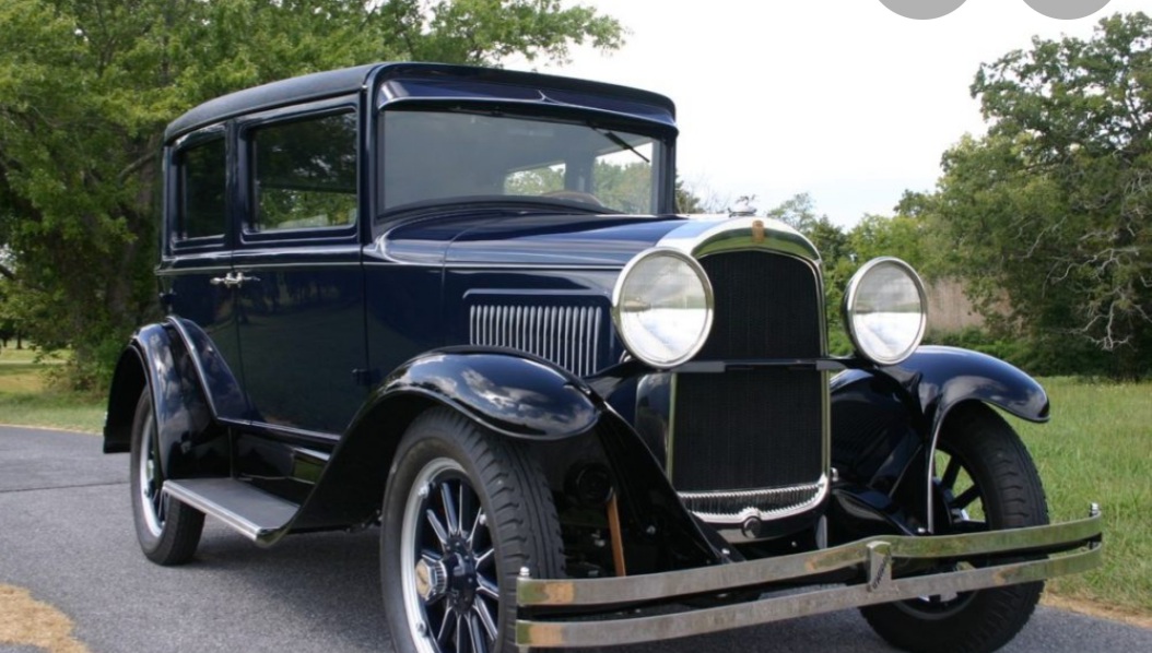

    A 96A is a Willys-Overland Whippet 4 cylinder model. Your serial number puts it in the 1930 model year. And the frame serial number tag is also the correct location for a Whippet. Unfortunately its not the early model with the cool horse collar grille shell.

    Excellent work. Looks like you are correct, except I think 96A447**x serial number lands in the 1929 USA model range. See link below.
    https://www.wokr.org/gallery/wh96ahis.htm
  15. This was from my Willys-Overland knight registry (wokr) roster ?
    I used to be a member, maybe they updated the numbers ?

    A lot of this old car stuff is a little bit hit-and-miss from one source to another.
    Interpretation can vary, but at least we can get real close.
    1929 and 1930 Whippets are essentially the same, just some cosmetic changes.

    Wow! Now we are getting somewhere! Could you post a pic of the whole page with that info on it, in case the DMV needs some more proof?
    I guess it's even more fitting that I'd use the small Whippet grille on this car.

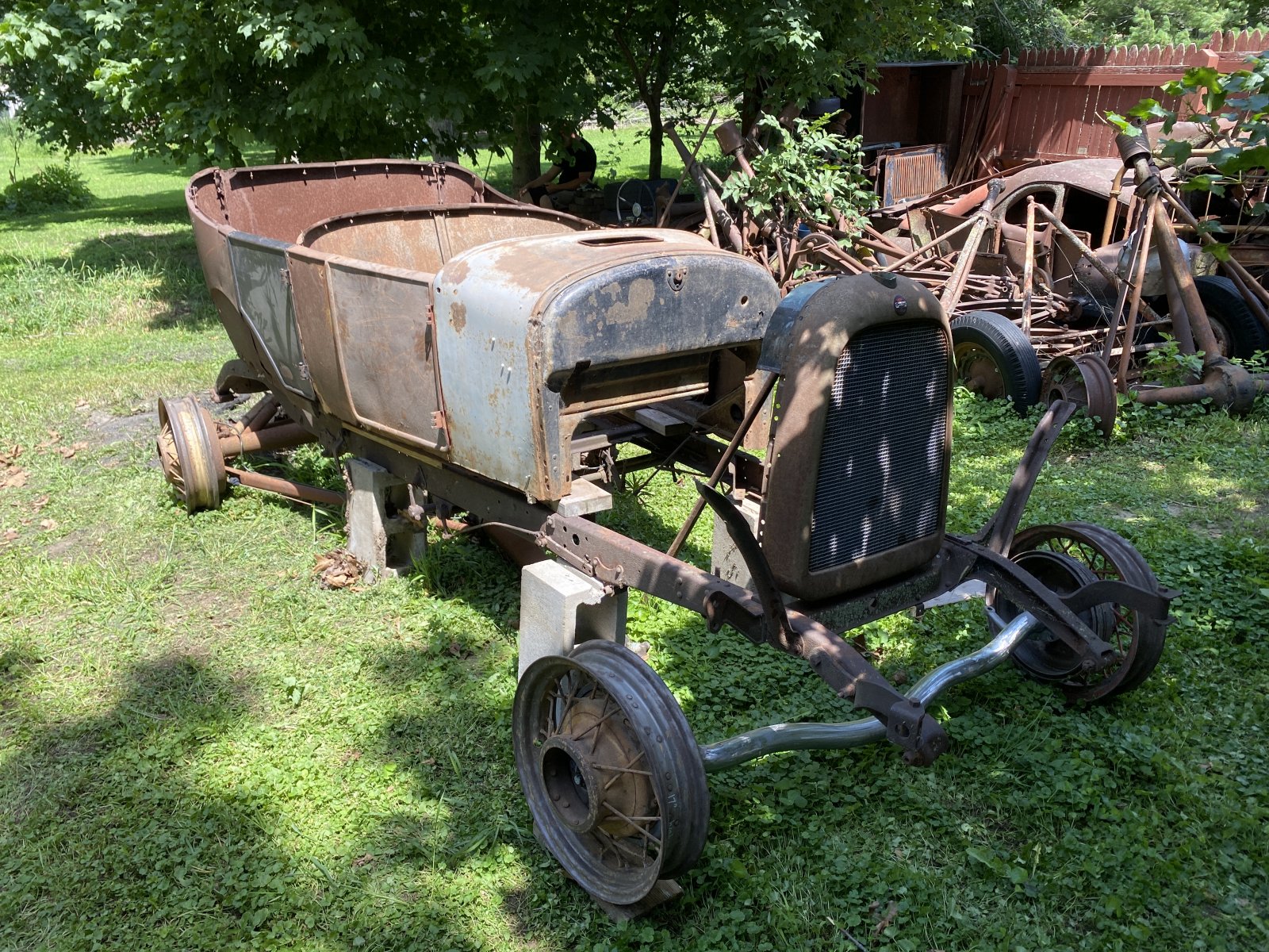

    Here we go! Sending in the application for a bonded ***le today.

    There has been some body re***embly done on the “1930 Whippet” since last seen, but it slowed a bit after that. Hopefully I’ll get back to it this winter.

    all you lack is finishing up...
