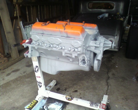

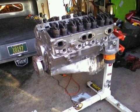

    at about $36 a can, the epoxy SEM shit is expensive, but NICE.. one can did a nice job on a motor... before and after from today after a number of hours to go from scrap heap to bare metal!.. (never mind what looks like drops on oil pain, its ripples in the metal on the stock pan sbc guys know what i mean)
