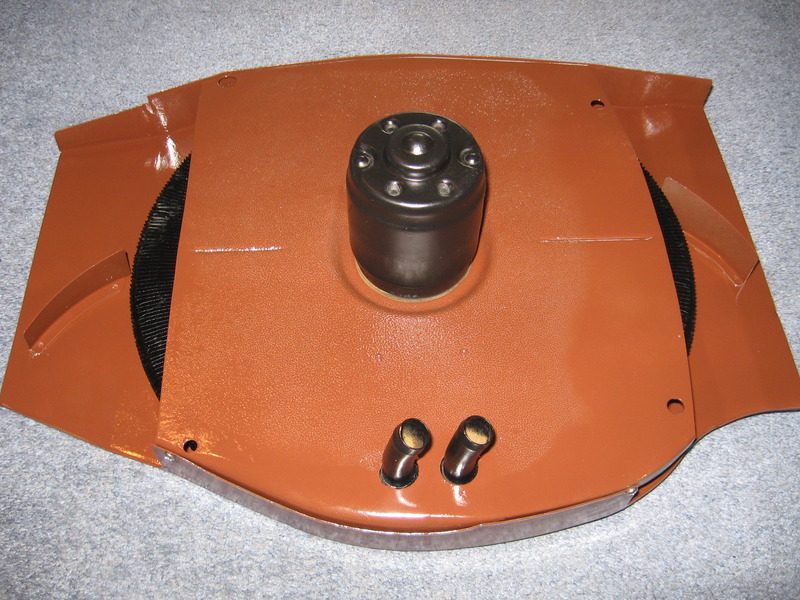

    A question about that heater. Does it have an outlet on the bottom or are the two outlets I can see the only ones?

    There is two heaters available,one with defrost and one without,mine does have the defrost kit. HRP

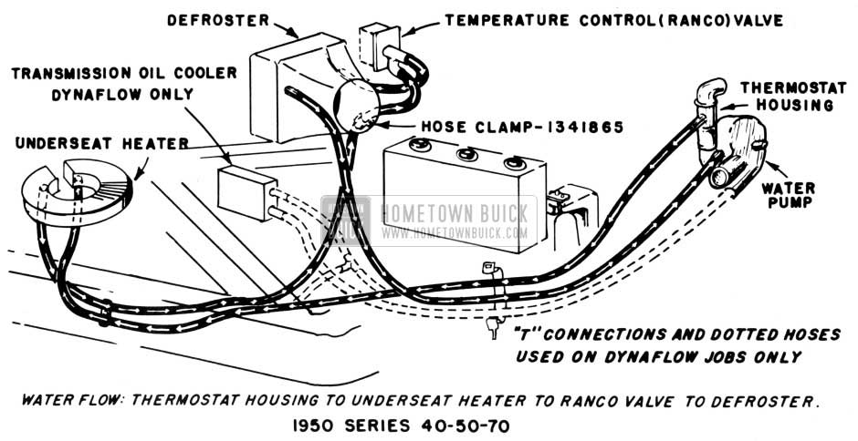

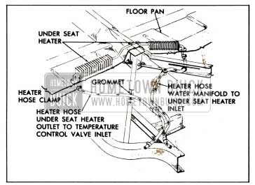

  14. Lots of '50s cars had under seat heaters with a little fan box.
    Some had 1 and some had 2
    Some square some round. Pretty neat.

    Thanks, but that did not answer my question. Does the heater have an outlet on the bottom?

    The 2 outlets are for the defroster,the heater only unit doesn't have these,the heater does have a open bottom for the heat.
    See figure #1 ~ HRP

  19. Yep hard lines down thru the toe board
