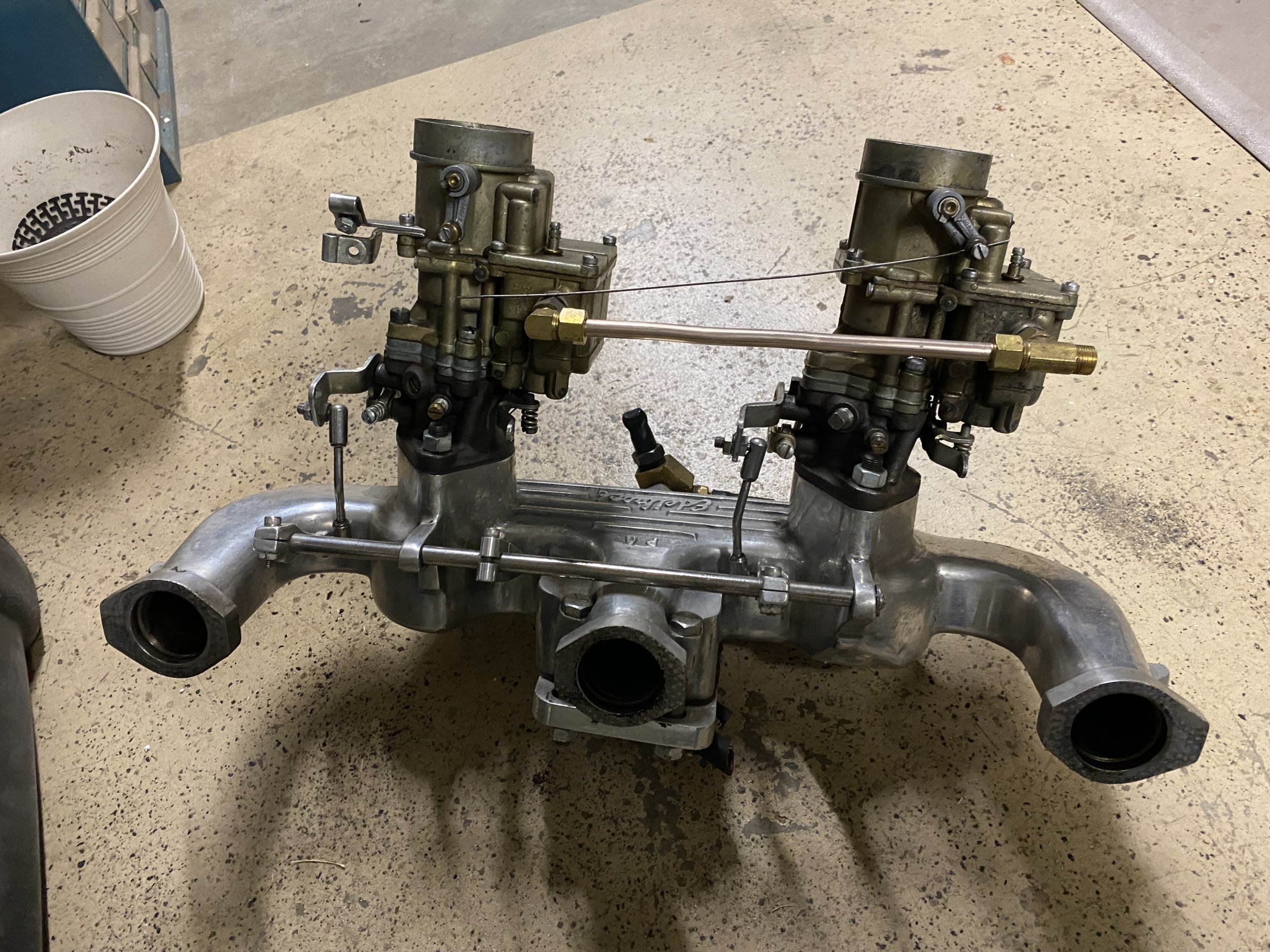

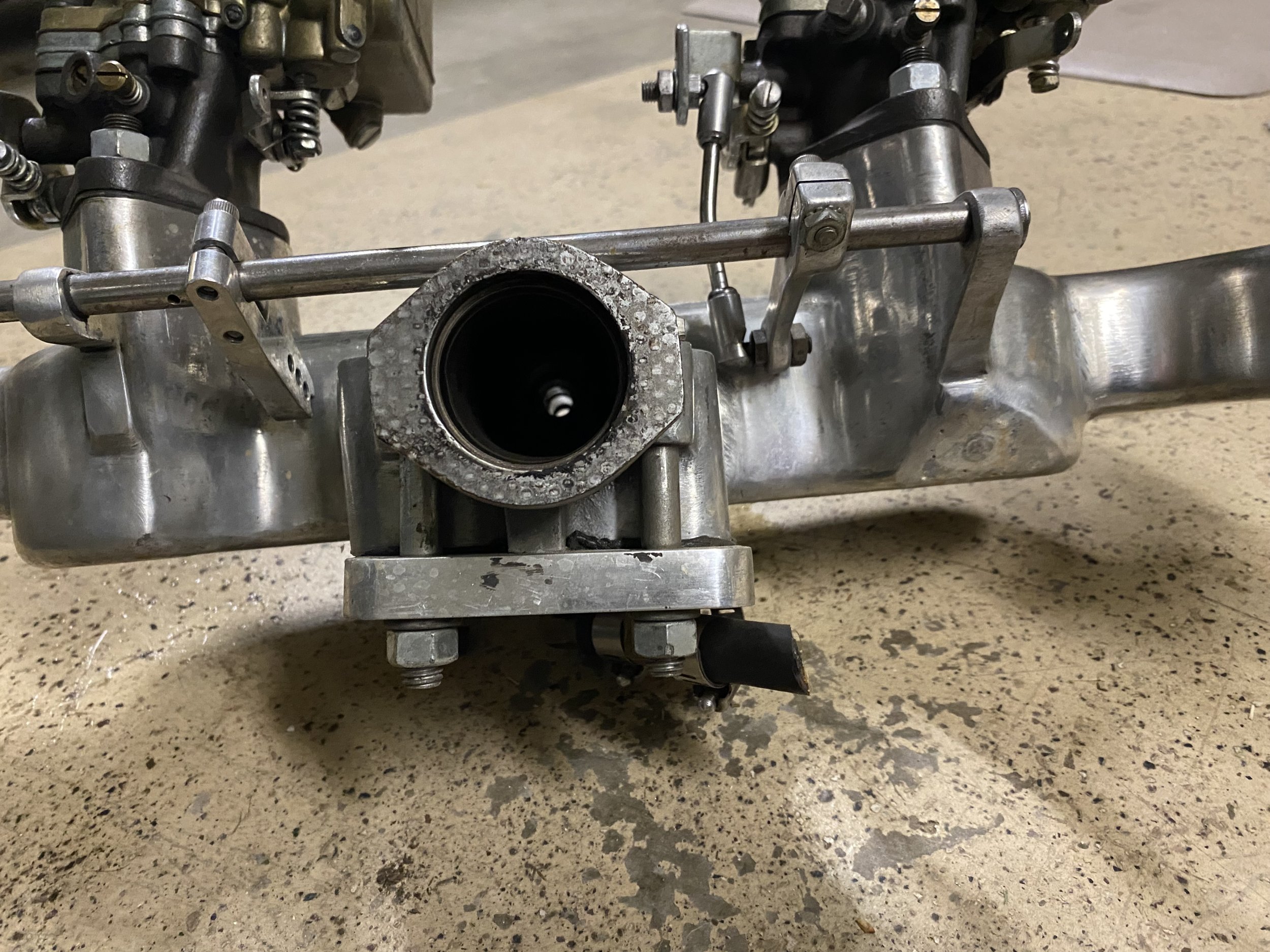

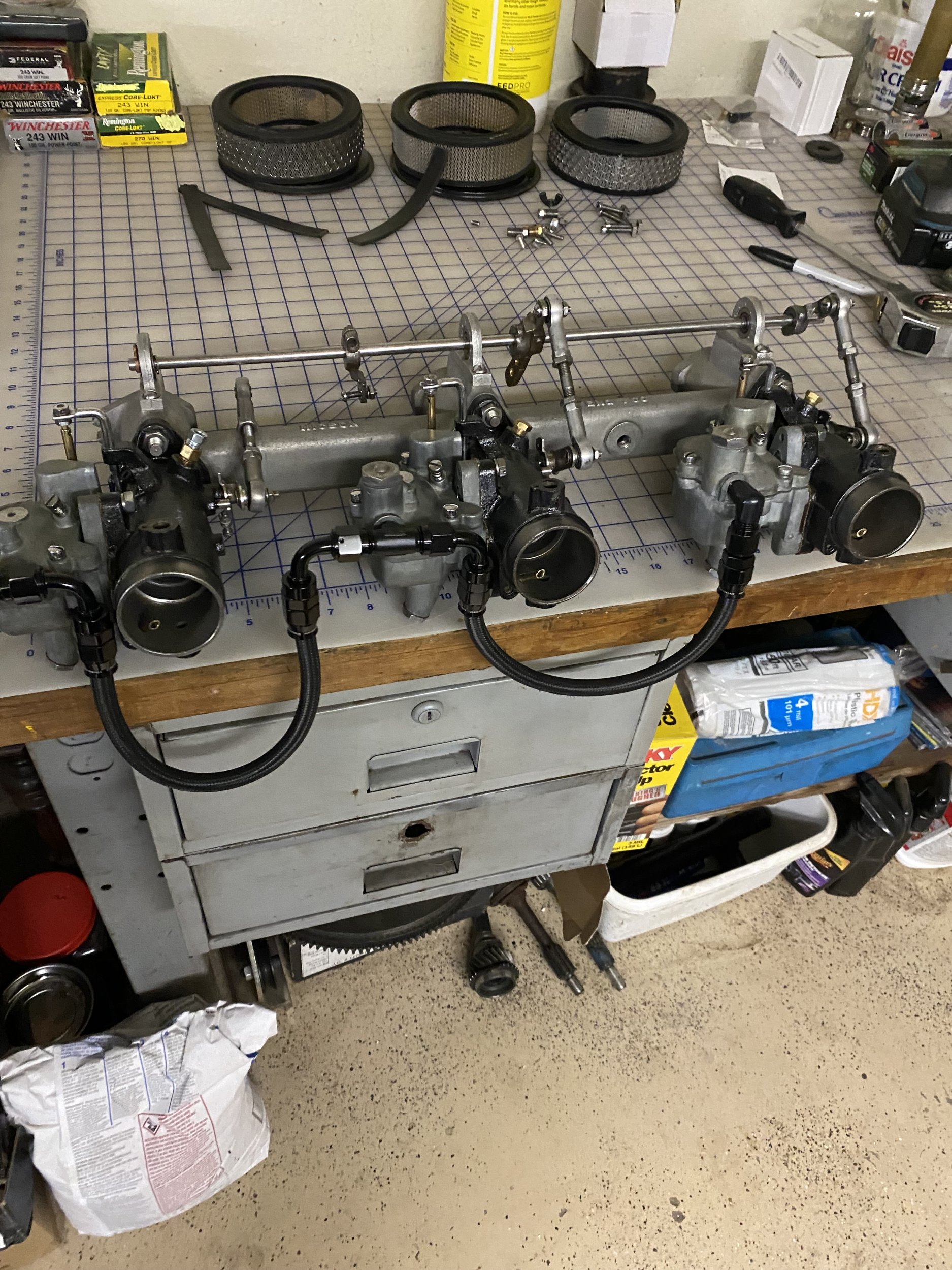

  1. This on had been clearanced many moons ago, I had to do a little more to clear the Feltons.
    I also had to clearance the Edelbrock that is on the car now.
