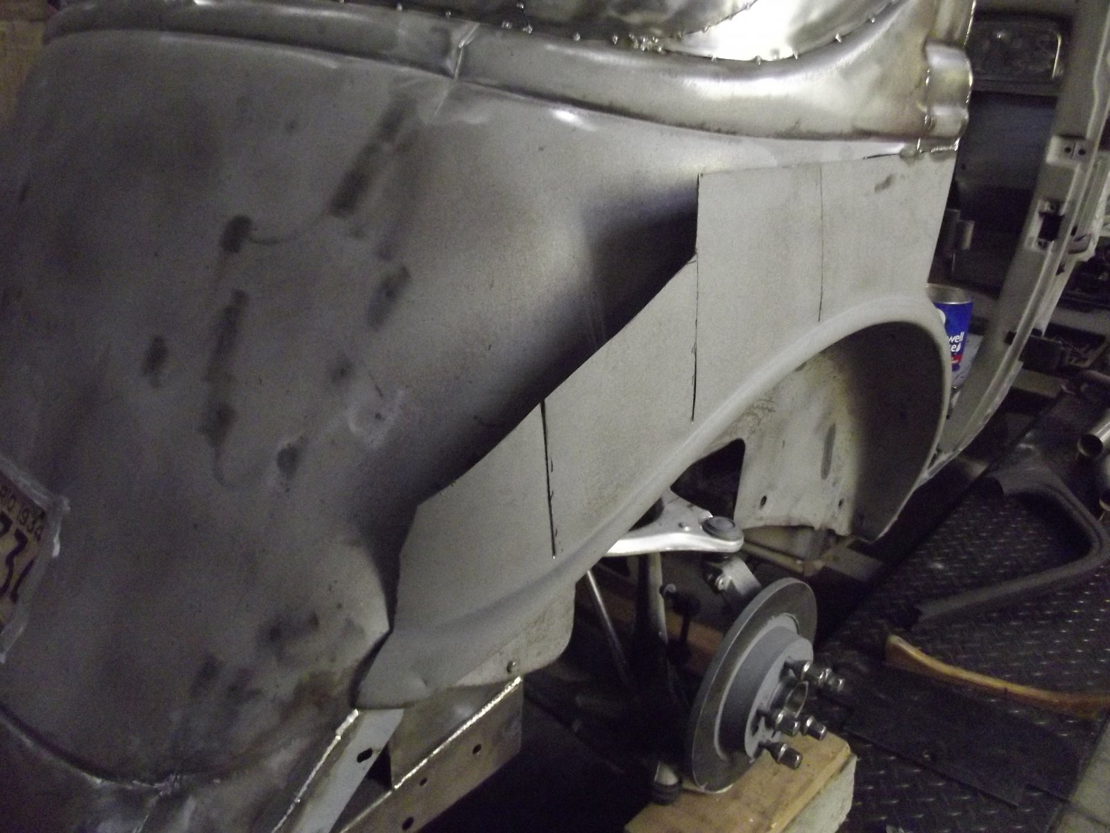

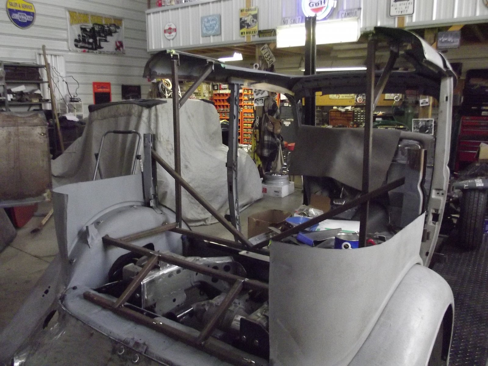

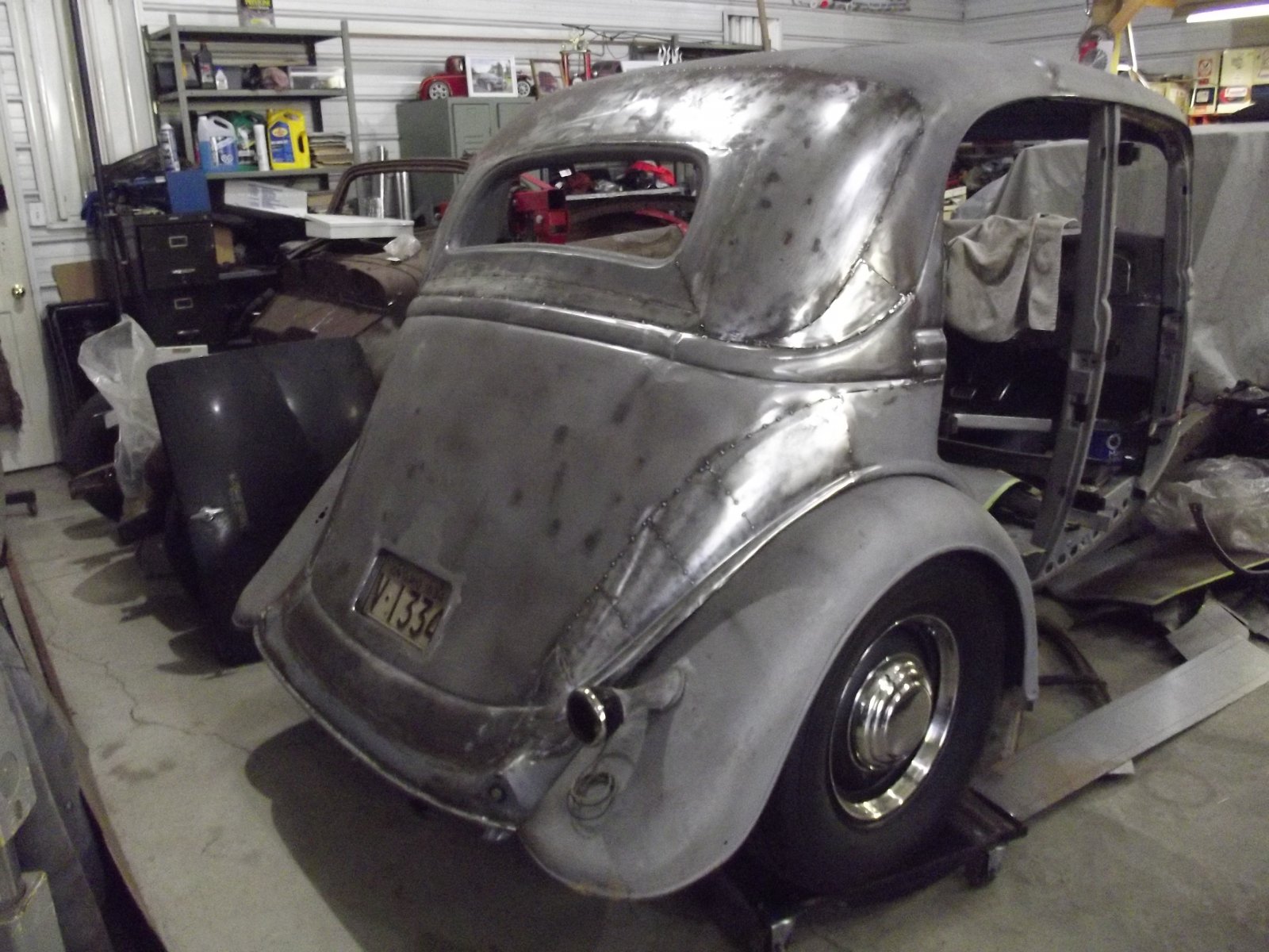

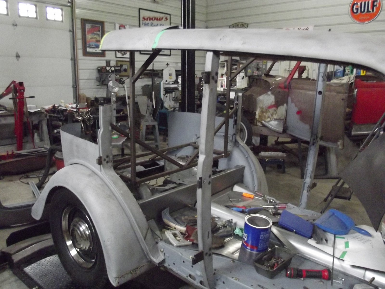

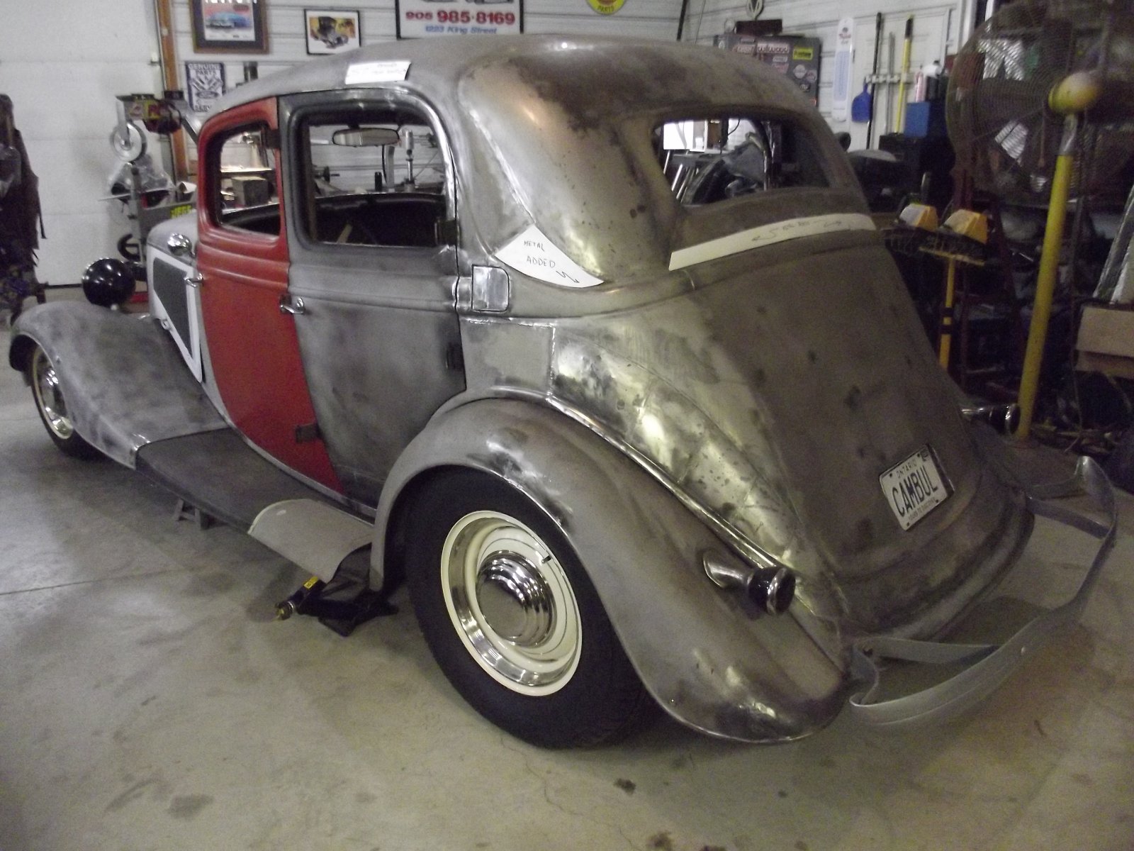

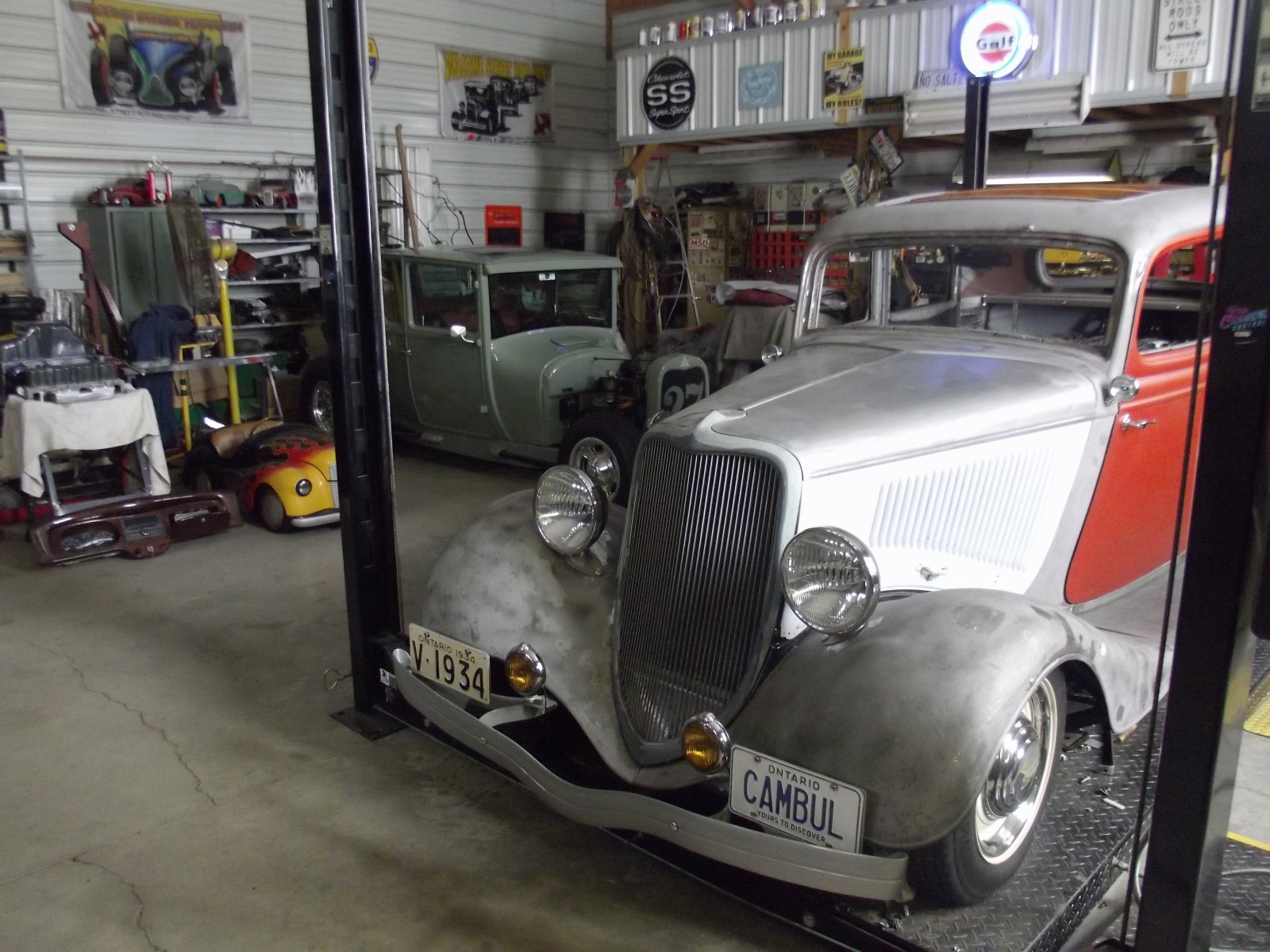

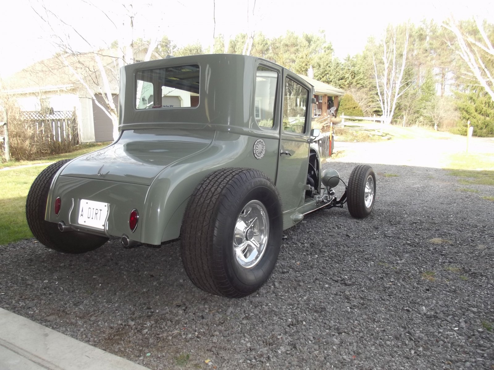

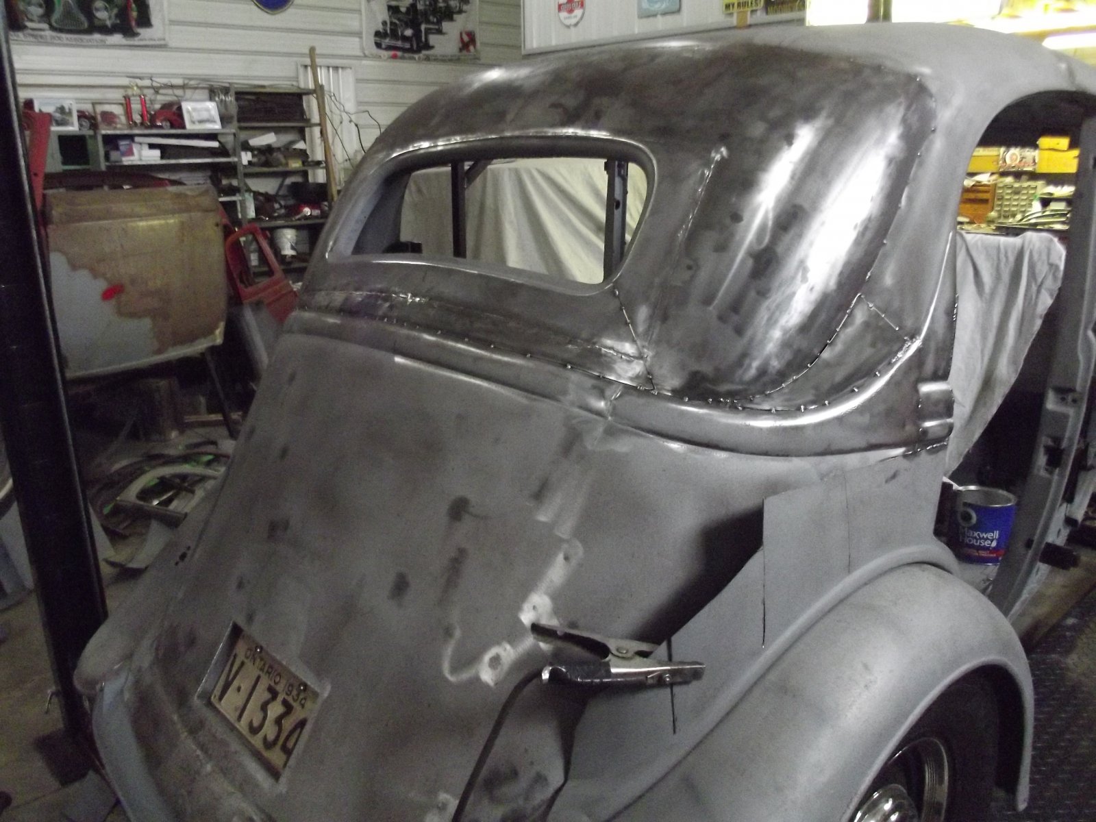

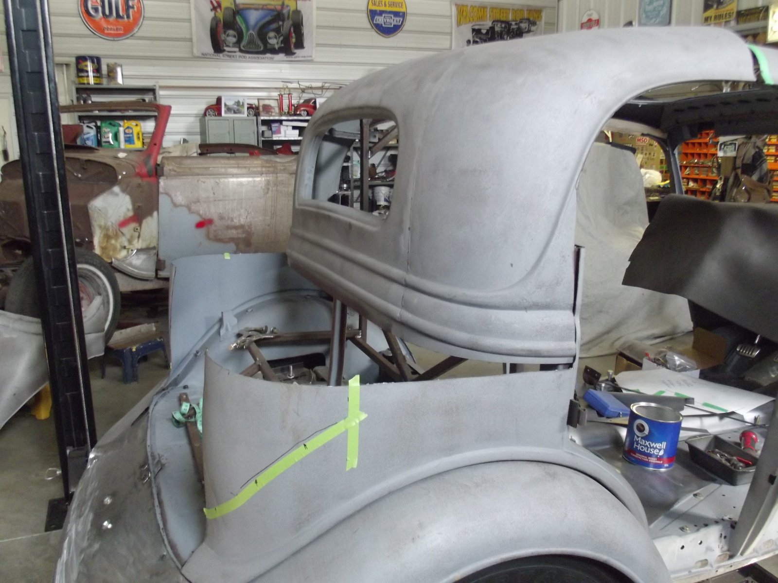

    View attachment 5360419 View attachment 5360422 View attachment 5360426 View attachment 5360427 View attachment 5360430 View attachment 5360432 View attachment 5360434 View attachment 5360438 View attachment 5360440 View attachment 5360442 View attachment 5360443 View attachment 5360449 View attachment 5360450 View attachment 5360452 View attachment 5360456 View attachment 5360457 Thanks for all the positive comments. I'm not much of a computer guy so I don't post much of what I can do. A friend talked me into this! and my wife is printing this as I speak. The '34 I'm building for my wife. Most of the rear panel from the belt line down is from a '35 slant back (good guess guys ). Above the belt line is '37 Ford with the rear window cut out and '34 replaced. The lower corners are also '37 Ford. These pieces were from rough field cars and the '35 panel was already cut off and laying in the weeds without side corners. I taped some cardboard on to show where I had to add metal. The T Coupe is mine and I built it about 6 years ago. The motor is 1962 Chevy ll . Bet most of you guys already knew that. Thanks again Mike

    I’m not into customs, but I don’t see this as a custom. I’d call it a tastefully modified Sedan!
    Cool as hell. It looks like it could’ve been an OEM design.

    I was actually doing an inspiration on your 4Dr Vicky lowering the lid a bit...no pressure...I was noting the molding being 35 meeting 34 and thinking that must have been quite a challenge for you...it sure was for me in PhotoShop...Your new pics make it clearer about what you did...

    On the topic of chopping the '34 I like chopped cars and currently own 2- the T. Coupe and a 1948 Chev Coupe that I lowered over 20 years ago. Others that I have chopped include: 33 Ford Victoria, 34 Ford 2 dr, 35 chev 2 dr., 37 Ford Coupe, 48 Chev. pickup, 50 Ford Coupe. However I'm going to leave the roof on the 34 Slant Back alone so it might look a bit more like Ford could have built this body style.
