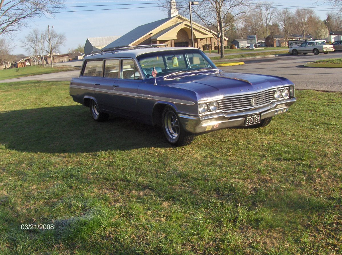

  20. H.R.P. I had a wing window that used to slam shut while driving on my 64 buick station wagon. Since i was working so much back then,I just stuck a piece of card board in there to keep it open. I finally found the time and pulled the door panel off and I was lucky the spring and nut had just worked it way loose I guess from all the use it had. Bruce. HPIM0439.JPG
