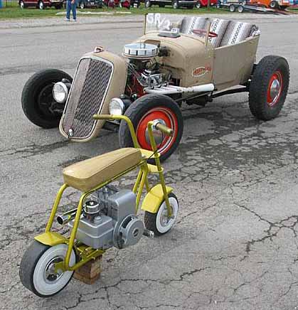

  15. I just painted this Mini Bike last monday. House Of Kolor, old lacquer candy lime gold. I was hoping it would be golder, but I still like it. Dean
  16. 67Imp.Wagon
    Joined: Jun 16, 2001
    Posts: 1,191
    67Imp.Wagon
    Did you just paint those whitewalls on the minibike? It looks cool.
  17. Yes I did. Krylon Fusion spray paint. You gotta clean the tires real good. I did a post about doing whitewalls on full size car tires awhile back. Pretty much the same deal, except I didn't grind the sidewall smooth on the Minibike. Dean
