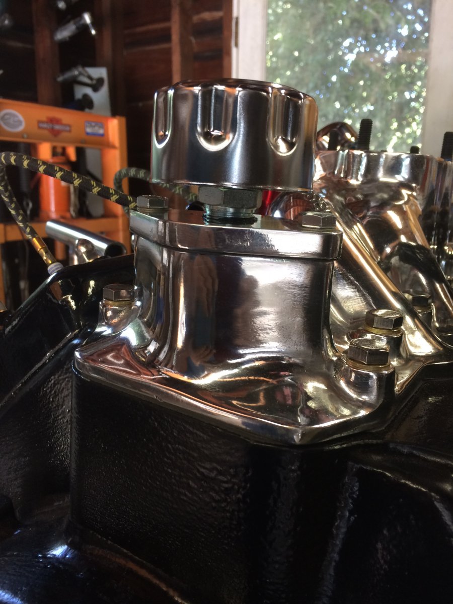

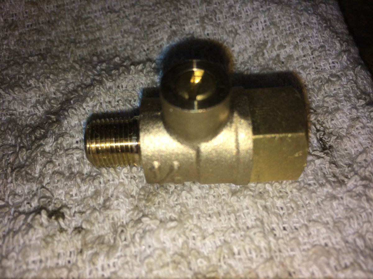

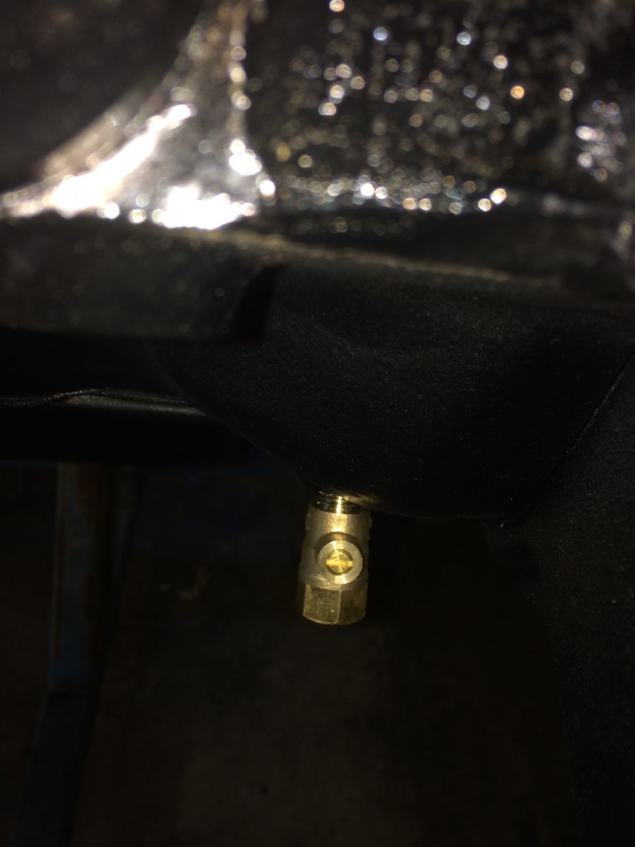

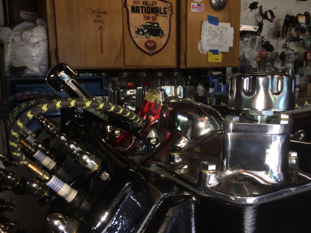

    image.jpeg image.jpeg image.jpeg image.jpeg image.jpeg I was dinkin with my motor today and got to thinking about some of the neat ideas hotrodders come up with for using "non-automotive" items to serve a useful purpose. There are some pretty fart smuckers out there, using odd ball items or tricks to accomplish a means. If you have any neat tricks or adaptions I would like to see them. Here are a couple I used today and what got me to thinking about this.
    Item 1
    If you have an engine that has water drain ****s, here is what I used. These are test ****s from a backflow preventer. You can get them in 1/8" and 1/4" NPT and are quality items. The screw slot turns a teflon seated ball and absolutely will not leak. Any backflow supplier carries them.....very clean and neat...I was able to orient the screw slot to access from above instead of having to crawl underneath to operate.

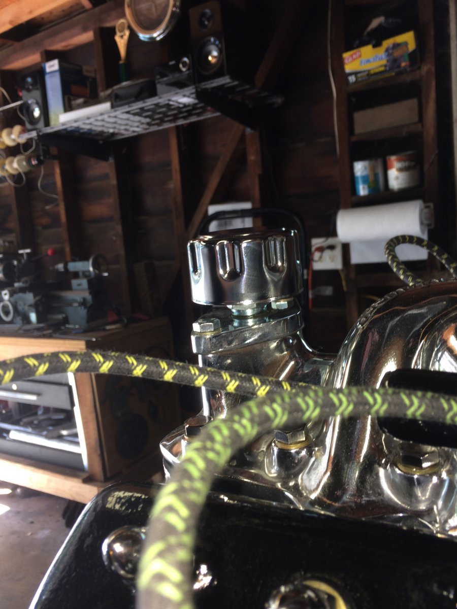

    Item 2
    I just installed a PCV valve in my flathead V8 and needed a breather for the blockoff plate I made where the fuel pump used to mount. This is an industrial clean air breather for an air compressor. You can get it with 1/2", 3/4" and 1" NPT.
    I ordered this one from Graingers in 1/2" NPT and got it next day. Made a blockoff plate, drilled and tapped and screwed right on. Absolutely free breathing with no resistance at all. No need for replacement filter unit as the whole thing was only $9.00.
    If you have any tricks or non-automotive materials that can be used in a hotrod. I aint talking about saw blade air cleaners for rat rods or such, but actual useful stuff.

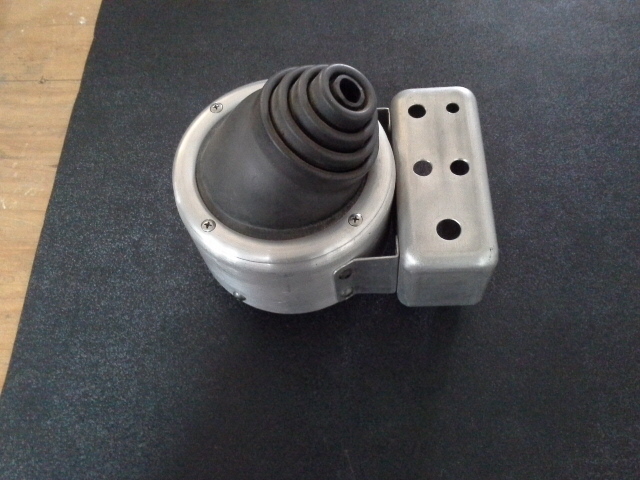

    Wasn't having any luck finding a shift boot to to clear the Hurst shifter in my roadster.
    I was at my local speed shop one day and found this old boot hanging on a hook in the corner, cheap enough so bought it, but it didn't look like it would work so I threw it in a drawer and I forgot about it.
    I had seen guys were using modified frying pans for brake cooling shrouds and thought what the hell so went down to the thrift store and found a neat little cast aluminum saucepan. I chucked it in the lathe and bored a big hole in the bottom and also turned off the nub that the handle mounted to. The rubber flange of the boot needed t******* and I machined a trim ring out of aluminum stock and it worked great.
    I didn't want switches mounted in the dash and was at the electronics surplus store and found this neat little enclosure so modified it and screwed it to the side of the shift boot riser with a couple pieces of aluminum flat stock bent to fit.

    Pretty crafty stuff there Denny, my Dad would have said now you are using your head for something other than a hat rack

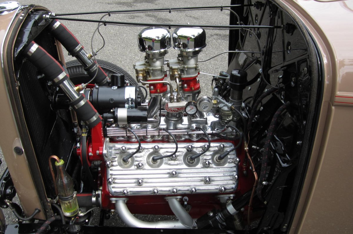

    Vintage thick gl*** Squeeze soda bottle for my radiator overflow!:cool:

    Very ' Sano ' engine detail stuff, like your twice engine temp wires

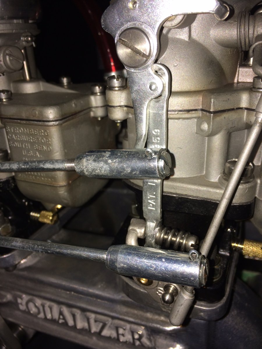

    Thats right...here are a couple Ace Hardware drawer pulls pressed into service for my choke rod and starter rod.

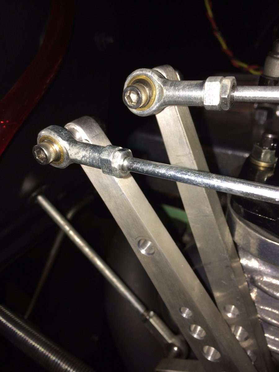

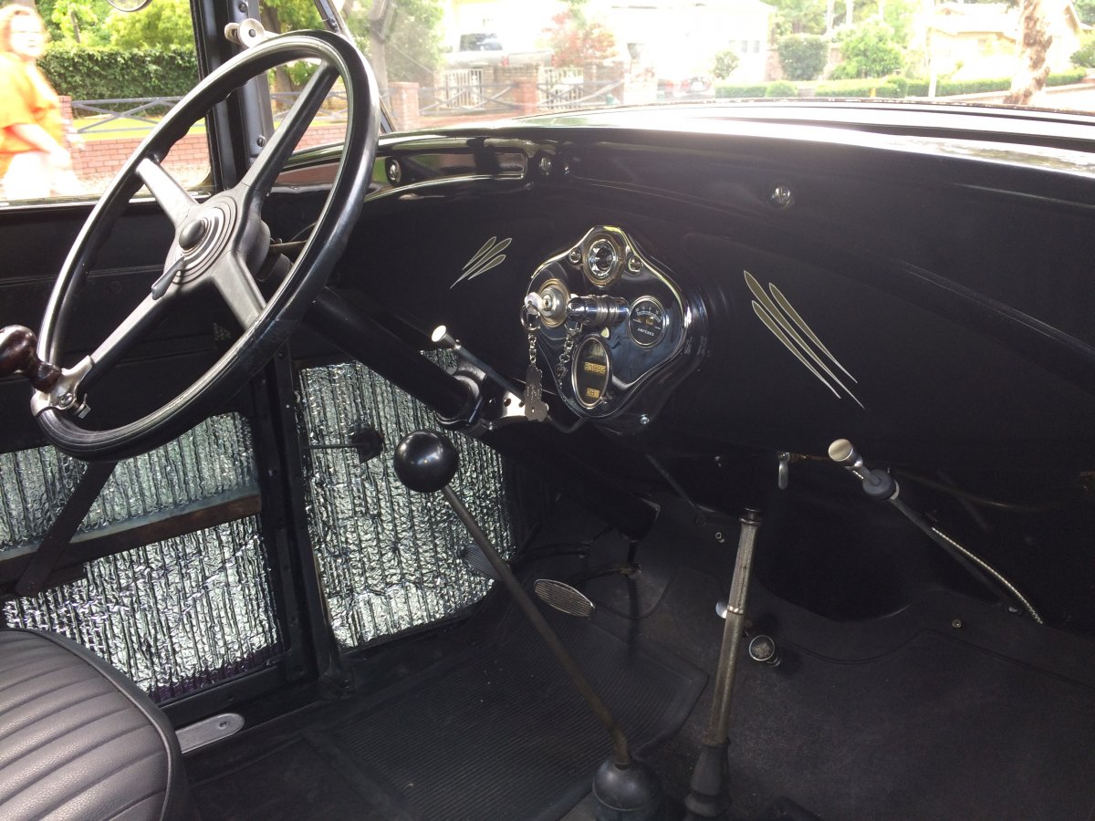

    Thats the best way for linkage....did the same on my tudor....very clean.

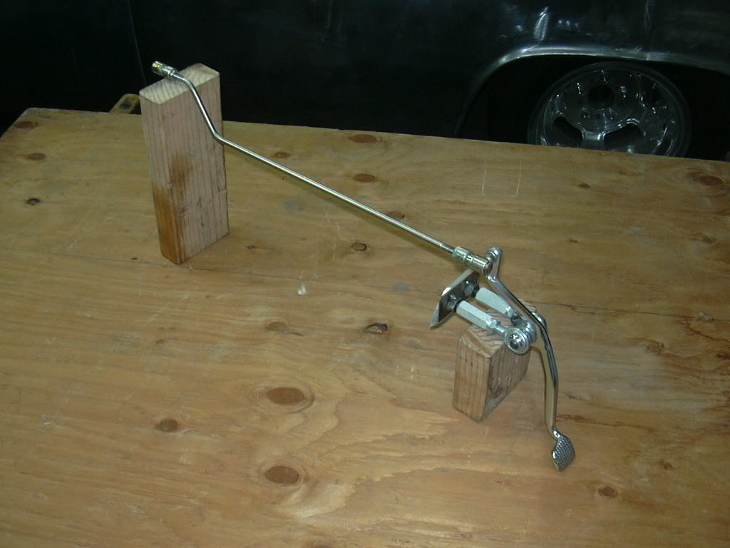

    If we keep this up Danny, we will put the 1-800 vendors out of business.
    This started out as a "repurposed" Honda bike brake pedal.

    I see both these every day, especially the breather. We use them on hydraulic tanks. Nice Ideas, Thanks for posting them.:)

    Now THAT I LIKE!! VERY nice DDDenny! I gotta start hitting the motorcycle section at the swaps!
