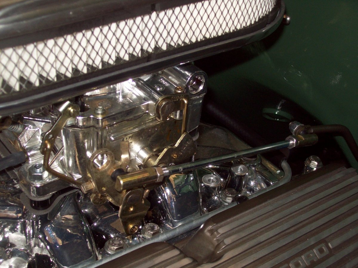

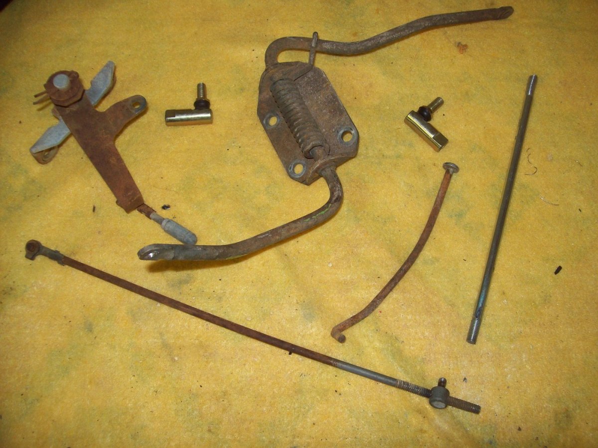

    I'll post the pedal in our wagon,I thought about using the aftermarket aluminum pedal because of ease of application but after I mounted it for mock-up it looked out of place so I did a lot of modifying some original equipment to make it work with my application.
    I'm certain other mid 50's cars have something similar if you are looking for a original look and feel.
    I used the spring loaded firewall mount and the slightly bent accelerator rod,I also purchased the two swivel mounts and a new rod,the rest of the parts were null and void with the new setup.
    Using the original V8 throttle mount made it possible to omit the return springs since this piece has a heavy return spring built in.
    This photo shows the 3 pieces I picked up at ACE hardware,cut and fit in place.
    I was able to purchase a new accelerator pedal from Dennis Carpenter and also a new clutch & brake pad so everything looks stock even though the clutch are is heavily modified to work with the clutch cable. HRP

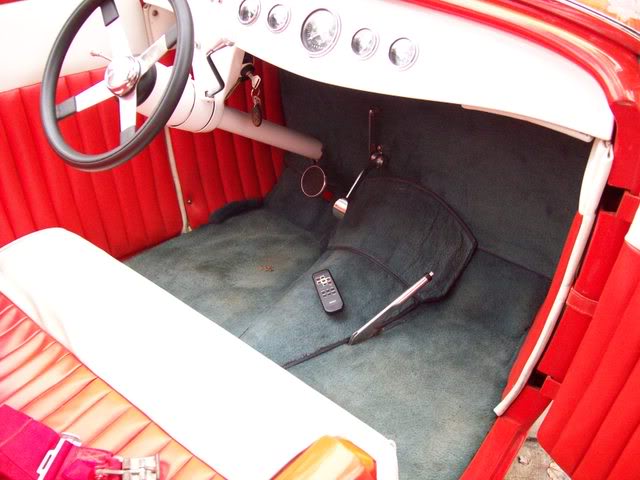

    The old roadster had the aftermarket s****. HRP

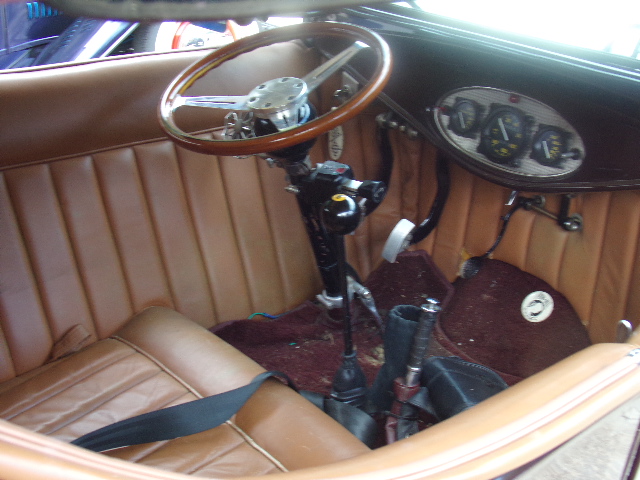

    Used in my Model A. 66 Buick Riv pedal ***embly slightly modified for alignment and a s**** added. Aluminum housing mounts on engine side of firewall with spring from bracket attached to top of arm. Large top head is for mounting micro switch for SP400 trans and rod to carb. S**** is home made and welded on and dressed up purdy. Gas pedal - side view.JPG

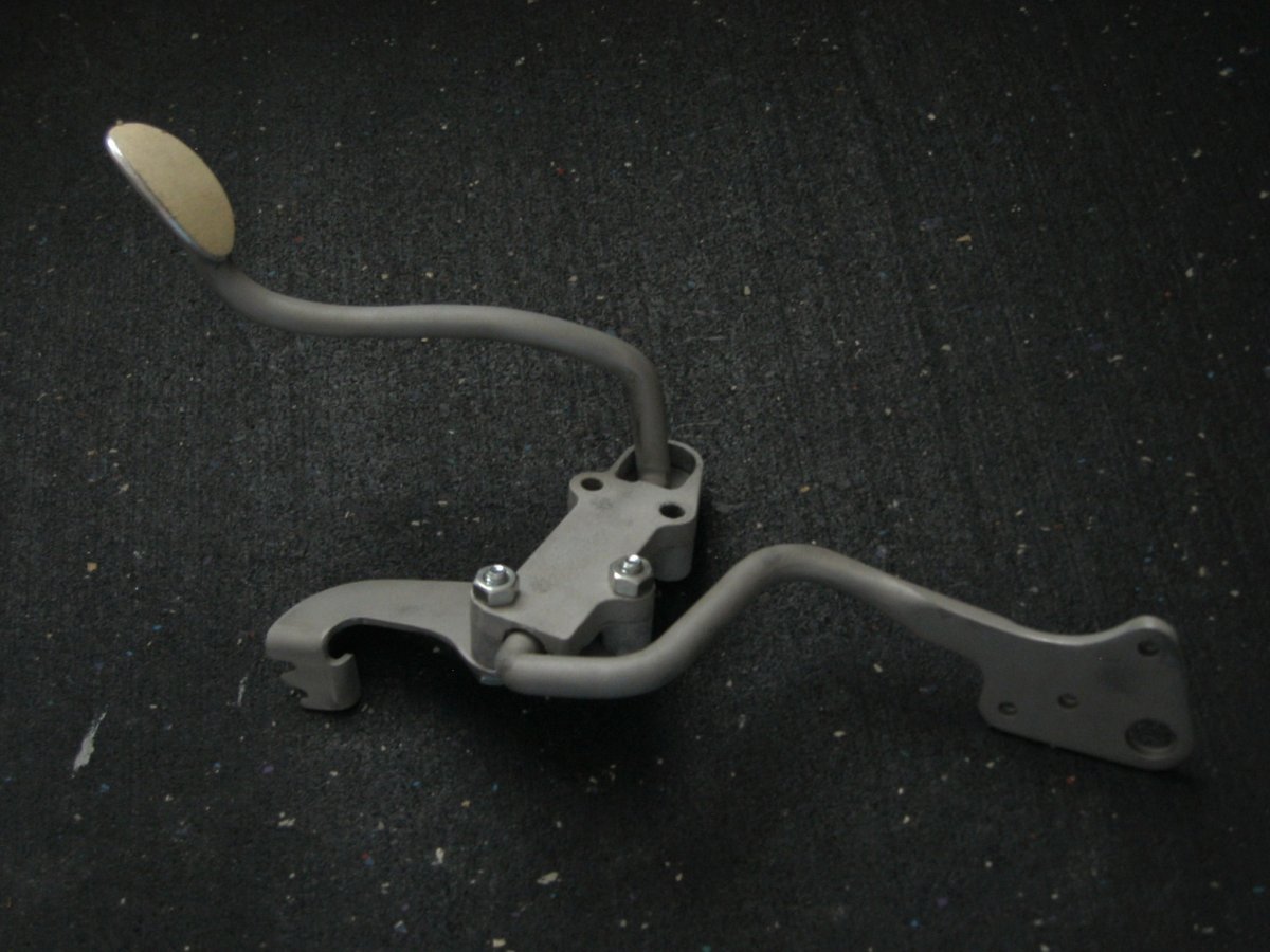

    I'm told this is from a mid 60's falcon. HRP

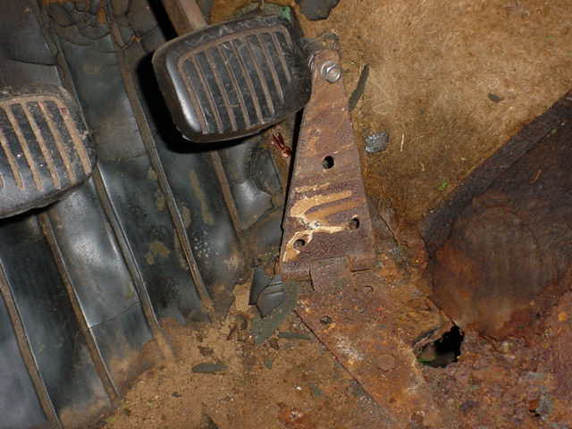

    I have told the story in the past how the wagon was purchased new off the show room floor and was used to haul tools and make delivers for the Jessies flower shop,then it was p***ed to Brenda's dad and then to us,it had been used & abused from day one and we used the car for several years before being parked in the barn for more than 20 years.
    During Clyde's ownership he used the wagon for camping,hunting,fishing or hauling concrete block,he tied ladders & boats to the top.
    On one of his many camping & fishing trips the throttle pedal broke and he saw a old abandon barn that was falling apart and he was able to pull a old hinge off and use it as a gas pedal,this stayed on the car until i pulled it out of the barn to rebuild...I still have the hinge hanging on the wall. :D
    This was done a necessity to get home,you might also notice there is a hole in the floor. HRP 54floor-vi.jpg
