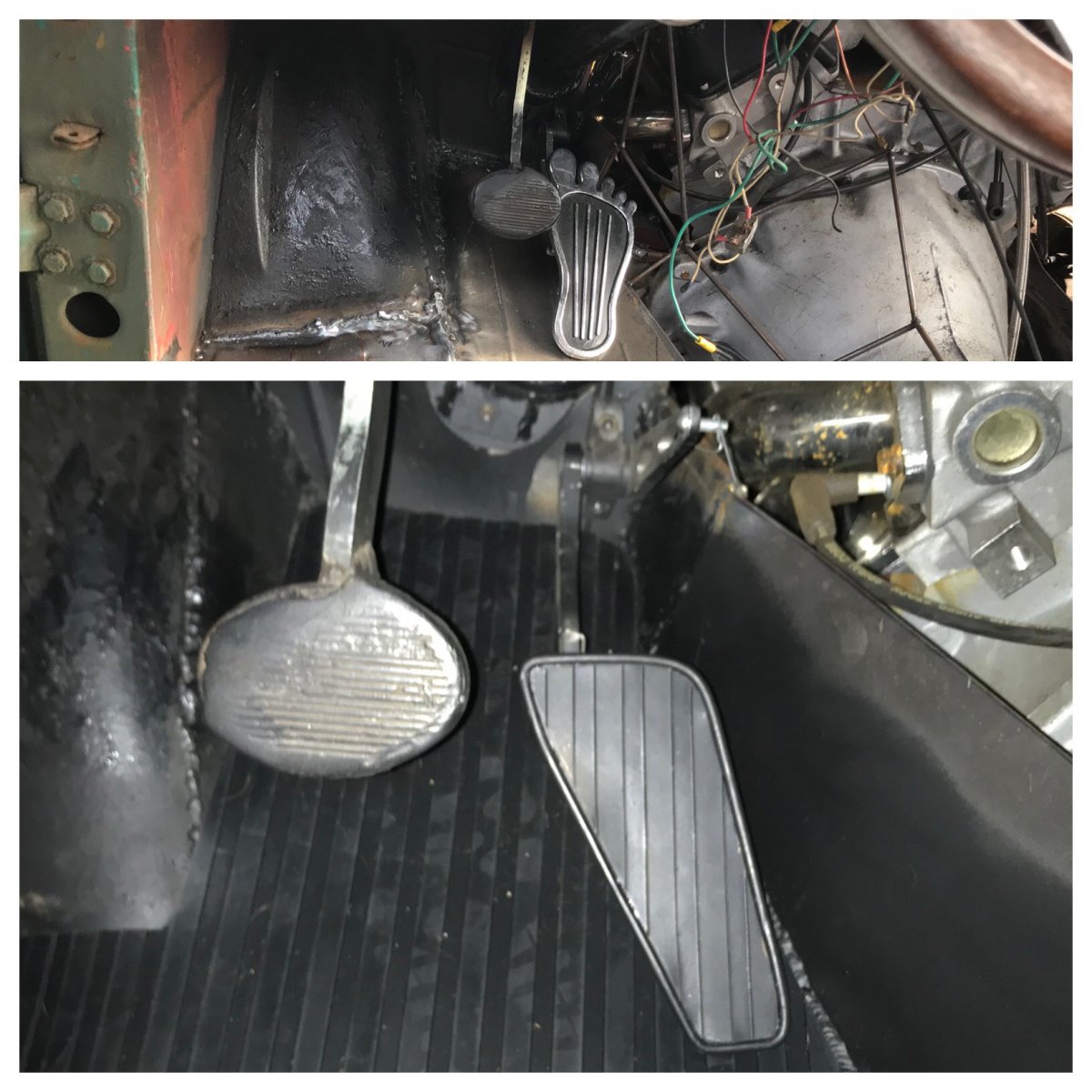

    A couple of my home made pedals. One thing I've learned is not to detail or paint a gas pedal 'til I get some actual long distance seat time with it. The spoon in my '36 is, I think, is the 4th try and is now painted. I think it's a keeper. The other is in my Henry J.

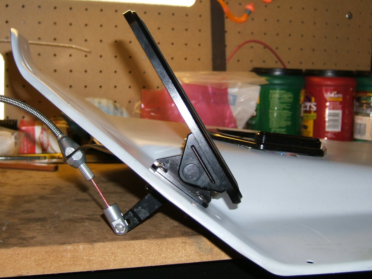

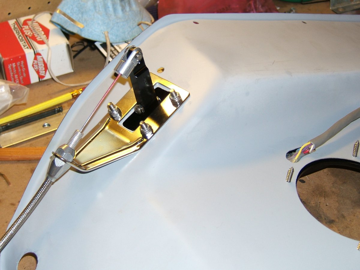

  5. I used a Lokar pedal in the '48 Ford F4 I'm restoring for a friend. I wanted to use the original pedal but couldn't figure out how to get it connected to the carb and open the throttle fully. Here are some pics of the mock up and final installation.

    Hivolt , my 36 Ford has the same pedal. I replaced the stock Ford pedal when I changed my induction. I find that the Lokar pedal is very uncomfortable because it pivots at the bottom , as the pedal gets pushed to WOT, you have to kinda raise your foot off the floor to compensate for the funky angle. My 2018 project is to rework and reinstall the stock one , it just works better. Mitch.

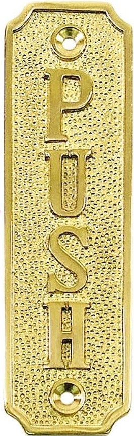

  9. I have this stashed away somewhere to screw onto the surface of the too fresh looking Lokar that came already in the "project" collecting dust in my garage.....
    push.jpg Meanwhile, I'm keeping my eyes peeled for suitable brass belt buckles for the other pedals.

  10. Mitch, I agree with you. The hinge point on the Lokar pedal makes it odd when going full throttle, but this F4 is going to be more of a "parade vehicle" so the pedal should be fine. Other than the odd hinge point, the pedal is nice and functions well. When I build my '52 F2 I'll probably look for a different pedal solution though.

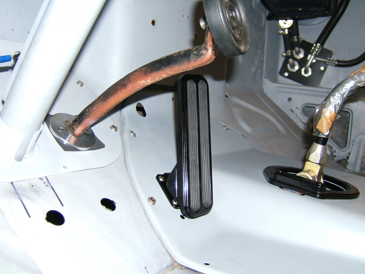

  18. Hitin the Streets 044.JPG I didnt like the way this one felt....

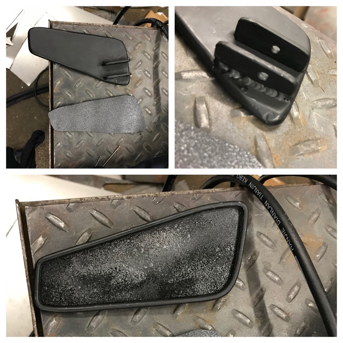

    E4BC4D7B-CC54-450C-9C95-03FD41999153.jpeg D55B7129-1A0D-47F6-8C92-82A7B533C512.jpeg tigged some round stock around a shape, glued rubber in the recess
