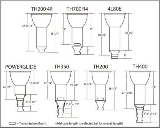

    Here's a cool chart that may answer your questions regarding sizes, lengths and identifying
    shapes of various automatics. I always remembered that the Turbo400 pan looked like the
    outline of Arizona...
    alanp561, chryslerfan55, rod1 and 3 others like this.
  26. squirrel
    Joined: Sep 23, 2004
    Posts: 59,940
    squirrel
    huh...lived here most of my life, been playing with TH400s for over 40 years, and never noticed!

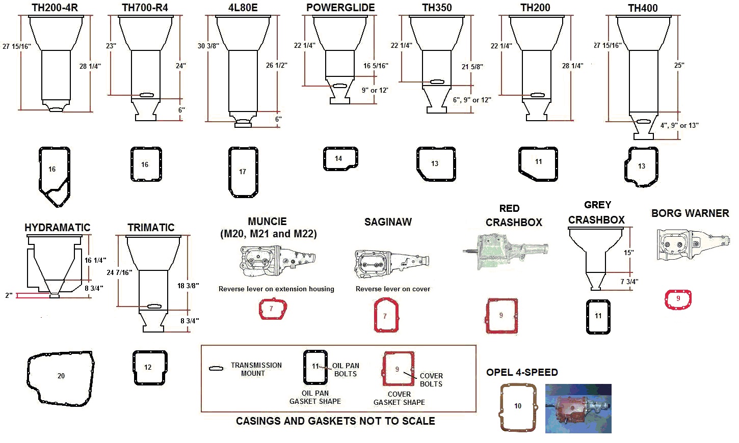

    Back when I was younger (but no wiser :D) I modified that diagram to show the pan gaskets, and included the local Aussie boxes:
    Cheers,
    Harv
    AHotRod, Ned Ludd, alanp561 and 8 others like this.
  28. Bob Lowry
    Joined: Jan 19, 2020
    Posts: 1,603
    Bob Lowry
    Nice, Harv! Much better!! Thanks, Bob
