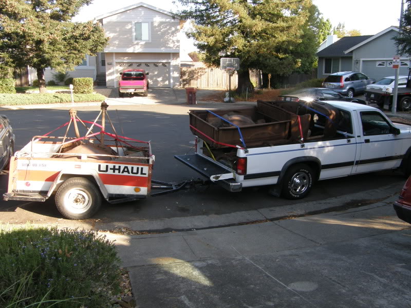

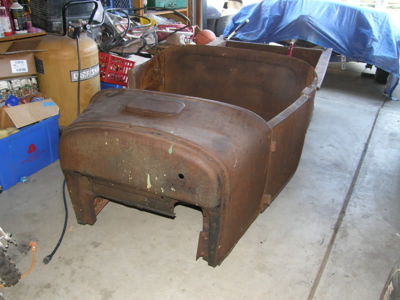

    It all started with a Craigslist ad. He was selling this '27 RPU and a bunch of parts for $800. It was 150 miles away but I jumped on it!
    Rented a small U-Haul trailer, hooked it to my truck and headed south. Came back the next day with gold!

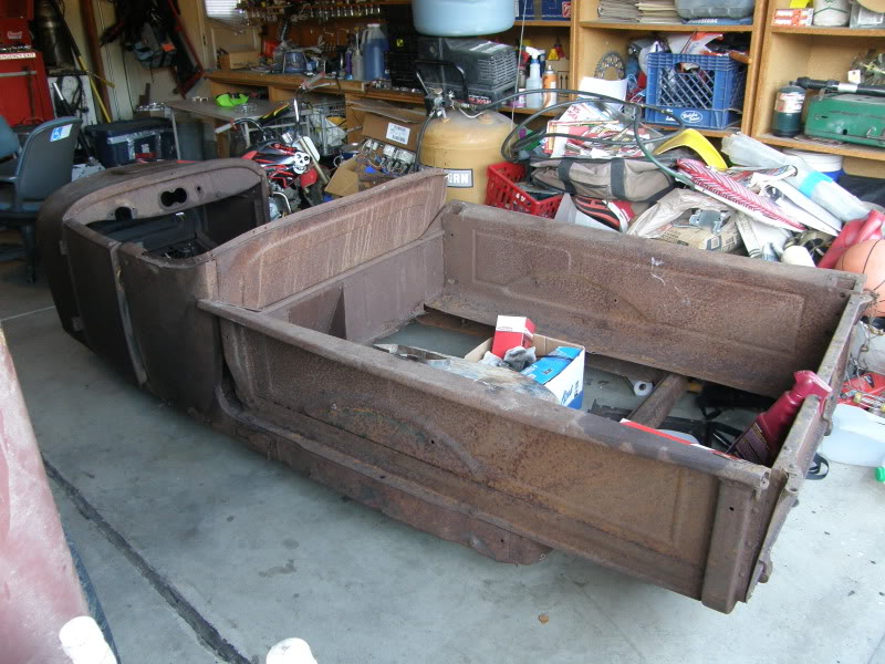

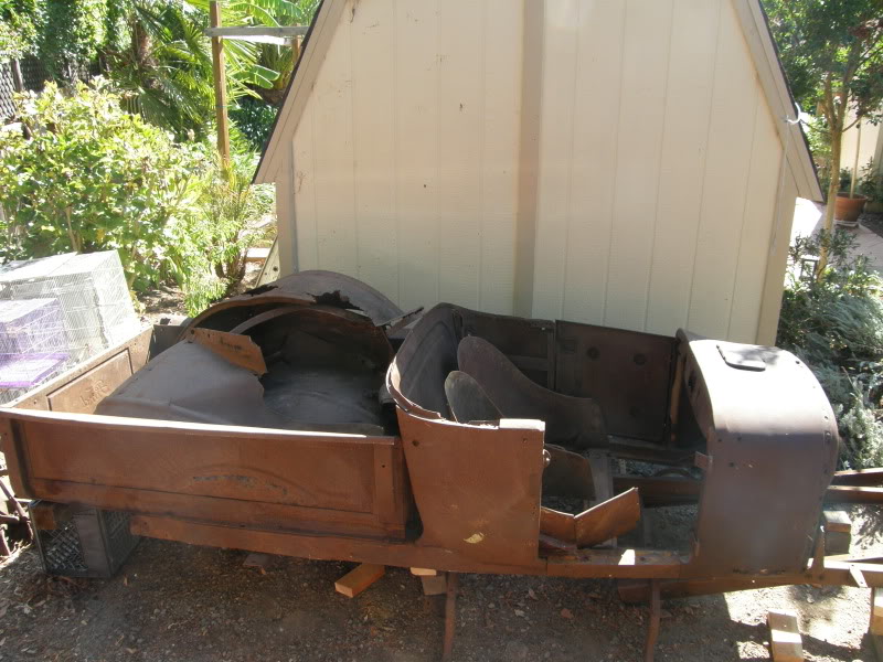

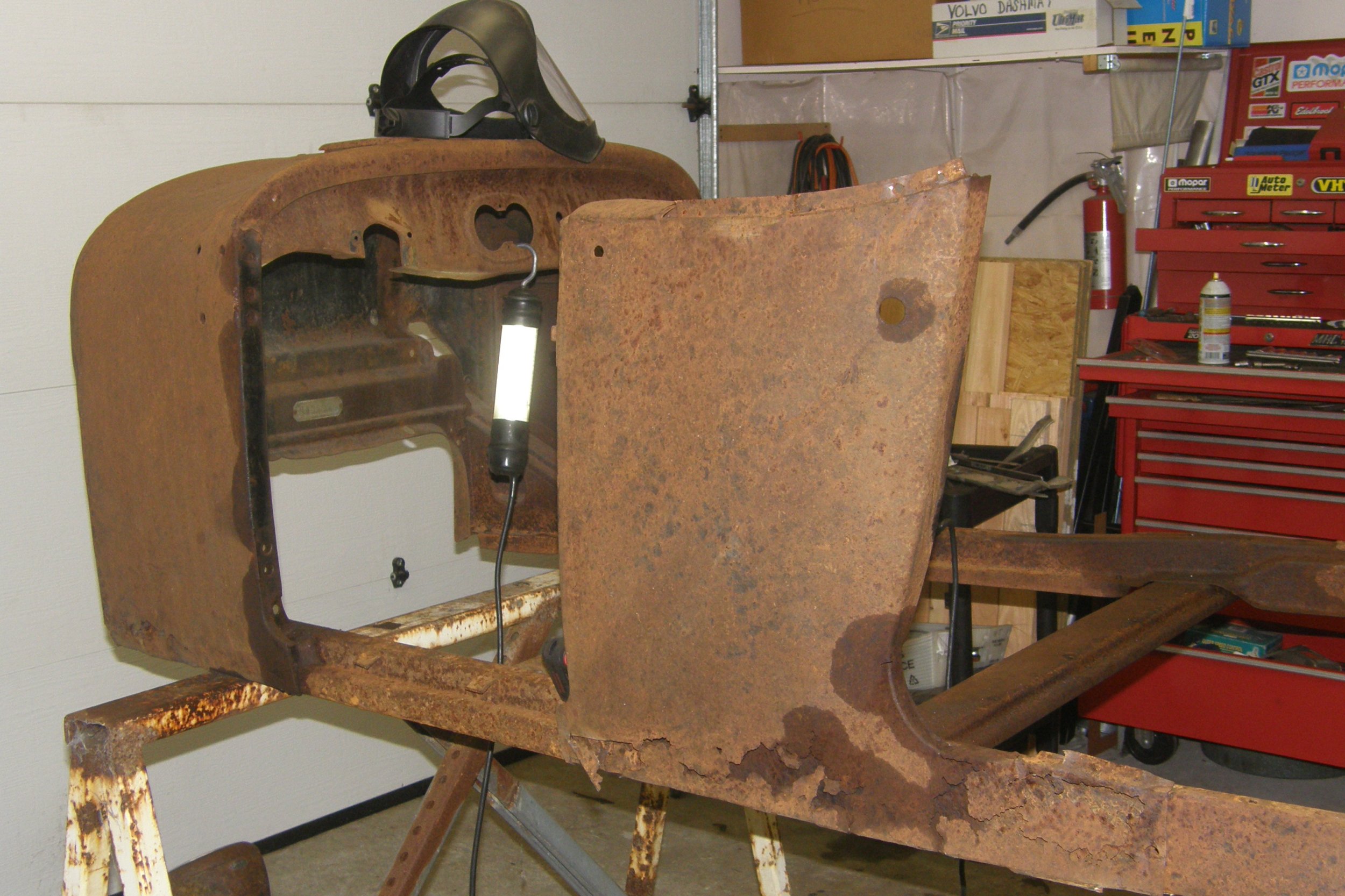

    Began tearing down the body......

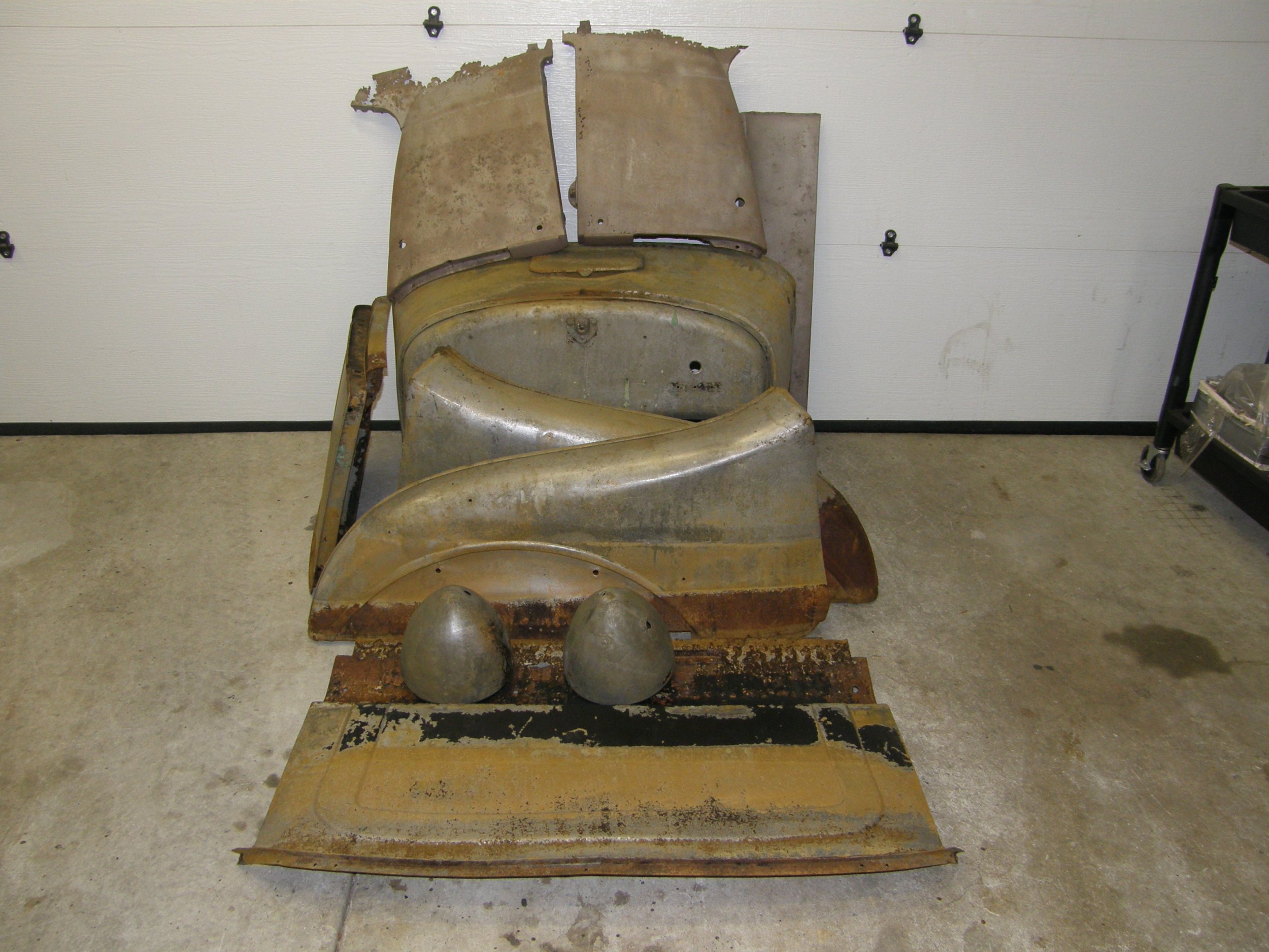

    Was able to trade the pickup bed straight across for a turtle deck, minus the decklid. And yes, it came with 2 quarter panels.

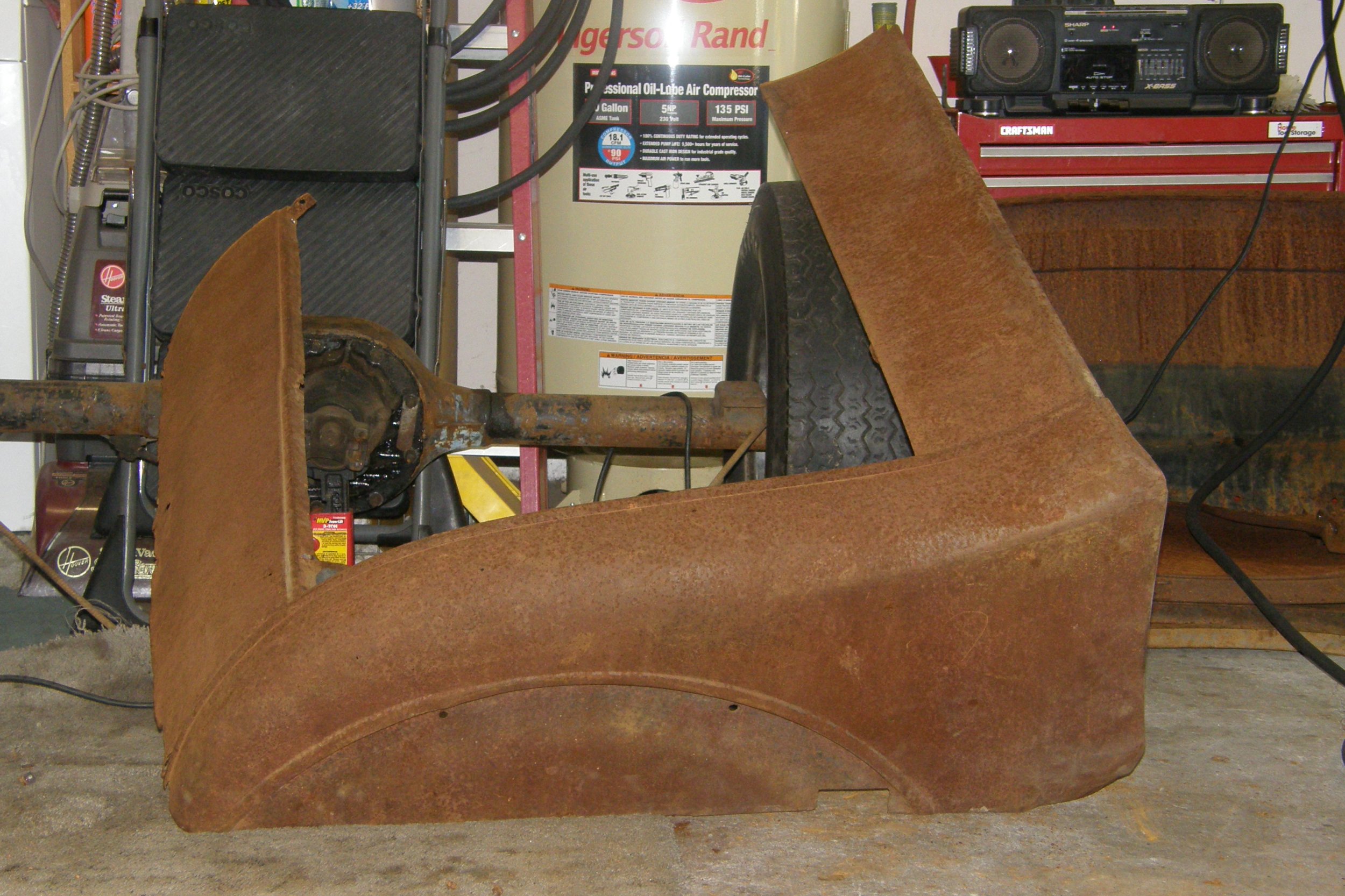

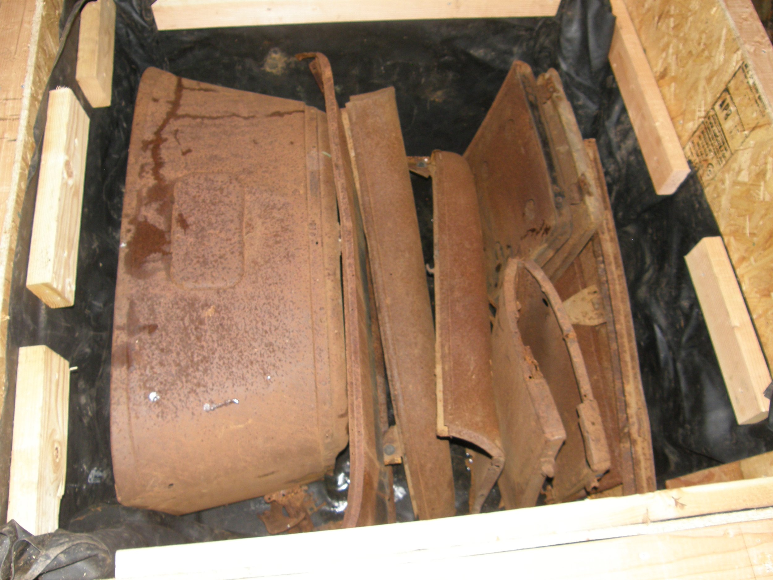

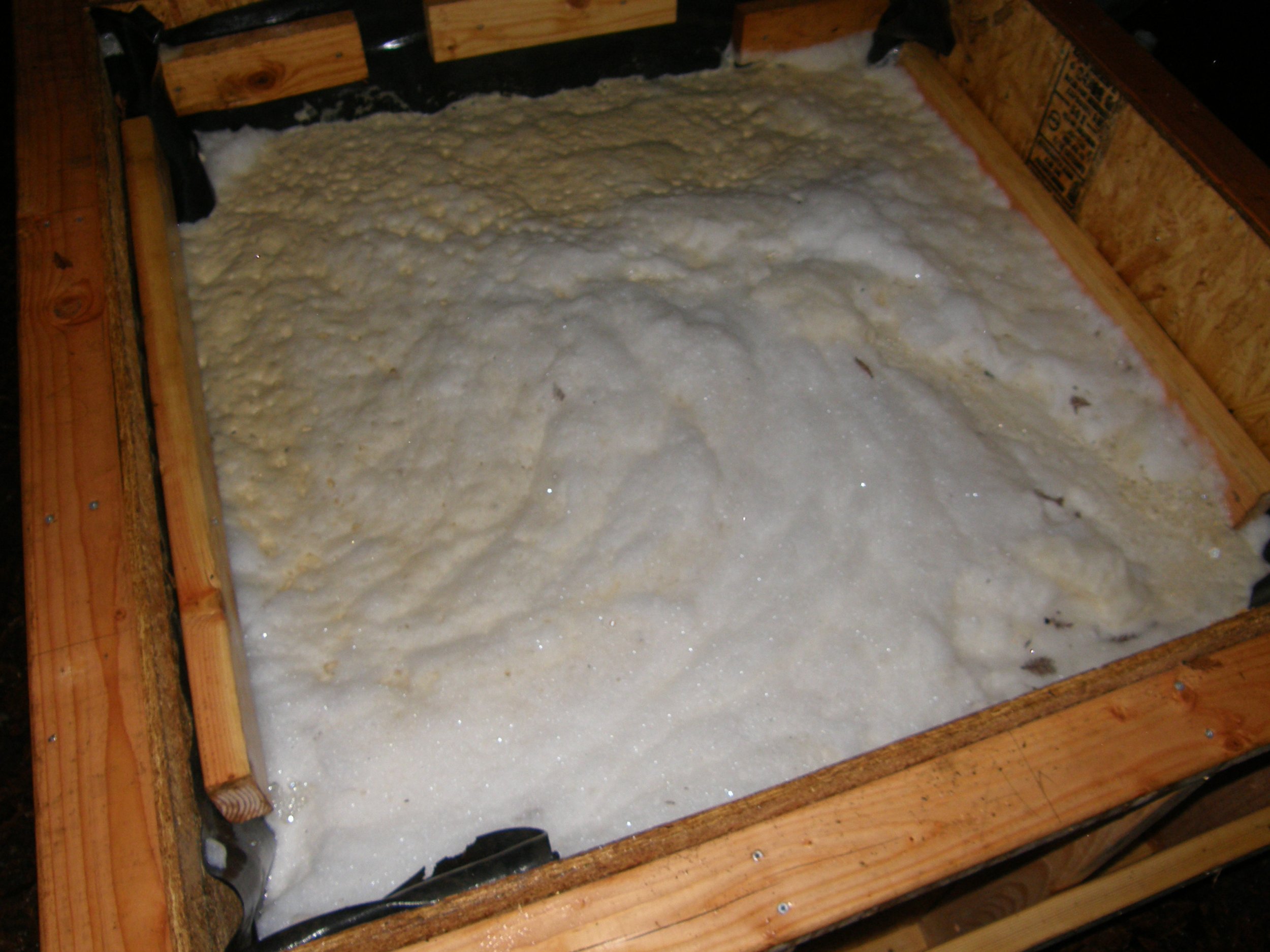

    De-rusting time! Built a 4'x4' box, set the body pieces in place and filled it with a mol***es and water mix......
    The results speak for themselves!
    Here's a full write-up on the process I did back in the day. https://www.jalopyjournal.com/forum/threads/rust-removal-the-miracle-of-mol***es.557996/

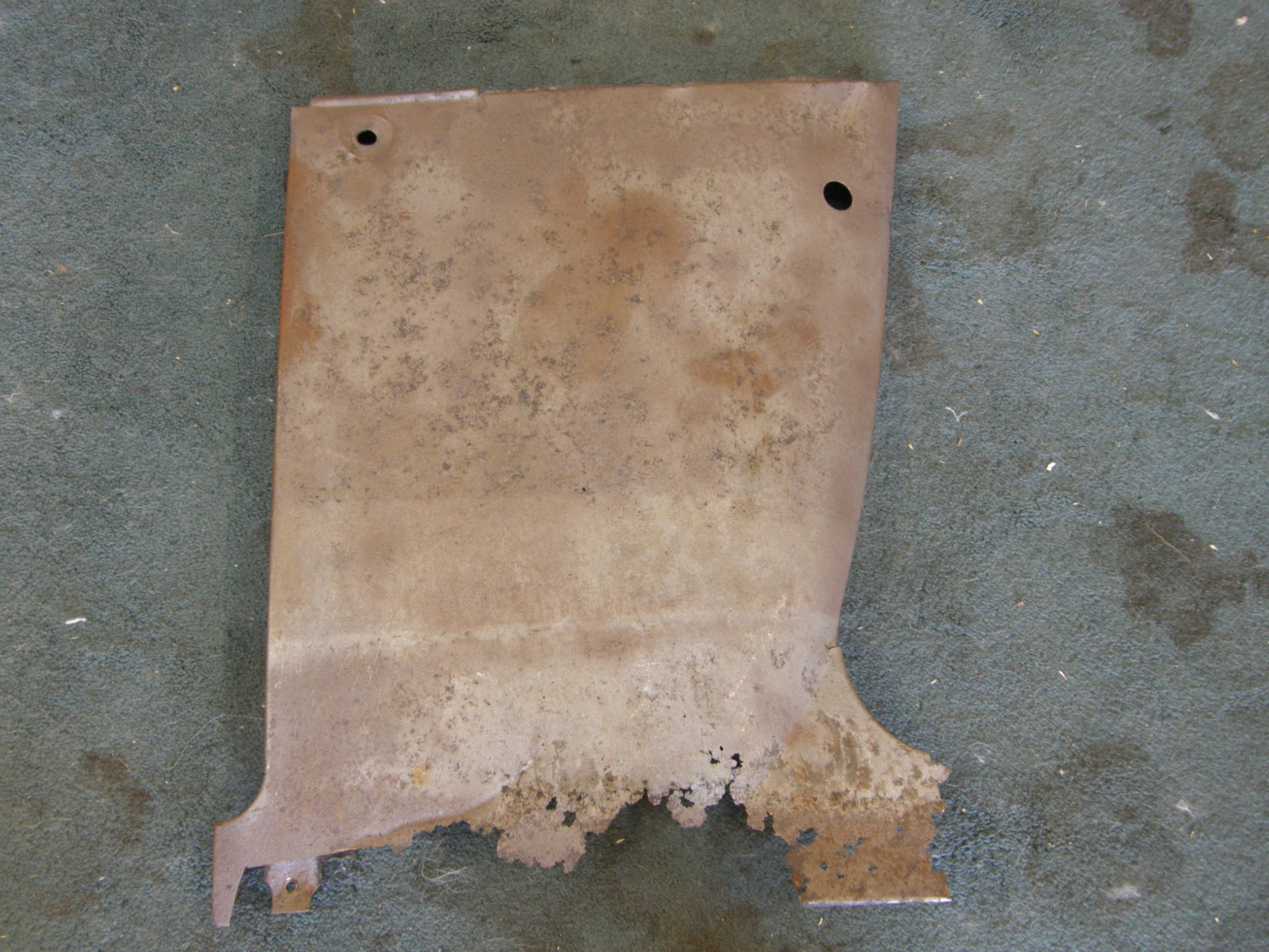

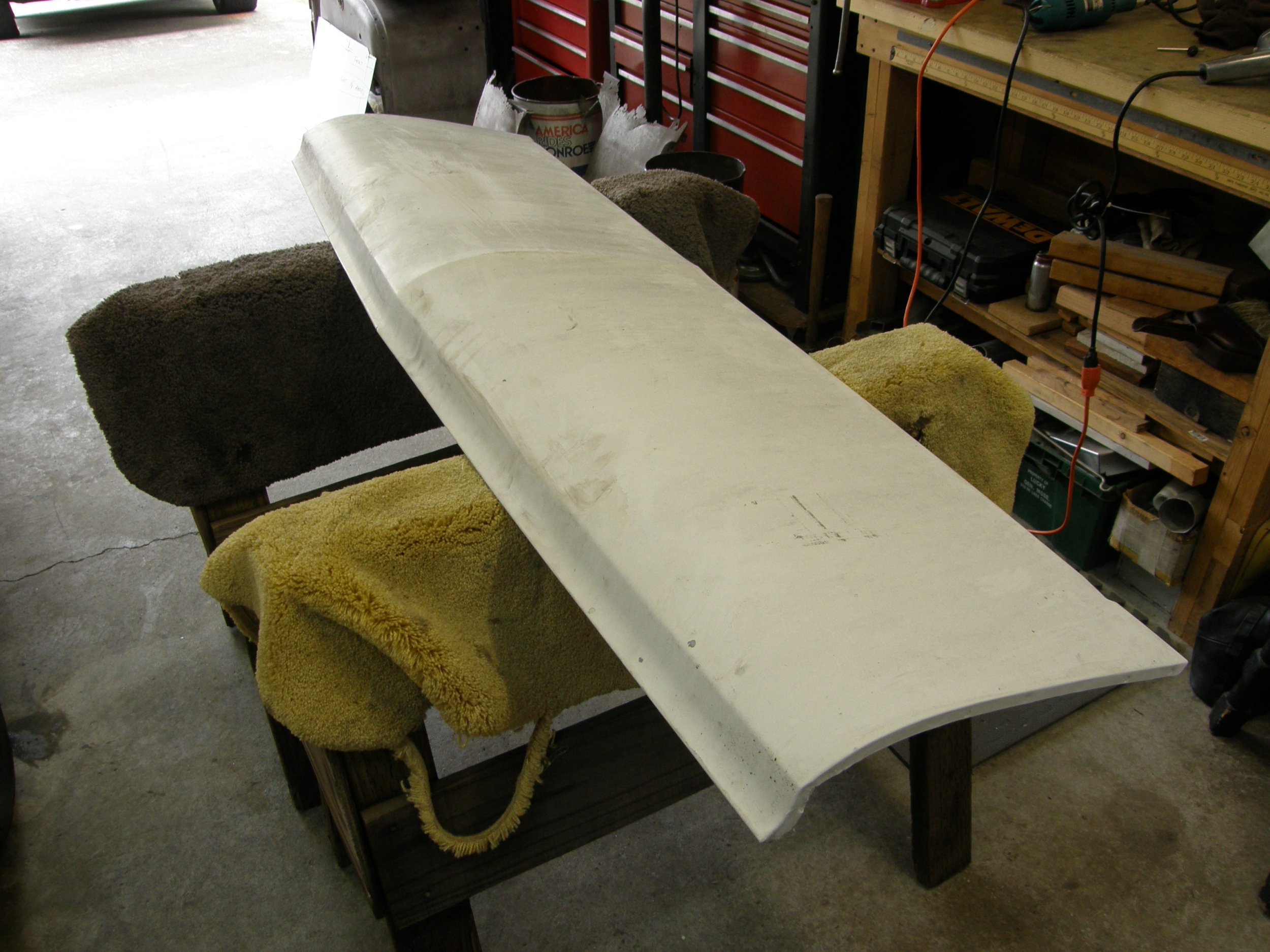

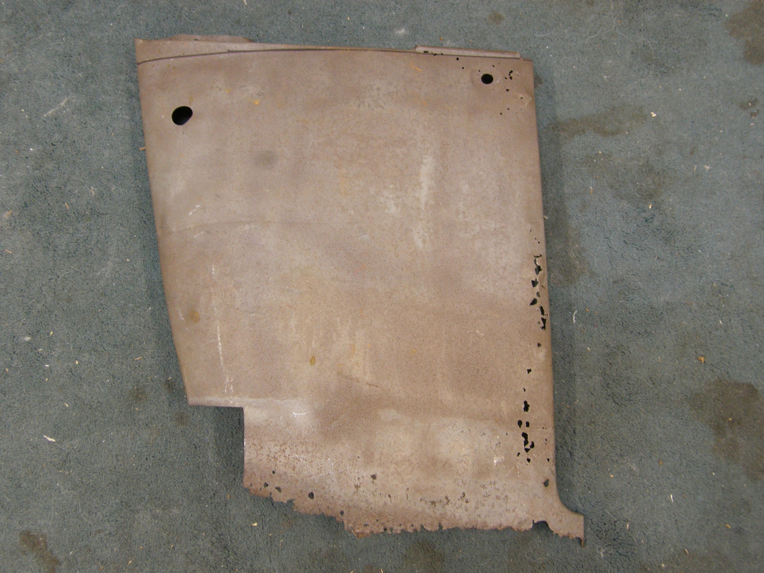

    After de-rusting, the bun panels were deemed unuseable......

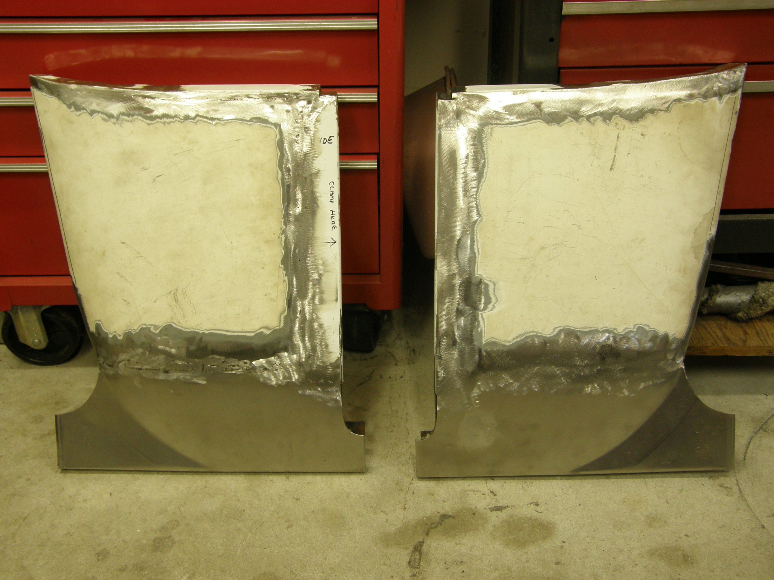

    So...I decided to make my own. Scouring Pick-N-Pull, I found the hood from '80s & '90s Chevy vans have just the right contour......
    Yep....it worked!

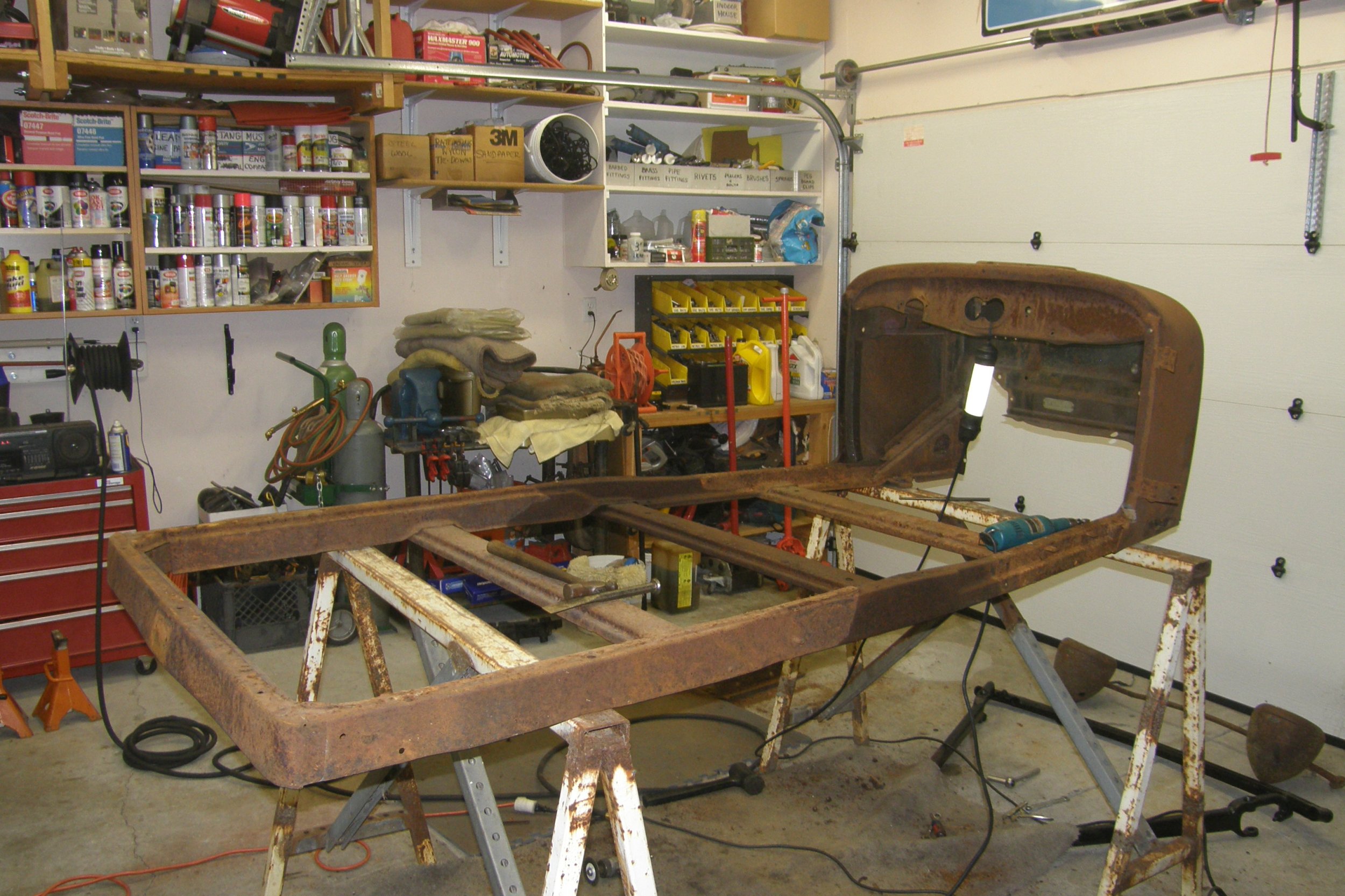

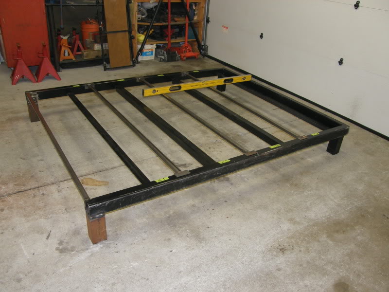

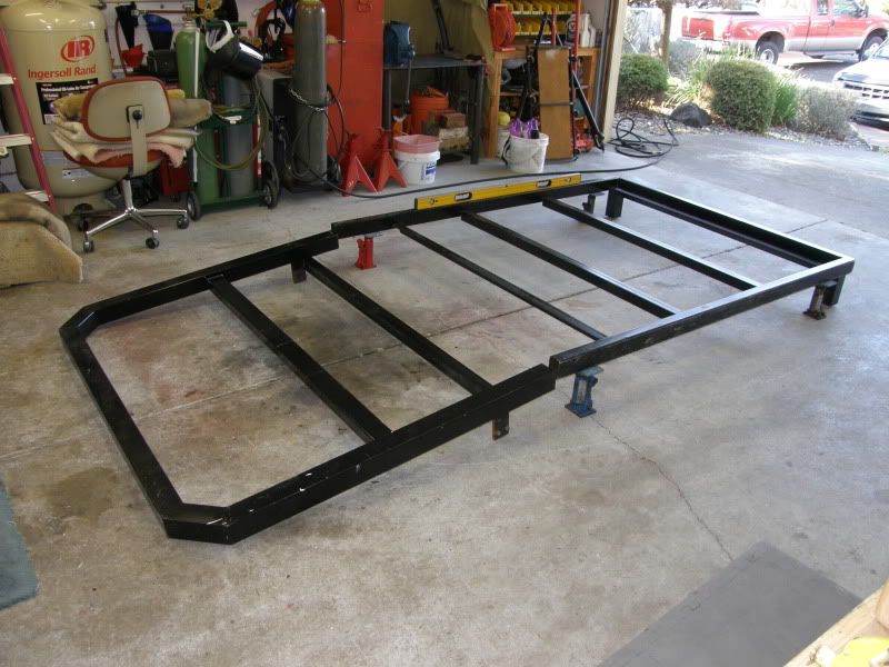

    Frame time! A friend called me and said he just bought a king sized bed frame off CL and it wouldn't fit through the door of his apartment. Asked me if I wanted it. Absolutely!
    Made a couple of mods and I had me a frame table!

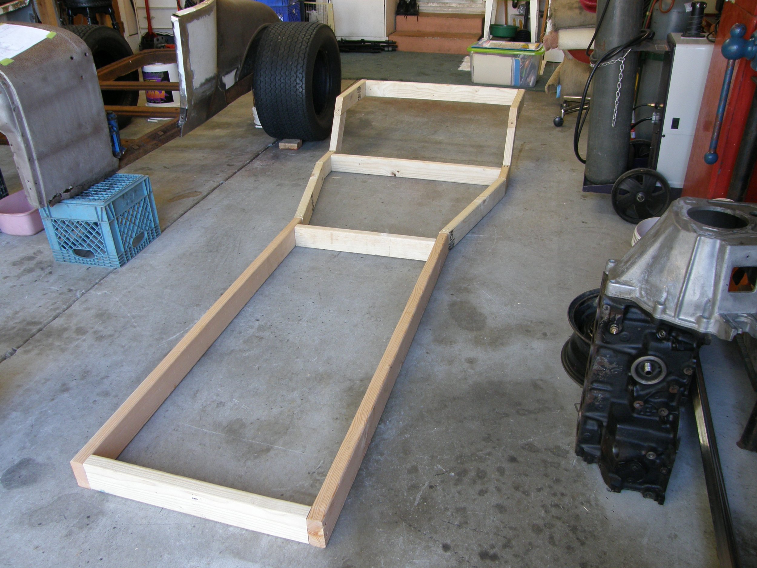

    First off, I made a wooden mockup of the frame to get the dimensions right.

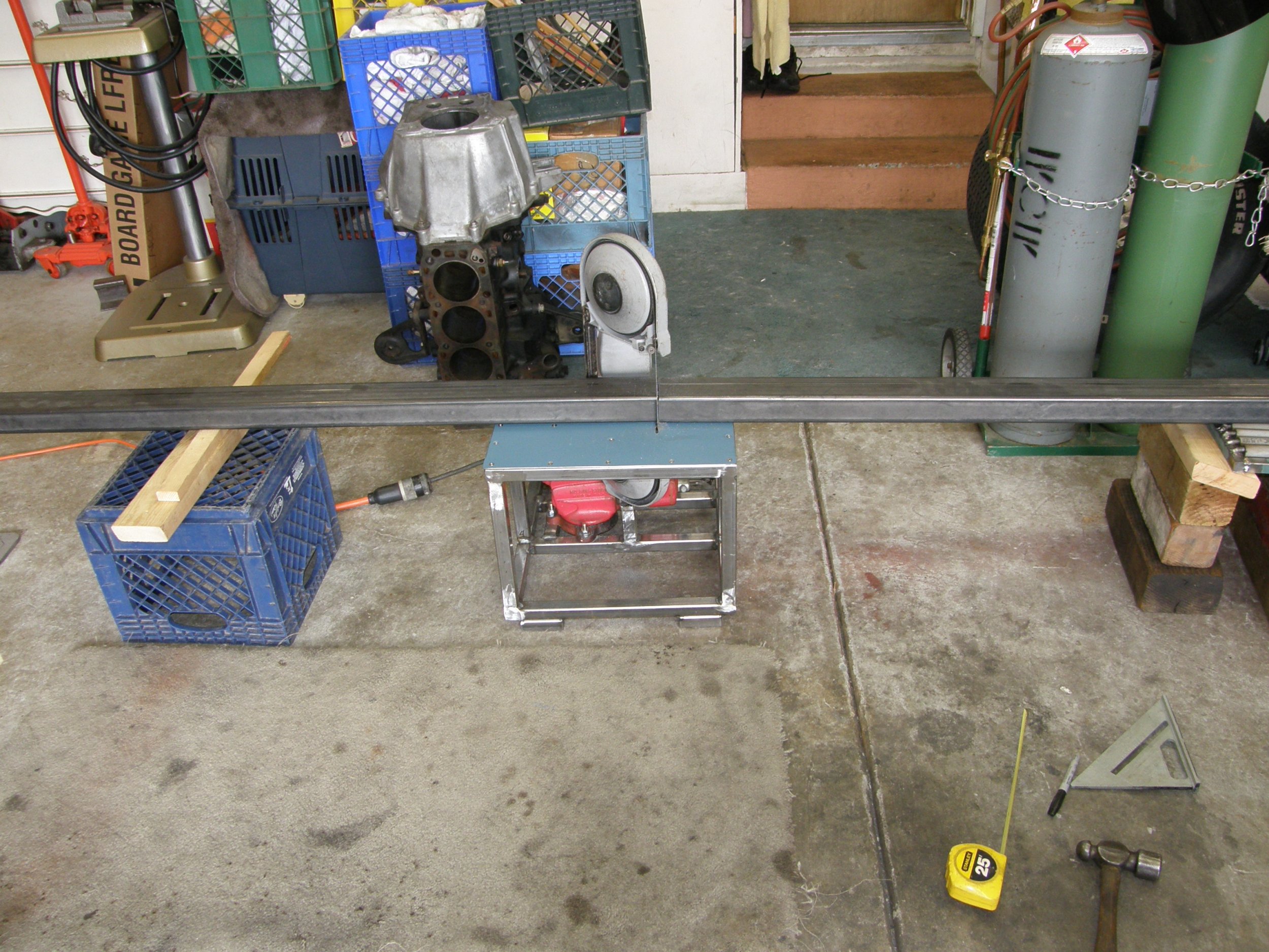

    Then, bought a few lengths of 2"x3" rectangular steel and started cutting them up.

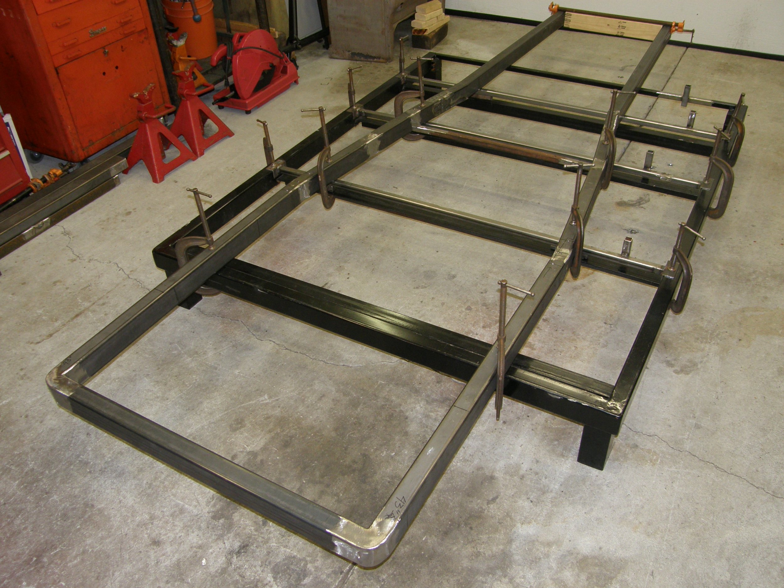

    Got the perimeter laid out.

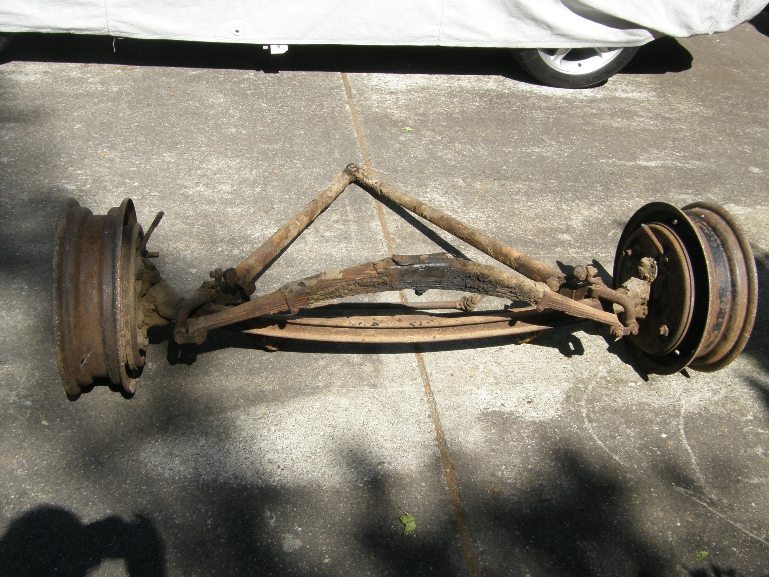

    I needed a front suspension so I picked up this '38 Ford pickup front end at Turlock for cheap.

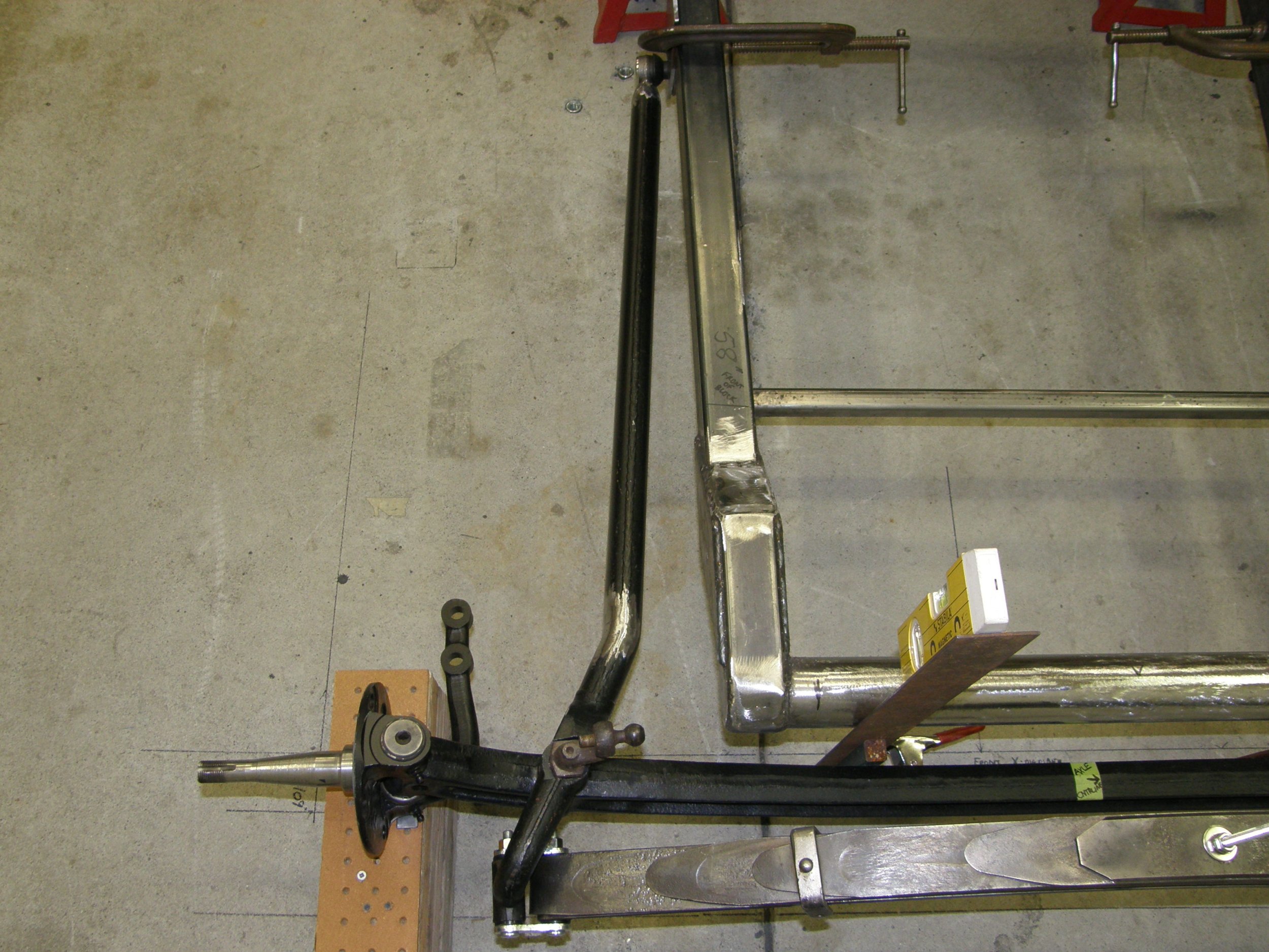

    Next, I fabbed up a front crossmember.
    Fabbed up a spring perch for the proverbial suicide front end.
    Starting to come together.
    Once I split the wishbone it wouldn't line up properly so, I 'bent' the radius arms somewhat.
    Gotta luv 16 penny nails!
    That'll work.

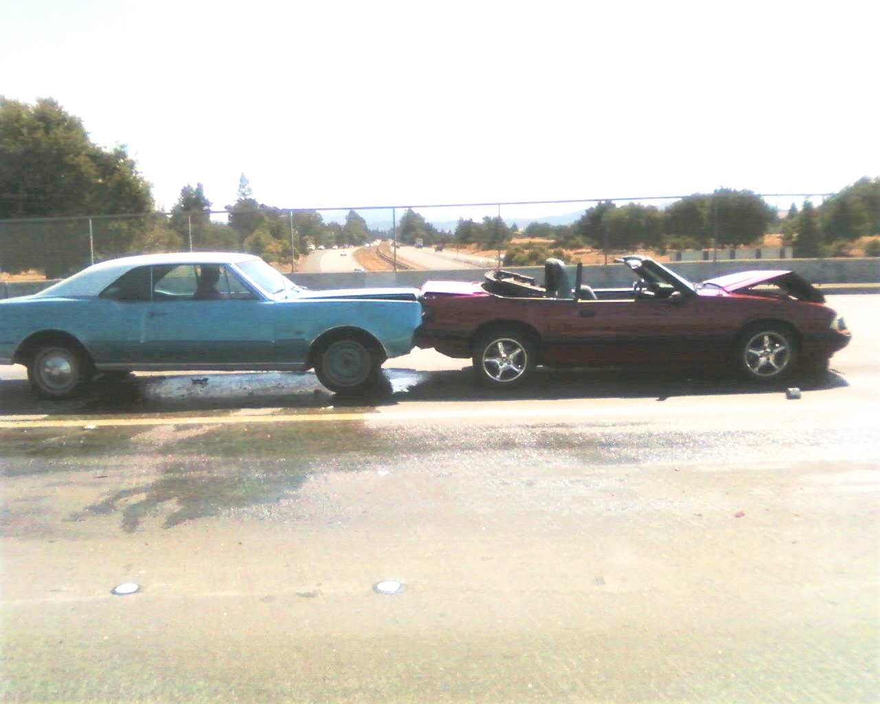

    Now it's time to install the motor. I had originally built this motor for my '89 Mustang project and enjoyed it immensily, until some bozo in an Olds Cutl*** decided to rearend me at 40 mph, totalling the Mustang!
    Here's a before shot.
    So, out of the Mustang it came and into the roadster it went.

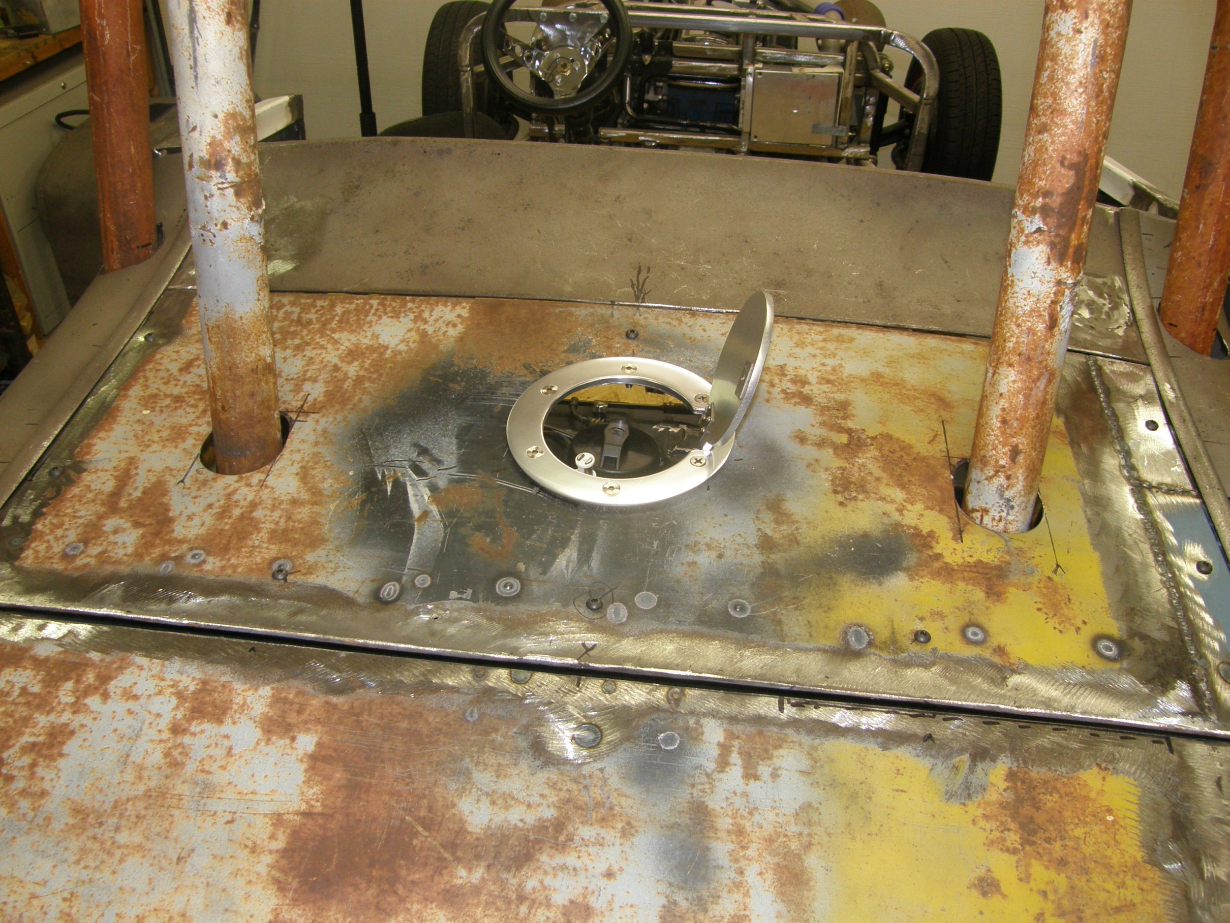

    How about a Geo Metro gas tank mounted under the decklid?
    Had to relocate the filler neck to the top.
