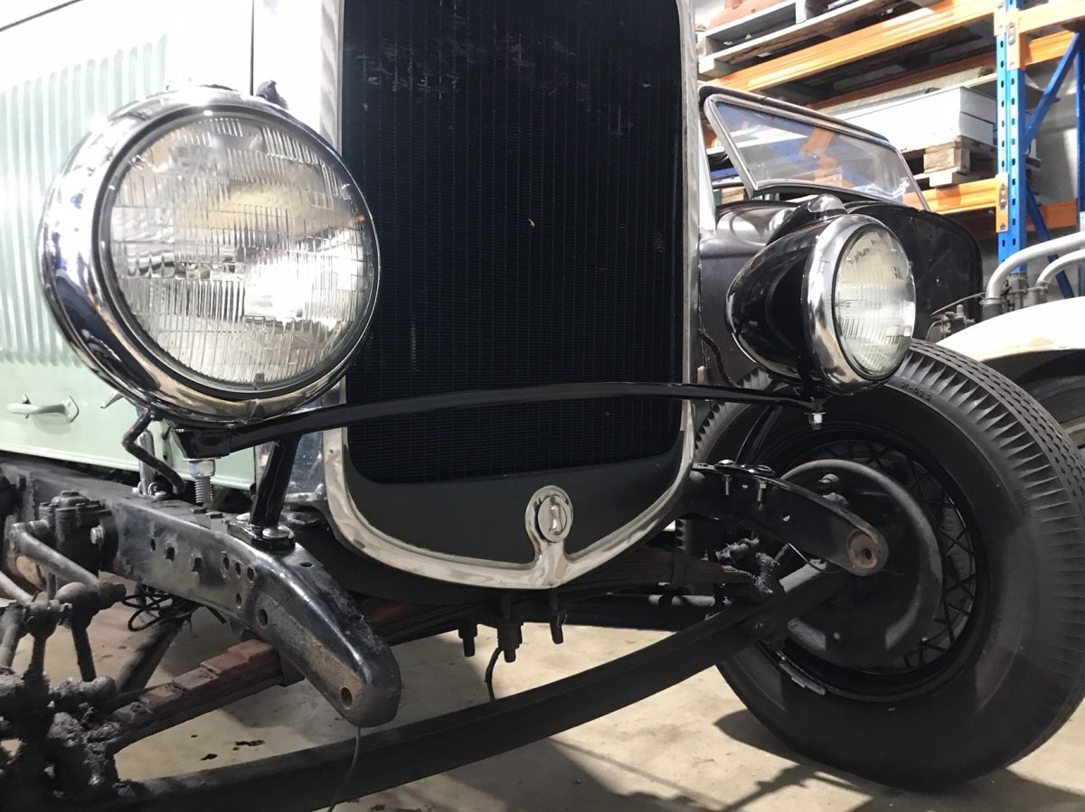

    I will put the splash aprons back on and make the one piece not two. I’ve also just finished painting my headlights and tail lights (guide 682-C rears are 39 Pontiac) lots to come this week, stay tuned.

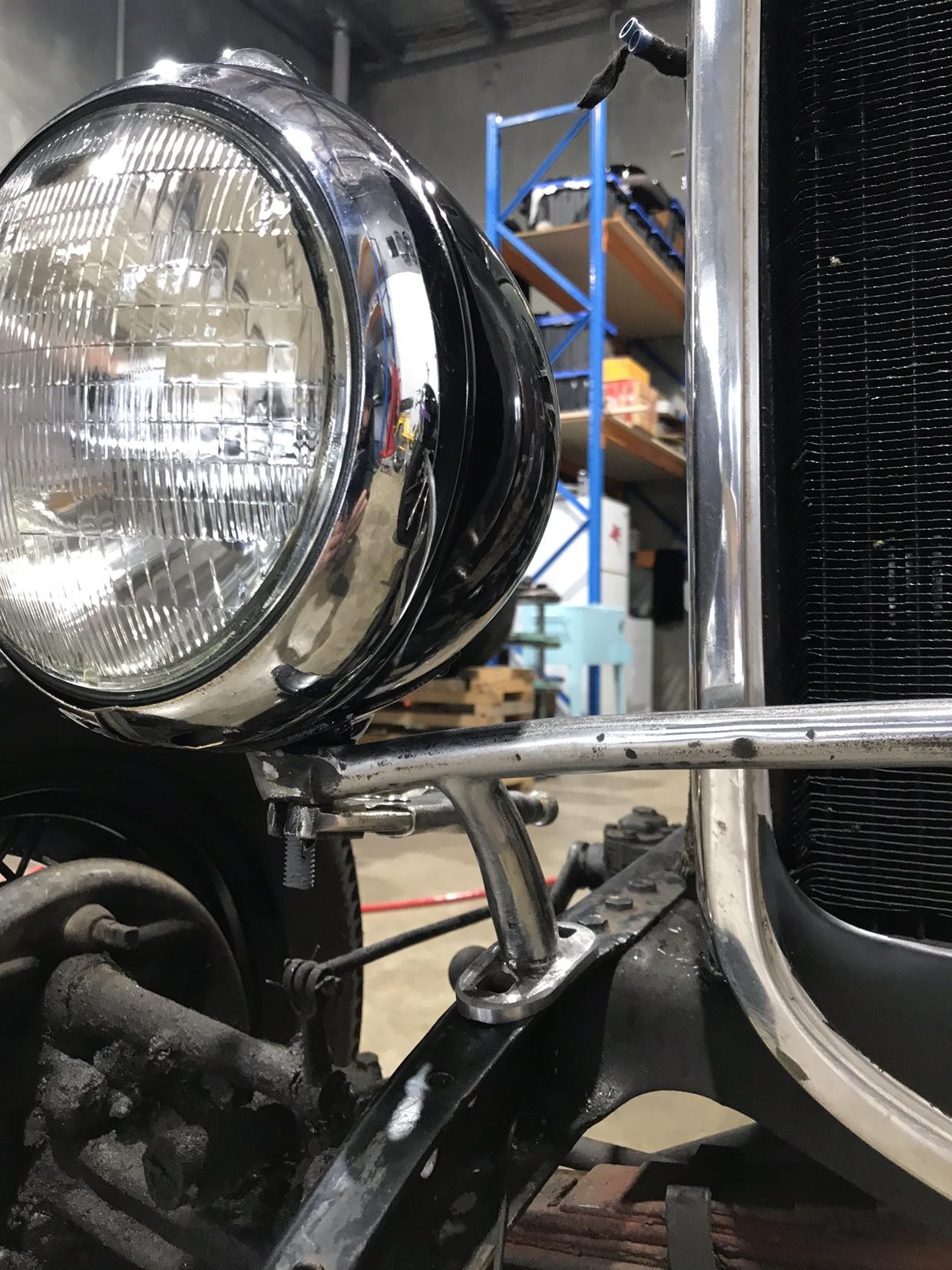

  5. Well today I tried to get the guide lights setup and mounted. I used the original head light bar and cut off the end off relocated them. I trimmed the bases to make them sit better on top of the frame rails. I welded the posts to the frame and after a bit of filling and sanding I will paint it black tomorrow and mount these lights.

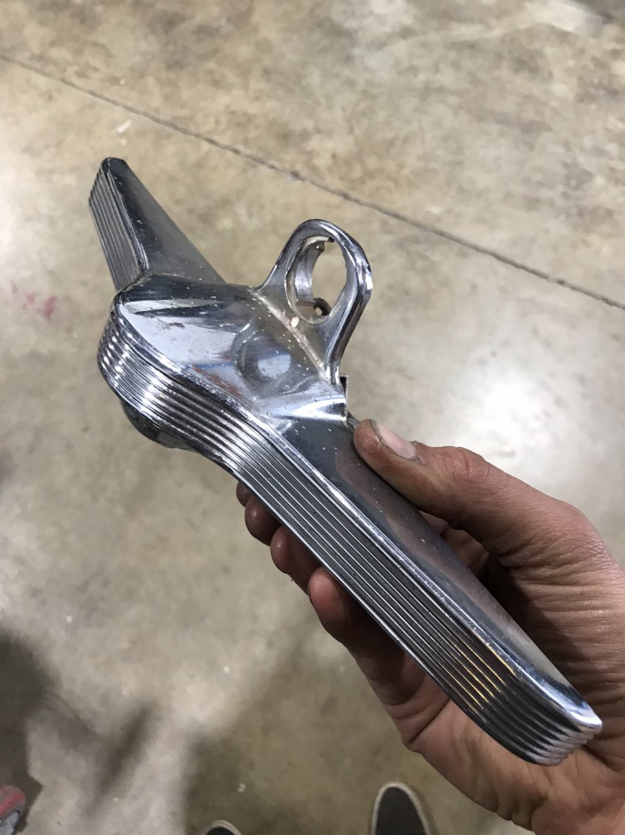

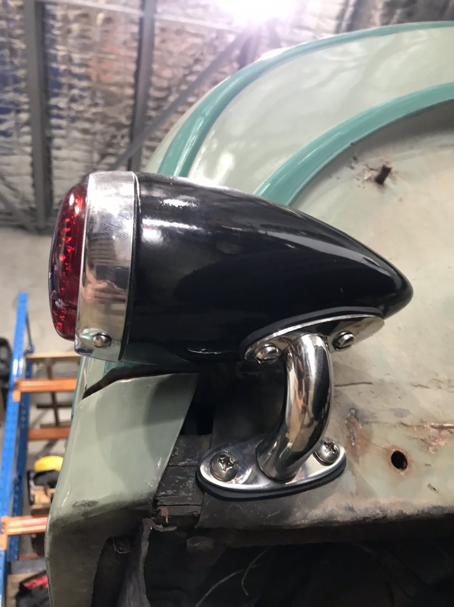

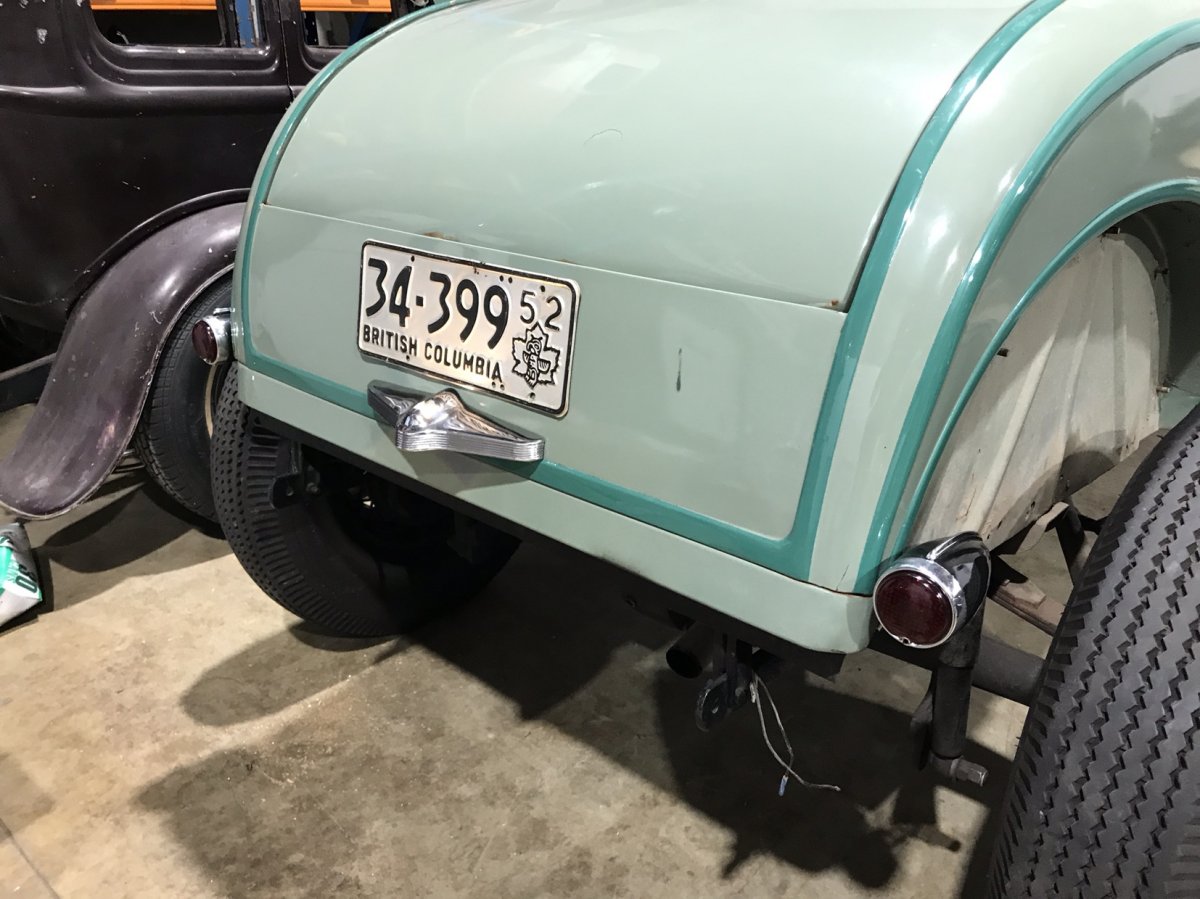

  20. Few late nights in the shop, managed to get my 39 Pontiac tail lights ***embled and mounted as well as the front modified headlight bar and headlights. Now I’m playing around with this 1940 mercury trunk handle and making a license plate light. I’ve welded the seam and will also make the splash aprons one piece and black with all the running board holes trimmed off. IMG_6744.JPG

    Great job on the tail lights and brackets - very cool indeed

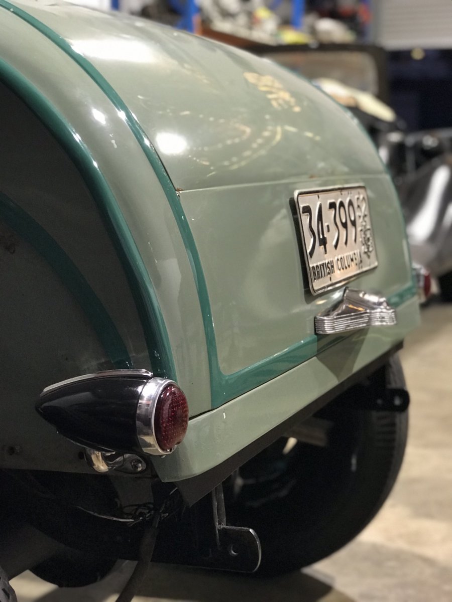

  24. Roughed up the splash aprons and attached them. Drove it outside to see what she looked like. Really need to sort out the roof and many more pieces of the list, for tonight this will do- [​IMG]

    I like how the trim on the Pontiac tail lights mimics the aux light on the 682C
