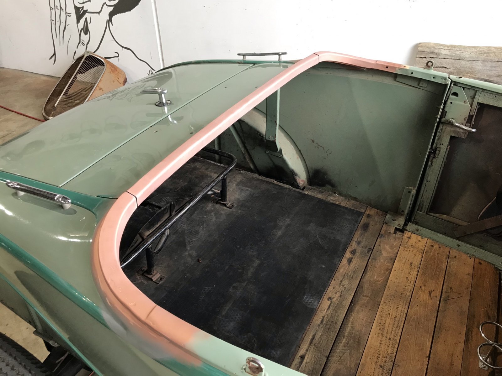

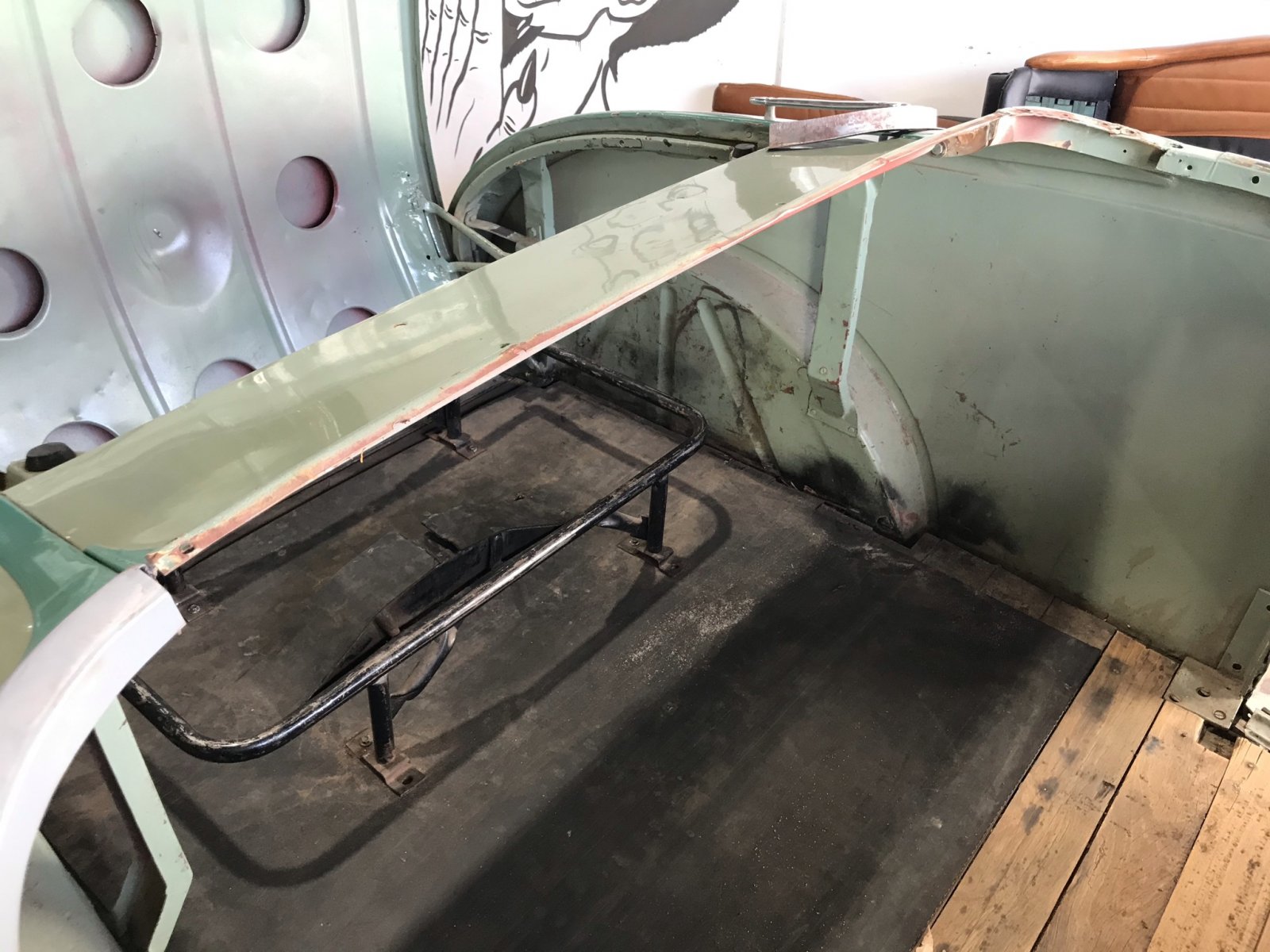

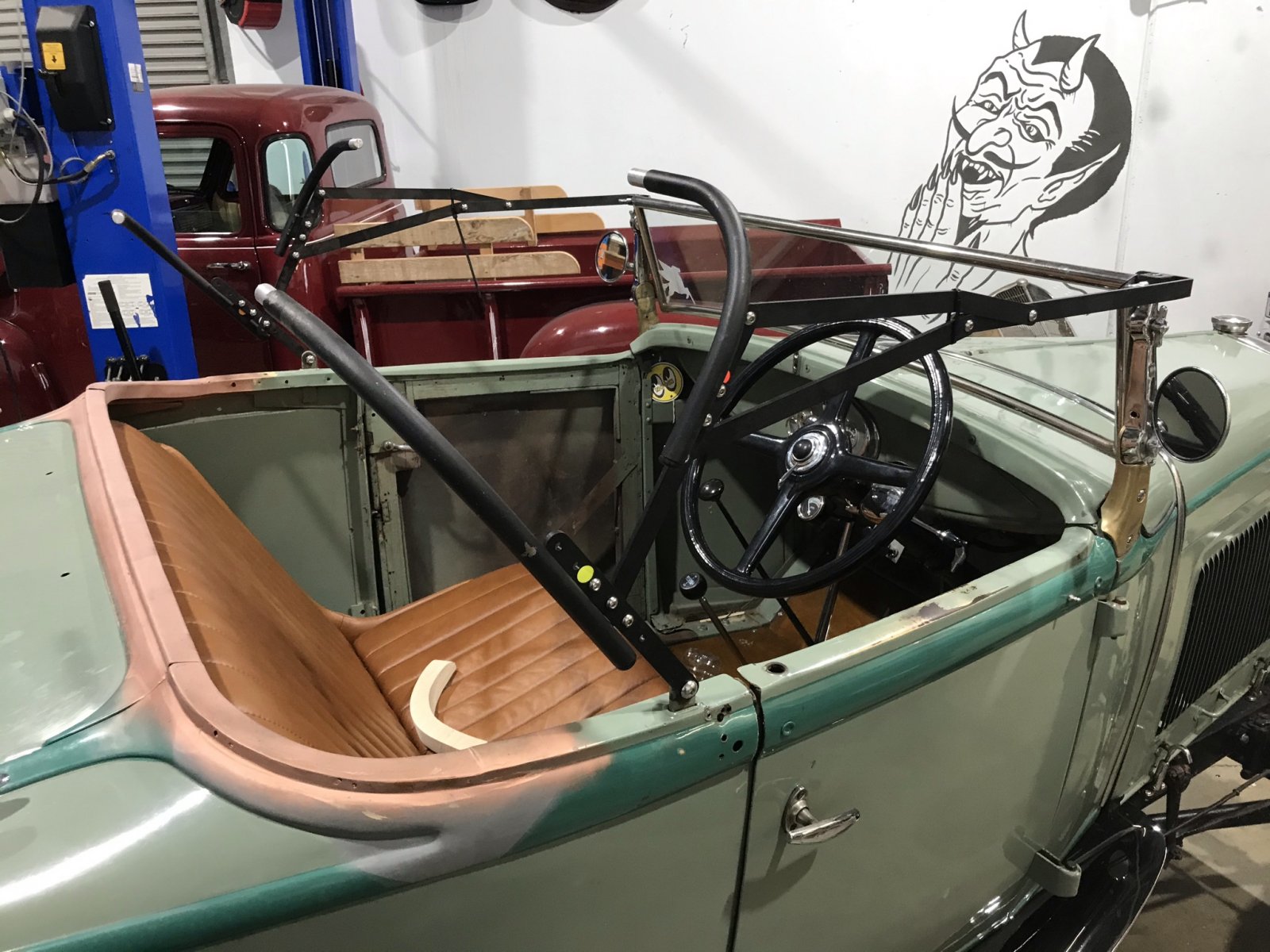

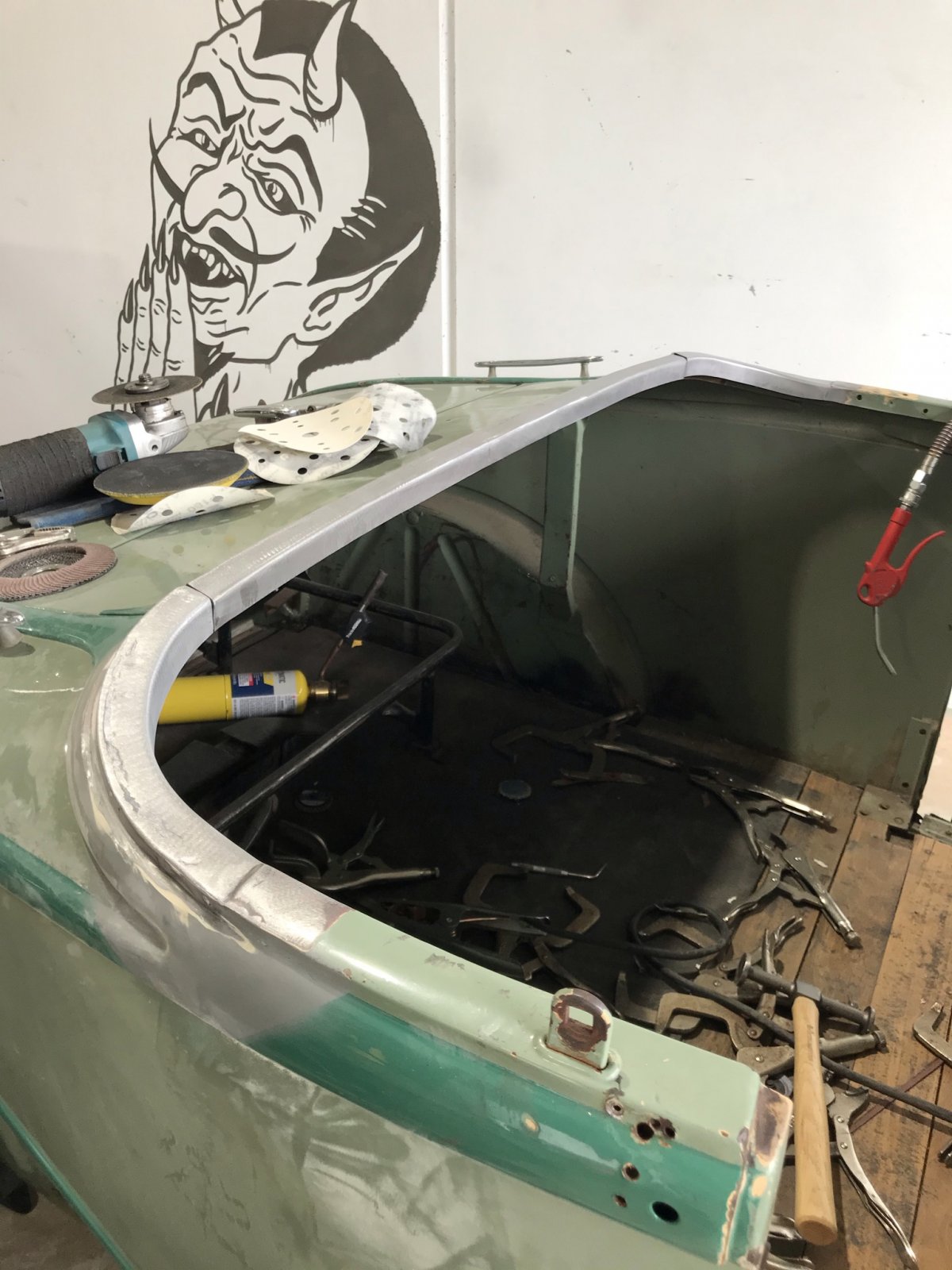

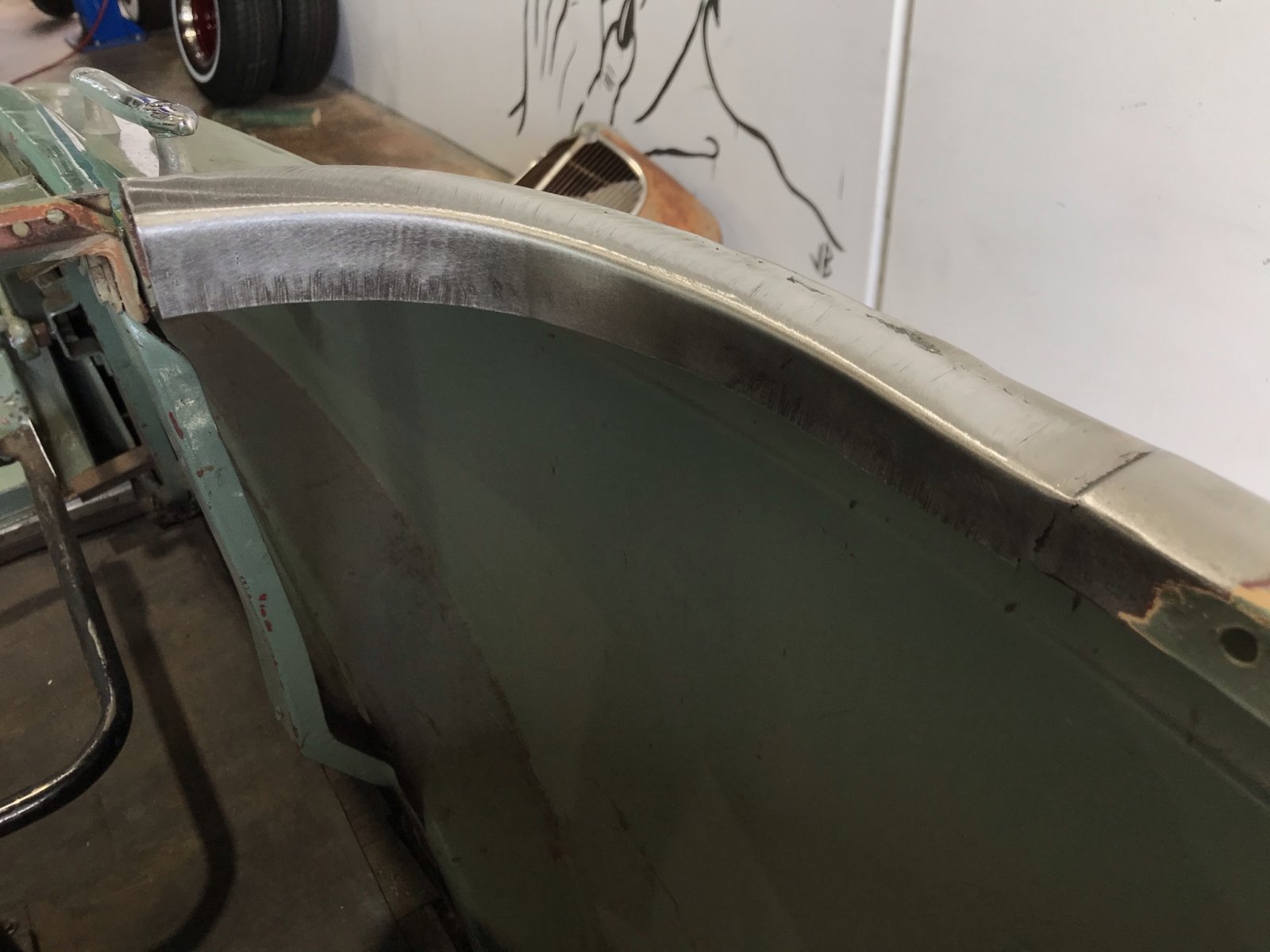

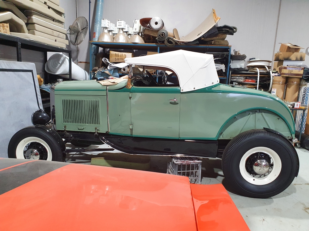

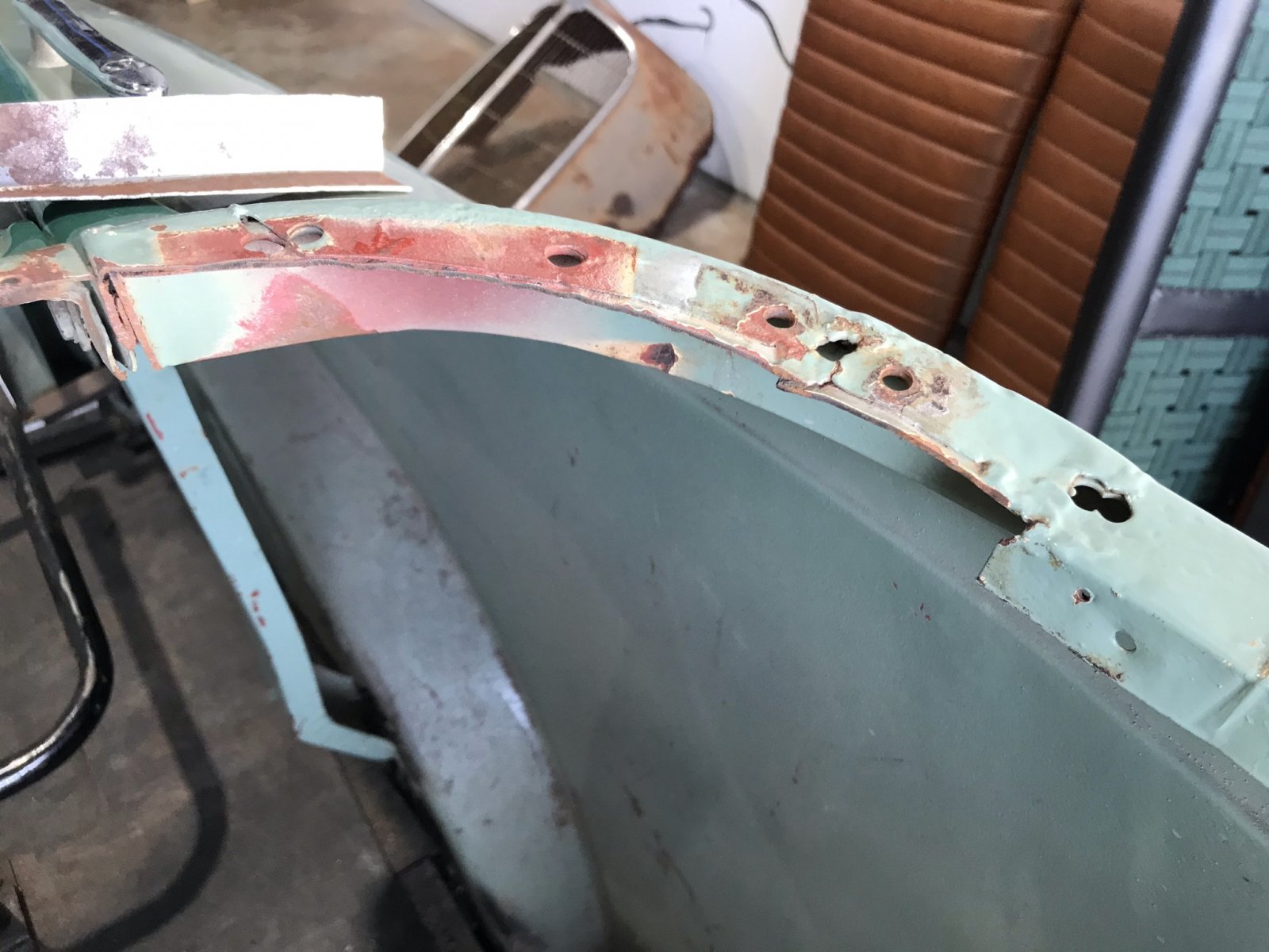

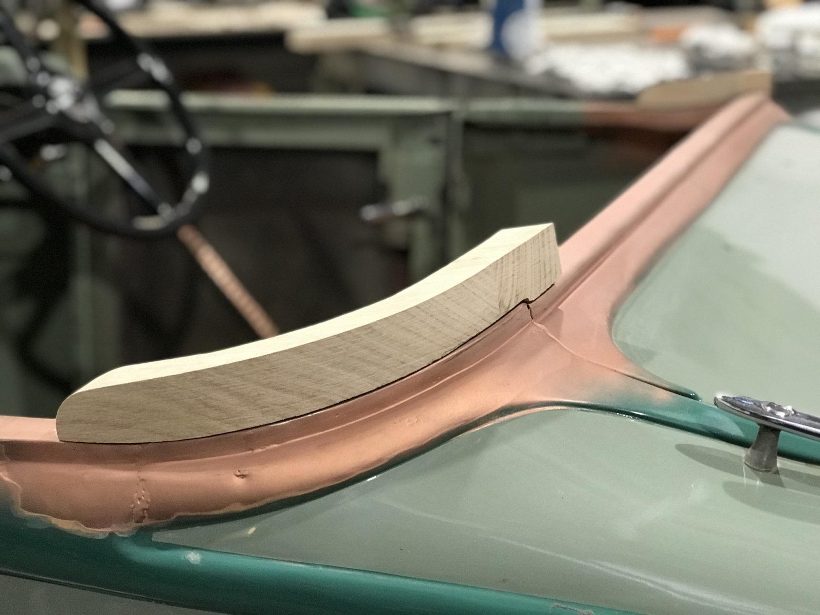

  4. Well this could use a better ending! Well the new owner (at that time) brought it back for me to finish off all those bits and pieces and give it the birthday it deserved!

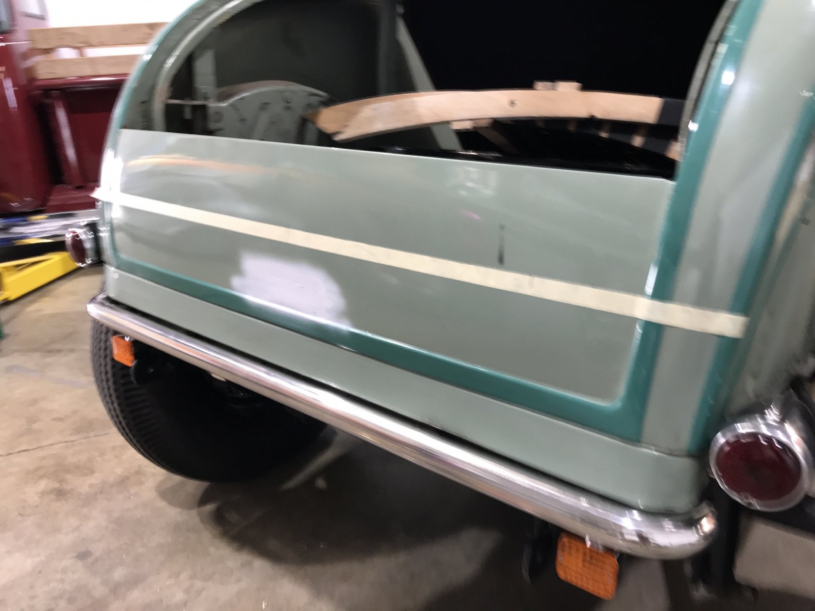

    first on the list, finishing off the rear section behind the seat.
    F664AB75-D396-4871-A04F-4504B77BF390.jpeg 9165CEC4-EBF4-4C80-AFCE-C33ABB4FD96F.jpeg 50447536-87A8-45AE-B112-3B905A40E475.jpeg ECB88EC8-241A-483F-BBD7-4168B3BC15C8.jpeg C5962CE9-6BD9-4DEC-BE2B-9530FC770938.jpeg B42FA8FF-22BF-49C2-AE05-D2CBF2BC15CA.jpeg

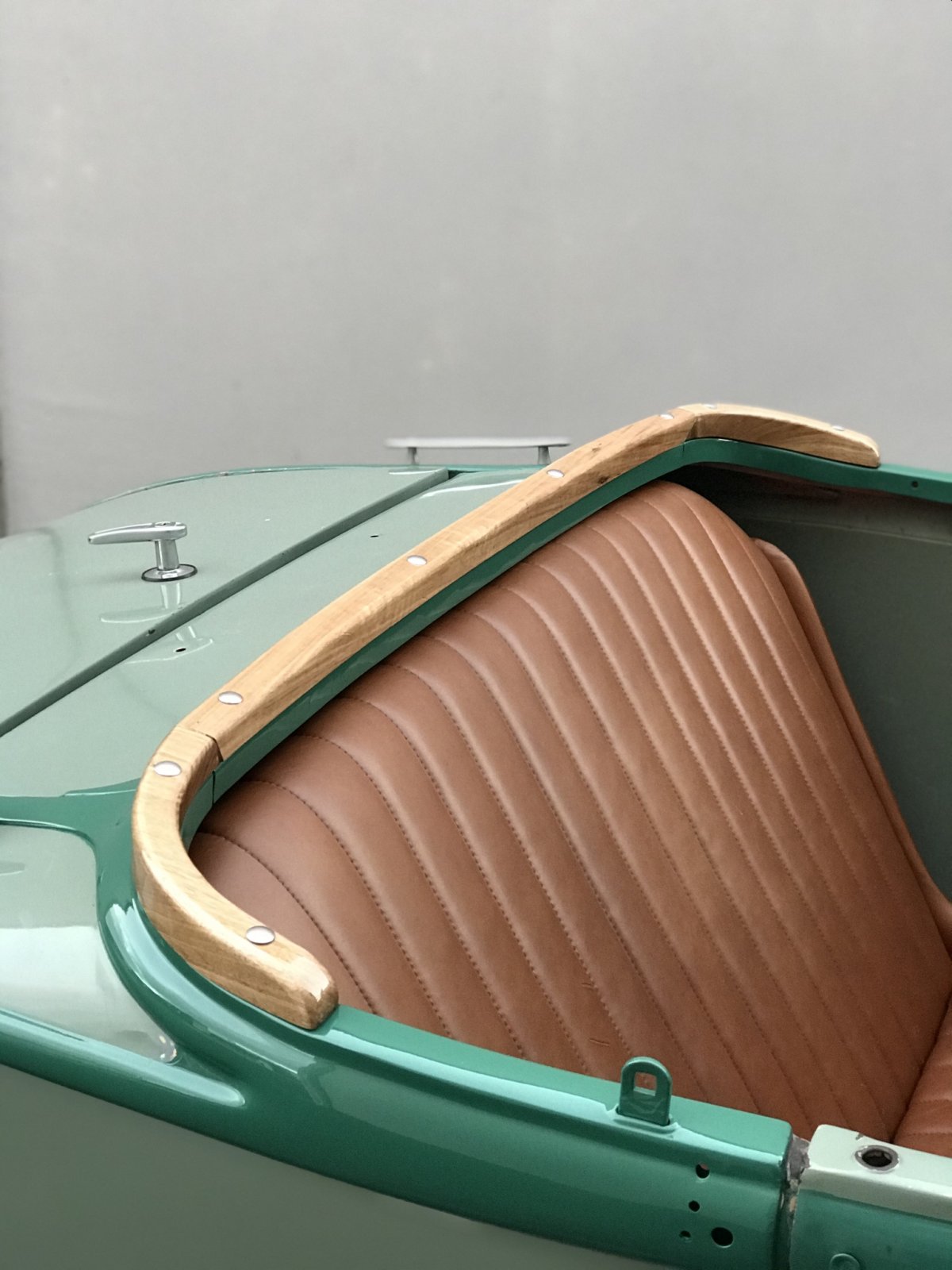

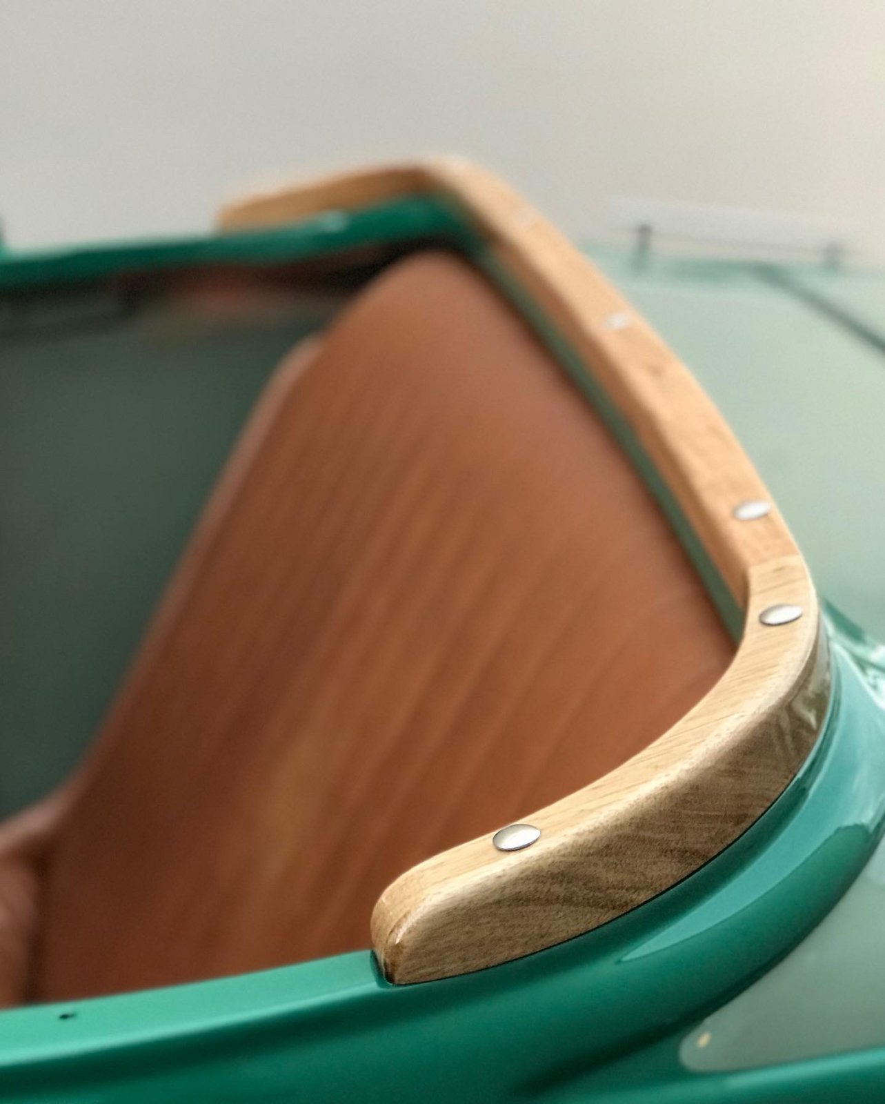

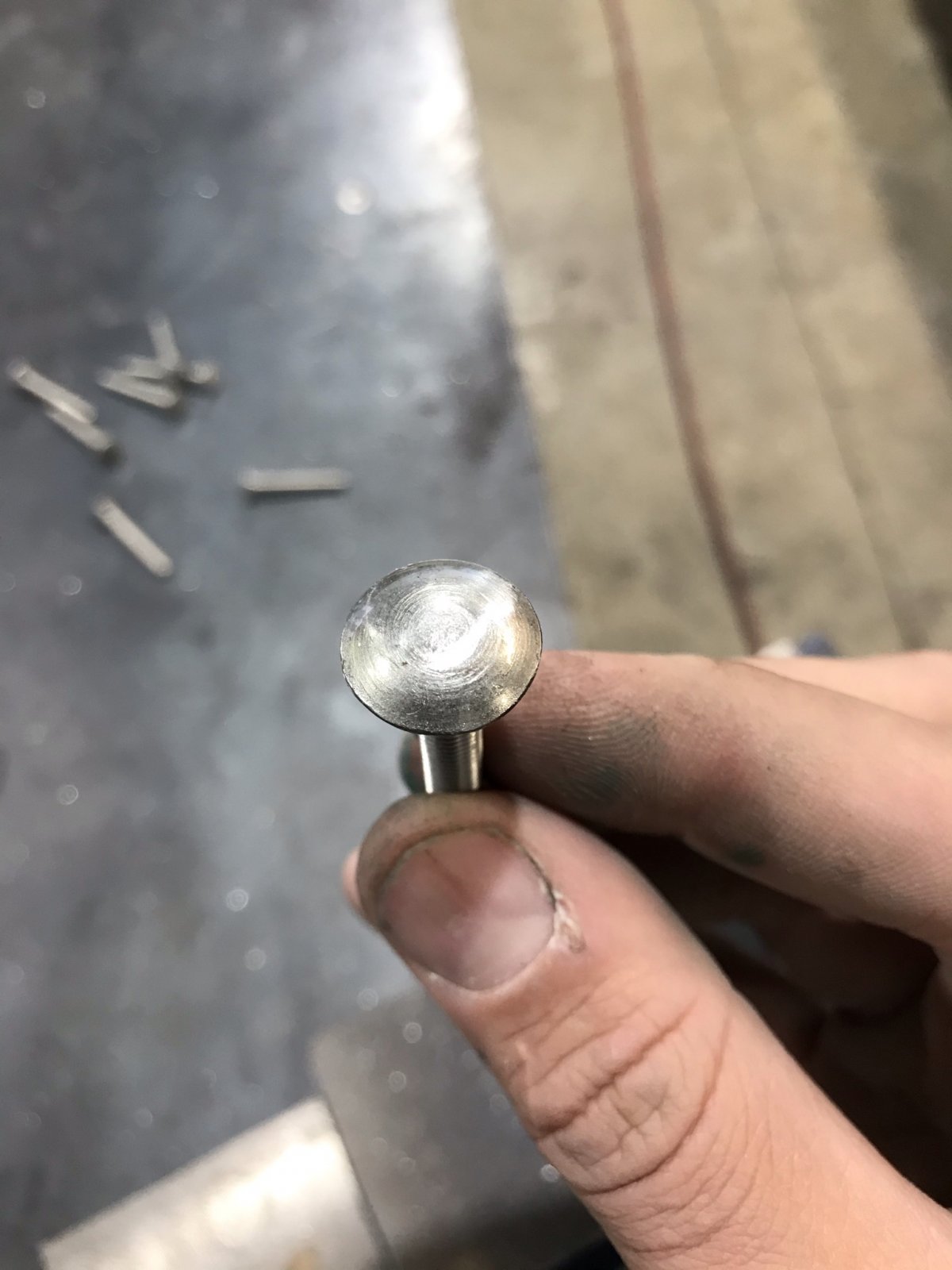

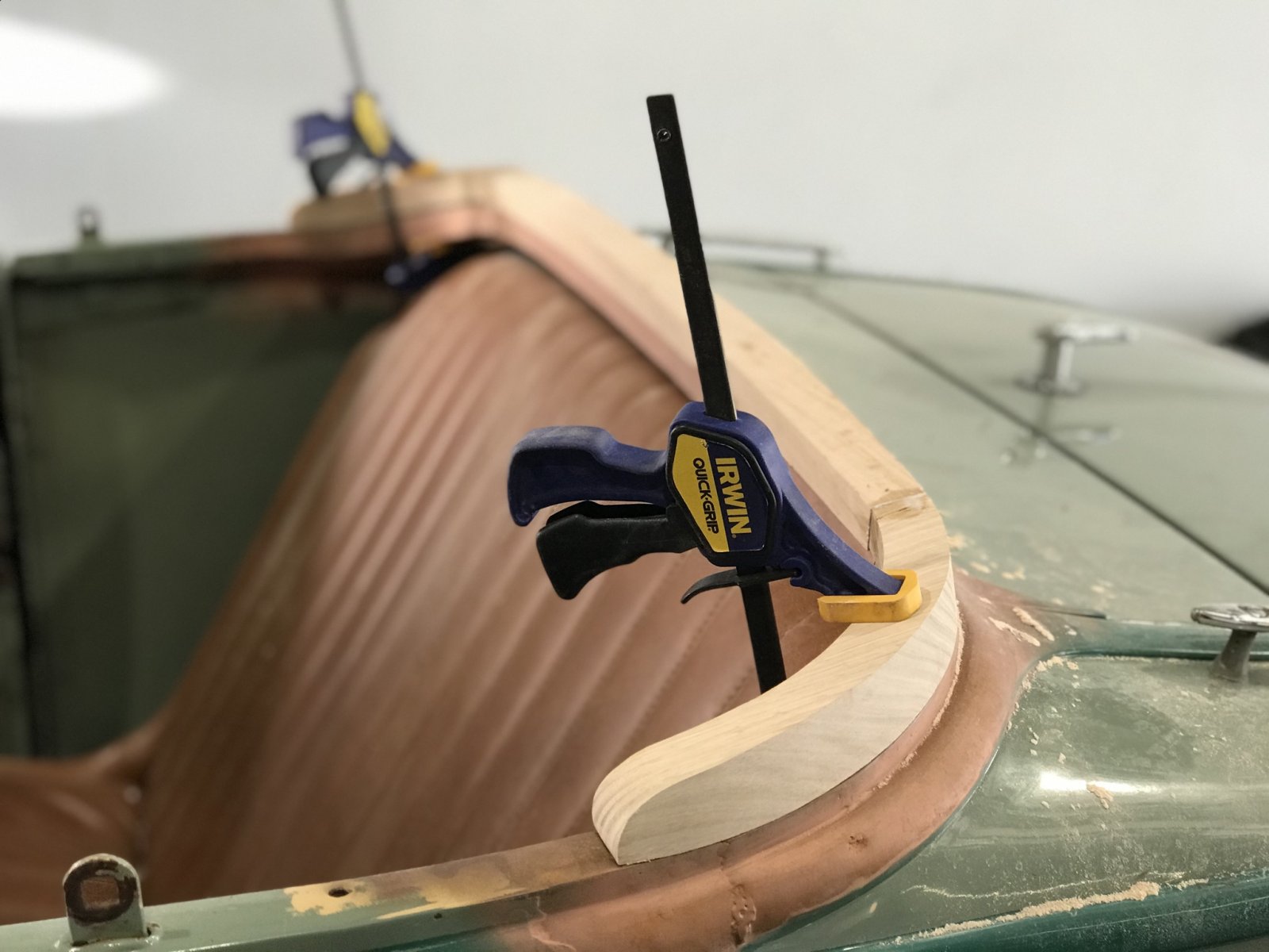

  5. After the metal finishing was done it was on to making a new piece for the rear out of some Tazzie Oak. And polished stainless ****on head bolts. A small amount of body work, some colour matching and it was in the booth getting some colour, I was definitely happy with the turn out. 832588FA-C17E-4FC5-A510-3A78820B935D.jpeg A94732EA-FD7A-4A2B-8FB0-4A16713ECDB6.jpeg 1978F3EC-761E-41A0-B61E-2874AF77D2C1.jpeg 78D4A054-477D-4584-AC6A-37348BF8C783.jpeg E8BF011D-C400-436D-92B9-ABD9EA34C31A.jpeg F956A2C4-14A7-4E63-B97C-76B584EC8A17.jpeg BE3CD2C3-C7EA-4E21-9E2D-3D0D1C90B332.jpeg 5CC8E570-FB84-4736-991B-56D3A466B458.jpeg F3202D23-9DFD-436D-9D02-72F9C4CD1BBD.jpeg D690357B-64A7-48BE-B4CE-1F51E2705510.jpeg DFA7D29F-827B-4DEF-A536-211A47091C42.jpeg 1CF9A892-A50E-4462-8B0B-22ACEC2D7DB6.jpeg 470769AD-4350-409F-9315-CCFBDFC17D84.jpeg B7C81D4D-7F99-4744-AE16-E6581A5A00F6.jpeg 7C2C206E-C8DA-4264-92AD-B22772FBFFDB.jpeg

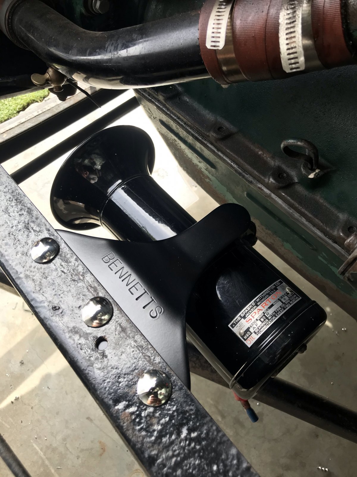

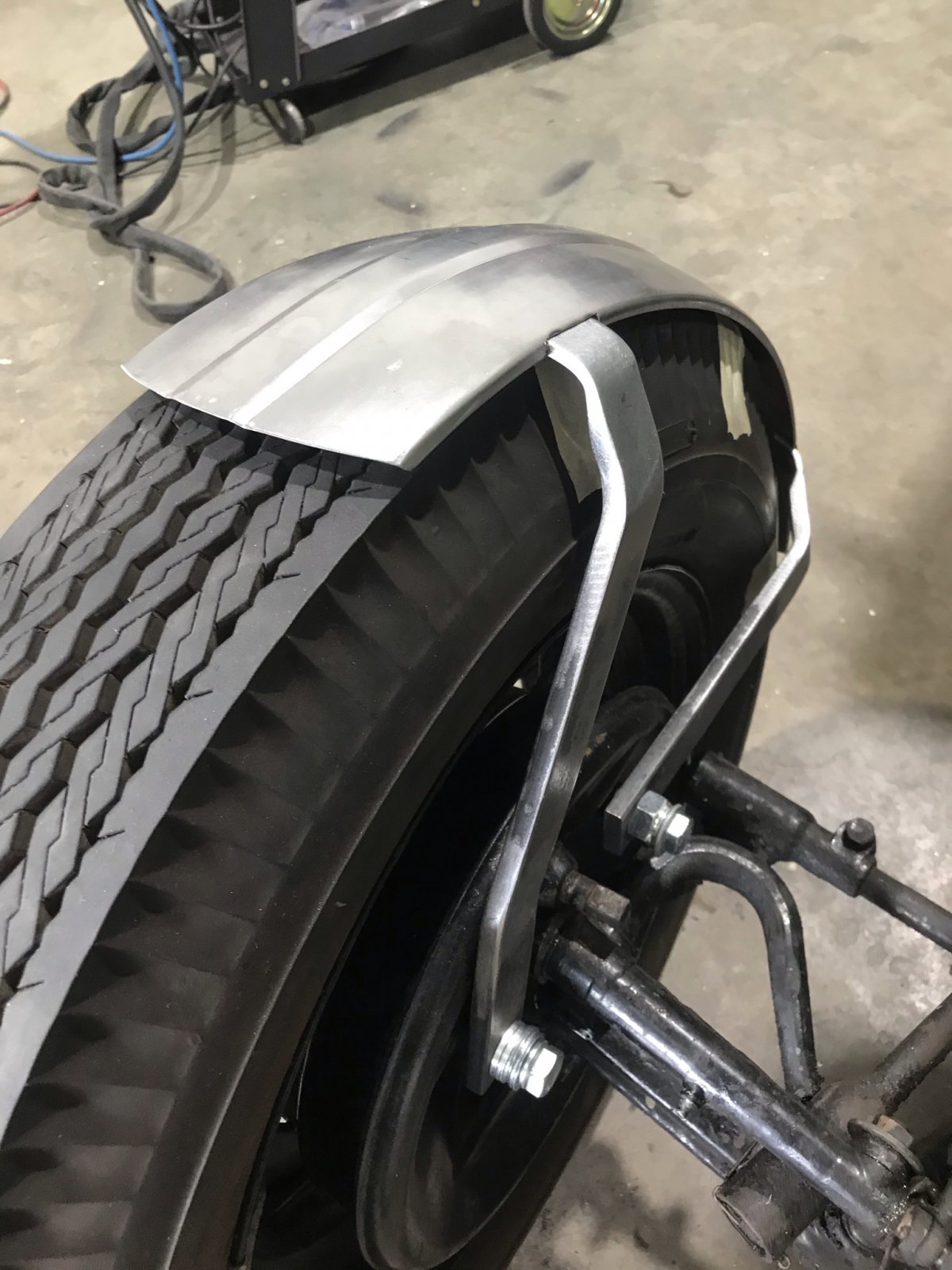

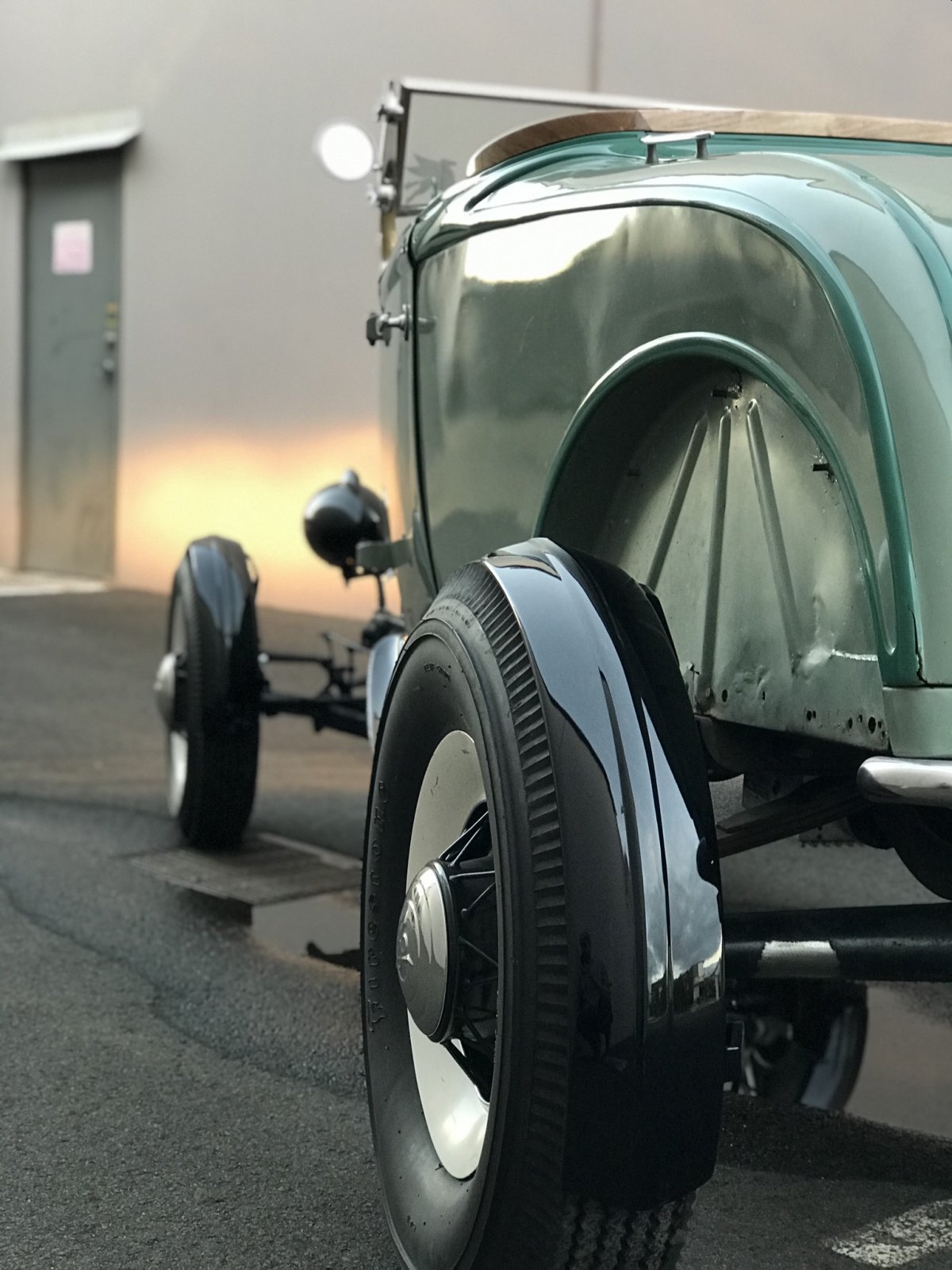

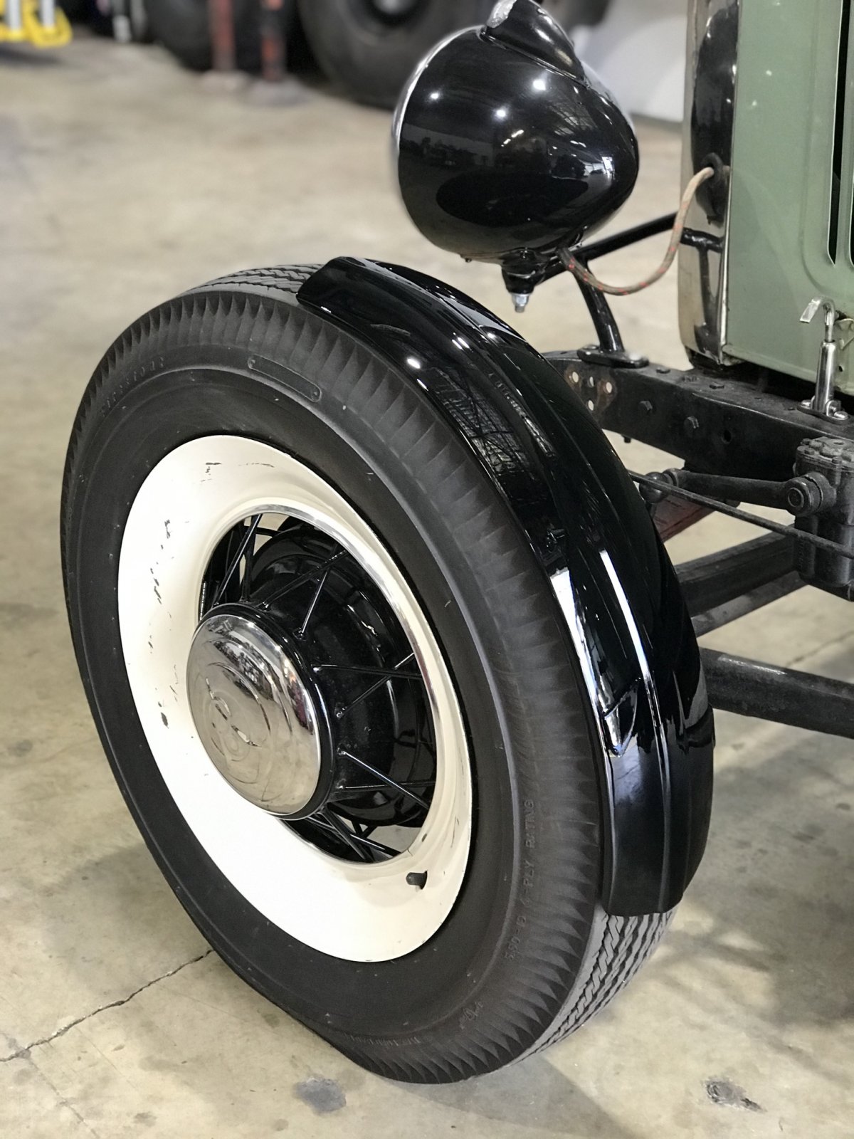

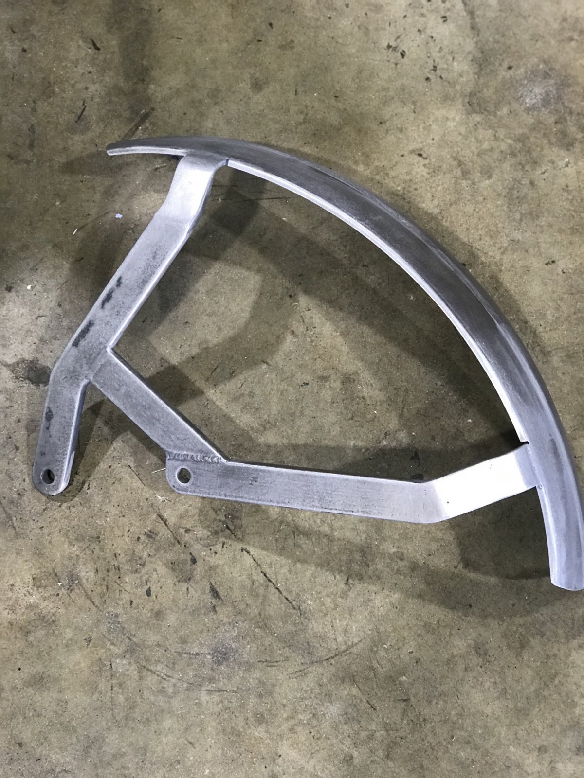

  6. Quick horn bracket,

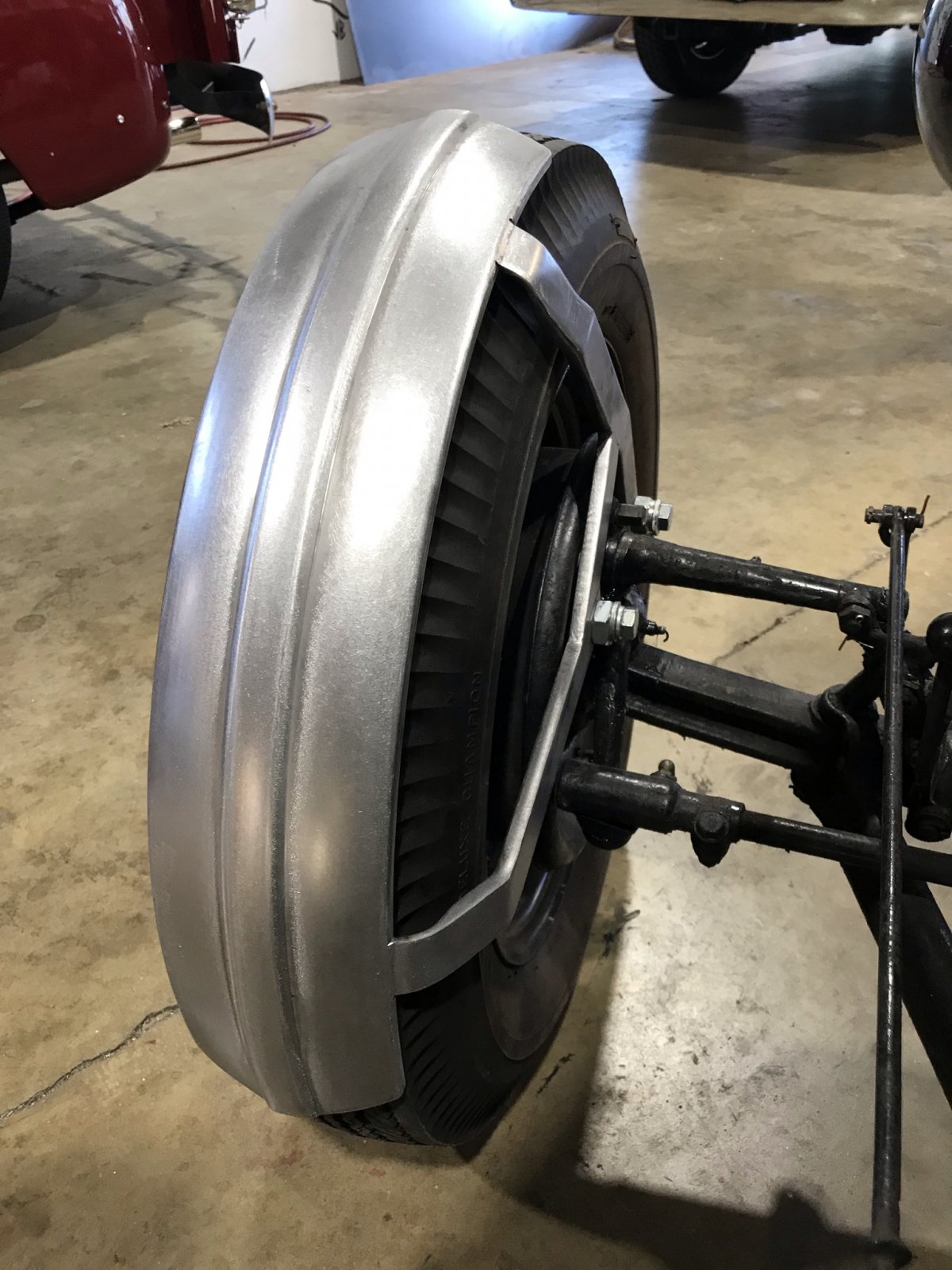

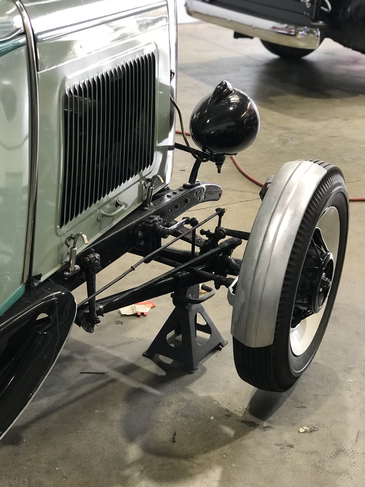

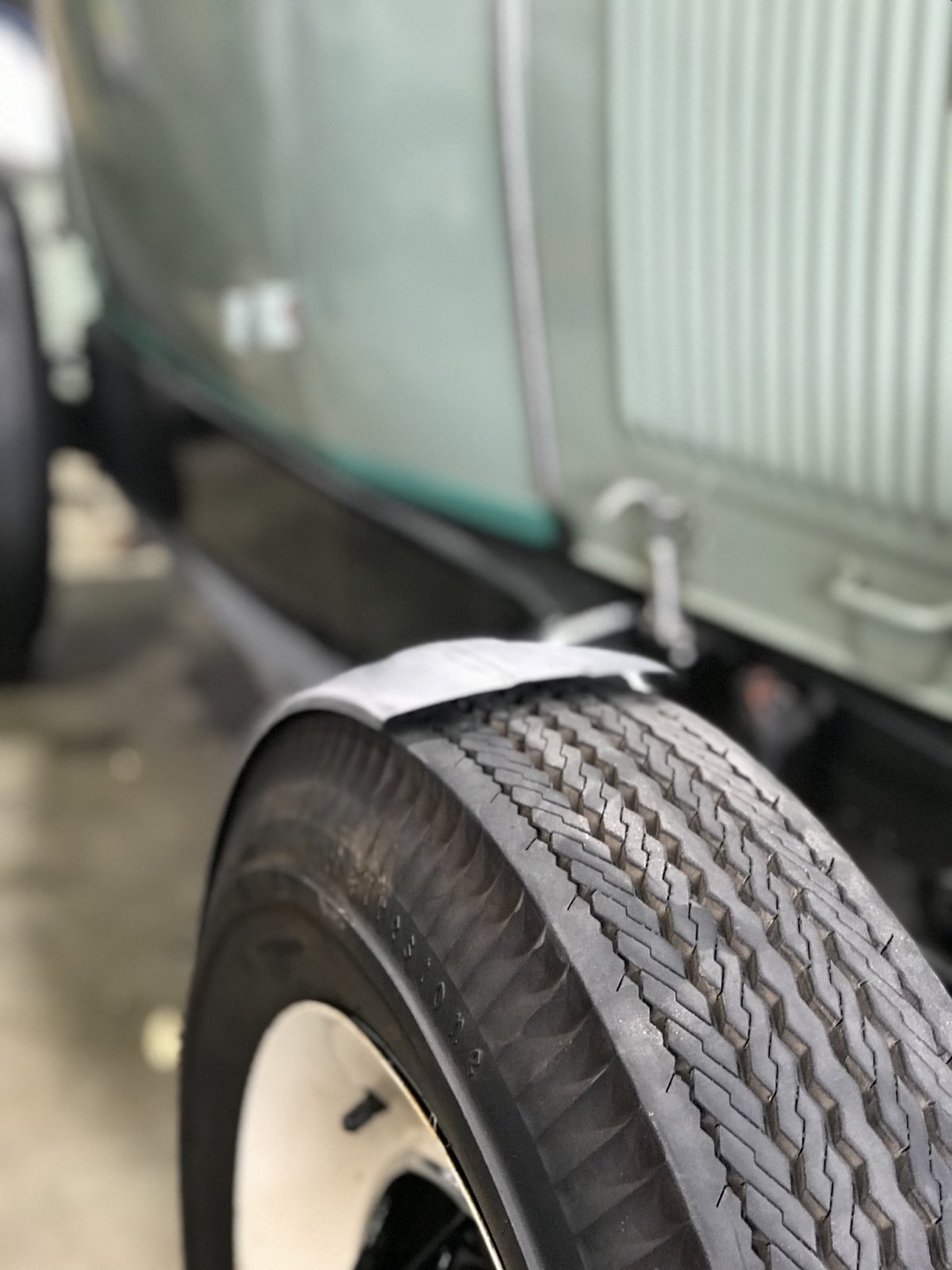

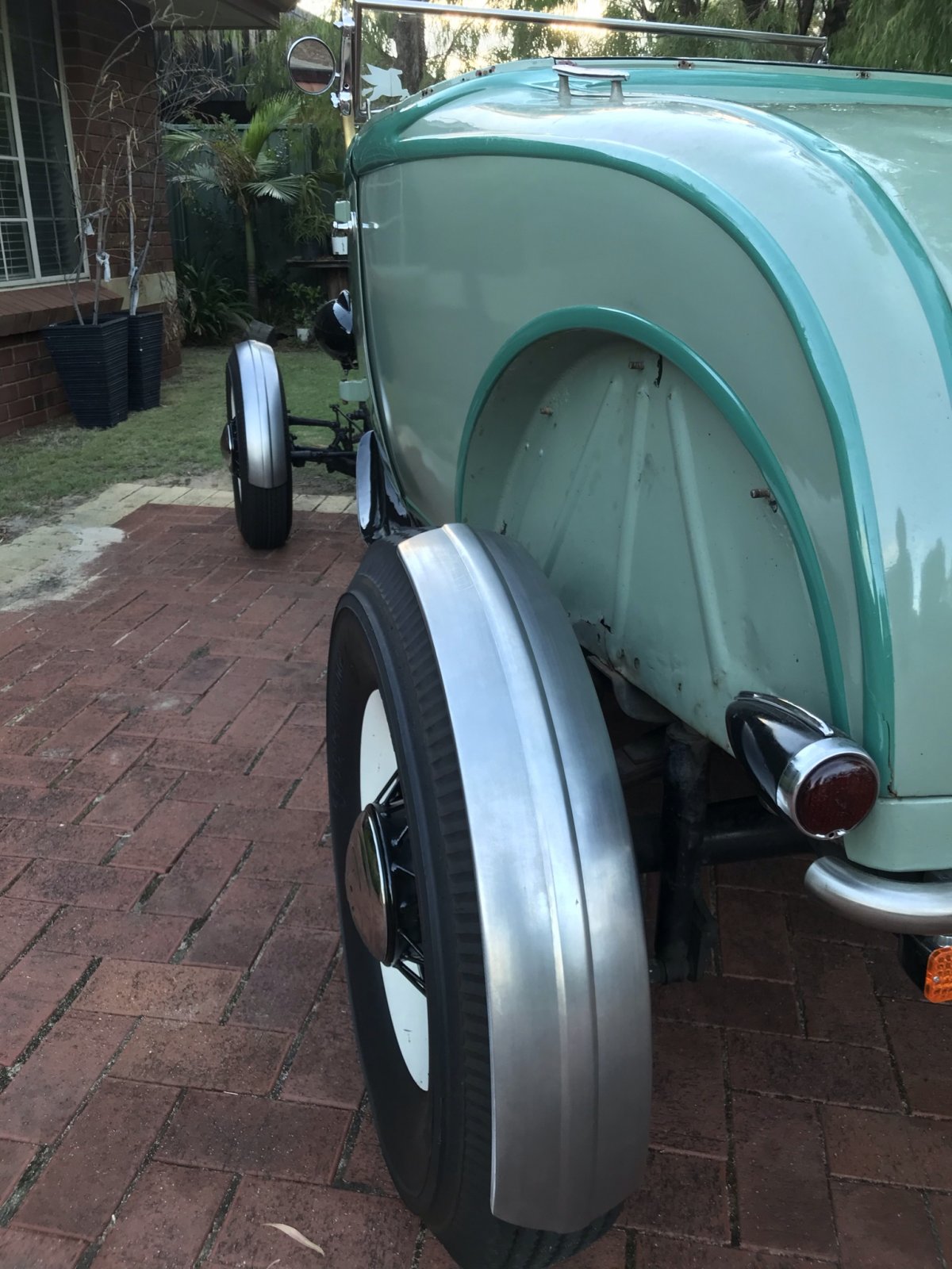

    Unfortunately no open wheels here is Aus (although I did for over a year) it was time to fabricate some up, I purchase the fenders from Deluxe metal shaping co over East. They showed up promptly and were the perfect fit.
    Then it was creating a mount that wasn’t overly intrusive and still complimented the car. I like to make them fit tight allowing about 15mm of clearance. 8B4BA62C-4886-4BDF-A331-DCF5136339D5.jpeg 16F8D8BD-3A5F-4190-AB01-0181B118BADF.jpeg BF6E55C8-135B-492A-A43D-070B97E2B9FB.jpeg 88D48B00-E1A1-4F26-AAEC-81AA1579745B.jpeg 30B89DA3-2E7B-4F38-A2DC-C81755BC7980.jpeg 6BB49F63-B1E0-4E22-8C06-EE9E7AEE45F9.jpeg CE042F47-EF93-4008-AC7F-6C4A301BAA90.jpeg 9D4EF59D-5156-4B81-8ADC-B6567BF1EAB0.jpeg B4035E52-CE91-470B-BC75-B34F317B0828.jpeg F018094B-726F-4ECD-ADC4-EE314D3045FD.jpeg 8378C6F9-B527-41F4-B1F1-1CCBEC2938F9.jpeg DD76BCBA-8245-45BF-9A9F-820584699449.jpeg 3D8CBF06-DC90-4052-B66D-2F164CF003E5.jpeg C7A30A30-E4E9-4F14-8CE7-61802CF53FA9.jpeg C846F64F-662B-4EA6-B2E9-5CD11F661931.jpeg

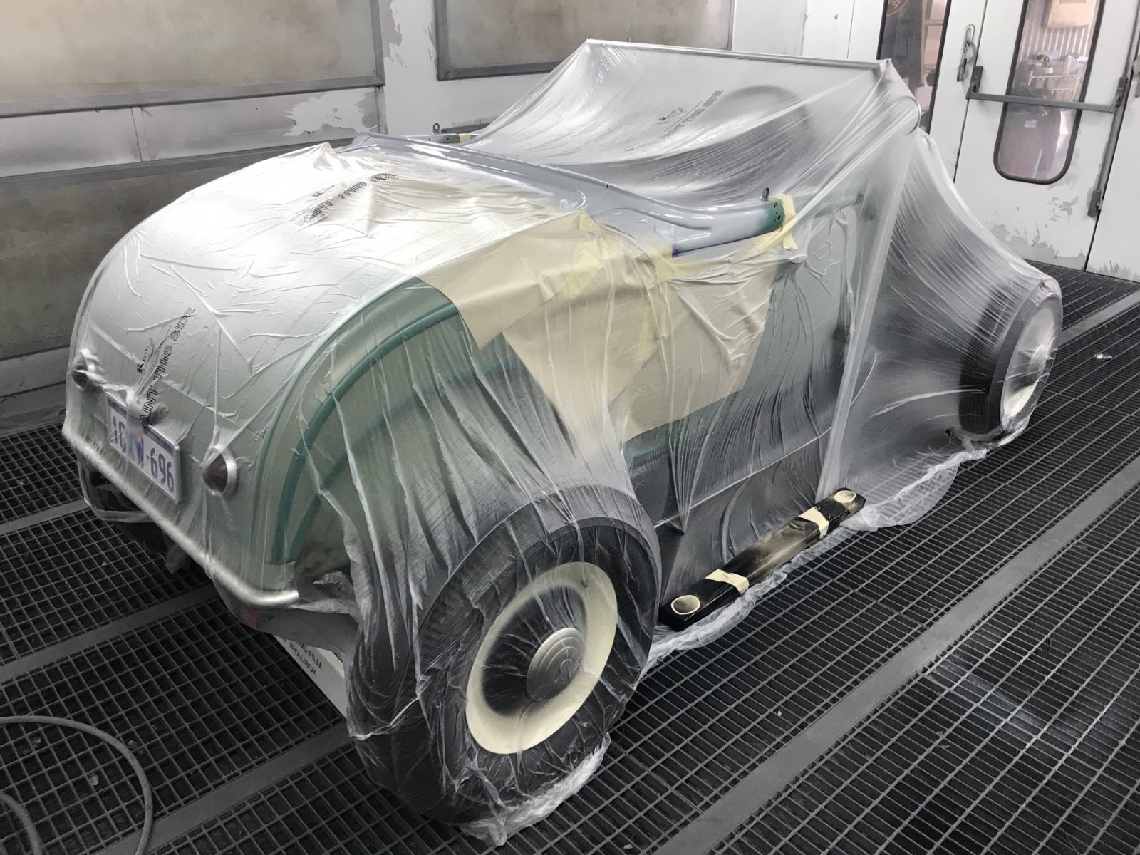

  7. Back into the booth for primer and paint
    2 pack “Deep Black”
    Really happy with how these turned out

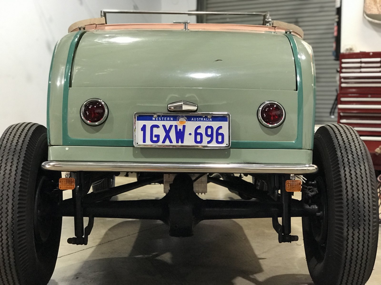

    Then it was new tail lights and License plate bracket/light
    4A441E3A-435C-4390-A1B1-D5BFFCA8C2F7.jpeg 3FEBF5A2-1E9F-46EF-A689-260C5C94D635.jpeg 5518048E-8828-4F59-8E73-C7A19998F039.jpeg 75DD7ADB-C26C-4AE1-BF4E-57425E7097CA.jpeg 16777F17-0643-41AE-BD0B-EBBE5CF9E015.jpeg 6A02D248-C953-40B0-929D-8BB2B332AE7B.jpeg B3BB2D09-AAB8-4835-A591-0C2A97E243F2.jpeg

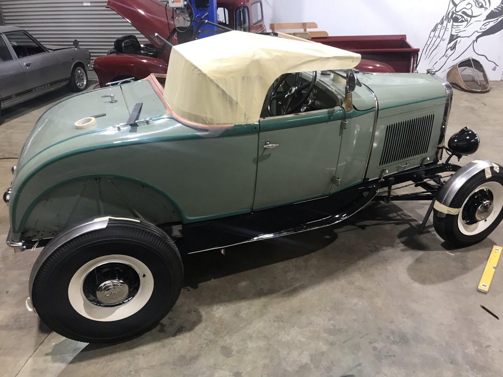

  9. 1F4AEFD7-48D5-4931-9CC6-1E288C783547.jpeg 8244BF1E-FB54-4D85-BAFC-9CDAE155E354.jpeg 3CF9295A-1809-4DF6-AC44-281C939034F4.jpeg A86E051F-48CB-46DF-B90C-F5B093862FC1.jpeg 75162DF5-6310-49DB-8C2A-2FE78F45C24B.jpeg A859D96B-820C-43A1-A76F-DD4D2B783B8B.jpeg C6A097D5-13C2-42D1-8B02-93E5CC466698.jpeg 4767843E-D228-47D4-9252-68169BE28434.jpeg 072CE48E-35B5-4F1D-8C41-4058EDCFE1B1.jpeg 33C387B7-9571-4D20-8223-D10841227E1C.jpeg 1A9DA8F6-A151-42D6-BE7D-DF0F7140FE9F.jpeg 93427499-EF81-4896-B0DD-62E1A2093D65.jpeg BA426B73-894F-438C-BE81-71E9B8E12A22.jpeg After doing a hot lap around town to test out the new fenders it was time to get some shade.

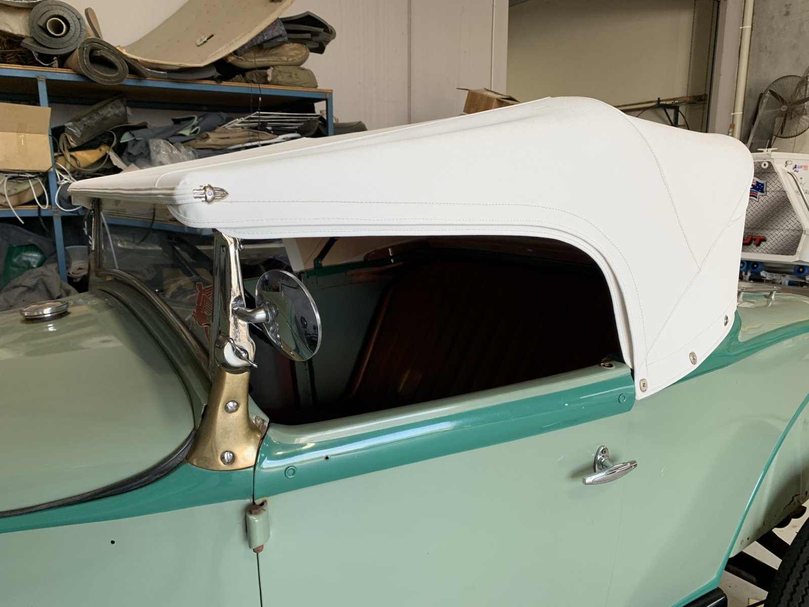

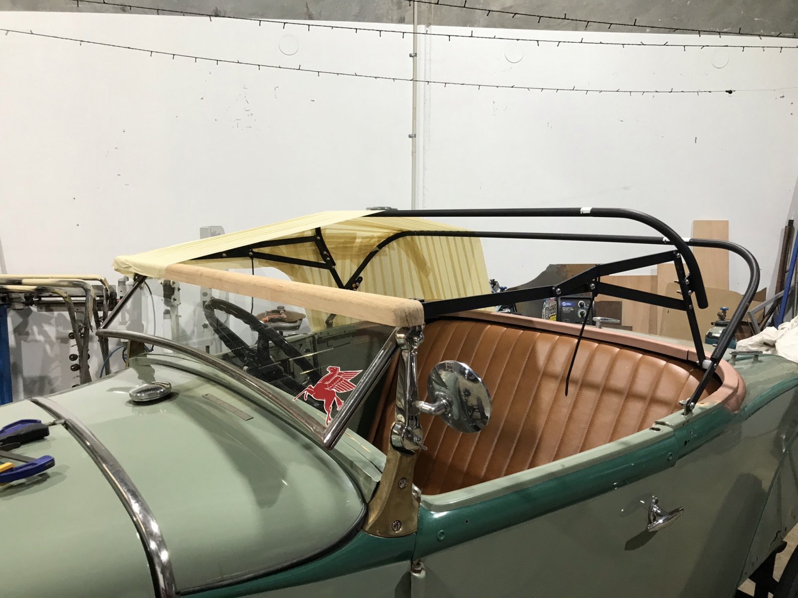

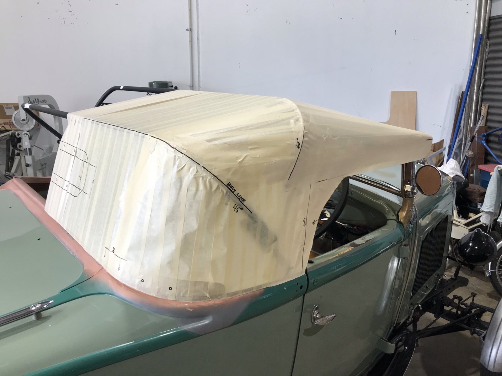

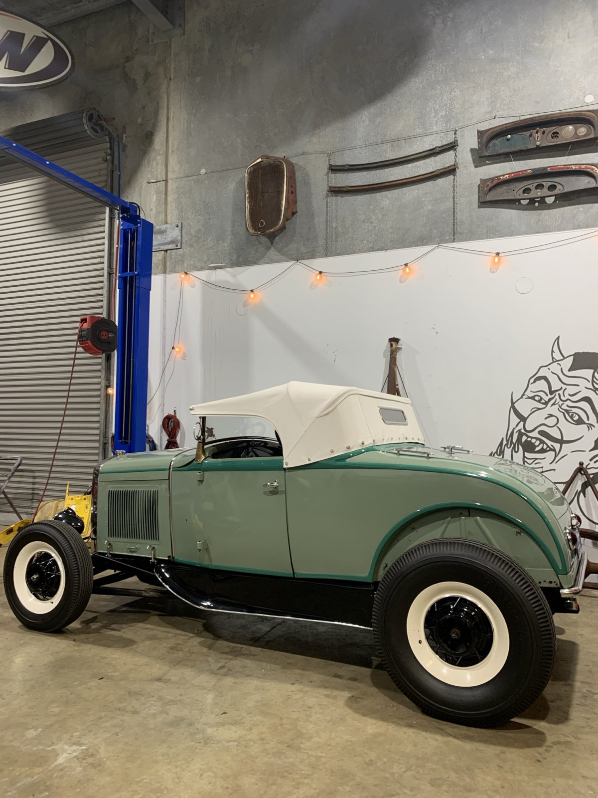

    I ended up using KwikTops roof kit, after lots of measuring and t******* I got the bows sitting where I liked. Then it was time to lay several rolls of tape to get the desired profile.
    Then it was off to see Grant at Kieth Williams Upolstery. He’s the man! And gets exactly what I’m after, I barely had to explain what I wanted he already knew, and he knocked this one out of the park! Also has small panels around the window fram so if door panels were made they would have a tight fit so no weather would come through

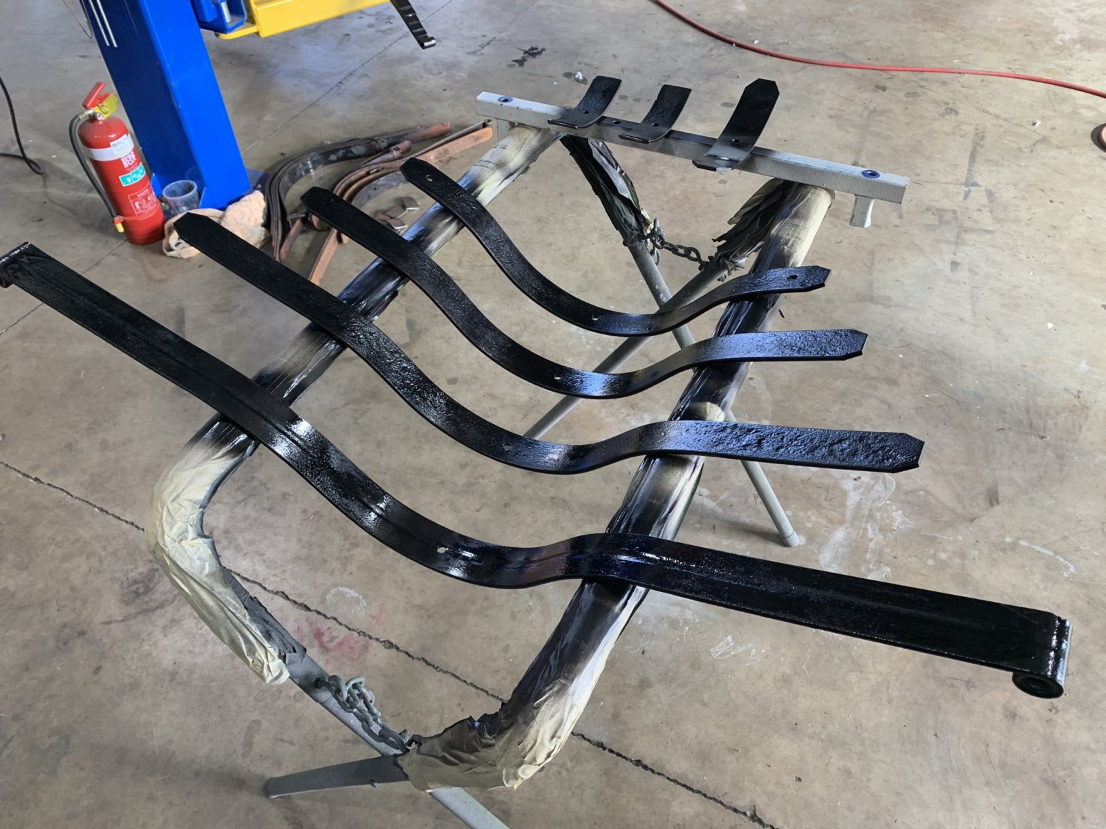

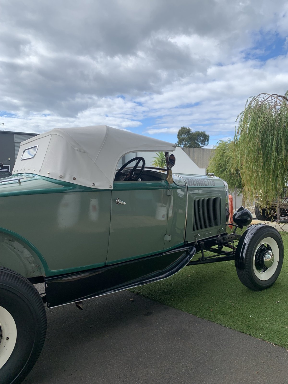

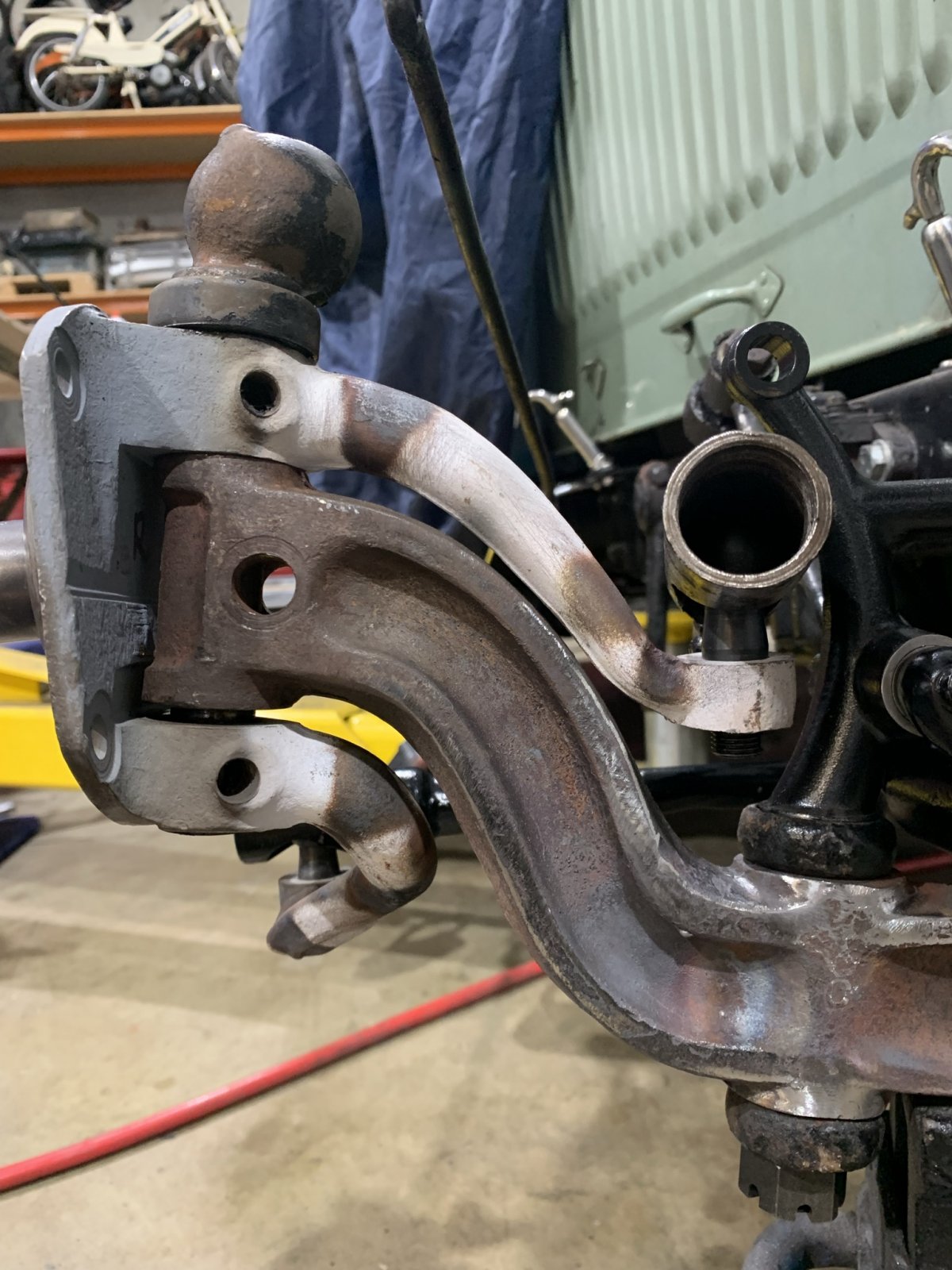

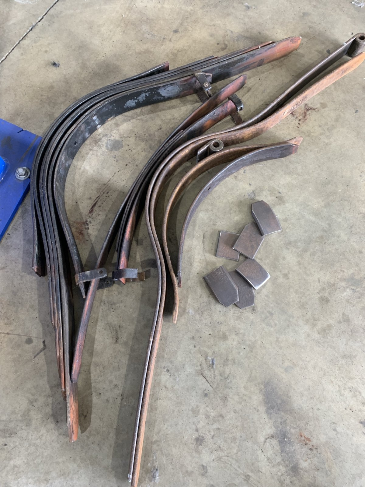

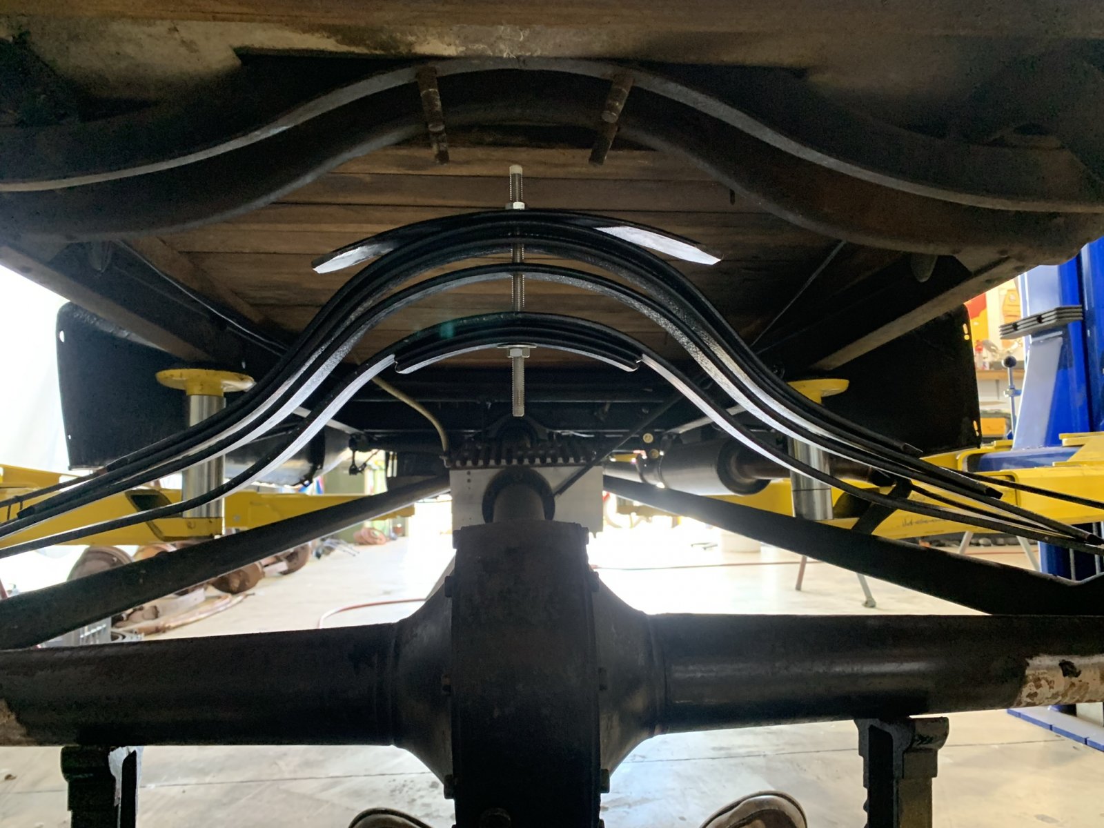

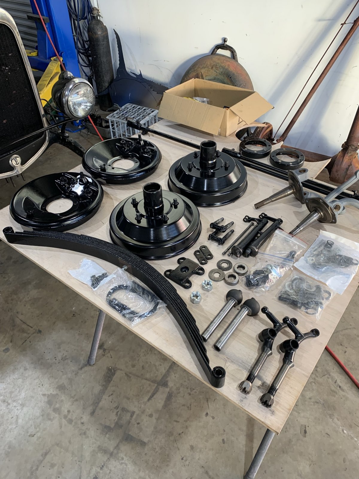

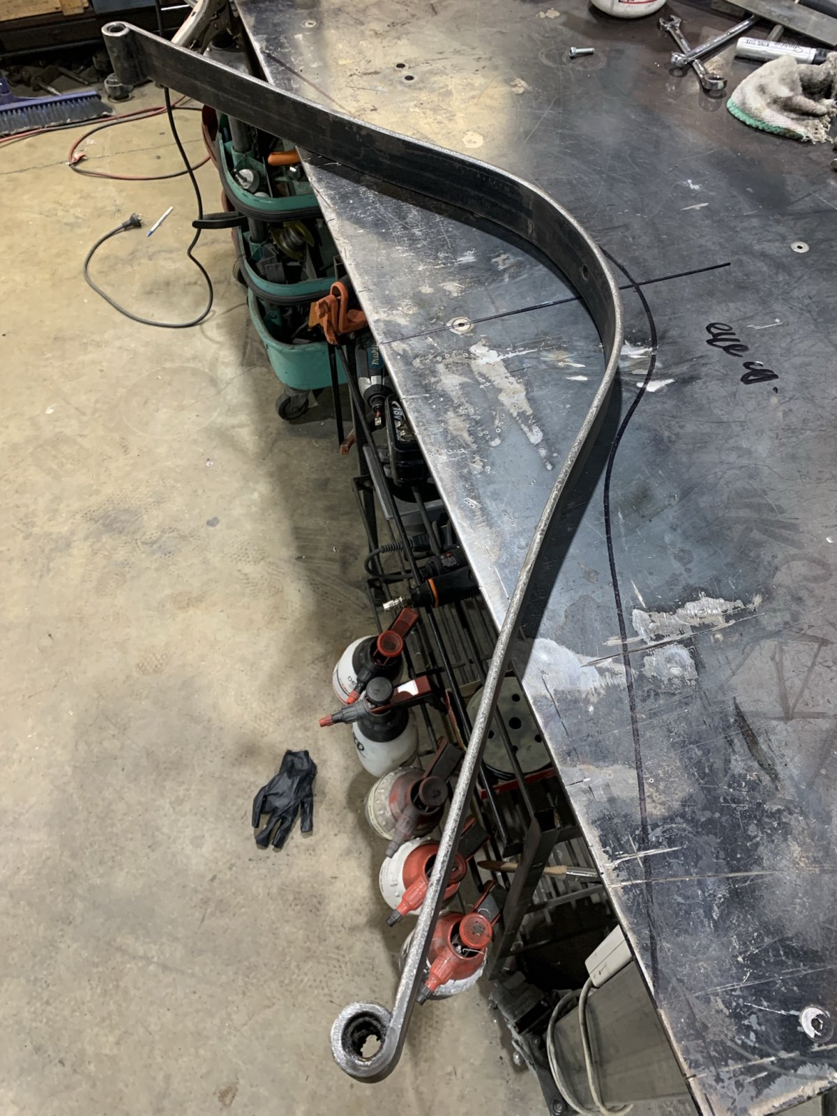

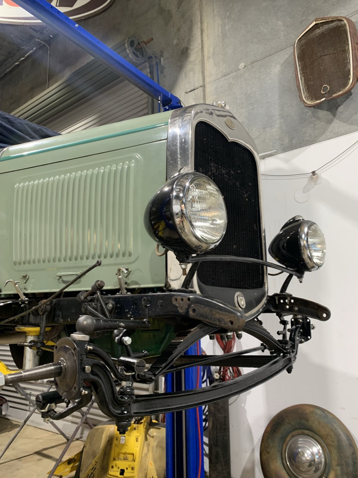

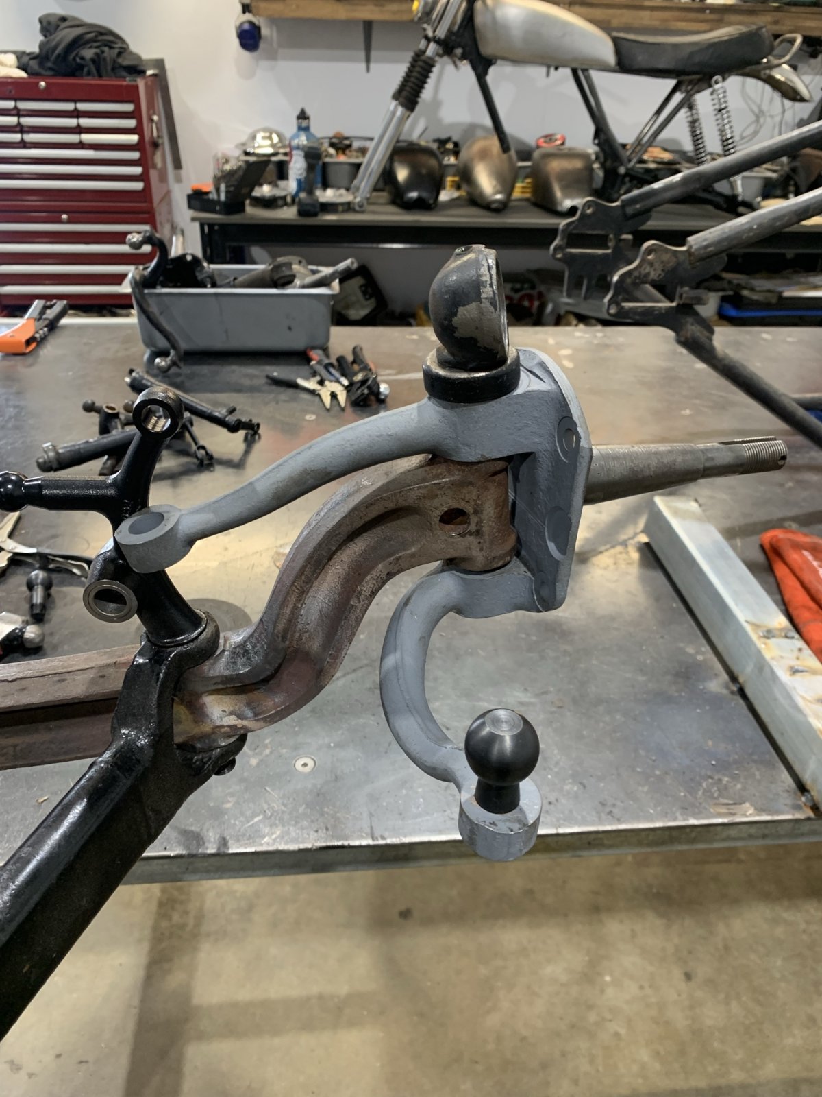

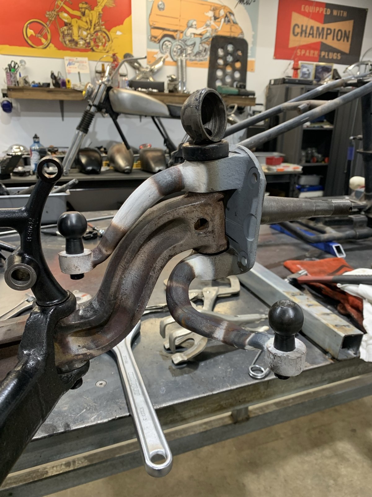

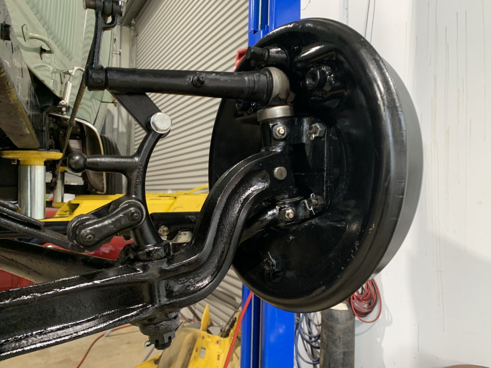

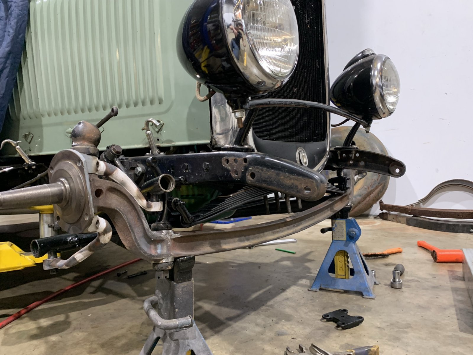

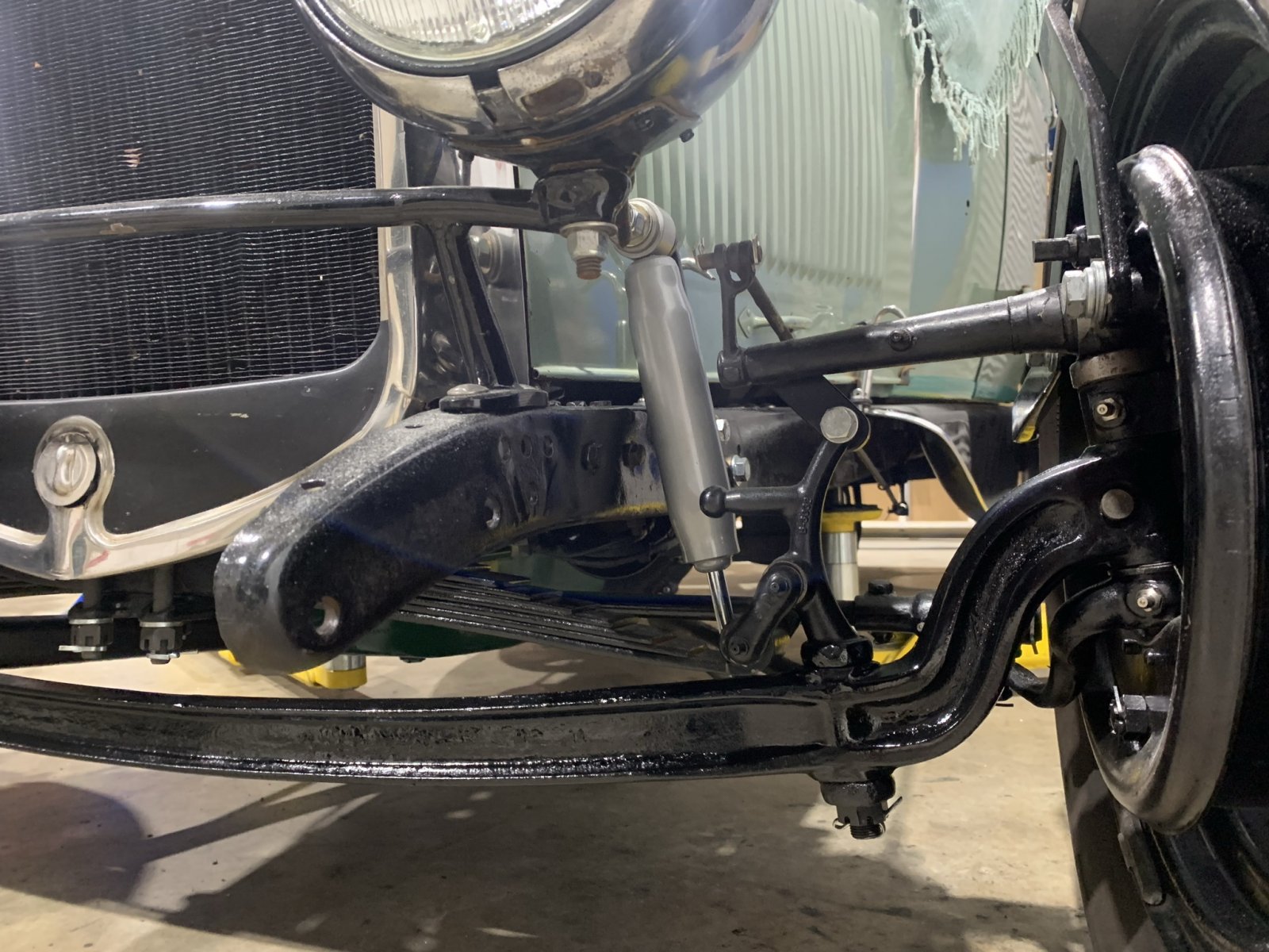

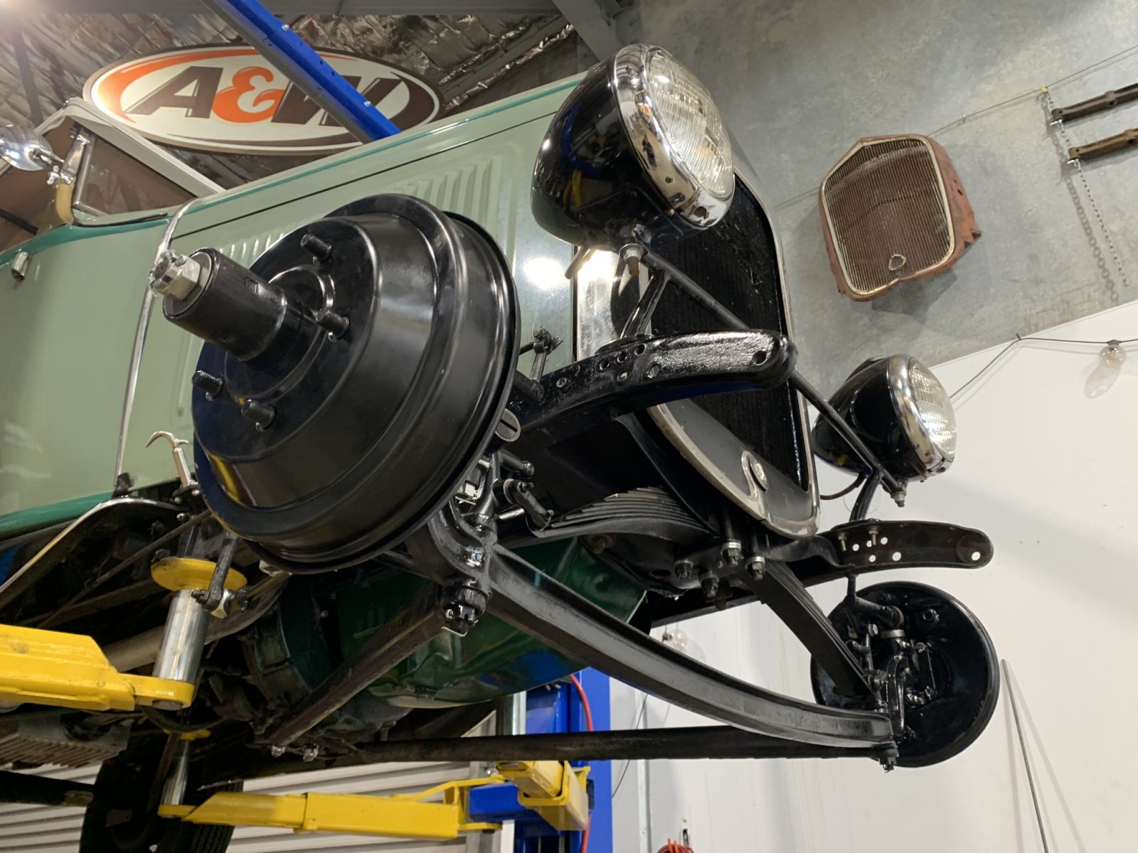

  10. With the new top on the stance needed to be addressed. Lowering was always on the list but wanted to see what the top looked like for the overall profile.

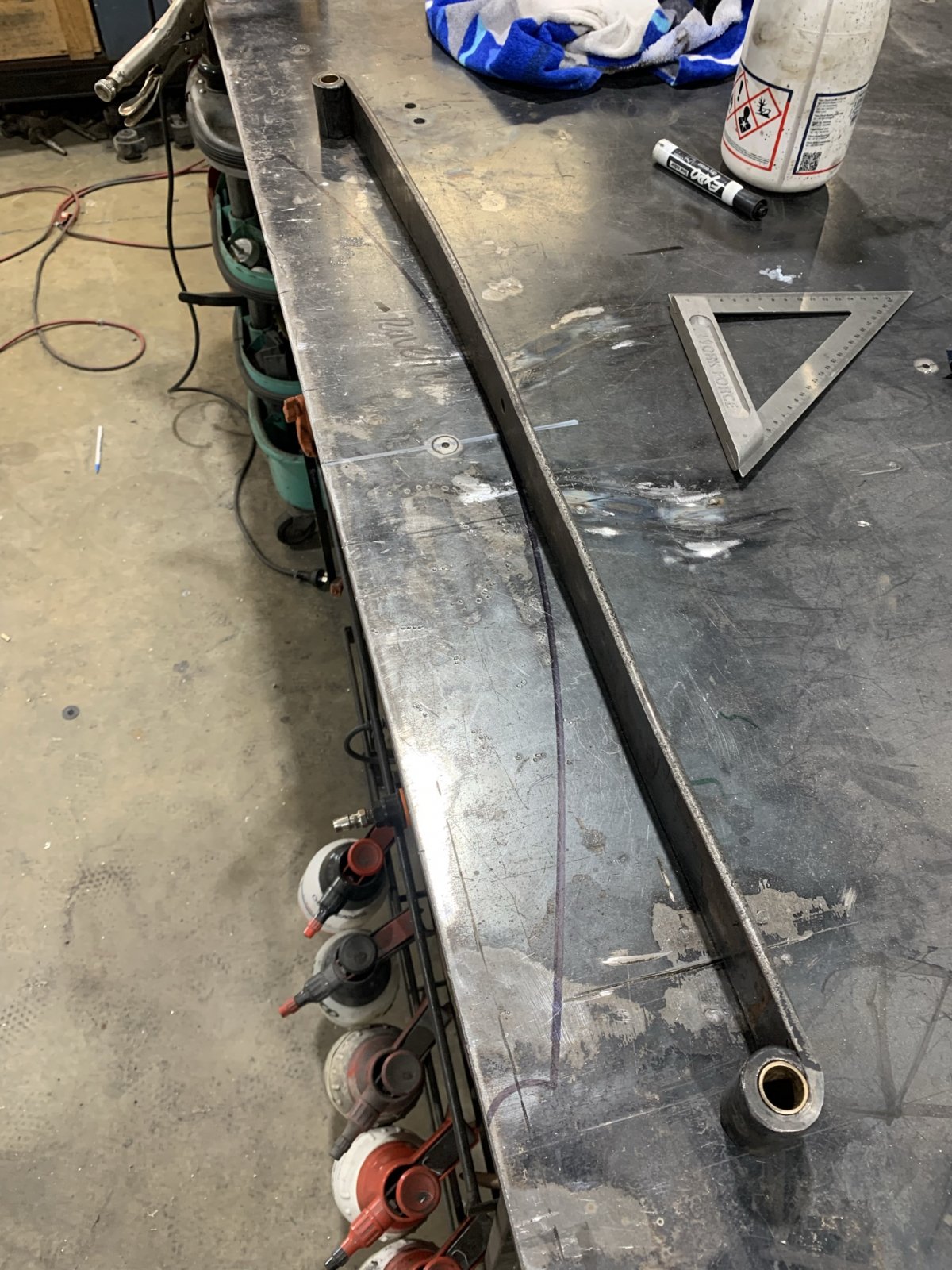

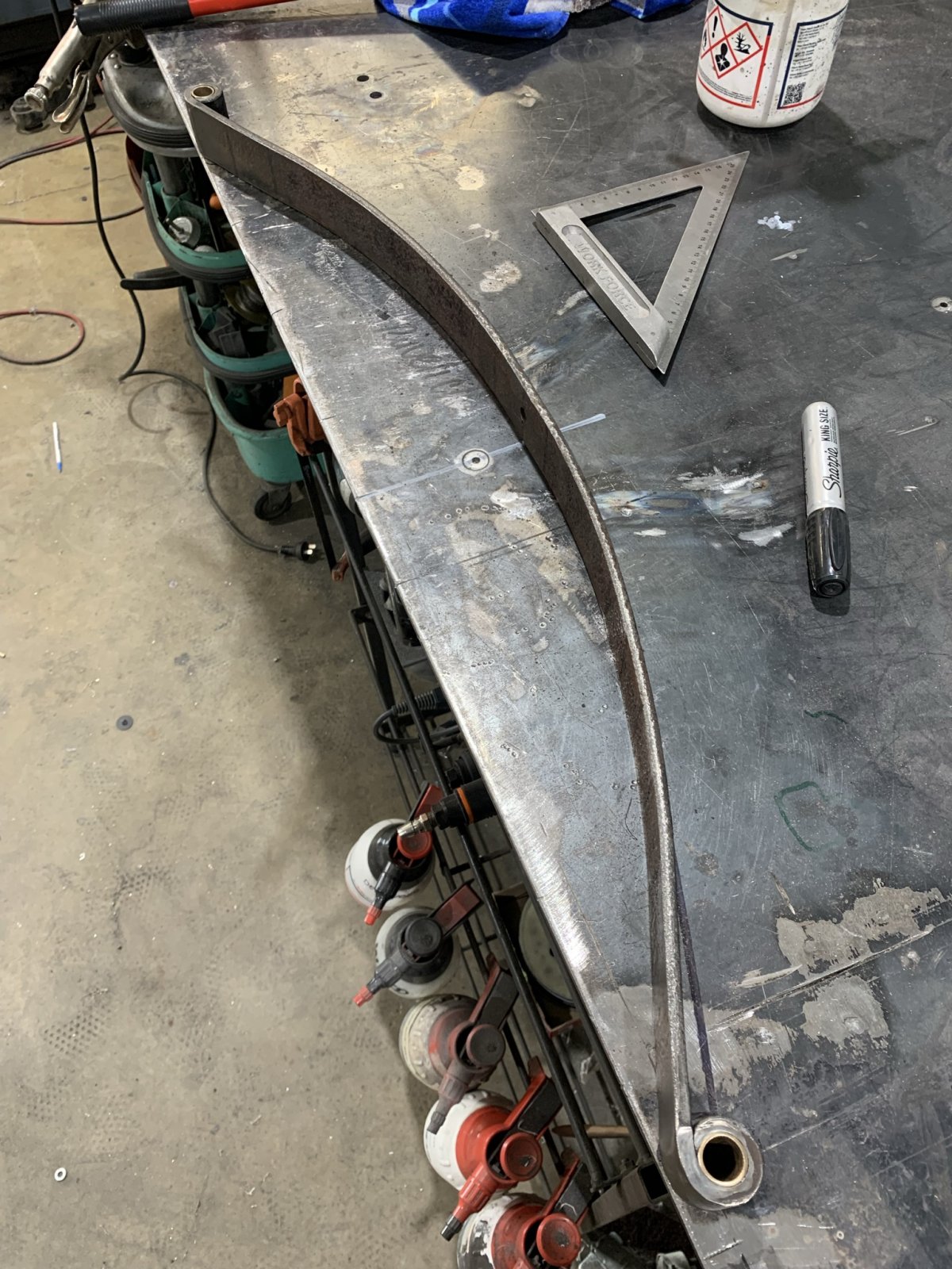

    We wanted to utilize the mechanical brakes still and after a conversation with Alex (steelsmith) about the steps he did I was able to find a set of original 32 spindles and perches. This allowed me to use the 4 inch drop axle and just needed to heat and tend to to steering and drag link arms. I removed the front leaf spring and ‘reversed’ it using a bottle jack and a little jig in the tube bender. This definitely takes time. And slow and steady is how you win this one. Little by little. It did take small trail and error setting up the front height, few leafs removed- a few added. Until the height was found. Modified F1 mounts were bolted in and new shocks fitted.
    The rear was much the same, I used a Model T spring as my profile, unfortunately it had a damaged eye so I used the profile and bent the Model A spring to the same profile. Surprised to see it came out perfect. Then this again was the treatment of adding springs putting the car on it own weight and seeing the overall stance and clearance. I’m sure there many ways of doing this but it was great to create this stance utilizing original parts and doing it way the it was done before. Ready for photo spam! 8EB3FBA4-896D-4498-BD11-3BEC066B6724.jpeg E692F0F9-D9A4-4FB7-B66D-352A250A3B1B.jpeg E0DC8B0D-A122-4AAF-8EC4-C1A845F8BFC1.jpeg 03C05A57-5E11-4643-A2BD-11C7B18BE675.jpeg 8A0AACDE-1F51-4005-B8C8-70CA11EAF471.jpeg 385DC9B7-A548-48A9-8797-D1321382CDE6.jpeg B2042135-6D37-455D-8CD1-3F26E98CBE63.jpeg 54E6C4B3-45E4-428A-B5E5-BC61C17F762F.jpeg 9D19FD19-C09E-4063-86F7-E907444AEEA3.jpeg 4E3B8130-2BB7-4420-A961-CF2EC60D7F22.jpeg 11545615-AEBE-4CF3-A280-10715A6CD5BB.jpeg B6A1BB57-BDE9-4D8D-8EA2-2B11E4150010.jpeg 42689AD8-B645-45B0-B17E-D326681FEB79.jpeg D84F94C7-E65C-4DD9-97C9-4C1D058EB20E.jpeg D3DEBDE3-3035-4E4E-92D4-BEC3AF47CC66.jpeg BC089610-6113-4E85-96A5-8D85E9D19BB6.jpeg 609FADED-EDDF-4E81-8E7B-10E297F6CB31.jpeg 402DE3B9-E9CD-4A4A-AD79-0A8E469A6F2E.jpeg 5AECAF9F-CA74-4D1D-A859-114806B9E863.jpeg 825302CD-9B12-4AEF-83AE-71CD1BB62C40.jpeg
    brEad, catdad49, loudbang and 5 others like this.

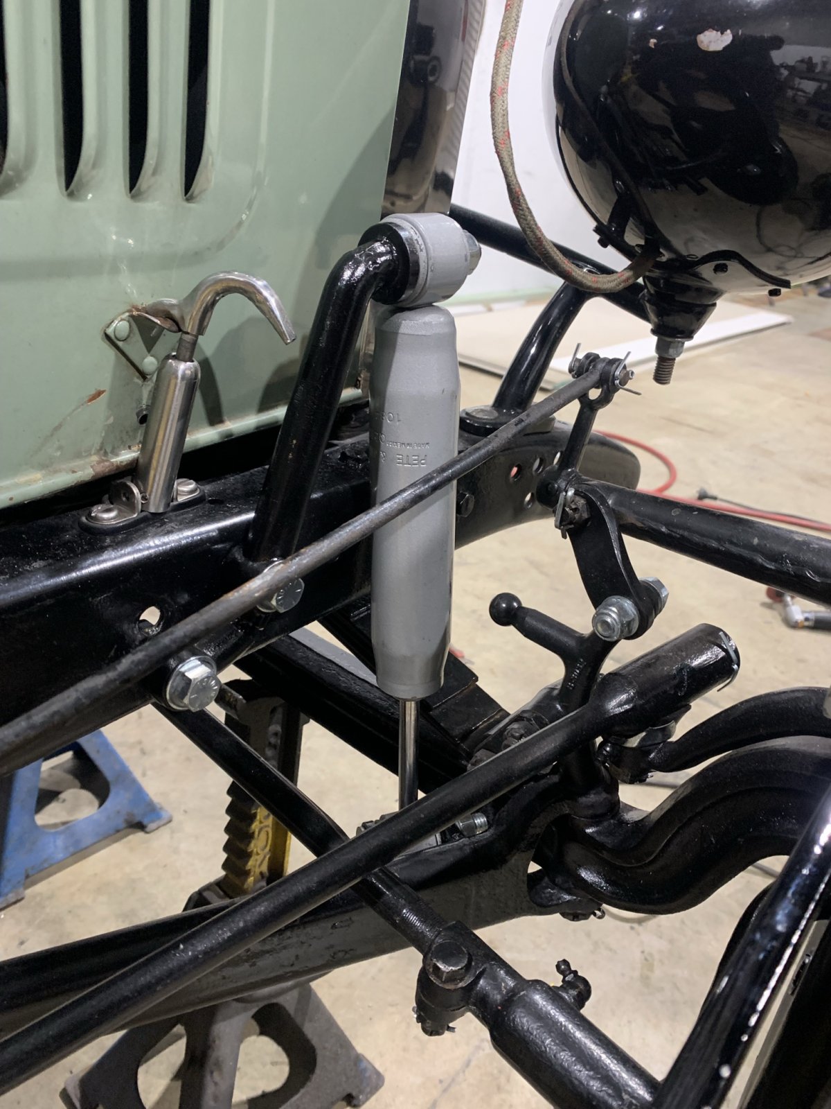

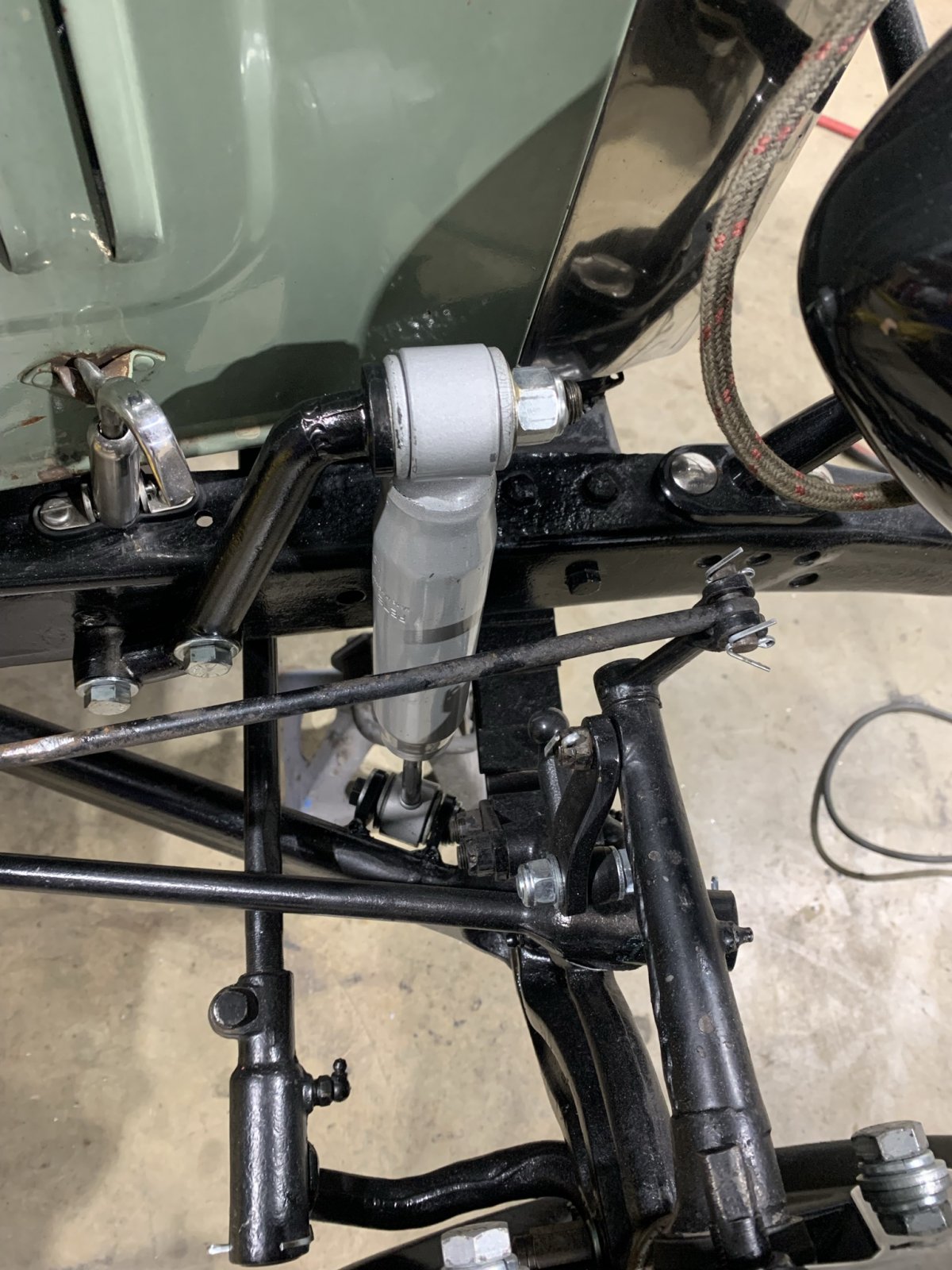

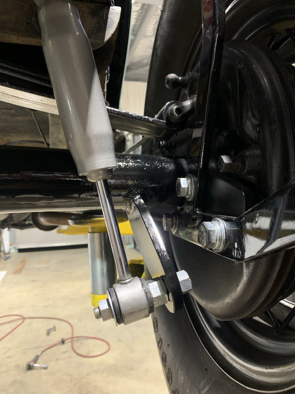

  11. 3179A5C3-BDD4-4F3C-A377-FF8473A2A63A.jpeg 81D1815D-402A-4A62-B3AE-F46C9646991E.jpeg ACEAFDDD-7329-4FF3-A8B5-14E84ADD5252.jpeg 374BB51F-3586-4782-992B-0BACC9B2EA41.jpeg Shocks installed front and rear.

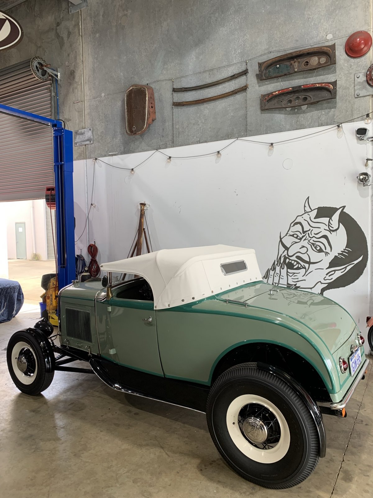

  12. It came along way, and really enjoyed the process with this one. It’s now off to another new owner who is enjoying it every day.
    Plans have been made. The parts pile has grown strong and in two weeks time I’ll start to build the next one I plan to keep for a long time (maybe)
    Stay tuned and keep an eye out for the new build called Bennetts Customs ‘Midnight Special’ this will be a 29 roadster on 32 rails 36 rear end 32 heavy 40 ford brakes flatty with all the necessary speed parts 40 ford wheels 39 Pontiac tail lights 46 ford steering wheel and a 34 Buick dash. I’ll post a link here to the new thread once I purchase the rails and crossmember next week.
    Hope you all had a great Christmas and New Years. May 2022 be a better year for all.

    Beautiful build from top to bottom - very tasteful. I think the cycle fenders are the cleanest I've seen.

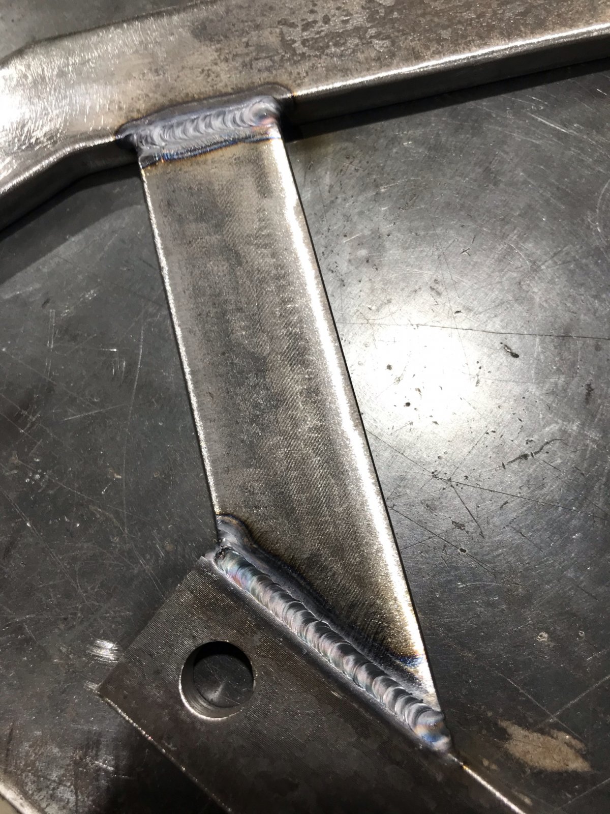

    I’m guessing if I sift threw your videos I’d find the answer but I’ll ask here anyways. On your fenders, do the braces go all the way over the tire/ under the width of the fender? Other than the week at the inner edge how are they attached to the brace?
    they look fantastic, really enjoy your content
  28. thank you for the words! Means a lot. It was definitely a fun little roadster. Definitely a regrettable sale this one! But on to the next!
    Below is a thread to the most current one at the moment
    https://www.jalopyjournal.com/forum/threads/bennetts-‘midnight-special’-speedster.1257714/
  29. Hey Tim- I used 8mm flat bar and graphed it into the thinker material. A v’d end made it easy and strong, made sure it was as close as I could get it to the tire with consideration to the growth of the tire.
