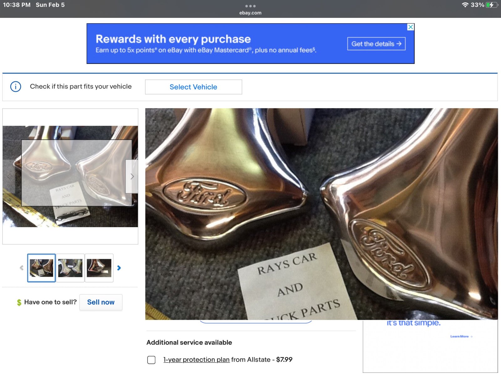

    Finally got my 34 on the road. The exhaust comes all the way back and under the center section of the independent rear then up and out the back. Looks like the exhaust is going to blow straight on to the rear spreader bar/back bumper.
    I was thinking of adding the flat and wide tips/deflectors.
    Any experience with them? How they look? If they do much deflecting?
    Do they change the sound much?
    I mainly want not to soot the spreader bar without adding turn downs.
    Already getting busy down there.

  3. Shake n Bake
    Joined: Jan 23, 2010
    Posts: 28
    Shake n Bake
    from TN
  4. Shake n Bake
    Posts: 28
    Shake n Bake
    from TN
    the plate is moved up between the tail lights and the exhaust comes out about where the tag is.

    My buddy has a set on the back of a 56 Nomad. I don’t see that they do much. But the back of any wagon is kind of a suction chamber, so might be different for you.

    Wont do anything to prevent soot on your spreader, there is too much turbulent air under there at speed. May work when you are stationary.

    I have them on my RPU and have never had exhaust residue on my nudge bar or tail gate.
    Question, why are the tail pipes aiming at the spreader bar? JW

    When it is all together with the spreader bar in place wouldn't it be simpler to have the muffler shop bend some tips that directed the exhaust Down past the spreader bar? It looks like you have a few things to take care of back there including the spreader bar and then figure out the last few inches of the exhaust.

    If you want the look of it but don't want the soot, cut your pipe to have a hole in underneath and a 45° blocking plate at the rear of the hole. Paint the inside of the pipe matt black. Hidden turn-down.
    Any tip you put on will never get dirty...
