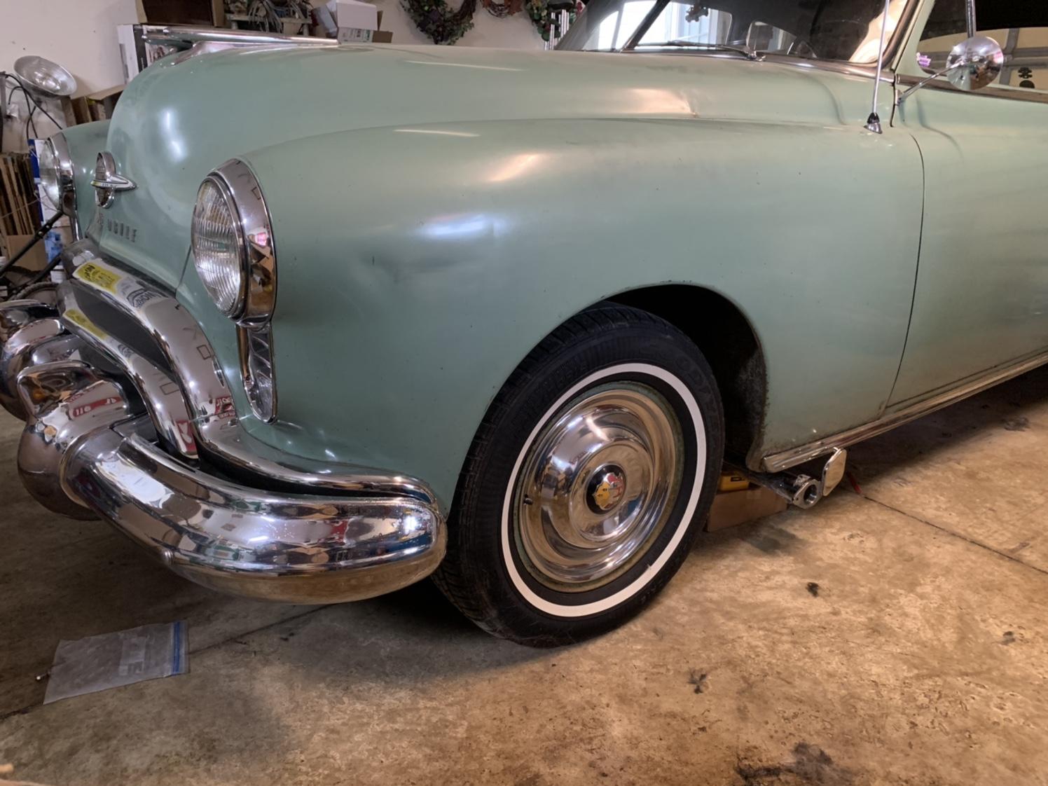

    Mock up of the dump tubes, that is where the exhaust will permanently exit, can’t wait to get the the system done. Got lots of other stuff on the list [​IMG][​IMG][​IMG]to do first.

    When I was growing up they were called “cutouts” dump tubes were under the car about 1-2” behind the rear end on each side of the differential on a jacked up rear. Most had flared ends and looked good on 59-60 Chevs. Some called them scavengers....

  6. To do Cutout's correctly the pipe needs to be joined at a bologna slice as close to the manifold or collector as possible so you actually get Exhaust out the end. If you do a 90 degree joint you get a **** sound much like a Hole in the head pipe. I run mine open a lot.
