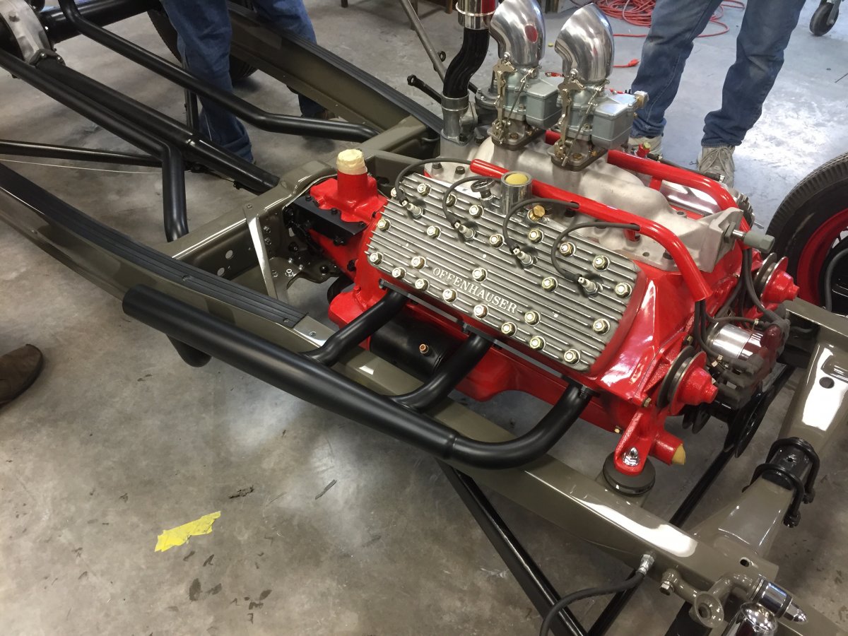

    Just received my exhaust headers from Red's for my AV8 and to tell you the truth they are beautiful. I really don't want them to rust and I don't like the looks of wrapping them so what kind of paint or high temp sealer is recommended to keep them from turning into rust.
    Is there a high temp clear that could be sprayed on???
    If I have to paint them it would probably be black or maybe white.
    thanks for any help.

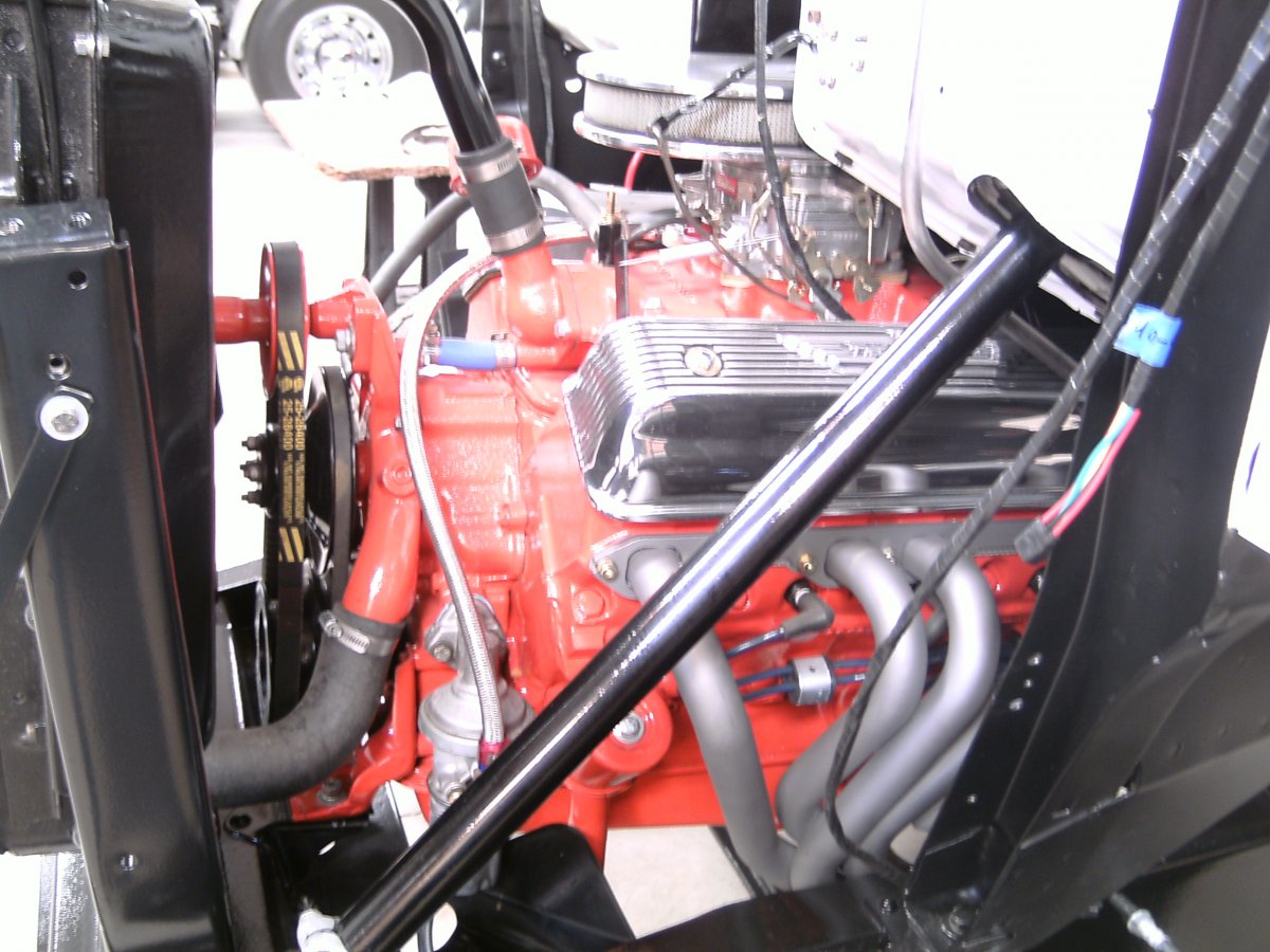

    Both of these were coated and still look as goos as the day they were done. image.jpg image.jpg
    chop job likes this.

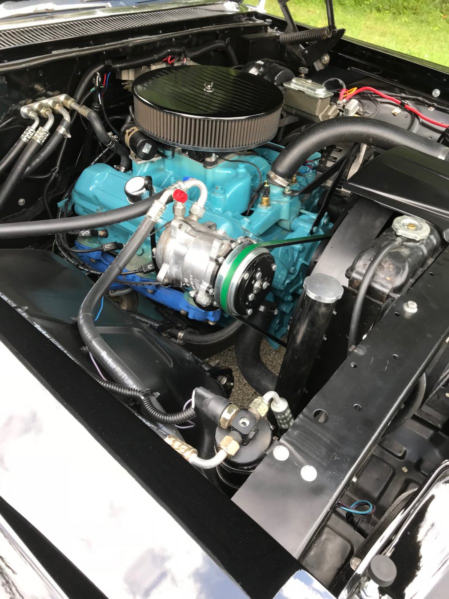

    I used KBS high heat primer and paint, the headers were used and came on a 312 in a 56 C600 series Ford truck, I had them sand blasted and then hit them with the KBS and followed directions to a T for a change, and as 46 caddy said keep you fingers off of them, I've put several hundred miles on that truck and no problems. PICT2599.JPG
