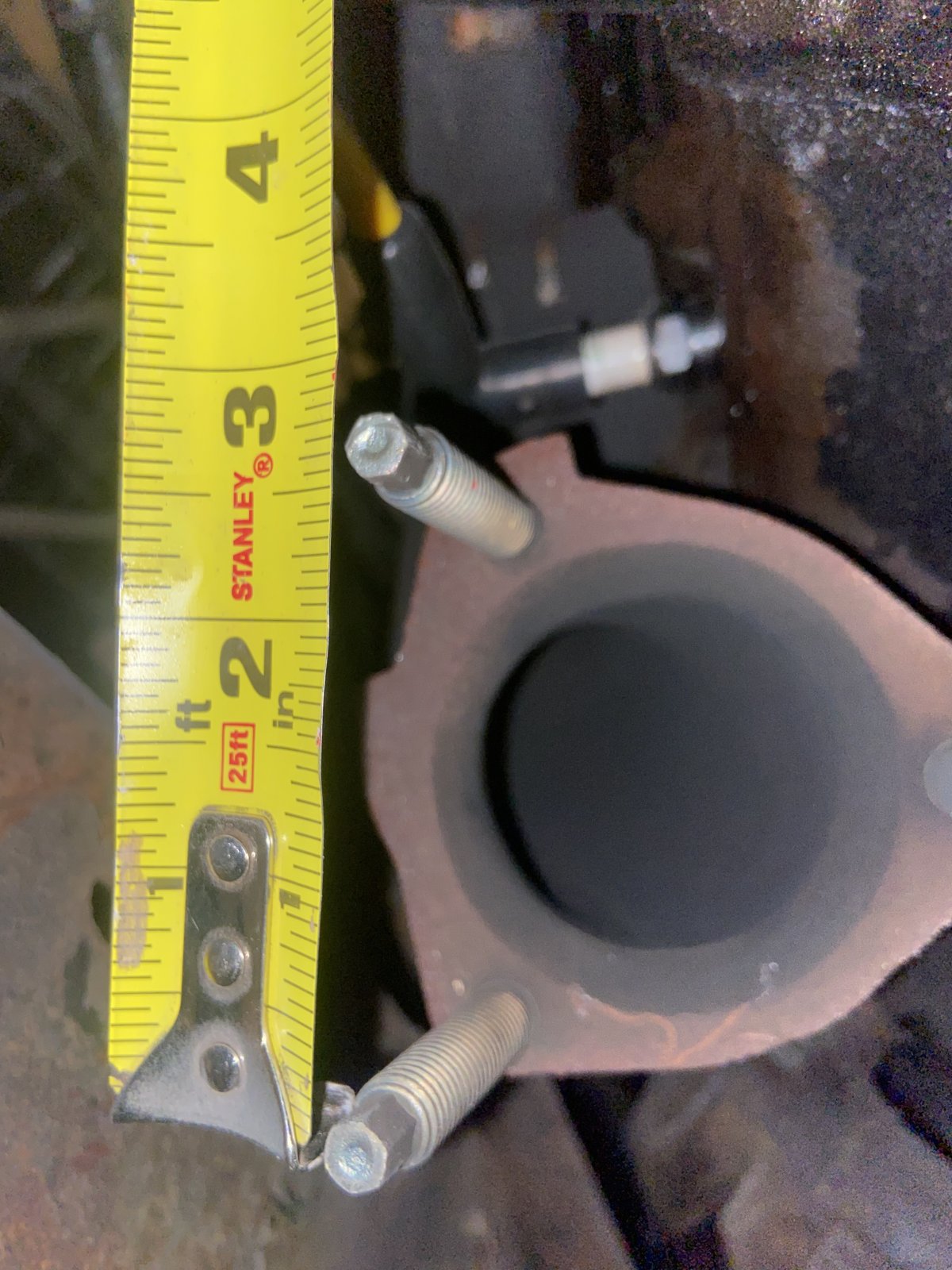

    As always, pictures would be helpful. But if the bolts on the manifold outlet are 2.5" apart there is no way the exhaust outlet itself is 2.5", more likely 2.25" or even 2".

    This is what I measured. The output opening I believe was Looking at it correctly. But I have had a few beverages haha

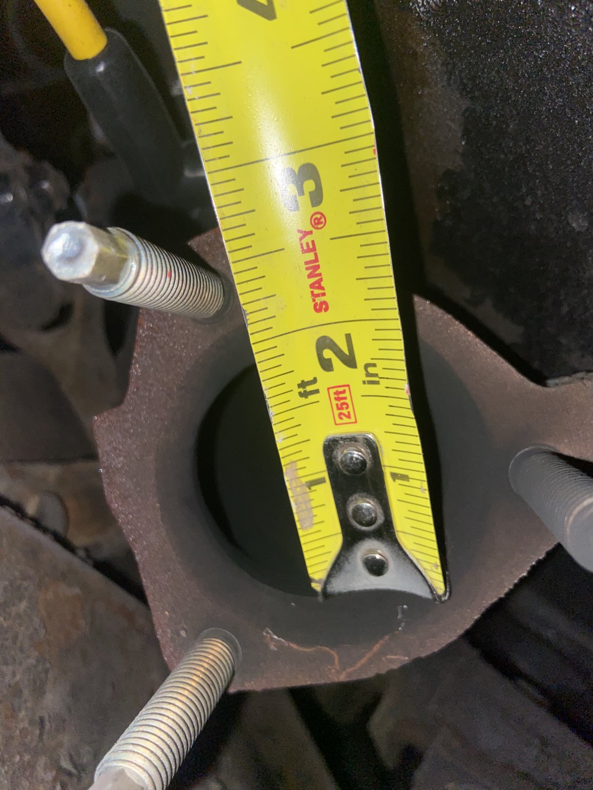

    Here’s the best pics I could get from underneath.

    What are the manifold's off of? You're going to need the doughnut's, heat riser gasket , and heat riser/heat riser delete spacer. Depending on application, you may not need the heat riser/delete spacer. Once you get all of that sorted out, you can start with the factory style head pipe flange's.

    Most old Chevy manifolds have a 2” head pipe with a slip-over donut for a gasket. Corvette versions were for 2 1/2” pipe. If you have the factory flanges, donuts and the old pipes you can work with that and adapt it to the new 2 1/2” system. If not, you will have to find a good old muffler shop and buy some flanges that fit your manifold outlets and some tubing for stubs.

    If it's your run of the mill, standard SBC manifold, it's usually a 2" outlet. How much of a headache is it to remove a manifold and take it to a local NAPA and match up what you need to what you have? Does Summit give any critical dimention's for the manifold's? Or do what @bchctybob said, because he type's faster than me! LOL!!! :D
