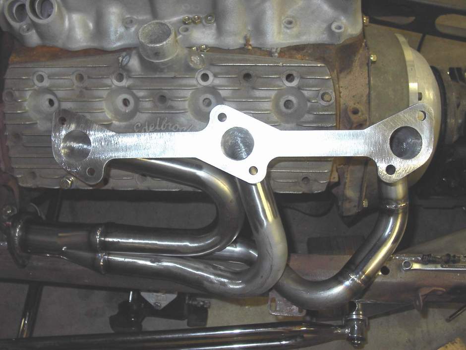

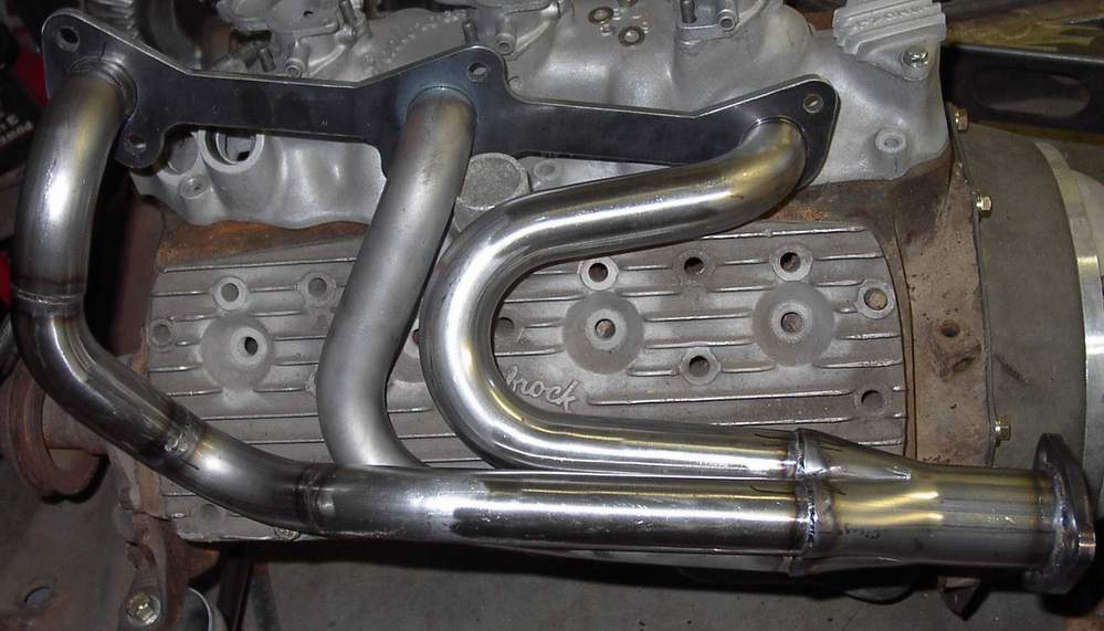

  27. A Chopped Coupe
    Joined: Mar 2, 2004
    Posts: 1,133
    A Chopped Coupe
    Conceptfab,
    Well put, here are the ones I did for my flathead.
    To put it in simple terms, when you build custom headers, you build for that specific motor, and that specific chassis.
    I love building headers!
