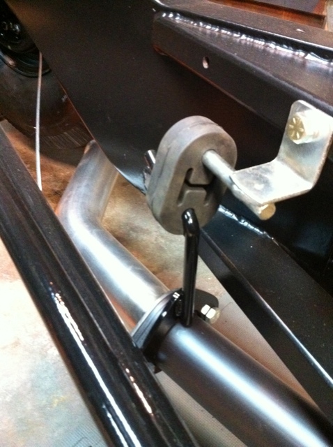

  15. Sanded the pipes with 80 grit then cleaned with paint prep solvent and coated with VHT,
    hung it up to dry till the next day. The first picture was 3.5 years ago with 4 trips to the salt, just pulled the headers this week to re do. The pipes still look OK. The second picture is from 2 years ago.

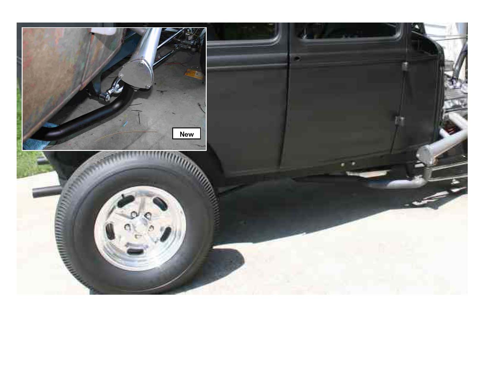

  23. hr31hr
    Joined: Nov 30, 2006
    Posts: 221
    hr31hr
    from PA
    Comparison pictures..
