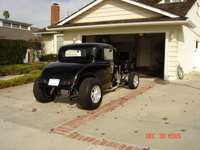

  20. I have done it many times, and not because of laziness or cost, but it fit a style I was looking for. And it the right mufflers are chosen there is no drone, just like any system, I've heard plenty of systems that go out the back that drone like a mother F'r. This was my 41 coupe done that way
    When I did the exhaust on the 40 Ford Road Tour car this year (built by Hollywood Hot Rods for that magazine), I dumped it in front of the rear wheels as well, but really hid it so you had to look to see a little tip sticking out - and it got many positive comments
