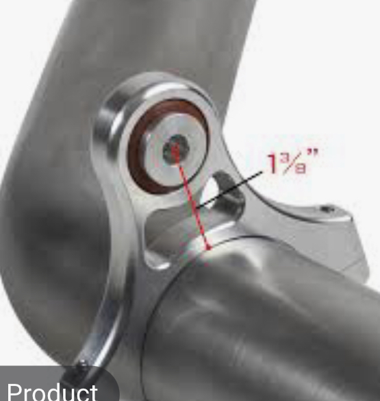

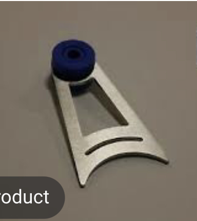

  12. 15F22E54-2FFB-4327-88D9-1EAD419186A4.jpeg A24DF086-C02E-4757-8851-3B785FA767C4.jpeg 34490F71-D66D-4CE7-A3A6-536EFE6EC193.jpeg 8395269D-10A0-4860-BEBF-C070D0CF6415.jpeg
    Here are a few online pics.
    I usually build something like this last one
    mgtstumpy and Pist-n-Broke like this.
