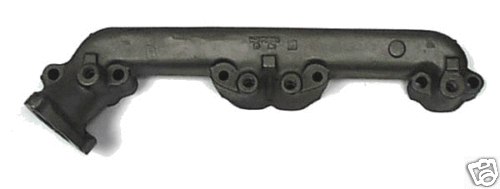

    So a buddy of mine has a 46 plymouth that hes getting ready to put an sbc in. The drivers side looks like its going to need a header or exhaust manifold that dumps at the front. Is there a header made this way?

    Dunno about a header, but IIRC, '55/56 stock manifolds can be mounted for front dump.

  4. Just swap sides with the stock manifolds.
