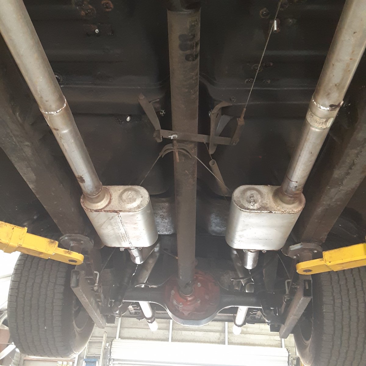

    Dump them in front of rear axle under the back seat with turn downs? I did this to my OT FE powered Fairlane and again on my current FE powered 64 Fairlane. You do get some reverberation noise issues however no toxic fumes.

    Go up and over the rear axle and out the back under the bumper. Not what you wanted to hear, but..... Some times if you stop before the axle you get weird resonance and noise inside the car, plus fumes. If you go under the diff it's hard to get the pipes to the rear bumper without being too low and looking stupid. Also going under the diff has it's own clearance issues. Just my 2 cents.
  4. What @mgtstumpy said, going under the differential can be done but causes clearance issues.
    extend your exhaust pipes to just in front of the rear wheels, much simpler and you get the same effect of no fumes in the car.
    ive done this on a couple of off topic cars I’ve owned.

    Here's what I've done on numerous builds, since I have no access to bending exhaust pipe, and too frugal to pay for it. I've simply bought from Jegs or Summit an exhaust kit from header back for '68-'72 Chevelle in 2.5". The last kit I bought last year was $170 for everything including turbo mufflers, clamps, hangers, etc.
    I don't use any of the clamps, and I weld the whole system up. I've used these kits on a '63 Falcon, a '35 Plymouth coupe, a '69 Nova, a '56 Chevy, and a '39 Chev coupe. All worked great, and all ended up with various amounts of leftover pipe.
    I start by going through the various pieces and figuring out how to use the pieces with the least amount of cuts or welds. Normally from the muffler back over the axle, and out the back, I can use the kit just as it comes. Then I simply choose from the other pieces forward of the muffler and begin cutting and fitting. I hold pieces up and tape them together, and mark with a felt pen. Tack them as little as possible on each side to test before final welding, and then take them down to weld it up. I usually end up with just one weld being done completely under the car, and that one is almost always at the inlet to the muffler.
    This setup is easy, cheap, and makes for a nice system I can do in my garage in 4 hours or so.
