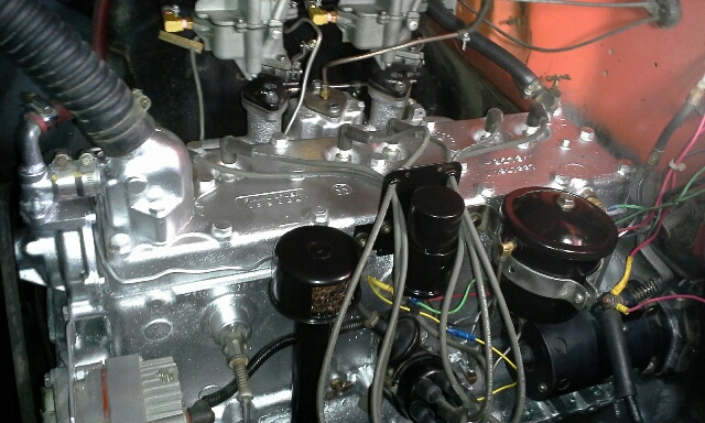

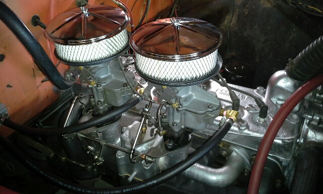

    Okay I have a Chrysler flathead 6, dual Carters 1 bbl B&Bs, tru split dual exhaust manifolds.
    This set up is in a 1955 Fargo truck.
    I cobbled together exhaust with 1 walker stock type huge oval muffler, and 1 walker huge chambered muffler off a motor home.
    Not only doe this sound pretty quiet and lame, I really wonder how much power is being robbed from an already limited power source.
    The tail pipes dump at the rear diff, pipes are 2 inch front to back.
    What do I need to do, A) make it sound better, B) make the most power?

    Thnax Guys for thoughts on this, my set up being an inline 6, with dual exhaust, just trying to get advice or a feel for correct pipe size, and that type of stuff.
    I truly believe the big mufflers on it now are restrictive and robbing power, which it needs all it can get...
