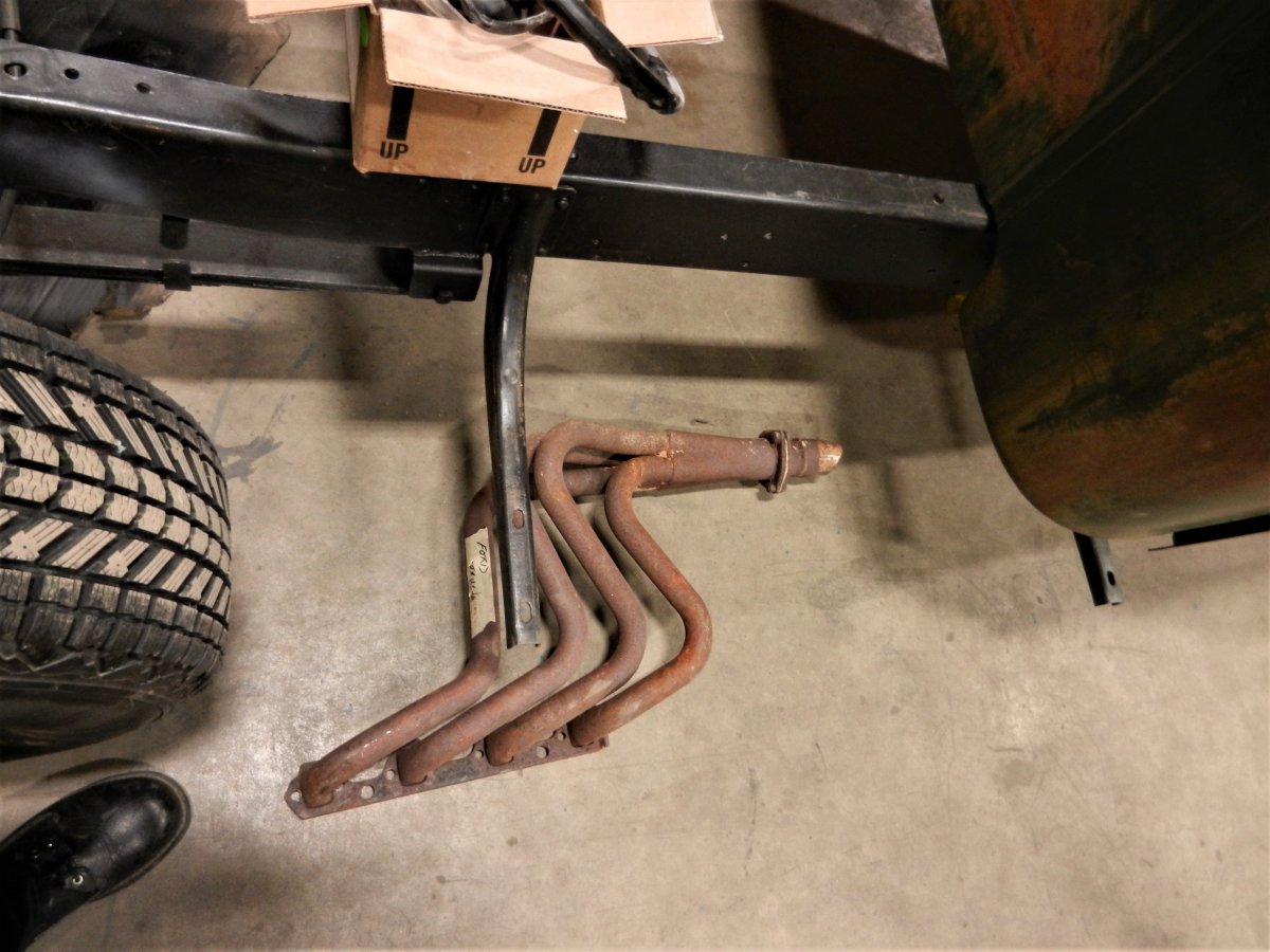

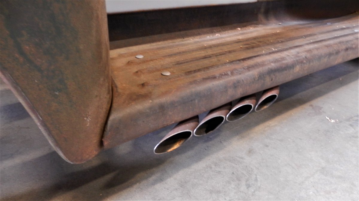

    Here is the set up we did on my 1951 Mercury M3.
    I do not like the mis-aligned, cut your legs up dual pipes coming out from under the back bumper, so I tried this.
    Found a used Ford header at the the swap meet for $10.00, seems to not know which direction the air is flowing.
    If you need to know, the frame was done in Candy Apple Black Tremclad (way better than Rustoleum) with a lint-free roller.

    So only one pipe is functional?

    no he ran the header "backwards". putting the exhaust into the collector and out the individual pipes.

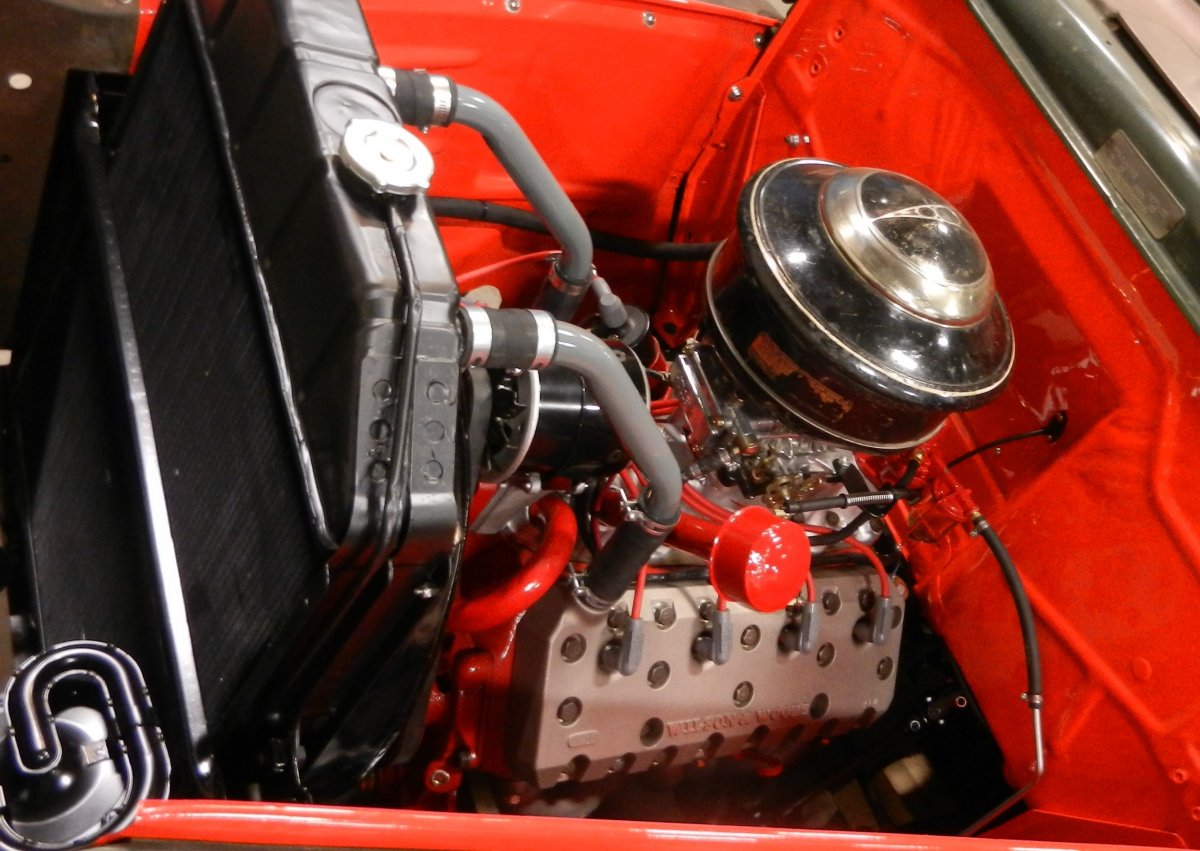

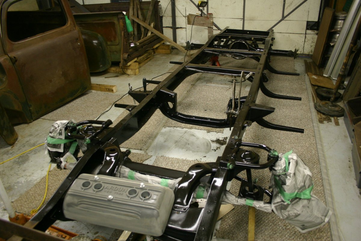

    ]That’s a fine looking work truck , how ‘bout some more pics?! Thanks. 5 02-04-06a Frame.JPG DSCN9665.JPG 12-27-04 Big   xa.JPG Engine 274.jpg DSCN9250.JPG
    OK, here you go. Started with a 1951 Mercury M3 I found at a farm in Saskatchewan, the owner had 250 trucks neatly parked in rows, in there were 60 Mercury trucks, I bought 2.5 trucks and started the vision. I left everything that the original owner had done to the truck, grain chute on the side, grain chute cut into the Mercury tailgate, auxiliary box light, extended driver's door mirror, heavy duty rear bumper that was different left to right. Just funky stuff I liked.
    Started with rack and pinion steering, four wheel disc brakes, 274 inch flathead with Holley four barrel, Fenton headers, set number 11 of Wilson Woods heads, Ed Iskenderian ground the cam for me, the intake is the first Edelbrock 4 barrel manifold re-produced. Vic did not have Edelbrock boxes done for them yet and it was sold to me after they were done with the catalogue photos., Tremec 5-speed using the original pedal mounts (very trick set up)

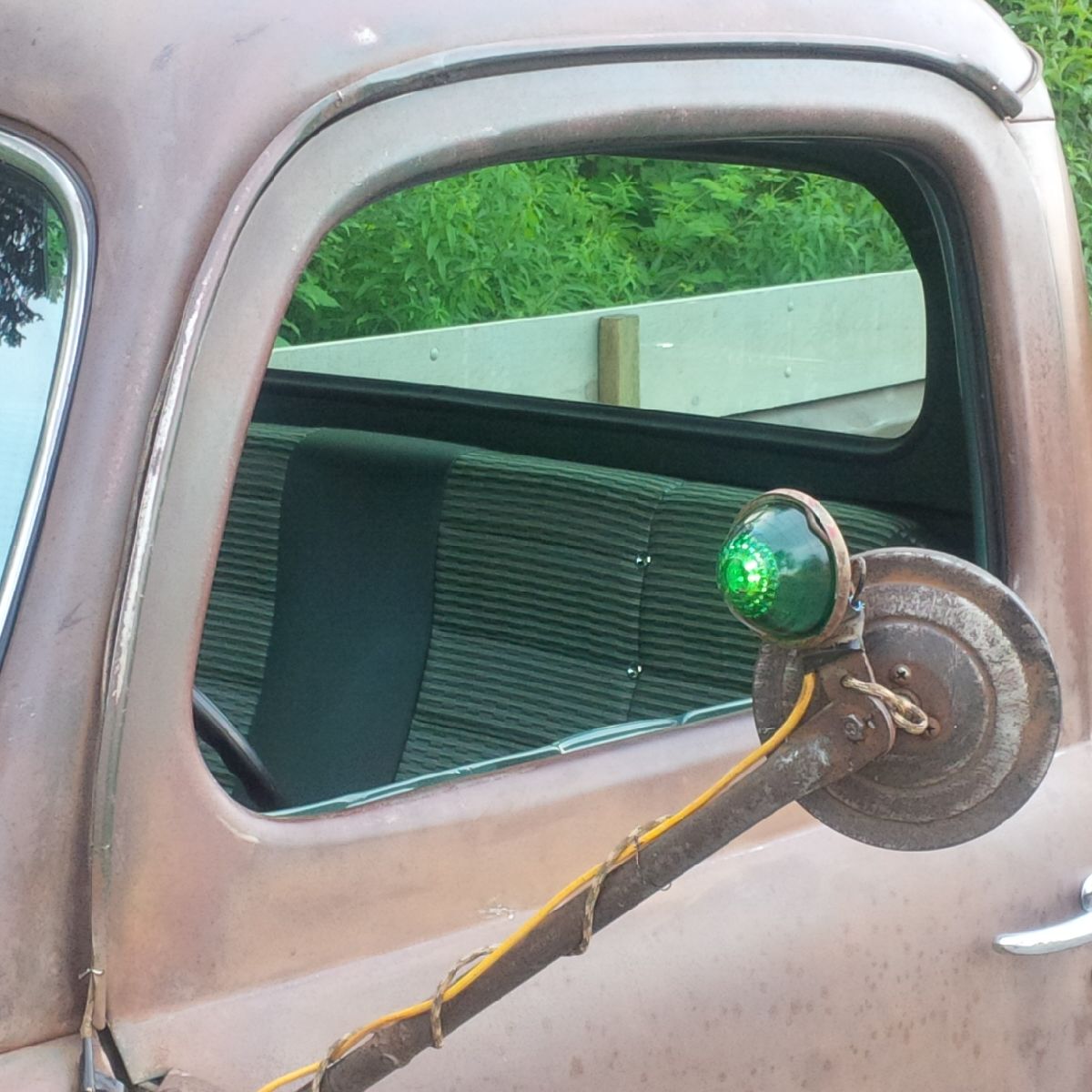

    Boxwood is alder from Saskatchewan that was cut and milled, then painted to look like a DEW Line sign. US guys use Area 51 and I wanted something Canadian. Which is also why I used as much Robertson hardware as possible. I also re-used as much of the square headed hardware that was removed when I dis***embled it.
    Taillights were found in an old fire truck that was at a garbage dump at a deserted saw mill/ghost town. I think they are 50's ambulance. Split them in half and added a second bulb. They are plastic, so I rusted one of them up, spray bombed them from a distance and added floor sweepings that I had saved 10 years earlier when I took it apart. The green light on the mirror was an old truckers accessory to show oncoming traffic how wide you were., if you look closely along the drip rail you can see where the farmer ran the wire for the box light for shoveling grain at night. 2017-03-15.JPG IMG_20170605_181051.jpg IMG_20170605_180721.jpg IMG_20160727_195625.jpg IMG_20160727_195639.jpg IMG_20160727_200132.jpg

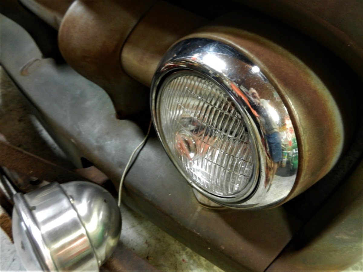

    Took some brand new HID headlights, broke the lens out of them and added 1950's Autolite Bullseye lens', laminated hockey sticks for stake pocket brace, Rick 'the Axe' added door graphics, different on both sides, original fencing nail box left on. DSCN9920.JPG DSCN9922.JPG DSCN9415.JPG DSCN9457.JPG DSCN0403.JPG DSCN0399.JPG

    I think wisdonm is correct, only 1 pipe being functional. It does not look like the header is just installed backwards, it looks like he cut the individual pipes off the header and attached them for looks.
    Look, no collector:
