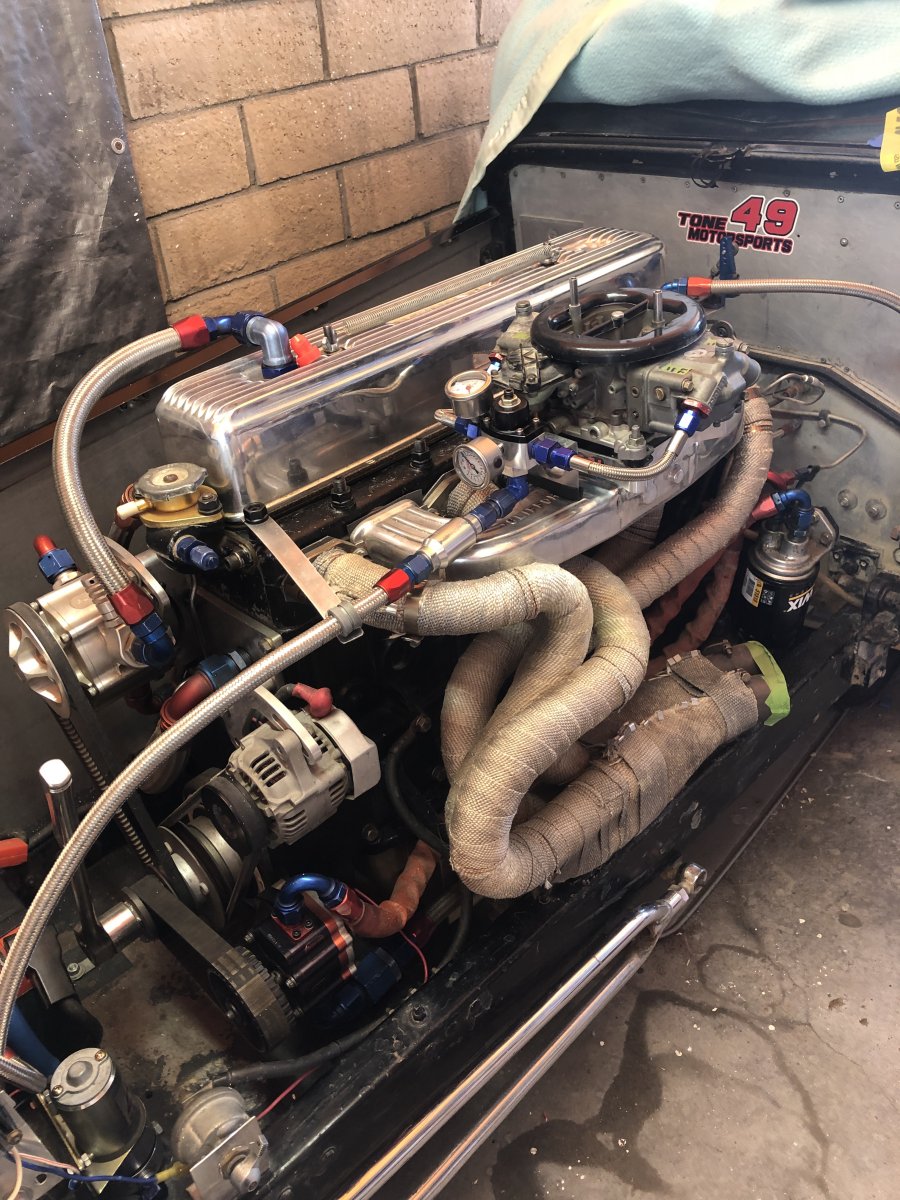

    Do them with the wrap material wet. I use DEI clamps and bailing wire to hold it on. 2998AD38-6394-4F46-9493-C857E9F329AD.jpeg
