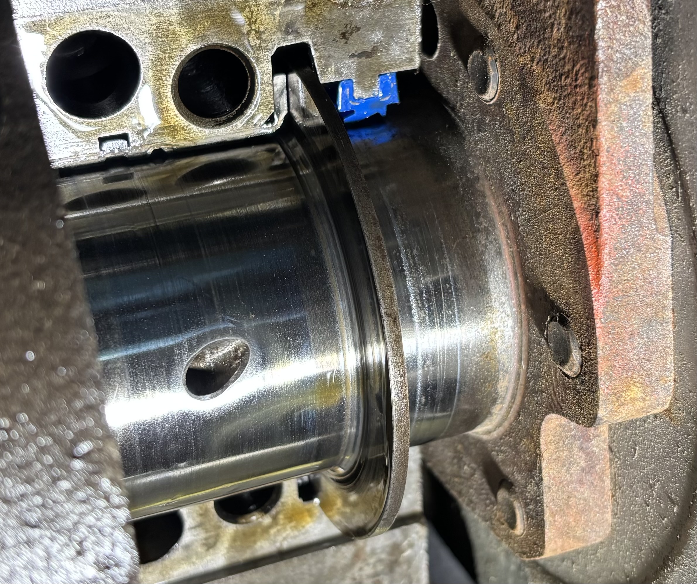

    This engine was built in 2000/2001 and sat until 2023. My God Father spent this time building the car so the engine was never turned over and I was told it may have been slightly locked up and I am not sure what the hot rod shop he worked at did to refresh it and or on budge it free. Also not sure if they performed any type of break in procedure. No serious metal in the oil that was drained.
    I am trying to address the mechanicals now that there is 600 miles on the motor/car and one of the big things was the rear main seal was leaking badly.

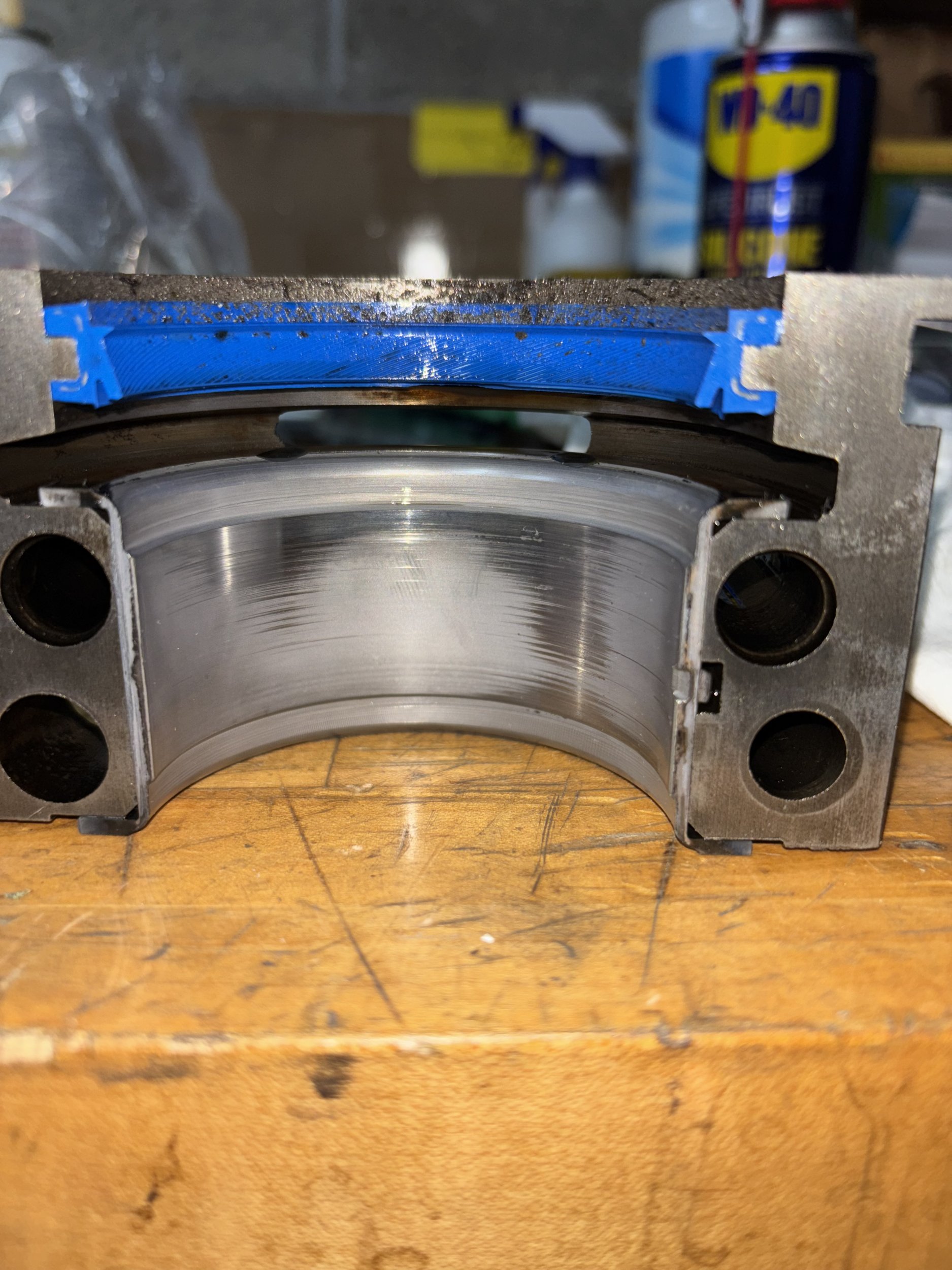

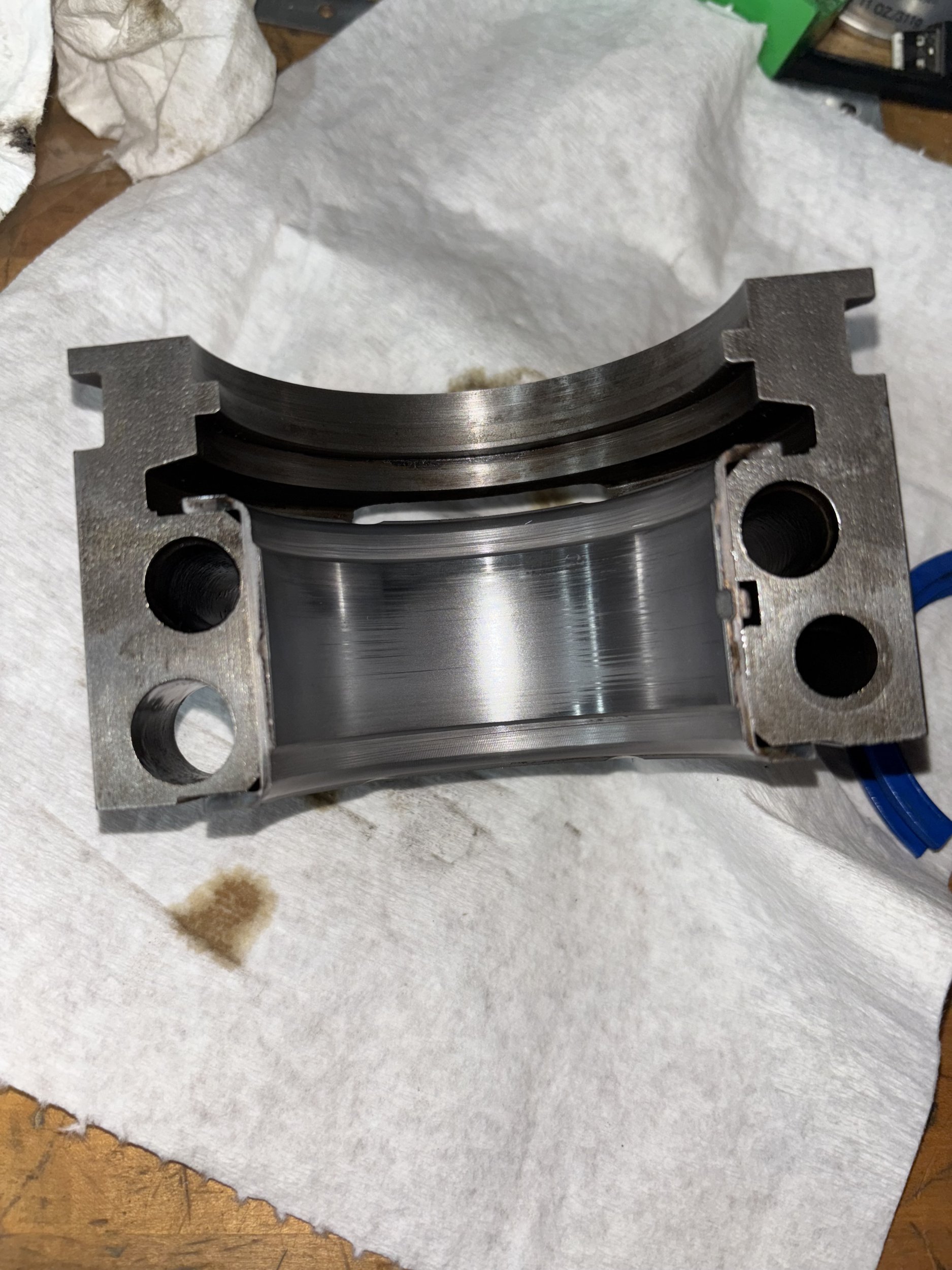

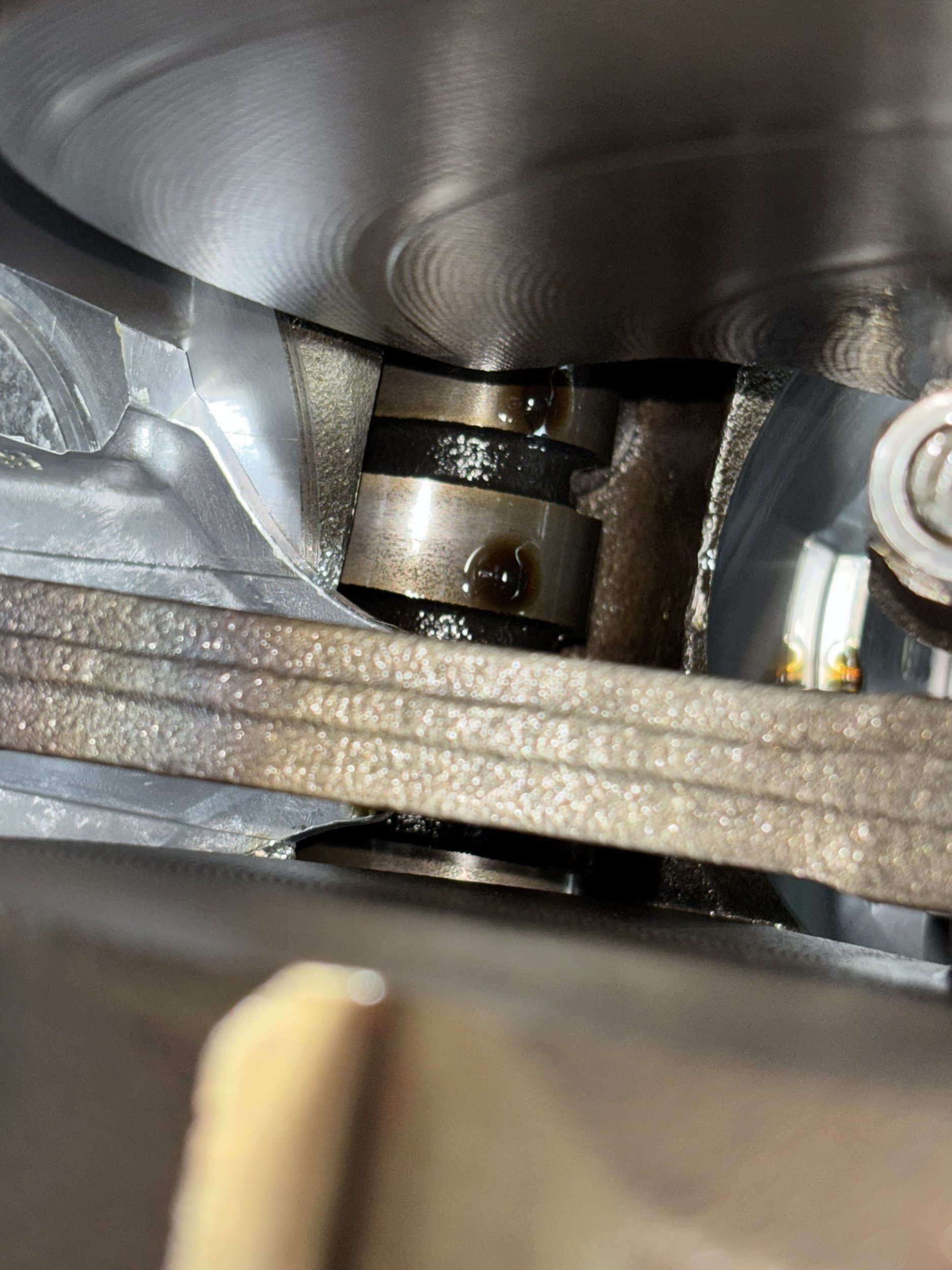

    What are your thoughts on the look of this bearing? I did not feel any major grooves with my fingernail.
    ALSO - should I loosen all the other main caps and tighten them back down to 75 ft lbs since it has been sitting so long?
    Following the David Vizard small block chevy book. For this rear main seal and the other main caps I still intend to do, I plan to tighten each bolt on each side of the bearing to 25 foot pound the to 50 foot pound, finally to 75 foot pound increments.

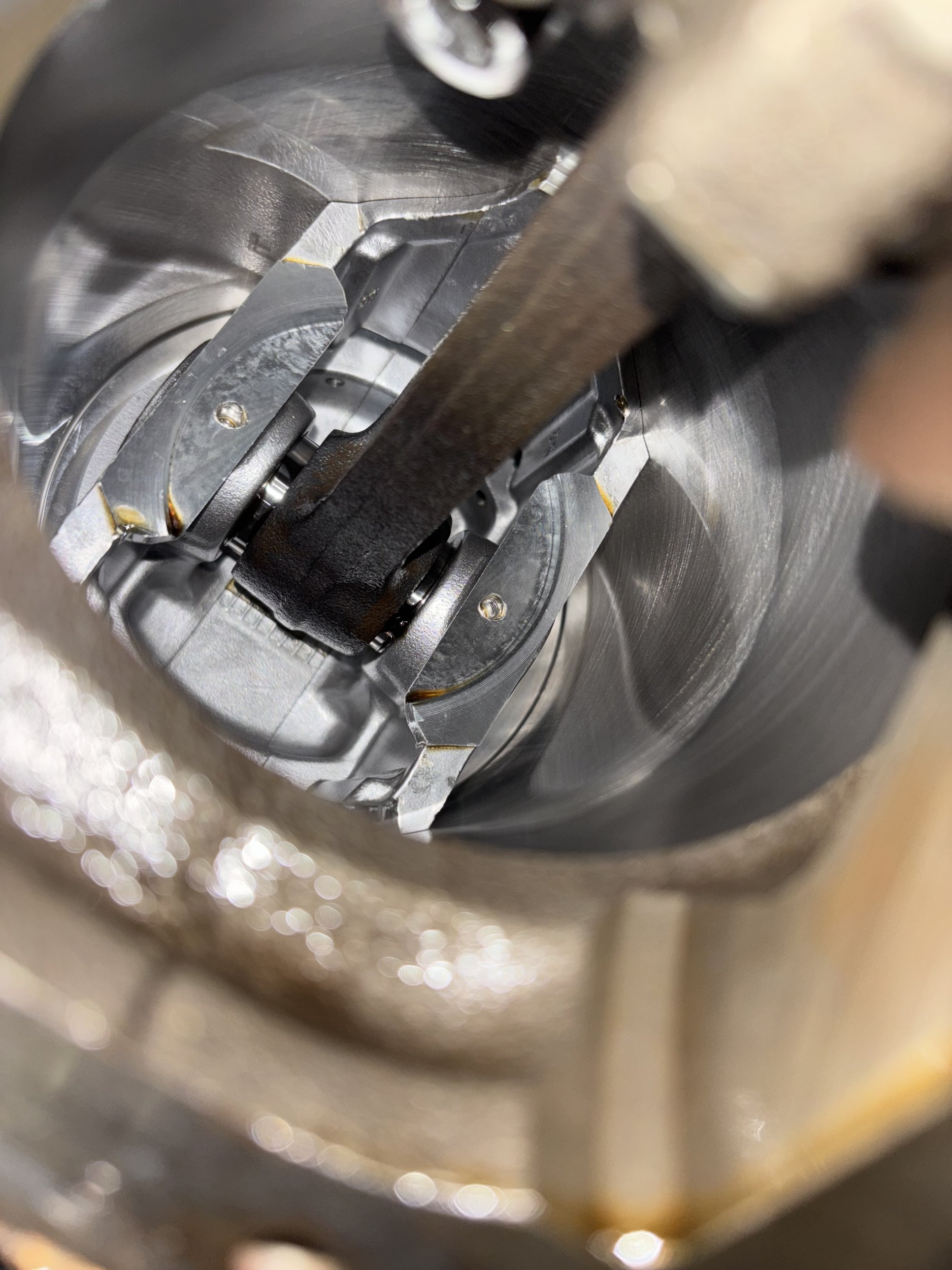

    I want this engine to last so any tips are appreciated. Not sure if I need to mess with valve lash as the car seems to run quite good.
    I plan to pull and look at the plugs and also replace them with some standard AC Delco ones, also replacing with a melling M55 standard volume oil pump, upgraded metal driveshaft, and new oil pick up since the old one is welded and would sit about .65 inches or more above the bottom of the oil pan and since the old one was welded on.

    The bearing looks perfectly fine for 600 miles.
    The seal was most likely deformed from sitting for 20+ years with the crank in one position (it would no longer be centered in the main bore as the weight of the crank would cause it to settle down onto the bearings). When you fired it up, the deformed lip could no longer seal as the crank was lifted off the bearings by the oil pressure. Replace the seal and move on.
    I would loosen and retorque the mains, starting with #3 and moving out to the ends of the engine. Probably not necessary, but it will make you feel better.
    Always a good idea to check valve lash on an engine that has been sitting for a while. If it is running good now, you can wait until your first oil change.

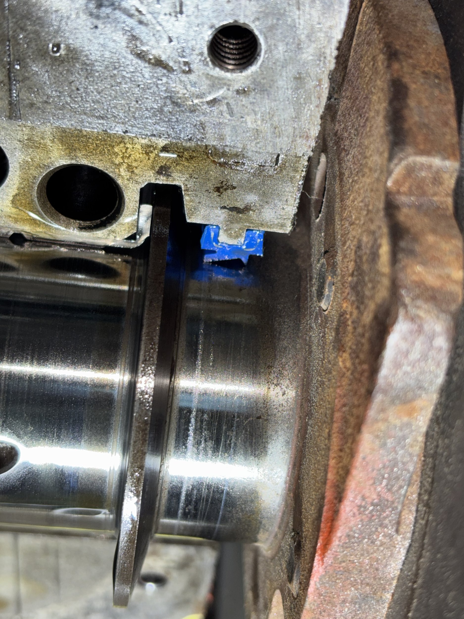

    The parting line of the seal should not be lined up with the parting line of the block / bearing cap.
    I always clean the new seal mating surface(s) with brake parts cleaner to remove any possible mold release agents remaining from manufacturing before applying a dab of RTV.

    Yeah the bearing is fine, but shows the crank was ground but not polished. Good time to go through it and check everything.

    It looks pretty good in there and since it already has 600 miles its probably fine. Install a new rear main seal in the correct direction with dab of sealant on the ends and a light coating of oil or lube on the crank where the seal rides. Make sure everything is torqued to factory specs (refer to a service manual as needed), new oil and filter, and then run it. Is there is a build sheet on it somewhere?
    If it had not been run yet and I did not know who did the machine work, I would've torn it down and determined bearing clearances, piston to wall clearances, what the ring gaps are, and a whole host of other small details including having the crank polished. Then a thorough cleaning before re-assembly.

    Polish the crank where the seal rides to make sure it cleans up . A strip or 2 of crocus cloth will do . Loosen all the main caps to make it easier to install the seal . Before you disassemble any more , get a good look at the cam lobes .

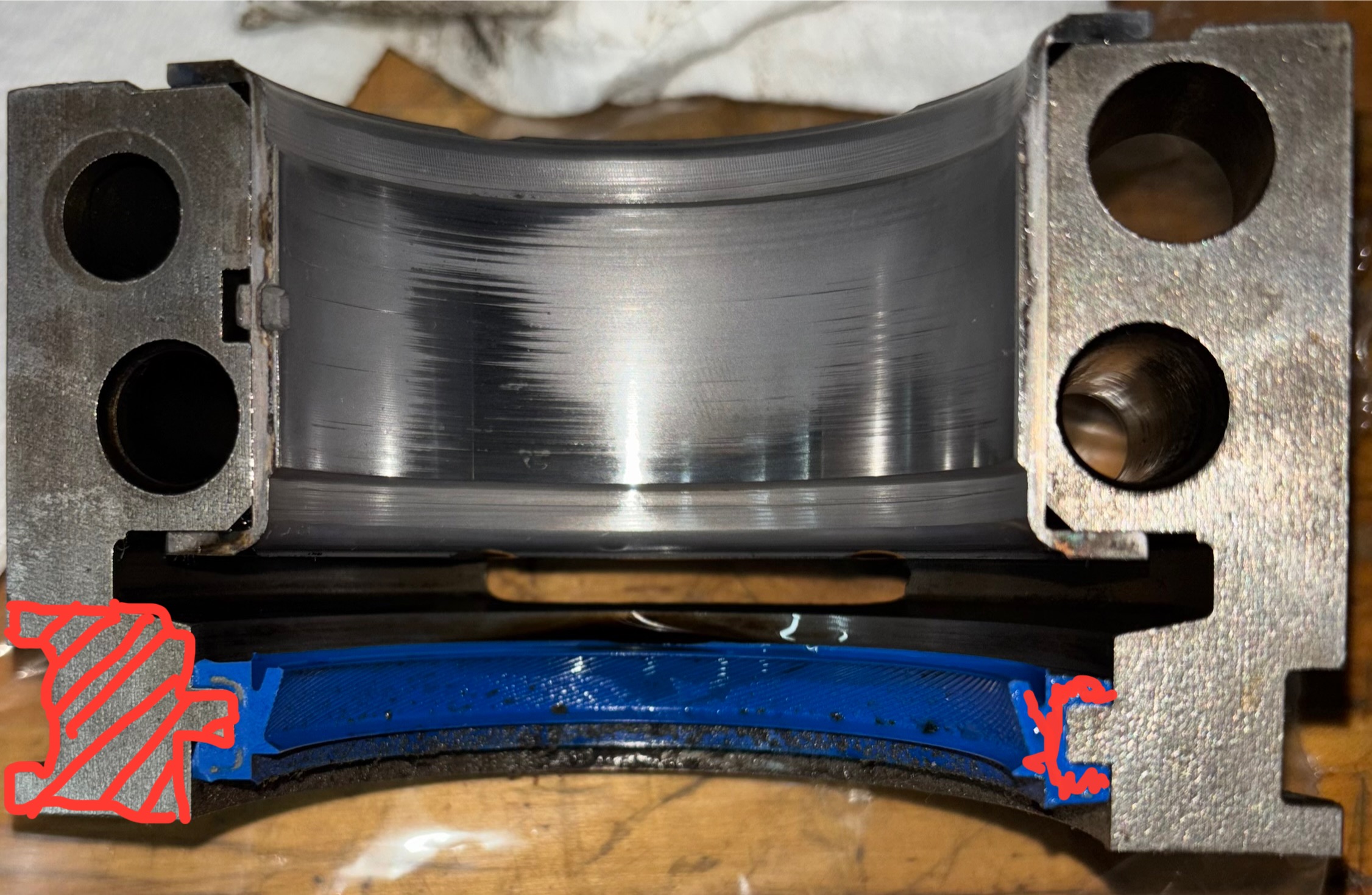

    I have installed the seal, added permatex ultra grey to the ends of the seal and lightly to the mating surfaces to the main cap per recommendation of the David Vizard Sbc rebuild book. I also added permatex ultra-slick engine assembly lube to the cap since wad not sure how long it will take me to get everything back together.
    I wish I had a service manual!! I will have to look on eBay but if someone here was looking to hand it off to the next generation I’d buy it off them.
    -Any further details/description on this crocus cloth (grits/brands?) and techniques (wet/dry/etc)? I’ll do some searching on here but I’d like to make sure I get the right material and also use it properly.
    - Is it ok if I rotate the crank with only that bearing off to clean it all the way up?
    -Does it matter that I already reinstalled the rear main cap with silicone on part of the bearing end end of the main seal or well, I have to scrape everything off and get a new seal?
    Luckily I didn’t need to loosen the caps to install the new seal.

    I personally wouldn't attempt to push a seal in place with the crankshaft in place too. Even loosening the torque wont make it easy really, and you don't want the rear main seal to leak again. I'd remove all the main bearing blocks, and raise the crank up a little with plastic shims at to other bearings and then install a new rear main seal. Be sure to not leave the ends flush with the surface, and instead raise one side 1/8" or so to offset seals from the cap and block surfaces. Then put a dab of black RTV on each end to ensure a good seal.
    Remove the shims and re-torque all the main caps and it's ready to go back together.

    I do not like the crank shaft sealing area .
    If it were mine and it was leaking after few hundred miles Id pull the crank and have it polished .
    I know you said time was a factor but if you got busy your only looking at less than a days work to do this and as far as cost your looking at top end gasket kit and having the shop polish the crank . the engine is already out and you have it apart already .
    I cant confirm 100 percent on a SBC but I know for a fact the crank can be removed on a BBC with out pulling the heads I have done it and have the engine still minus crank with heads still on to prove it.
    Id torque the main bolts if there a two bolt main to 70 foot pounds with oil on the threads and head of the bolt . 4 bolt man is less on the outer bolts as I recall.
    rods should be 45 pounds on a 3/8" bolt .
    If there ARP or some other after market stuff then you need to follow there recommendations .
    Lot of rust and crap on the crank flange was it rebuilt or just freshend up ?
    are the bearings under sized ?

    Polishing the crank won't remove much and if just the sealing area it won't remove any thing as far as the bearings.
    The area the seal runs on looks rough .
    I'd fix it.
    It's possable the crank had wear or rust on the seal area and was reworked and can't be fixed even with more polishing. Hard to tell from the pictures.
    The sealing journal is not turned undersize like a bearing journal.
    Are the bearings under size ?

    Pop the bearing out of the rear main cap and look on the back side. If it is undersized you will see .010, etc. near the part number. Not guaranteed, but usually.

    You look a the back of the bearing and see if has .010 or .020 or even ,030 stamped in it . ' if your this inexperienced I suggest you find some one to help you a bit.
    Taking the bearing out and putting it back requires a bit of care and proper technique but its a 3 second check . of the bearing has no under size mark then it is likely standard and the crank has never been turned under sized . checking the bearing under size would have been the first hting id have doen after pulling a cap to see if teh crank is original or has been turned . I suspect this rebuild might not be all you think and the crank might be an original that was only polished . the wear area on the seal loo like it was worn and prior and maybe already polished or cleaned up .Agai tha tis not a area that can be turned under size like a bearing journal . I don't know of any under size rear main seals .
    You go trying to polish the seal journal in place your likely to end up with grit and crap in every thing . You need to be carful and if your asking these basic question it shows you have not had much experience yet ., Not a insult but a observation. This is a good time to learn . Were you 100% certain the seal was actually leaking and not the pan end seal ?
    I did not know ere to tell you to go for 1000 grit or even 800 crocus cluth so i did a 5 second search and found about 100 places .

    For some reason I thought this engine was out of the car. I went back and blew up the picture of that seal surface and I'm with 1biggun here, the more I look at it the more I don't like it. Starting to think that crank was not ground at all, but is all pitted from rust. There's some trash lines in the main journal as well.
    @McMac 31 Don't try to polish that crank while it is in the block and in the car. You only have two choices, either put it back together and run it the way it is, or take it out of the car, tear it down and take the parts to a reputable engine machine shop for evaluation. This could be a great opportunity to gain some more experience and have some fun! Of course it will cost some money.

    It's really not going to matter what you polish it with if you clean it well after . The only thing your going to polish is the seal area.
    It's hard to tell from the pictures but if it's pitted / rough your not going to polish it out with 1000 grit easly or at all.
    If it had a Cal CUstom cast aluminum pan you very likely had a leak at the pan rubber end gaskets. Those things can be a PITA to seal .

    I appreciate all the advice, and I do wish I had the in house capability to tear down and reassemble, just not there yet tool/gauges/knowledge wise. Someday!
    What is the consensus with where to apply the silicone on the rear main seal and/or cap?
    here is what the David Vizard sbc rebuild book shows:
    zoomed:
    Is either of the below correct, or both even? I haven’t seen great illustrations around the web based on general application and location, do’s/don’ts it has been mixed.

    I personally wouldn't put it back together with a new pan gasket using that same oil pan. Odds of that pan leaking again, no matter how well you seal it are not good. I'd find a decent steel pan to put back on it instead. Might cost you $50 or less, and well worth having a better sealing stock pan.

    China anything when it comes to timing covers , pans is a crap shoot...Get USA original tin...Had a timing cover that was removed twice till we realized it wasn't even dimensionally correct...

    Why are you not polishing the crank ?

    He already said the engine is still in the car, and he has no tools or cherry picker to remove the engine.
