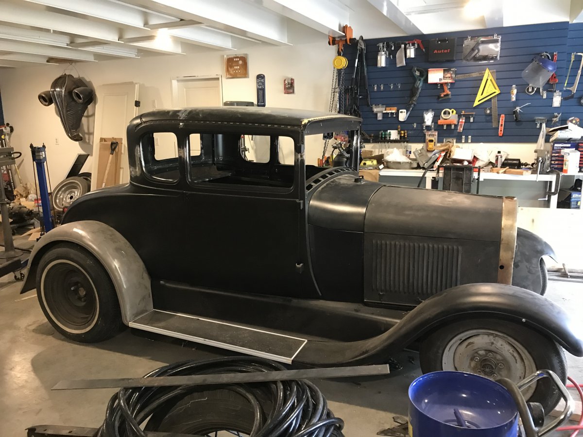

    Here’s a picture (if I can figure out how to post it from my phone) IMG_2789.JPG
    Heh, heh,heh.... I did it!!
    I like the car, I think I can de-street rod it but I’ve never dealt with a top like that.

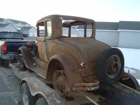

    OIP (4).jpg Factory Fresh Special Coupe OIP (6).jpg 80+ years out in the open Special Coupe showing the missing wood under and around the rear window.

    Like others have said, it's just the "Special Coupe" model. Basically the prerunner to the vinyl top option. If you hate it, p*** on it because you'd have to find a coupe roof and do a ton of metal work to convert it. They are not just a coupe with a vinyl cover.
    A leatherback was a sedan, not a coupe IIRC.
  11. The37Kid
    Joined: Apr 30, 2004
    Posts: 32,540
    The37Kid
    That belt line piece is a hard to find item, as badshifter just said swapping it for what you want could make two people happy. Bob
