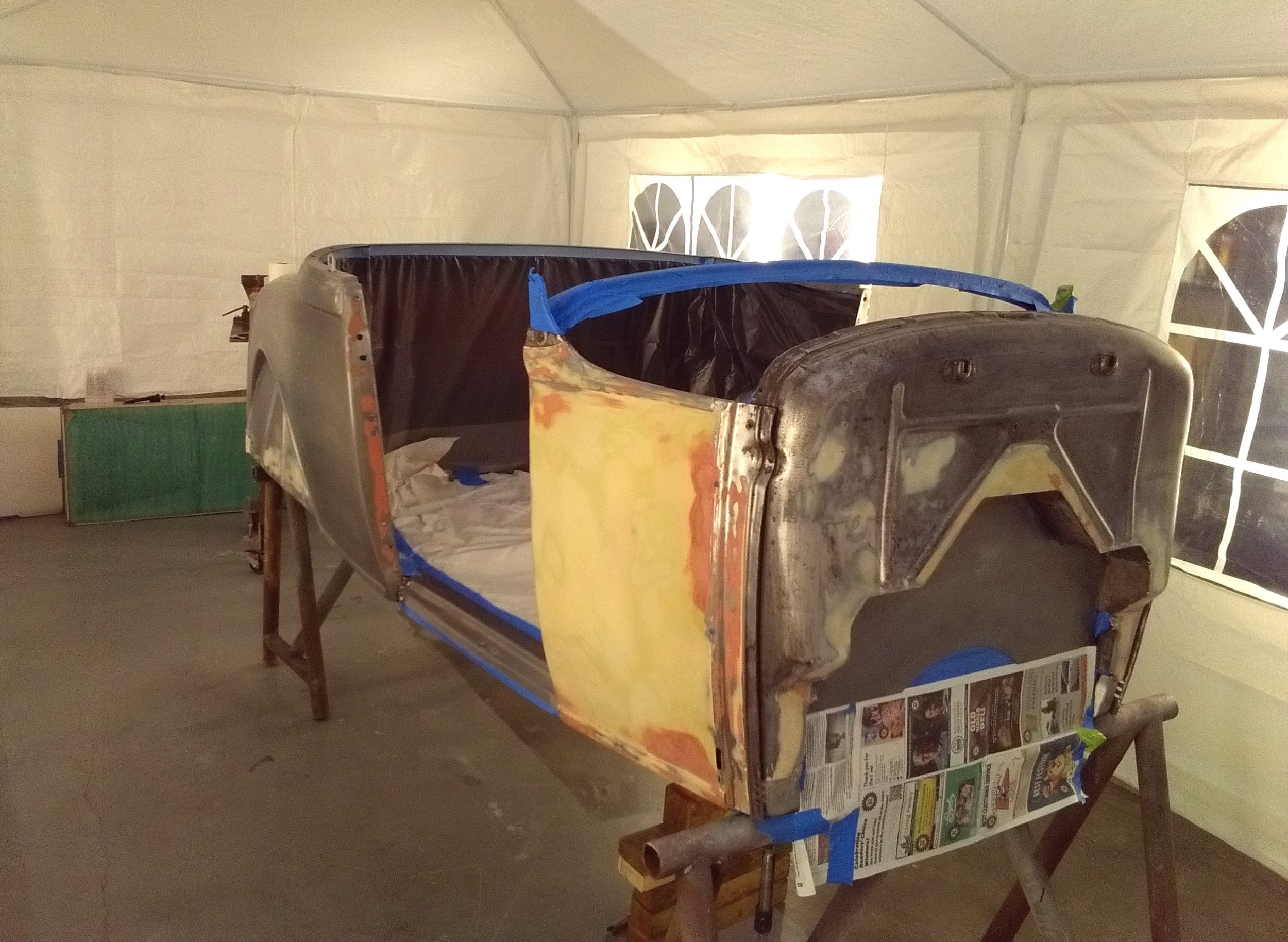

  29. warbird1
    Joined: Jan 3, 2015
    Posts: 1,354
    warbird1
    I used a similar set-up as Bandit Billy when I painted the roadster a year ago. Being concerned about losing power and having an inflated tent come down on my fresh paint I set up a cheap 10 X 20 ft. wedding tent inside my shop. I used red rosin paper to protect the floor, set the tent up on it and used several rolls of duct tape to seal all the joints on the walls and ends. Built a plenum for the back wall for the fan inlet to fit into, and covered the front of the plenum with paint booth exhaust filters (just visible on the floor in the back of the booth). Used an explosion proof barrel fan like Bandit Billy's for the exhaust and ducted it out to the back window of the shop. Front wall had a couple of rows of furnace filters for the air intake. I used a lot of duct tape to ensure that all fumes were contained in the booth and the exhaust system. Grounded the fan, ducting and booth to reduce the chance of static electricity. I had all the lights, compressor, heat and etc. outside of the booth. Though there are a few "improvements" I'd make if I used this spray booth again it actually worked well and after spraying a couple of coats you could leave the booth and there was NO odor of paint or thinner in the rest of the shop. Worked for me and I didn't blow myself up...
