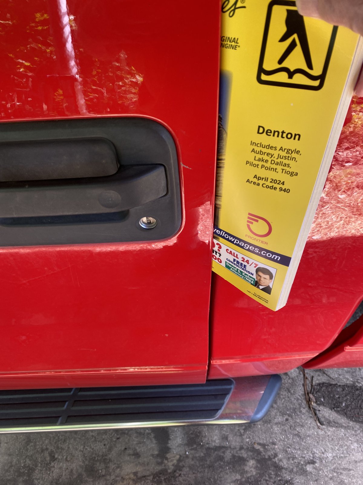

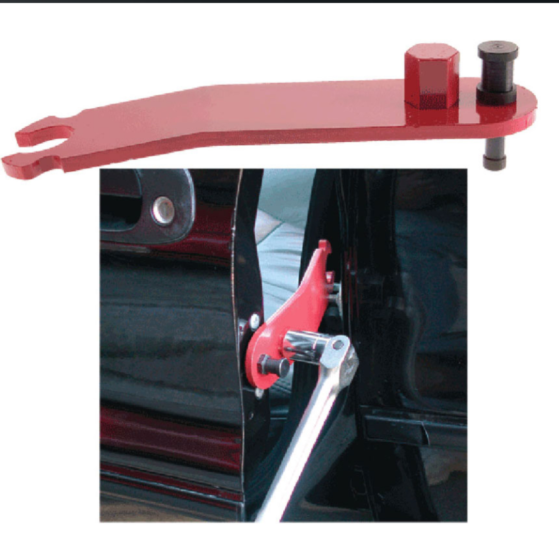

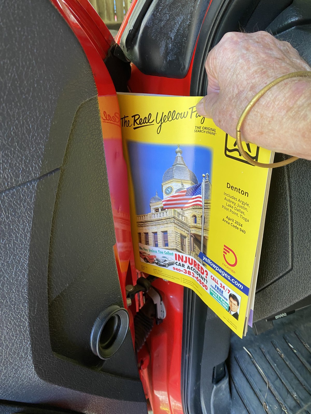

    You put the phone book in the door jam by the lower hinge and carefully close the door and apply pressure to move the bottom of the door back and up you can also put the book between the latch and jam and apply pressure to move it forward. I prefer the older ones that are really thick. The idea with the phone book is that it doesn’t leave marks like a hard object and conforms to the shape of the opening. You can do the same thing with a 2x4 but it leaves marks. We always used the expression calling the door up. They have door bars now , but I have more control with the phone book. IMG_7342.jpeg IMG_7341.jpeg IMG_7340.jpeg IMG_7343.jpeg IMG_7345.jpeg
