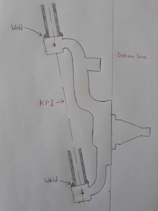

    Swap out the upper and lower ball joints for spherical bearings [bolt through]
    The modify the knuckle by boring through the tapers and welding tubes
    You will need to address the steering arm / bump steer issues as well
    This method is a lot easier and safer than cut'n'weld knuckles BUT it will widen the track slightly [OK with skinnies]

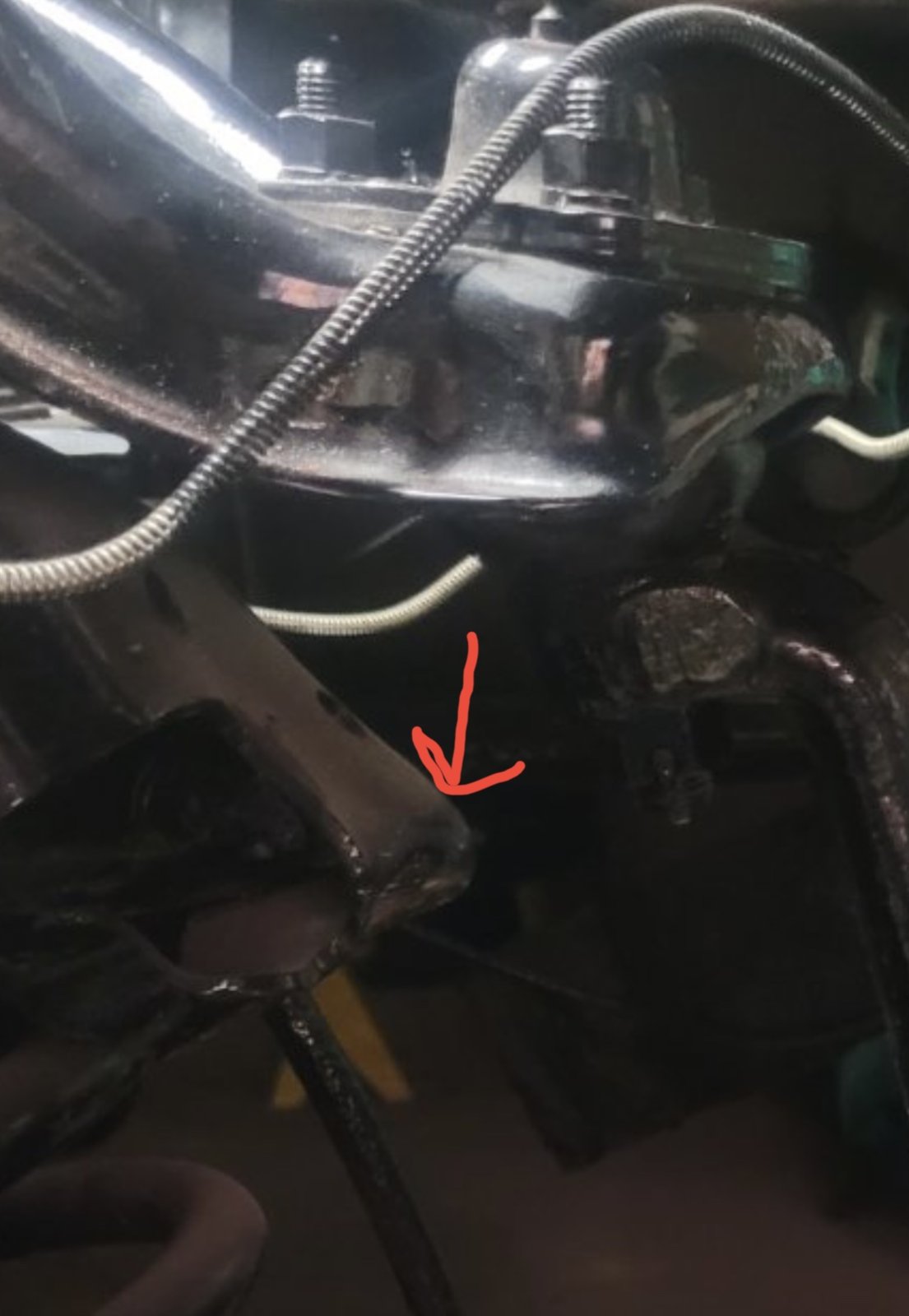

    348 58 wagon springs.
    Note about upper bump stop mount attached to the frame. These most likely will have to be removed. What happens is ball joint spacer will smack them causing a blow to the side of the ball joint spacer which is the real cause for them to fail. IMG_2156.jpeg

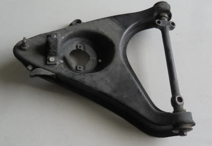

  25. Johnny Gee
    Joined: Dec 3, 2009
    Posts: 14,036
    Johnny Gee
    from Downey, Ca
    ^^^^^ The a-frames posted within op’s pic sure look like 58-64 unit’s. What’s the point? IMG_2158.jpeg
