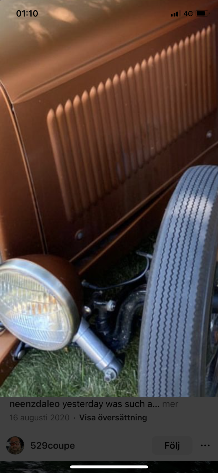

    The frame seems not be modify on that car.
    Tony is here on Hamb, but car was in rodders journal, so maybe some has that number and can take pictures ?
    Edit.
    But I found more.
    It look line a std 4” drop axle but bones is later style, but that not set that car that low and its super low ?
    Horns in front can’t be more than 6” up from ground.

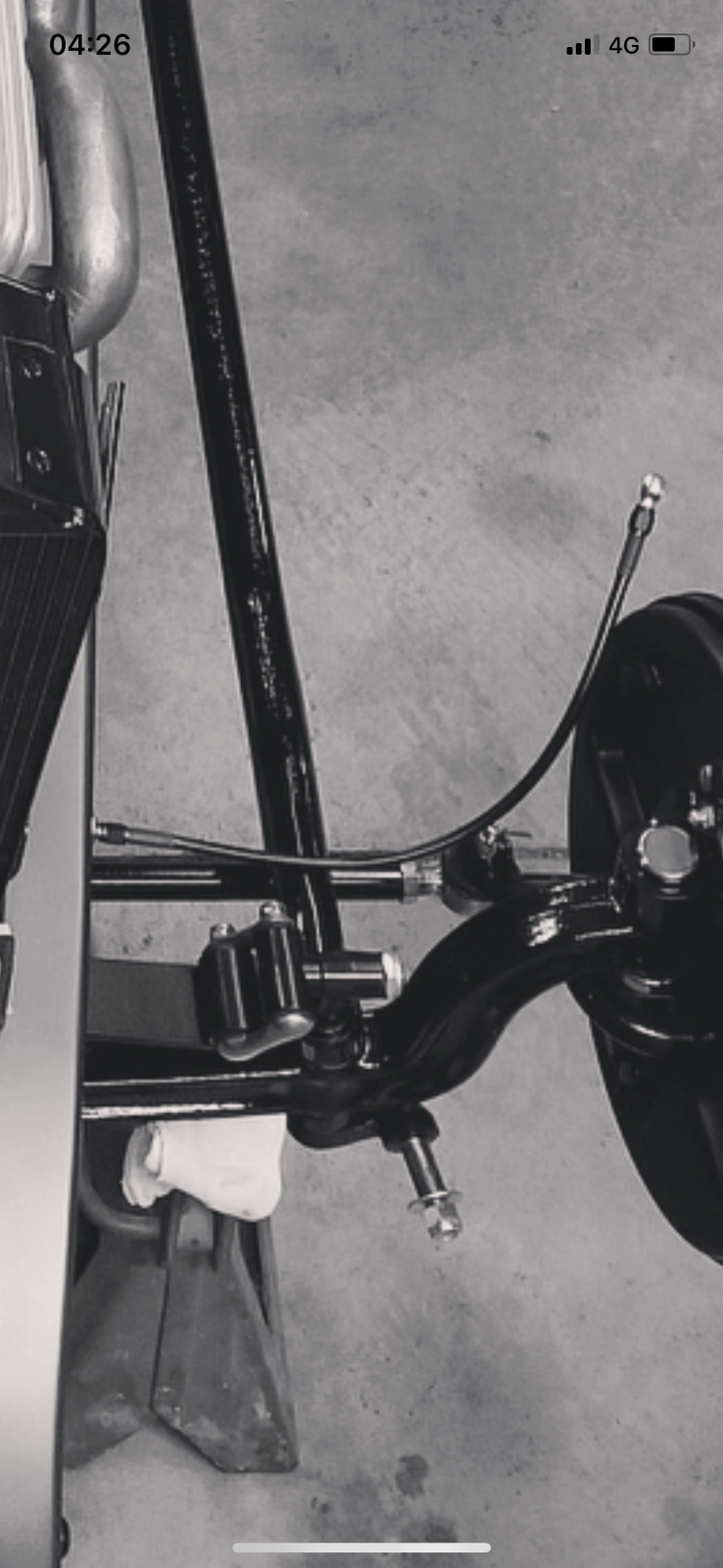

  27. from your pics there’s -
    Flat cross member
    Frame notch for spring clearance
    Extra deep drop axle
    Crossmember moved forward.
    Can’t tell if that spring is reversed eye or not.

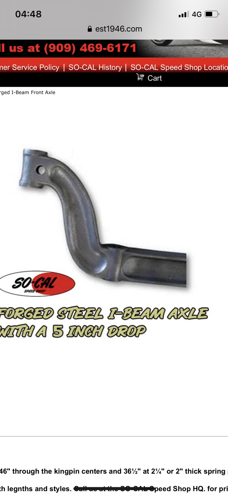

  28. 3w Hank
    Joined: Jan 29, 2022
    Posts: 1,074
    3w Hank
    Yes it loock like frame has a noth and spring has a reverse eye. I saw a frame picture and drop must be a 5”, and I think it must be this axle, se pic.
    I guess he has a flat cross, and I read a flat cross lower 1.5-2” from a A-cross and maybe from a std 32 maybe 3”.
    If axle is 5” thats also 1-2” more than a std hot-rod axle ( as most are at 3-4” )
    Thats a total 4” more.than I plan to
    has. A-cross and a std 32 spring and a 4” drop.
    -But this gets the cool rake.
