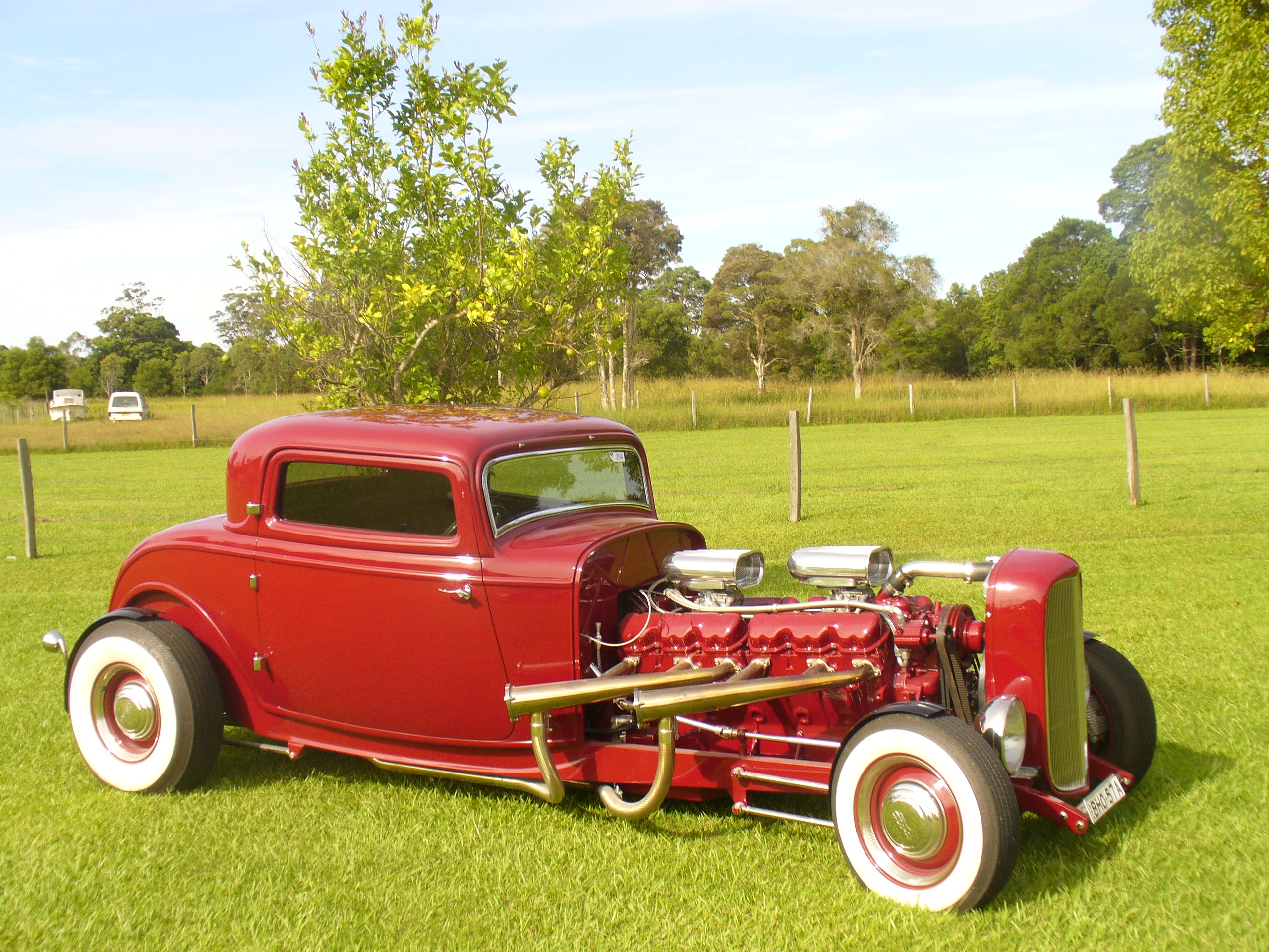

    3.5 " longer wheelbase. My own hood but hardly any longer than a stock hood because it is vertical, not leaning forward to match the body rake. Front of hood also 3/4 " lower than stock. 32's looked humped up in front to me. Moved the W/S posts back about an inch too. img557.jpg Custom one off radiator. Cools good. Best *****'n award and 1st place Deuse Doin's Goodguys S E Nationals. PS; Run skinny tires on your own ****.
