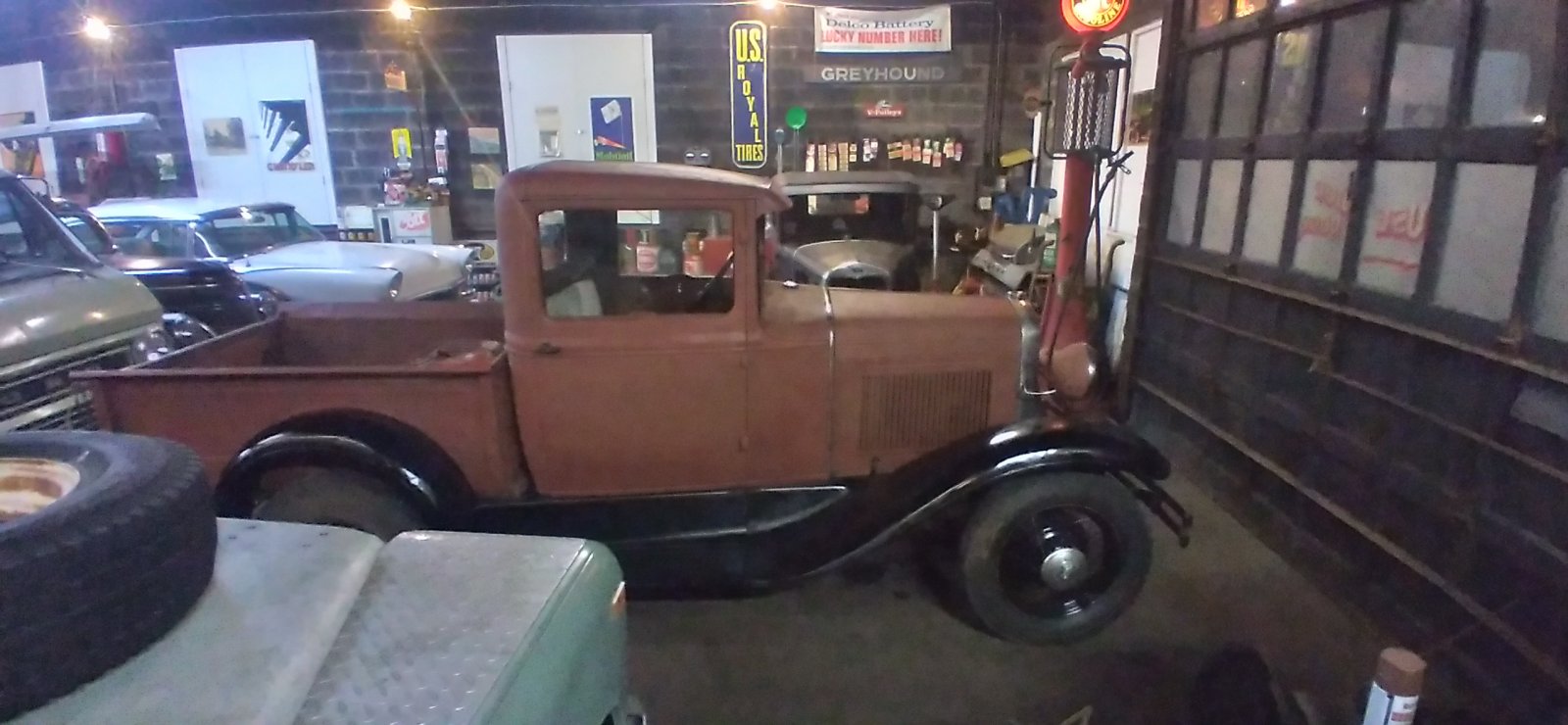

    20211120_014402.jpg I just built a 31 Budd cab truck this summer from a pile of A parts cut apart with a fire axe and stored in a chicken coupe since the 50s.......was a lot ot metalwork!!!!
    I had to make a very low profile seat so fit but I can manage to fit my 6 foot 8 inch body into it...
    I really like the stock proportions
    But long trips are out of the question. 20220113_150459.jpg 20200708_210446.jpg

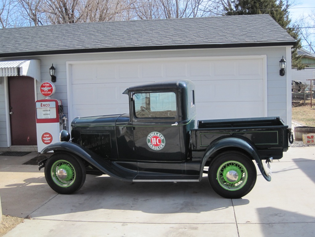

    Cowl and doors extended. Hate the channel and the cab looks out of proportion. Living with it for now.
