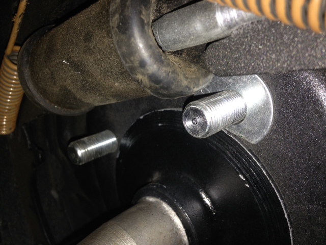

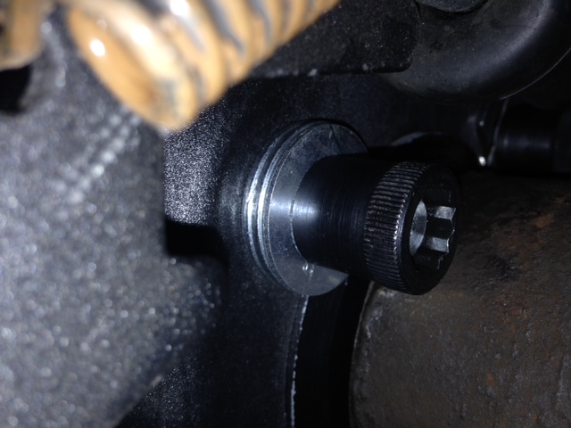

    I know quite a few people have ran into clearance issues when using a traditional hoop steering arm and F-1/F-100 brakes. Most people will ditch this arm in favor of a Super Bell slingshot or a similar blind hole fastened arm. I've never been a fan of blind hole arms and I prefer the looks of the hoop arms. I found a solution that worked for me and another member wanted me to post a thread for future reference.
    Allen nuts 1/2"-20: http://www.mcmaster.com/#allen-nuts/=slj6w5
    Budget F-1 brake drums: 8951- Autozone
    The issue is the tight clearance between the thread and backside of the wheel cylinder. It's way too tight to fit a conventional hex nut.
    @97 suggested to use 1/2"-20 Allen nuts which are readily available from McMaster-Carr. You can then tighten these with a socket drive and some loctite and it's good to go. One other thing is you will need to modify a couple of heavy washers to run behind the nuts. It's an extremely simple for fix for something that will make you scratch your head during mock up.

    I hadn't seen those Allen nuts! Great tip, lots of projects sit for months immersed in indecision.
    (say it fast)
    Also appreciate the Autozone availability of F1 drums. NAPA also has them, but $$$$.

    Those are really cool. They would work good also with a hoop and 39+ juice brakes too. You always have to cut or bend the***** out of the grease box in order to get a nut on the ends of the hoop. Thanks for the idea and the pics.

    Oh.. Did you have to cut the grease box for these to fit in? I don't know if you plan on running the grease boxes or just forgot to put them on for the pictures. It looks like the allen nuts would go right on without modifying them.
    LSGUN likes this.

    I haven't tried to fit the drivers side grease shield yet, I still need to clean them up. I don't think it would be too much trouble to make them fit, I know the washers would probably be the issue if anything.
