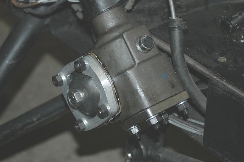

    F100 steering mod..png I have installed several F1 and F100 steering boxes in hot rods. I have always used the "modify the frame" method rather than cutting up the box. You end up with something with no welds or mods and can be EASILY replaced with a STOCK part if need be.
    If you have the fabrication equipment the job can be done in about an hour.
    Also, there is always the insurance liability thing with welded steering.
    A side note: these boxes can benefit from a cover girdle to keep the center slack out of the adjustment for extended periods of time. This does not need to be done for mild street use.

  7. panheadguy
    Joined: Jan 8, 2005
    Posts: 1,113
    panheadguy
    from S.E. WI
    Who makes the girdle?

  9. Pete1
    Joined: Aug 23, 2004
    Posts: 2,262
    Pete1
    from Wa.
    You do. It can be made with a hack saw a drill and a couple of files. It needs to follow the contour of the cover on the inside fairly close. Trial and fit. You probably won't notice any improvement unless you are stressing the steering like in a race car.

  10. Glen E MacDonald
    Joined: May 11, 2015
    Posts: 53
    Glen E MacDonald
    Petel... Any tips for us on your "modify the frame" method?
    48fordnut likes this.

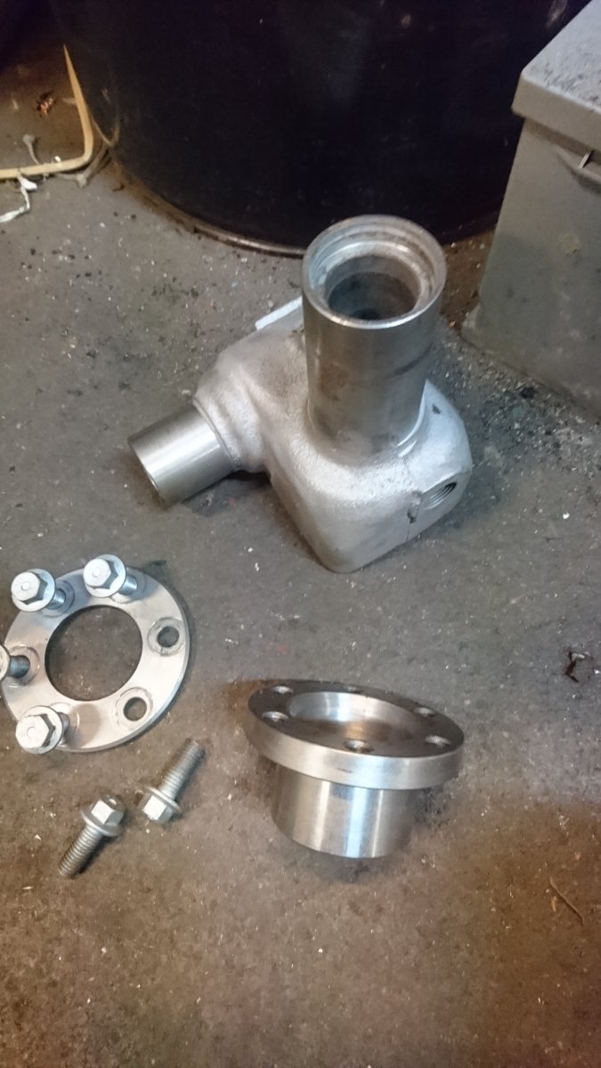

  11. Christian Moller
    Joined: Sep 14, 2017
    Posts: 28
    Christian Moller
    here is another way to do it:)
    It is a press fit, i heated the flange and it sits like its solid.
    Cliff Ramsdell, irishsteve and RMR&C like this.
  12. Pete1
    Posts: 2,262
    Pete1
    from Wa.
    Basically, cut the area around the old steering holes out with a small cut off wheel. Make a plate to fit the new steering flange. Fit the plate to the hole in the frame. Put the whole steering ***embly in and bolt it up to the dash or tank so it is in the position you want it finally. Final fit the adapter plate to the frame with the proper kick out. As you mock it up you will see where fillet pieces need to go. Weld everything together.
