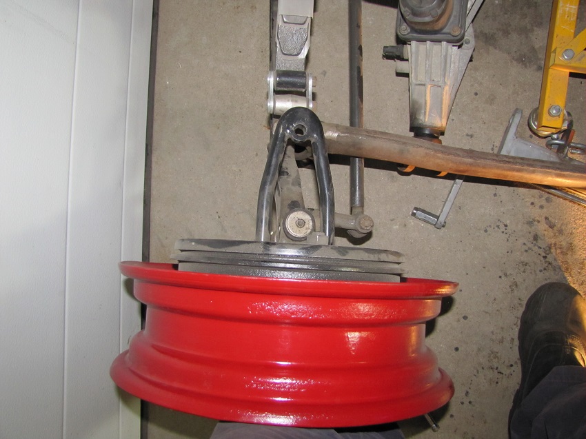

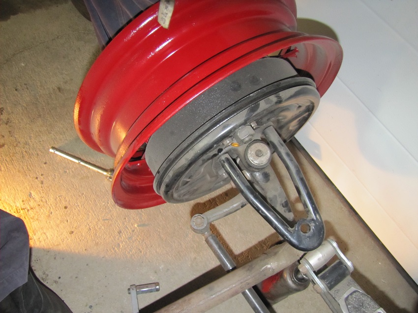

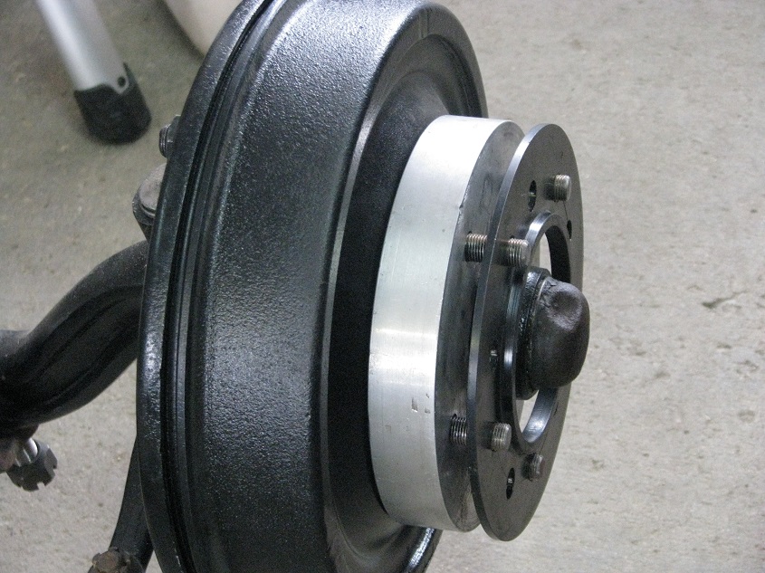

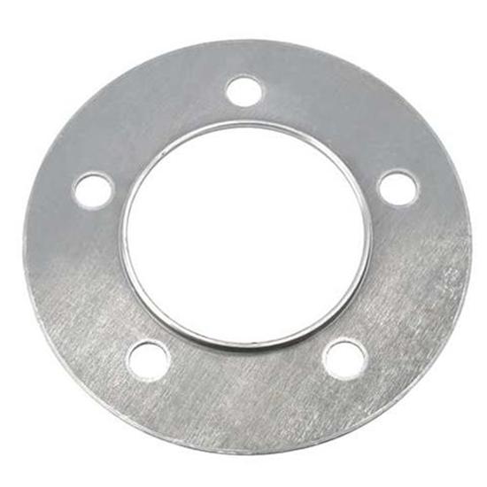

    I machined mine. A spacer and an adapter. This is a 56 drum and 48 spindle. Speedway sells the adapter. 8a.JPG 91065470_L.jpg

  13. Reyn, do you have any pictures of the wheel mounted showing how far the brake drum sticks out on the back side? What are the dimensions of each spacer used? Overlength studs? Im doing the same deal on a modified. Thanks.

    The aluminum spacer is 1 3/16 " thick and 7 11/16" dia. The link I gave in post #11 from speedway has the dimensions listed there. Mine measures pretty much the same. I bought 3" studs and cut them to 2 3/4 . The rim to backing plate measurement is 1 3/8". IMG_2661.JPG IMG_2662.JPG

  20. REYN your wheel setup looks good , did you have any problems finding long studs? I'm doing a similar set up with rally America adapters Thanks for your post

    The studs I purchased from "Jegs". They were 3 1/2" part #070-100-7703.
