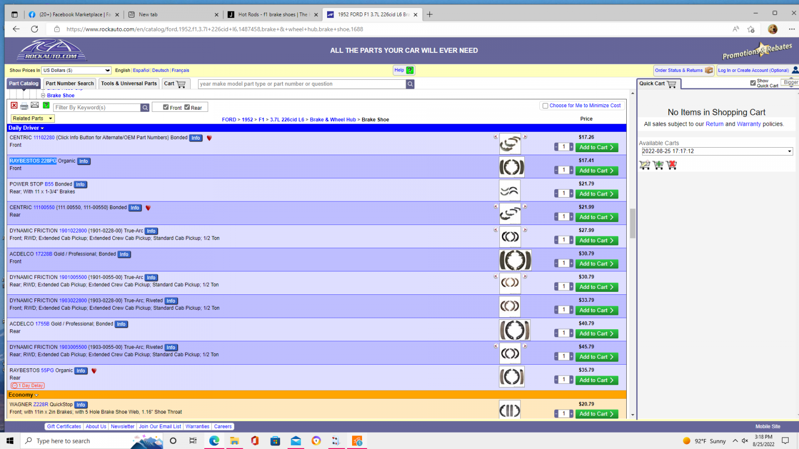

    1949 FORD F1 3.9L 239cid V8 Brake Shoe | RockAuto

    any of them there veehjikles use a 11 by 2 '' finned drum

    Raybestos 228PG or the equivalent. As Nobby showed they are a very common shoe that was used in a lot of vehicles. Those are organic but your local parts house you deal with all the time may have some different grades if you want metallic. The Bronco drums are just the ones that fit without jacking around doing modificatons to get them to fit.

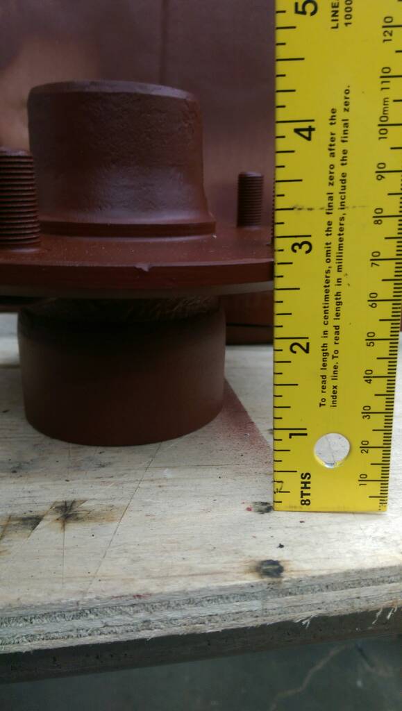

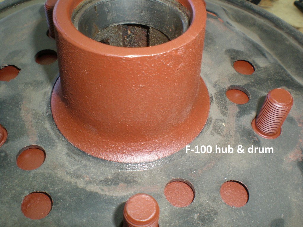

    Would that be considered f100? I measured my hubs and they look to be f100. I’m having a problem getting the drums right. I can’t find drums that have the correct center bore.
  16. RICH B
    Joined: Feb 7, 2007
    Posts: 6,052
    RICH B
    Backing plates are the same across F-1 & F-100.
    F-100 hubs measure about 2-1/4" tall and drums listed for F-100 fron '53 up to about '62 are correct and pretty common. (top picture)
    F-1 hubs measure about 2-3/4" tall and 1980 Bronco rear drums fit. (lower picture)
    The center register holes are different; but the correct drums fit the register of the corresponding hubs.
    What problems are you finding with your stuff.

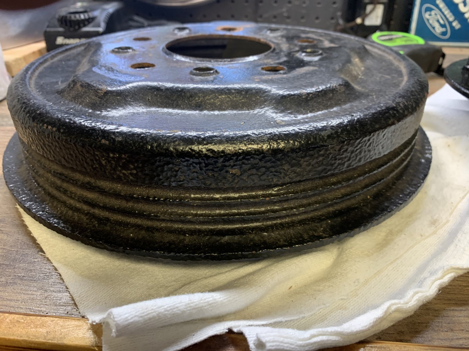

    77CAD588-52C2-4941-A477-C62619F6A4ED.jpeg D2B7627B-4699-4A8C-86DB-FD379B11E7AE.jpeg
    Thanks for getting back with me. So I believe I have f100 hubs, when I look for drums the f 100 front shoes center hole is 3.570, my hub measures at 3.150. Do you still recommend the f100 drums. Or can modify to fit bronco drums with a .500 spacer and longer studs? I would also need to turn down the hub center flange to 2.880.
  18. RICH B
    Joined: Feb 7, 2007
    Posts: 6,052
    RICH B
    F-100 drums should have a center hole that matches your hub @ about 3.150.
    I usually get Raybestos 2600R drums from RockAuto lately; since AutoZone no longer likes to ship Duralast drums to their stores.
    If you are reading drum specs on a web sight; they are not always accurate.
