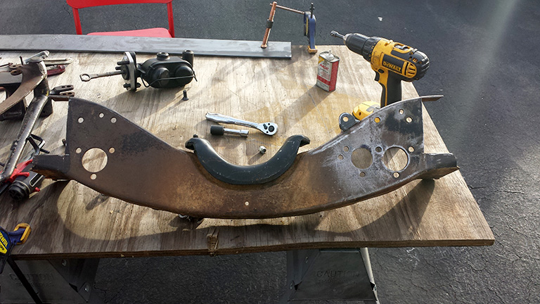

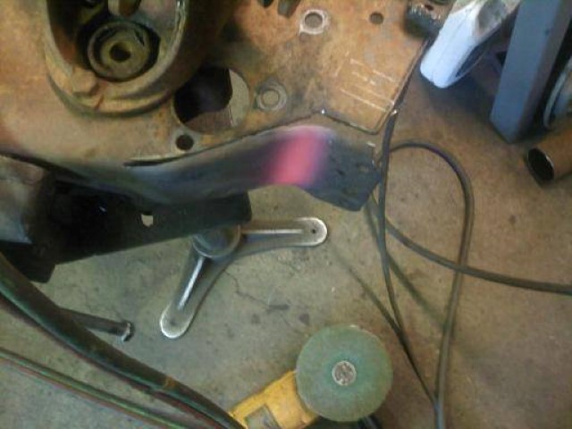

  3. RICH B
    Joined: Feb 7, 2007
    Posts: 6,298
    RICH B
    Couple pictures I took of one being installed. Master cylinder/pedals moved over one one hole on top and the top lip modified to accept inside mount bolt. It is not in the final position in the last picture

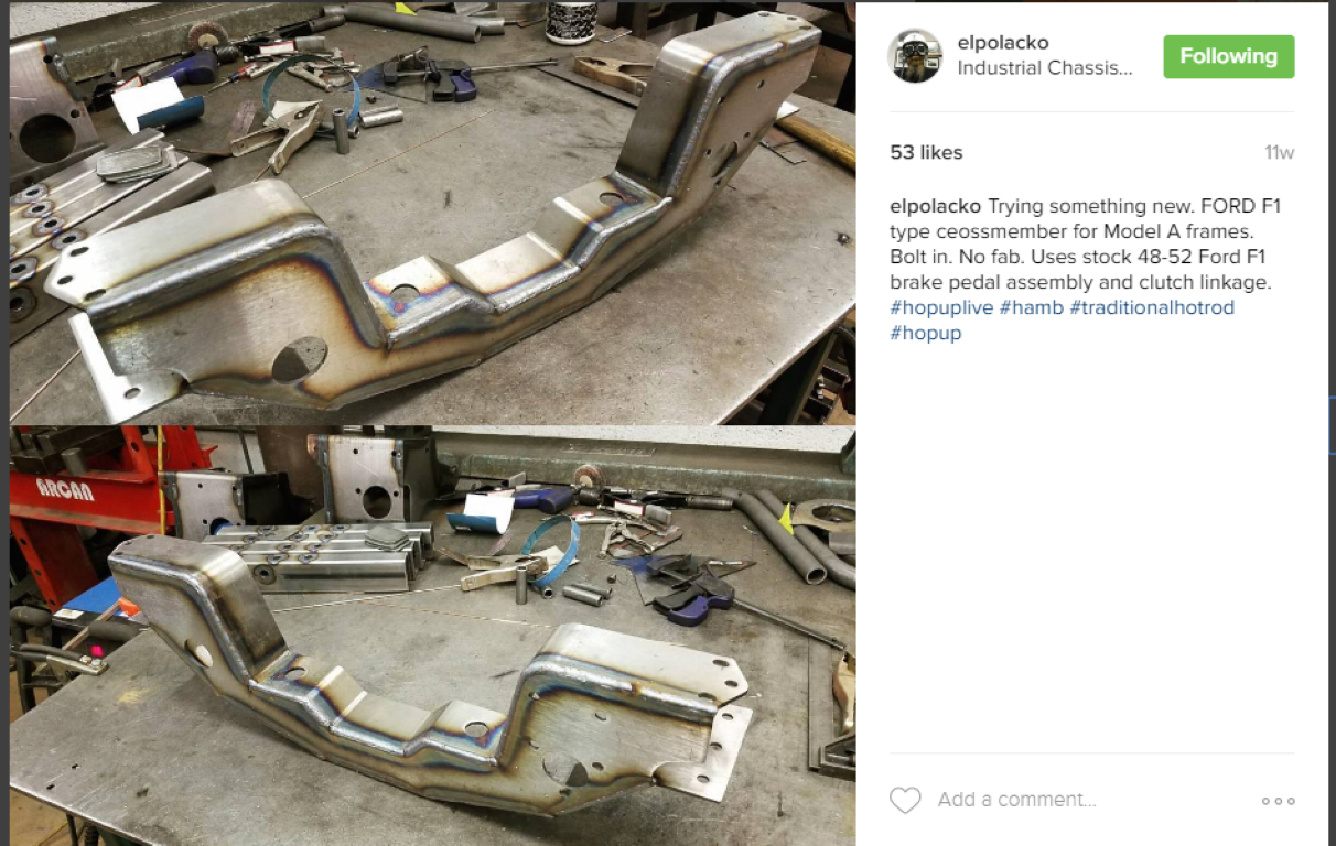

  6. Do you by any chance know who sells the f1 crossmember?
    48fordnut likes this.
  7. RICH B
    Joined: Feb 7, 2007
    Posts: 6,298
    RICH B

  9. Tim
    Joined: Mar 2, 2001
    Posts: 21,569
    Tim
    from KCMO
    patmanta, MFJL and 48fordnut like this.
  10. Yeah its that one.
    Unfortunately Old Yankee Speed Shop only had the front engine mounts on their website right now.
  11. I stand corrected, last night they werent on, but they are now!
