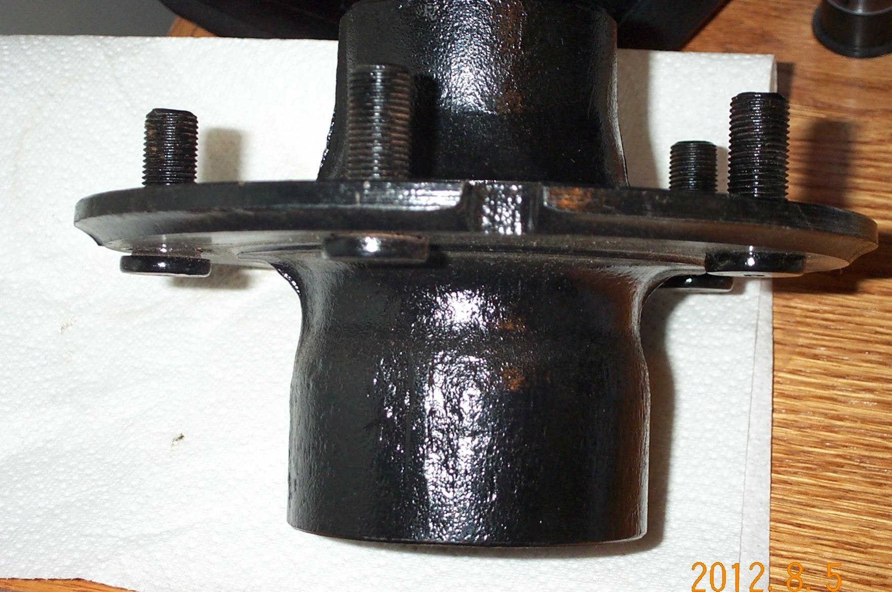

    Can someone tell me if this is F1 or F100?
    Thanks.:)

  2. i believe by the offset it is F-1

    Thanks. I was hoping for F100.

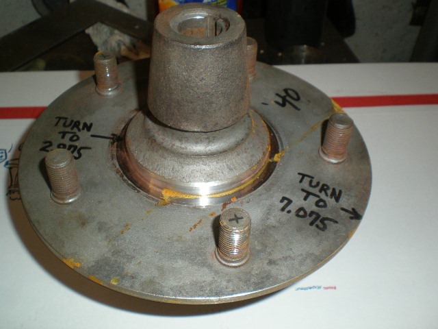

    Ok....another question regarding hubs.
    Forgive my ignorance here.
    I know to get self energizing brakes it's Lincoln 12" or F1/F100 11" and you need the hubs to go with all of this.
    There is I'm sure a very easy answer otherwise everyone would be doing this,
    my question:
    Why can you not use the later car hubs from the non energized brakes instead of the F1/F100 hubs. All of it use the 5 on 5 1/2 bolt pattern.
    My thoughts why not......
    the car hubs outer diameter is larger (but can they not be turned down) or is this an issue?
    the mounting flange for the drum hole is also larger than F1/F100 (again can't the car hub flange be turned down to fit the F1/F100 hole)?
  5. 2935ford

    The two differences I see in early car hub and F1/F100 are:
    car hubs have a larger diameter overall.
    car hubs have a larger mounting area for the drum hole than F1/F100.
    F1/F100 hubs need the "bearing kit" and possibly some grinding on the inner bearing to fit the spindle. Car hubs do not.
    I know I missing something here....otherwise everyone would be doing the car hub thing?

    Here are some pics of the hubs. You can visually see the differences in size and at the drum hole.

  10. will the passenger hubs go on with the same bearing swap at the F1/F100 ???
  11. There is also about 1/8" difference in the flange to backing plate distance.
    The edge of the drum may need to turned a little to clear, depending on the drum itself.
    This does not seem to me to be a worthwhile conversion, unless you already have a good set of F-1 drums and can do the machine work yourself.
    Another possibility, you could probably also use Bronco drums instead of F-1 drums, depending on your wheels, most people would not notice the difference.
    If you have to buy new reproduction F-1 drums, you could probably buy a set of F-100 hubs and new F-100 drums for less money. Could also sell your '40 hubs and be even further ahead.
  12. Just looked at a '40 front hub and it does not appear to be enough metal to turn the drum register to the smaller diameter. Maybe turn a scrap hub and then

  13. 2935ford
    Joined: Jan 6, 2006
    Posts: 3,848
    2935ford
    Thanks 36-3window.
    I have aftermarket spindles (round type) and was not expecting any issues with bearings. I would think stock bearings for the hubs would fit the spindles w/o any mods.
    Thanks Rick B.
    I guess it will be easier just to get F100 hubs as I have to purchase new drums anyway.
    At least I now know the reasons why it wasn't done now or back then.
    The drum hub hole would have to be enlarged and possibly the rear drum outer back surface would possibly need trimming.
    Have I missed anything else?
    I had originally intended to run disc brakes but I'm wanting to run either my steelies or '35 wires and the wires have clearance issues with the disc setup.

    Rich B
    I was thinking of opening the drum centre to match the '40 hub?
