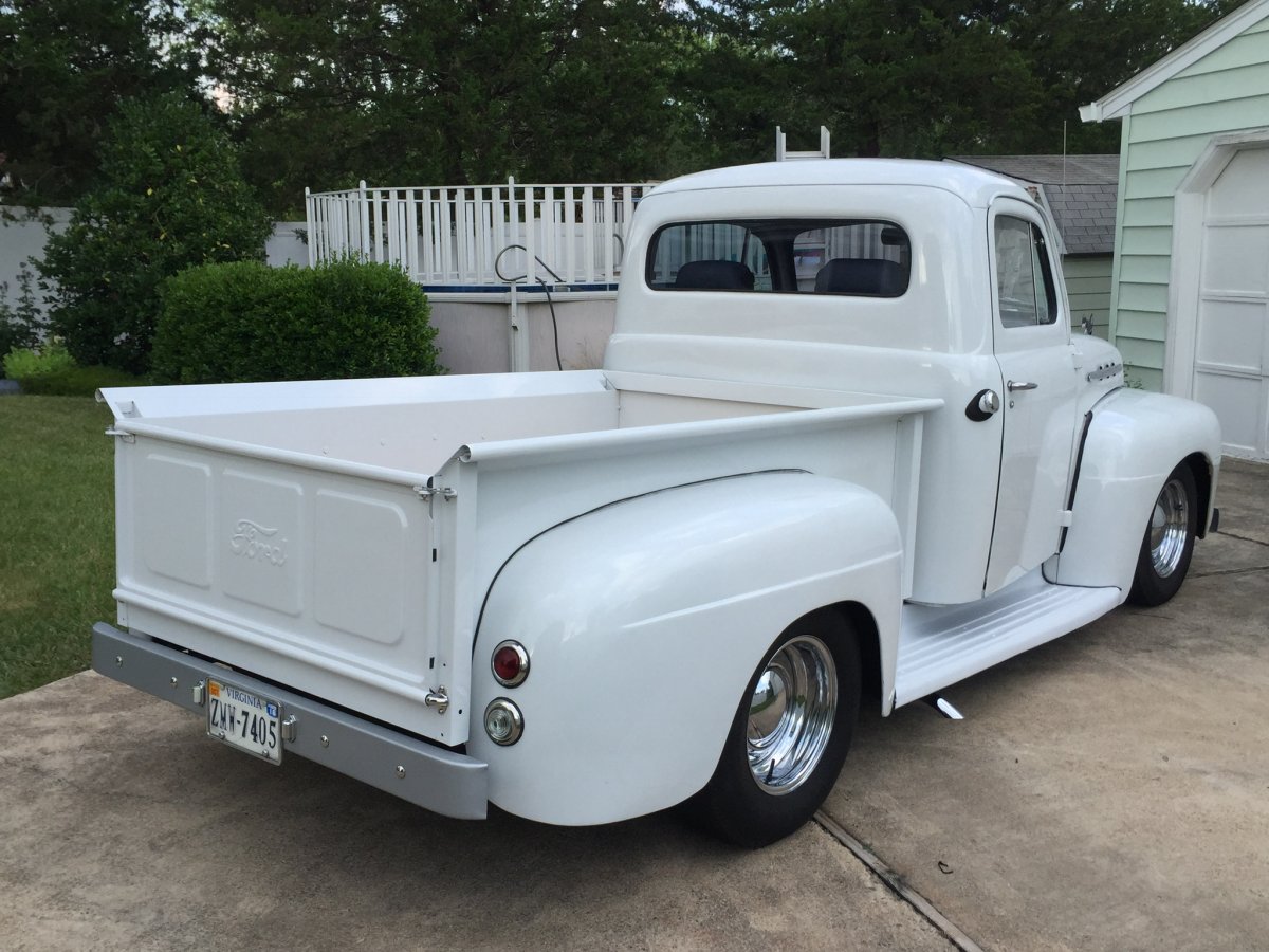

    Got mine out of a 68 Fairlaine. It’s a little narrow but the pics you posted have rear wheels that look reversed. You need a slightly narrower rear to use reversed wheels. A couple of pics of mine 2AF3F0CA-74B4-4079-9ABE-6A6472E44D3A.jpeg A6652D2D-E52B-40CF-9EDD-41474AAAC89F.jpeg
    charleyw, Just Gary and pkhammer like this.

    @Dino 64 Your truck has the look and stance I'm looking for. What wheel/tire size combo are you running?
  16. Dino 64
    Joined: Jul 13, 2012
    Posts: 2,533
    Dino 64
    from Virginia
    Thanks, the rears are 275/75R15, wheels are 15” reversed chrome smoothies. Front are 225/R15 on standard 15” standard smoothies.
