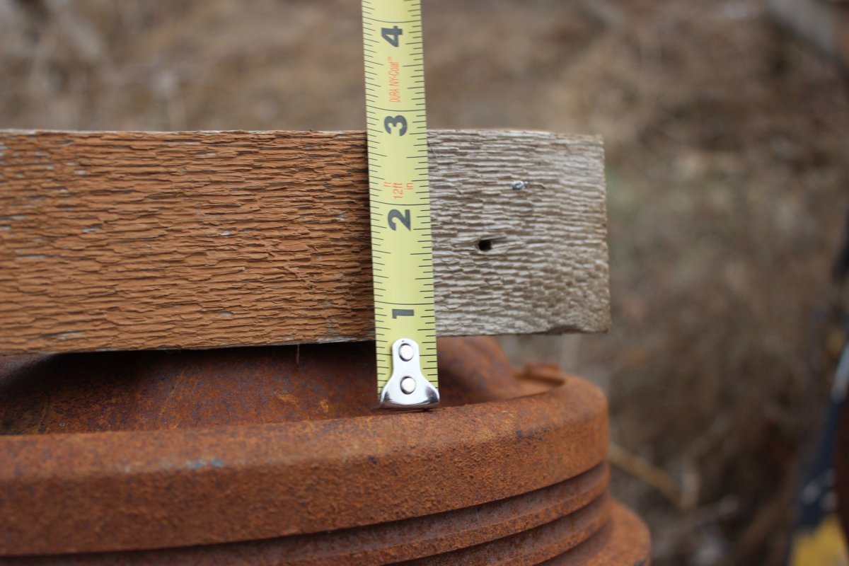

  24. Mr48chev
    Joined: Dec 28, 2007
    Posts: 35,977
    Mr48chev
    Same drum different source. I think I confused things posting the F100 stuff. Messed up with my own gripe there and that is posting something that isn't 100% relevant to the OP's question..
    I went out and measured my 52 F-1 drum and from the back of the hub to the edge of he drum is 3-1/16 roughly with the tape I was using and a piece of lathe for a straight edge.
    Flipping it over there is close to 5/8 difference between the wms and the edge of the drum. That might make them a bit more agreeable with 35 or earlier wires without spacers to get clearance from the drums. That is also why the deeper drum is needed to take up that drop when using the flatter face late drums. IMG_8900.JPG
    Stogy likes this.

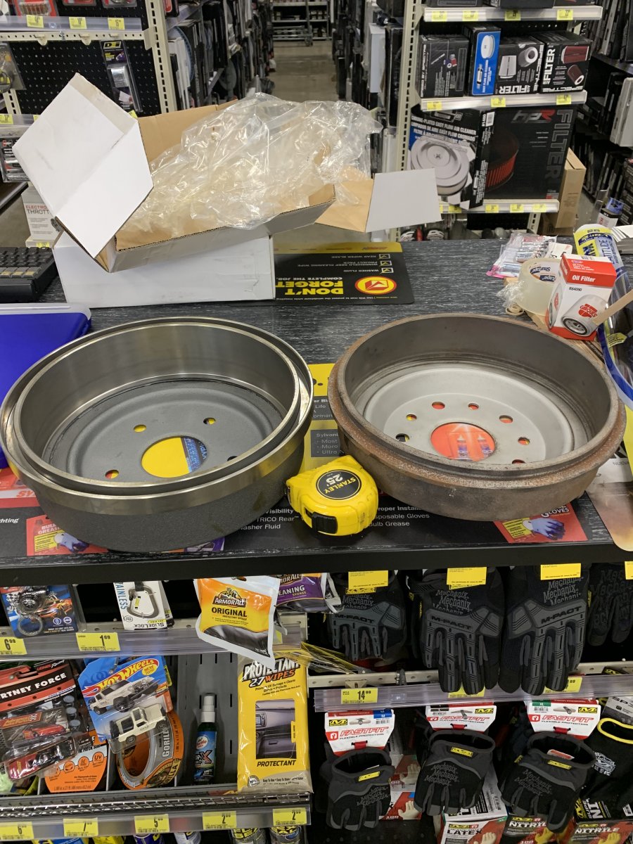

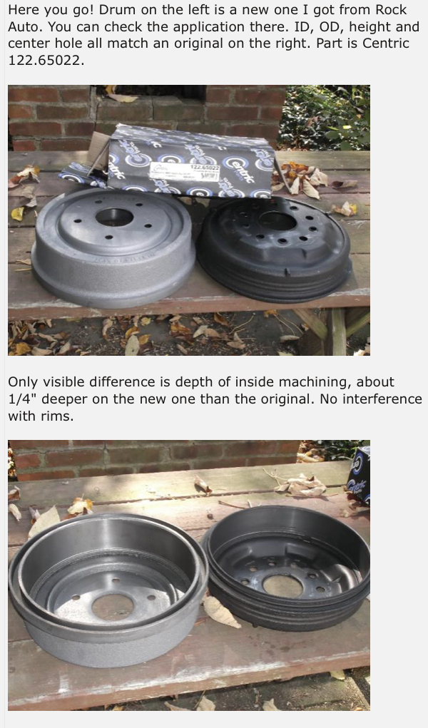

  26. Pete
    Joined: Mar 8, 2001
    Posts: 4,786
    Pete

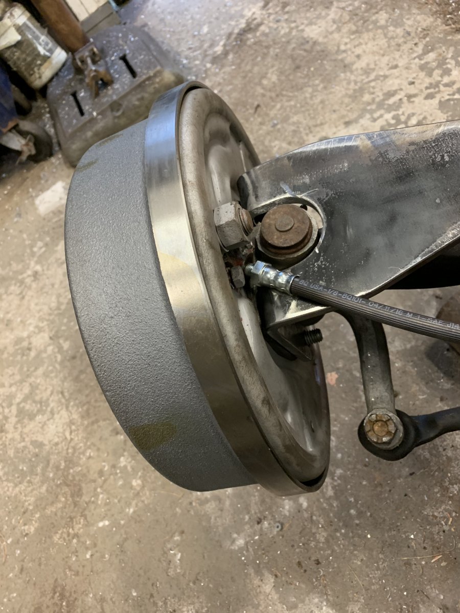

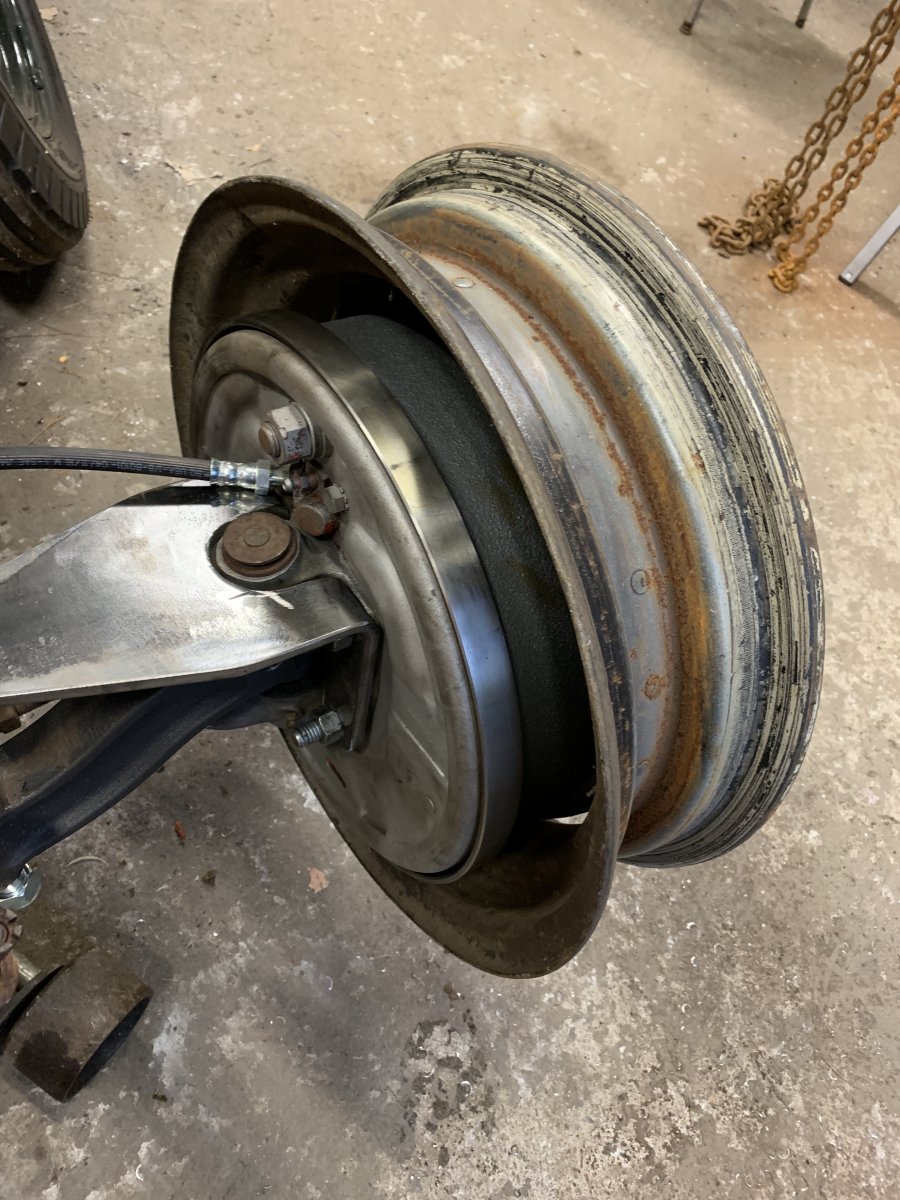

    Awesome info guys, I appreciate all the pics, part numbers and ideas.
    I did however pop on the FORDBARN and found some info.
    CENTRIC P/N 122.65022
    ADVANCED AUTO PARTS # YH140479
    I just got a pair, installed them on my F1 (not F100) hubs and they fit great. They are 11” drums just like the OG F1.....the center hole is the exact same size as the F1.....No rubbing or strange noises. I also installed a ‘40 rim, no issues.
    I used my Speed Perks rewards and paid $40—- per drum.
    Again, these fit F1 hubs,,,,,not F100
    D5F1FF8D-ED06-4F58-BCB7-C9EB90F52E2D.jpeg 14B7B47D-2D87-4E83-AD4A-BC53B75C0D24.jpeg 246A38E6-1186-427A-8201-9F0FBE5197E4.jpeg 81DA114B-DDC2-4047-9B29-CBDA64ACE5EA.jpeg 1767C8FC-C205-4321-82A1-F508ACAA17C2.jpeg 9CBE1210-5852-4E80-B29A-BB24D085D0C5.jpeg
    Inked Monkey, RICH B, teach'm and 2 others like this.

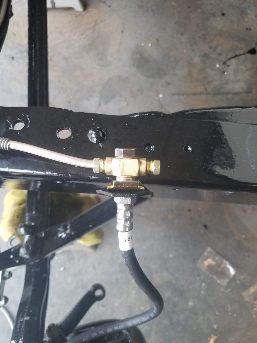

    On a side note if you are putting F1 / F100 brakes onto your early ford, and want to retain the use of the original banjo bolt for the hose fitting used from 39 to 48, you need to use Brake hoses for a 52 to 54 ford. They allow the use of the copper washer for the Banjo bolt, fit the F1/F100 wheel cylinder and still allow the use of the original 1/4 inch brake lines. Its Raybestos Part number BH16179. they are just the right length too when using a dropped axle.
    62529AAC-97BA-4613-A0BB-D74EE94B4974.jpeg 3F6B1889-EF90-4D62-BA64-5903EA178A9E.jpeg
