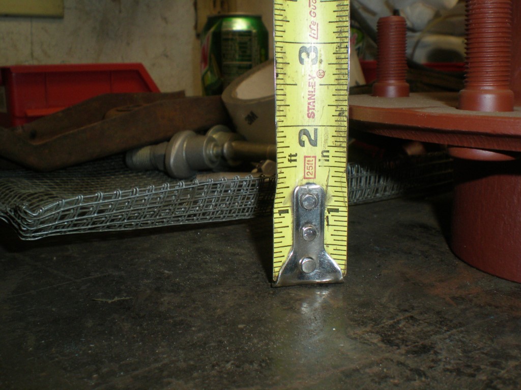

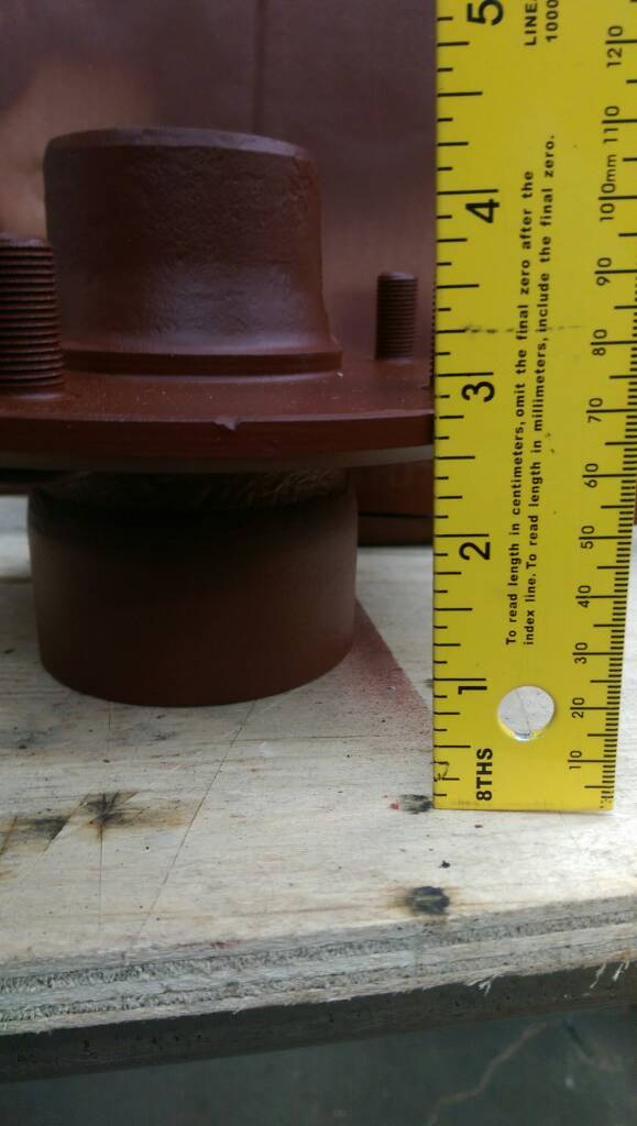

    I think some of the confusion is that Jason was referencing certain Bronco front drums that are the same part as F-100 front drums; which is a totally different deal than using Bronco rear drums on F-1 hubs.
    F-1 and F-100 front backing plates are all the same from '48-'56 (most are Bendix some are Ford Kelsey Hays).
    The difference is in the Hubs. The flanges on F-100 hubs are further inboard than F-1 hubs as shown in the attached pictures. This is what determines the drum needed.
    If you have F-100 hubs, you just need to ask for '53-'56 F-100 drums and you will get what you need.
    If you have F-1 hubs, you just need to ask for '80 Bronco REAR drums and you will get what you need.
