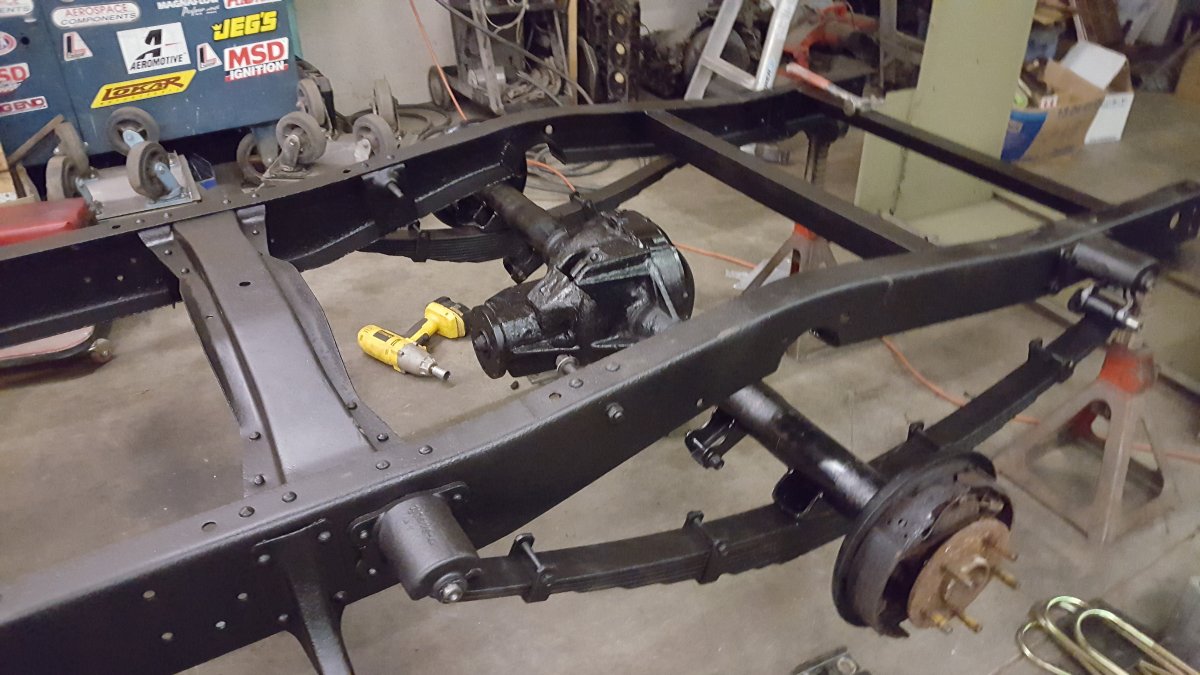

    We use explorer 8.8 rears.
    Shock mounts and spring pads will require some effort.
    Cheap way to get a posi and usable ratio inexpensively.
