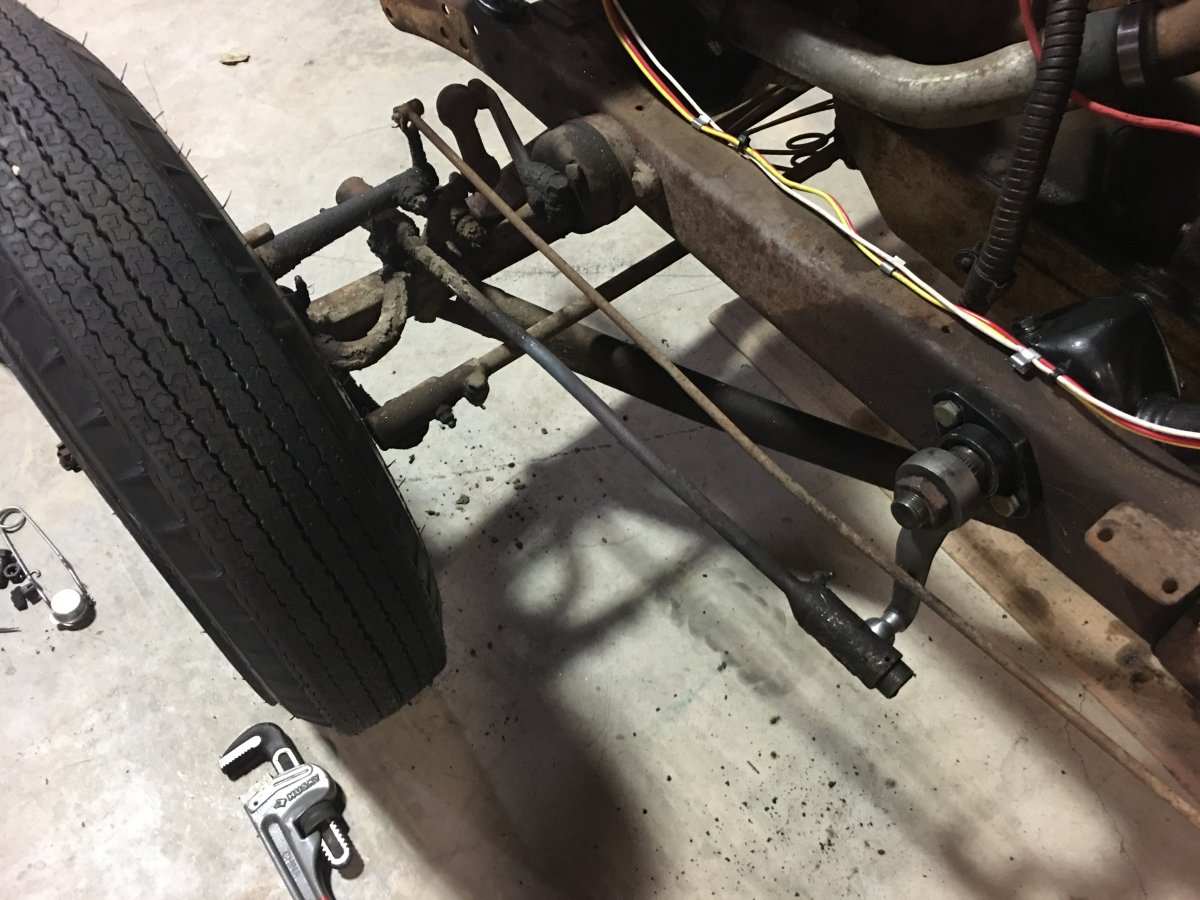

  11. On my '28 with F100 steering, I founds some ends and made the bar the right length.
    66fora69er likes this.
