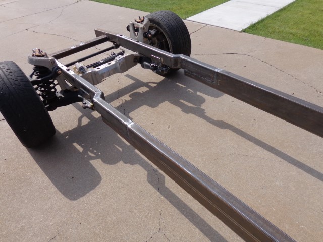

  3. Here's some pics of a narrowed cv that I did. I think the number was 4.625". That would require a complete redo of the front end. I know that Fatman did the narrow a arms but is no more. I haven't looked so see what there is available now. DSC01824.JPG DSC01797.JPG DSC02716.JPG
