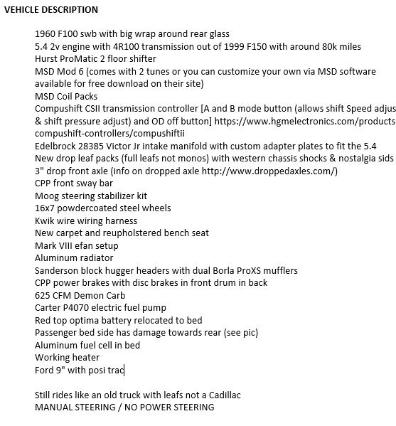

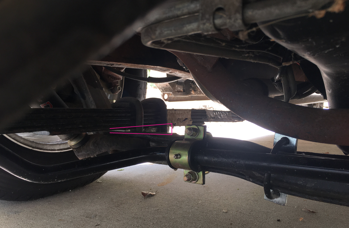

    I recently bought a 1960 F100 with 3" Nostalgia Sid's dropped front axle and 2" drop blocks for the tie rod. It has Western Ch***is lowering leaf springs all around too. There's also a steering stabilizer and sway bar kit. The truck is really hard to steer (way harder than my other manual steer trucks). It feels notchy too.
    I looked under the truck and it appears like the tie rod is touching the oil pan. The leafs also appear to be arched in the opposite direction. Is this normal? I'm including some pics and the build sheet so you can see what has been done to the truck. Any suggestions on making this steer/ ride better are greatly appreciated!

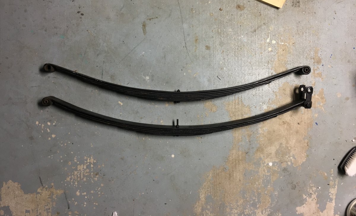

    Thank you! I did send a couple of emails to Sid. Maybe a phone call is better. The guy who sold me the truck is adamant that the setup is correct and that lowering leaf springs just look that way. Do you think the weight of the 5.4L and auto trans would contribute to the sag? Is there ever a scenario where leafs are meant to be arched in the opposite direction, or is that just plain wrong?

    De-arched springs look like that. I'd be more worried about the drag link angle.

    That drag link angle has to give some terrible bump steer and probably half the reason for the steering stabilizer. I don't know if shock clearance is an issue but the drag link should be a lot closer to level which means that the steering arm from the spindle needs to be bent down accordingly or replaced with one with the correct drop.
    On the springs, I'd email Western Ch***is with a photo but am like RNR&C in that that is the way they are set up.
    Pan clearance have the steering arms been dropped? At any rate that is the . thing that has to be taken care of as the tie rod will eat a hole in the pan in short order the way it is now. You may end up changing to a pan that has a more friendly shape to it or having that pan modified for clearance.

    That front end needs some major work. Raising the engine to clear the tie rod and lowering the steering arm to level it out should take care of most of it. Your castor shim looks like more of a spacer than an angled shim.

    All good input. I actually have some reverse eyed springs that came with the truck when I bought it. I wonder if I should reinstate them. The tie-rod would clear the pan and the spindle arm wouldn't need such a drastic adjustment. But then the front might be jacked up in the air compared to the back. I also have a stock height '64. It's my pride and joy. This lowered thing is all new to me.

    To start with, those are not caster shims but spacer blocks to raise the truck so the tie rod will clear the pan. I would put the stock springs back in it to bring you back to about where you are now. You either need to raise the engine-transmission to clear the tie rod or modify the oil pan. Dropped tie rod ends will put you below the scrub line. Modifying the pan would be the easiest way to go. Either get a drop steering arm or bend your arm to get rid of the angle as suggested.
