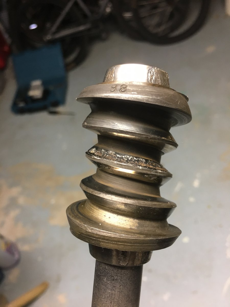

    I started pulling apart the steering today and discovered that the steering box is really gritty and rough, even without any load on it. You can see some significant damage to the worm gear on the steering shaft if you look closely at the pics. Do I need to toss out the whole thing or attempt a rebuild? A quick google search shows that these things are expensive and there's usually a core charge. Any input is welcome.

    So I took apart the steering box and everything looks good apart from the worm gear. Even the bearings look great. I don't understand why only the worm gear would sustain the damage and not the other components. It'll save me money though!

    What you show is pretty typical. The worm has been worn through the case hardened surface. The condition of the races show the bearings are done. Check the roller for any wear or tiny pits, that would indicate the hardened surface is compromised and will soon end up looking like the worm if re-used. The shaft will press out of the worm, so if you can find just the worm it can be pressed back onto the old shaft...might save some money there. A 7/16" quarter inch drive deep well socket is the perfect size to press the shaft out of the worm. You'll have to get your hydraulic press up on some blocks to get the needed space to get the shaft to fit for pressing the worm off. Good luck!

    Ford pickups (mainly) had case hardening on the worms that exceeded hardness specs.
    Steering boxes pitted at less than 50K miles, matter of record.
    Replacement worms are reported to have 'corrected' that flaw, every box I've rebuilt has come out 'like new'...but as long as I'VE been doing them, even I'm not old enough to have seen a number of them wear out again!

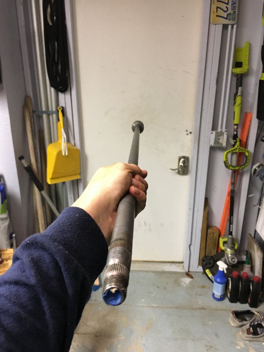

    My attempt at pressing the new worm gear onto the steering shaft was not successful. I bent the steering shaft! I went to 5 different shops and garages first, who either said they did not have a large enough press or were not willing to press the worm gear on. I eventually made my own rig with a bottle jack and some framing. It was squeaking along pretty nicely until the last 1/2" when the shaft suddenly bent. Needless to say, I'm rather upset. I even bothered to put the shaft in a chest freezer and heat up the worm gear. I listened to all those good suggestions people made and I still f'ed it up!

    There are more shafts out there. Or you could possibly straighten that one.
    When I did mine I found the toughest part was clamping the shaft so it wouldn't slide while pressing. I didn't just push on the worm end and let the other end be the stop. Some guys have even welded a pair of temporary blocks to the shaft up near the worm so they have a positive place to push against. Just a short but strong tack weld should do it.

    I'm pretty disappointed with myself, but I'll give it another shot. I'll try and straighten out the shaft before I drop $200 + shipping on a new one

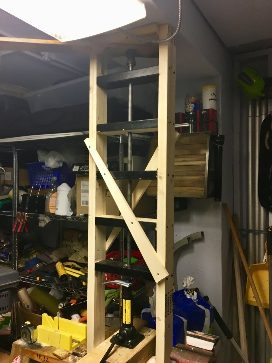

    I made a little jig for straightening the steering shaft. To my amazement, it actually worked! The shaft is mounted in some eye bolts that allow you to spin the rod and find the high point. I pumped the jack a few times and re-checked. I'm going to take a well earned break before attempting to press the worm gear on that last half inch.

    I listened to the suggestions and decided to build my own jig after 4 of the local garages refused to help. I guess they don't want the responsibility, especially with customer supplied parts. That's understandable. Anyway, the jig worked (see pic) and I'm back on the road finally! The key was to prevent the shaft from flexing and transfer all the energy from the jack straight through to the worm gear.

    :cool: Very ingenious with the straightening and the final install.
  19. alanp561
    Joined: Oct 1, 2017
    Posts: 5,994
    alanp561
    You play golf, don't you? Seriously, good job on straightening the shaft.
